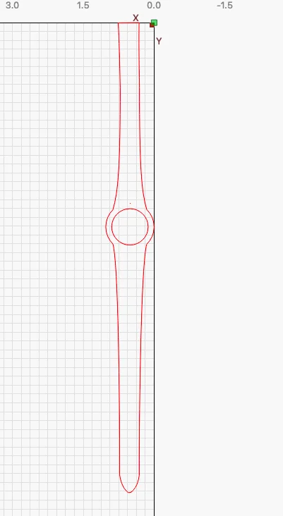

It is fairly easy to set up in lightburn. There is a metal insert that is in the back to provide some support at the stress points. I find that tuna can steel works pretty good for that.
It is really two circles at the back. The taper is done by drawing the strap, then using the curve path edit tool to bend a line from the outer cirle tangent to the buckle points. This then gets mirrored.
here is a screenshot. note that one side gets folded over for the buckle. Since this is leather I did not put the holes in it.
