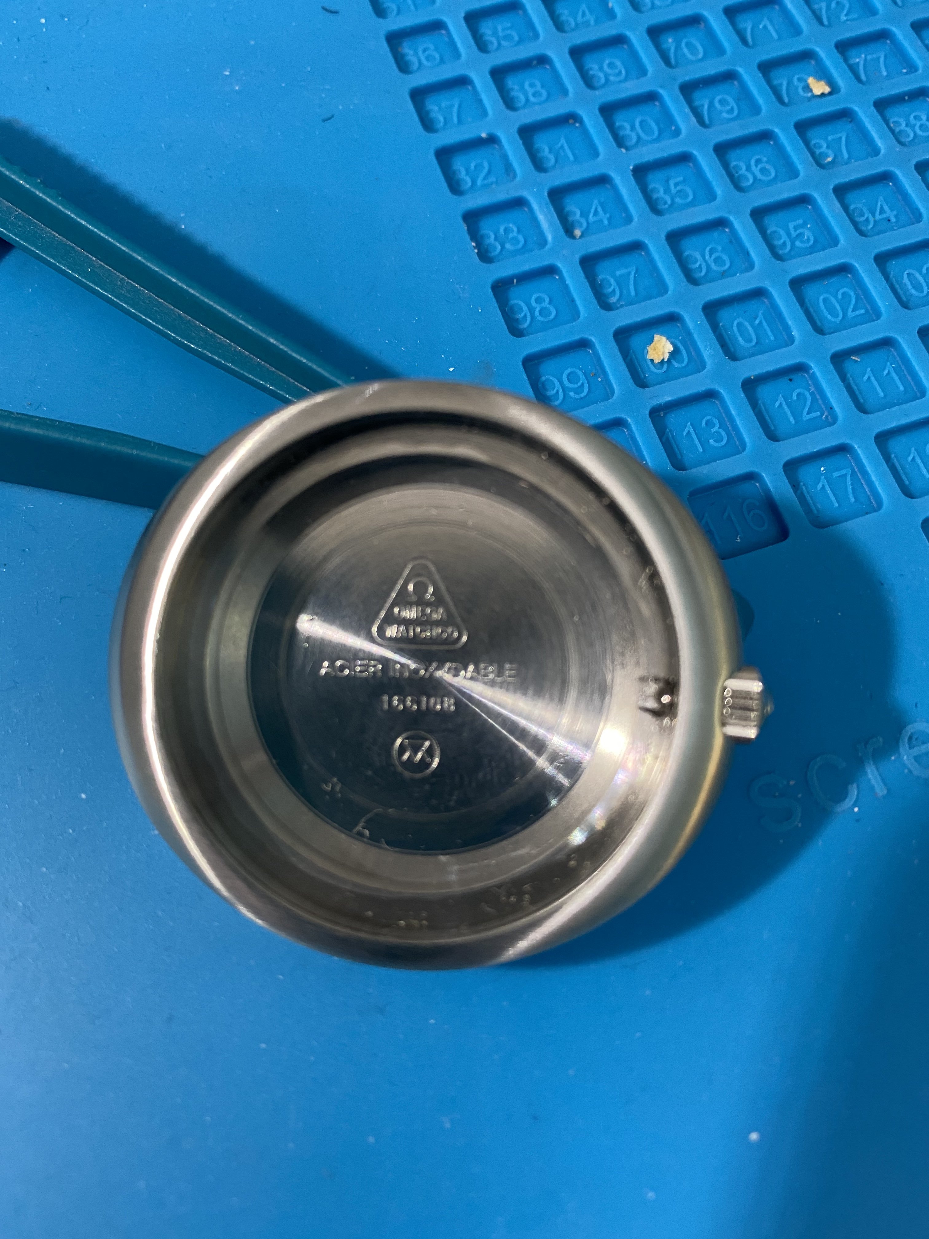

Hi guys any body can help what movement fits in a dynamic watch that’s easy to buy.
Regards Jerry

Hi Jerry,
There have been a lot of different Dynamic models... can you give us a little more information?
Thanks
Chris
792
845
As Chris mentioned, there are many dynamic models and different dynamic cases hold different movements. Series I dynamics usually had a 565, 552, 752, or 613. Do you have a photo of a case you wanted to use?
Frankly, I don’t recommend building a dynamic if that is something you’re trying to do. It is rarely cost effective and the dial/hands are hard to track down outside of official channels.

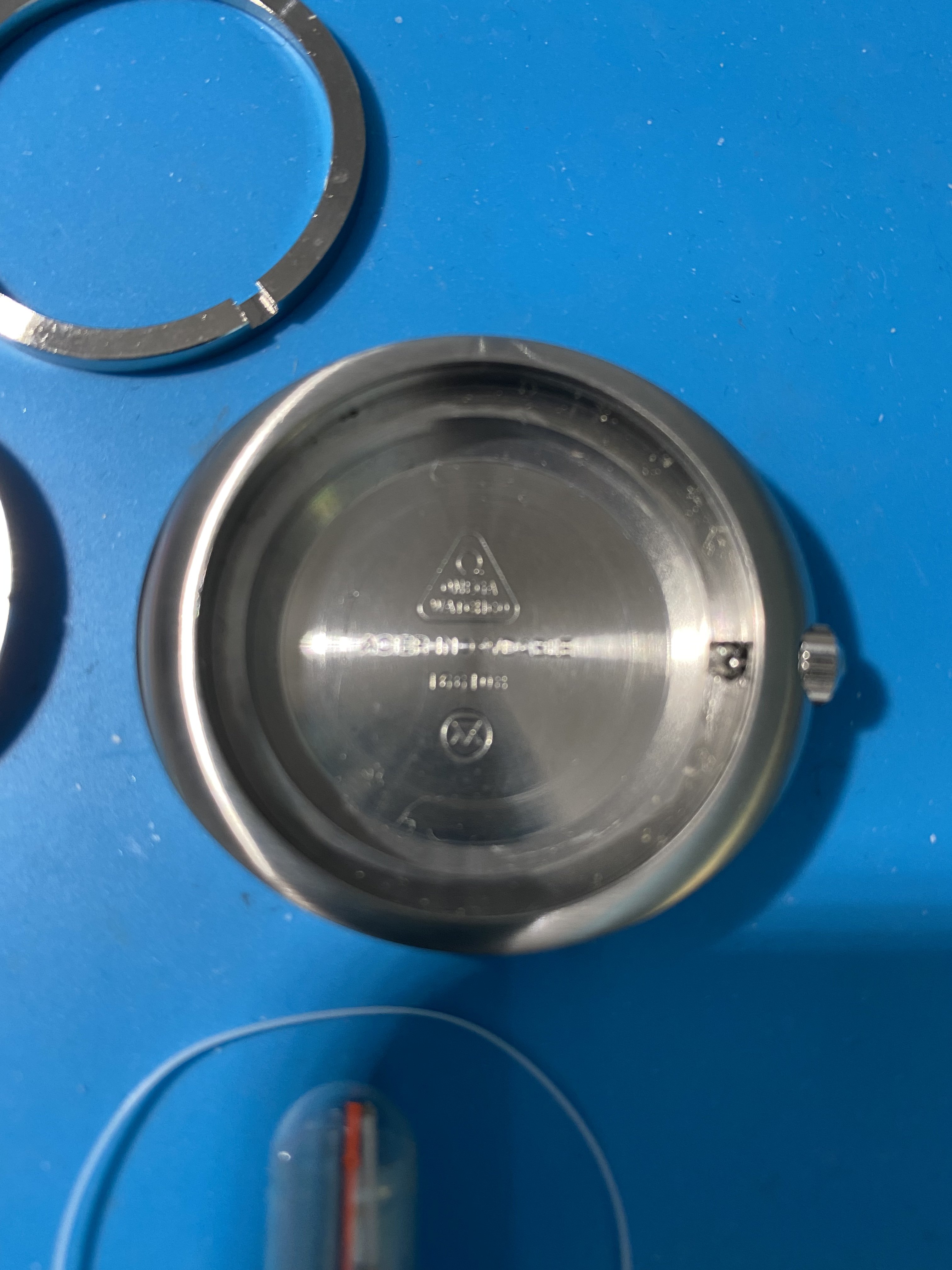

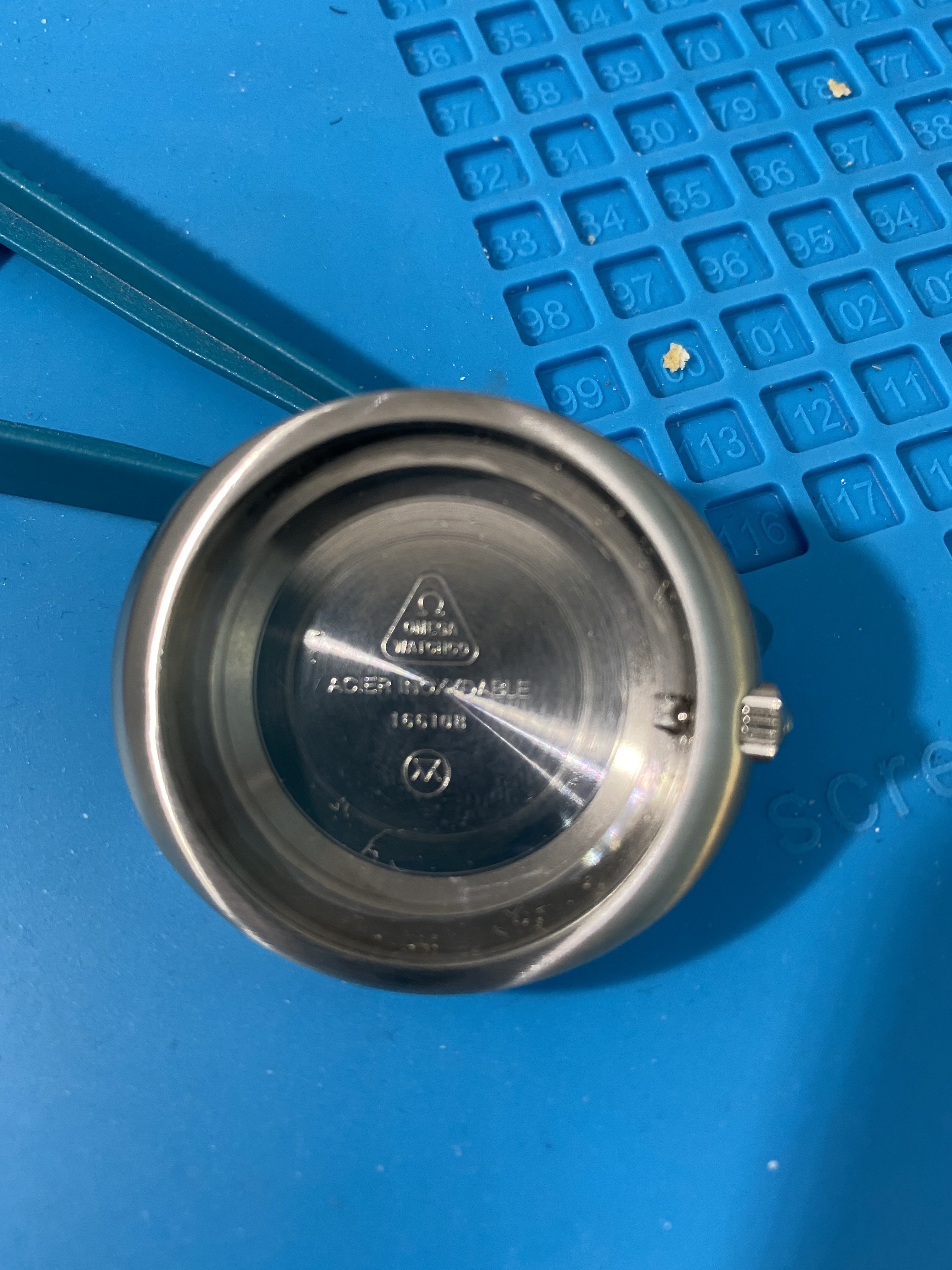

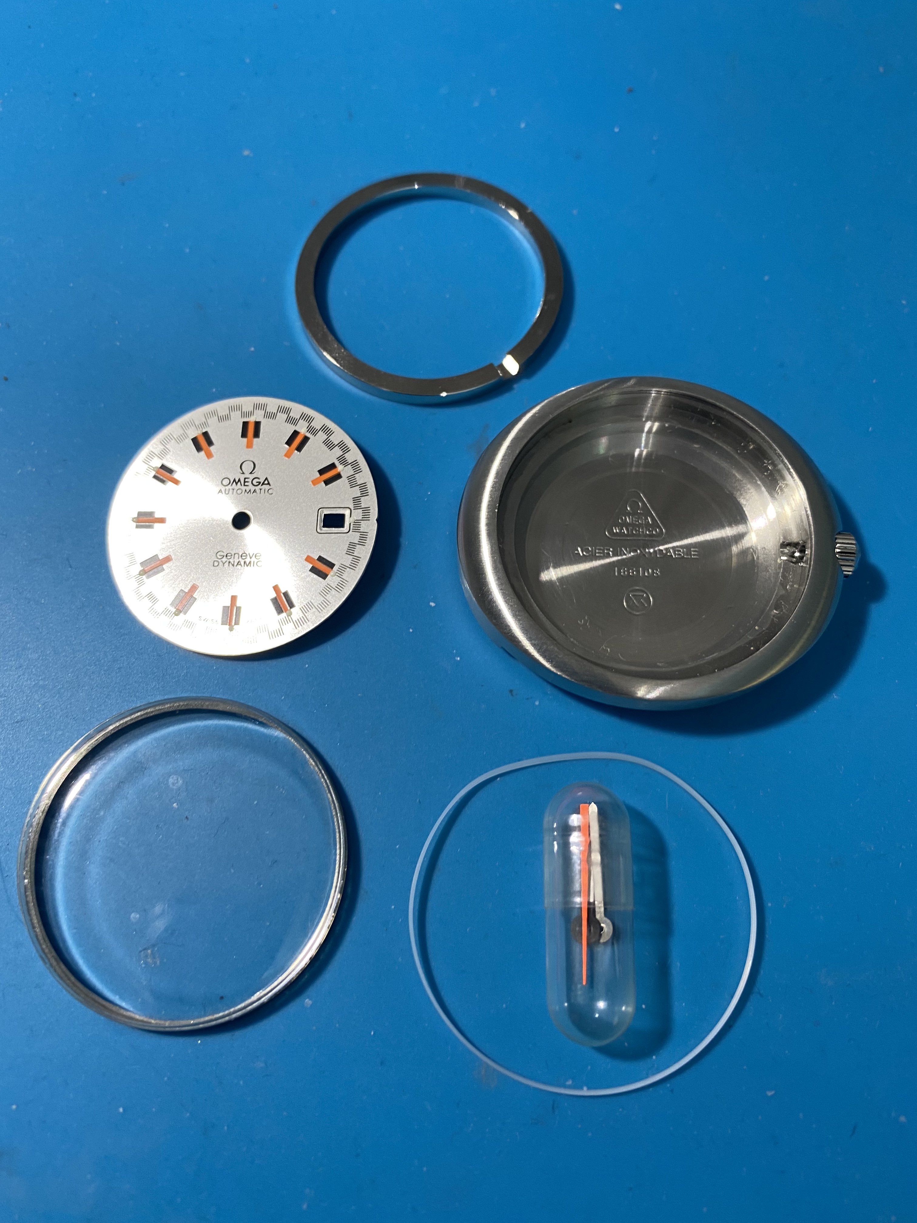

Does this help guys

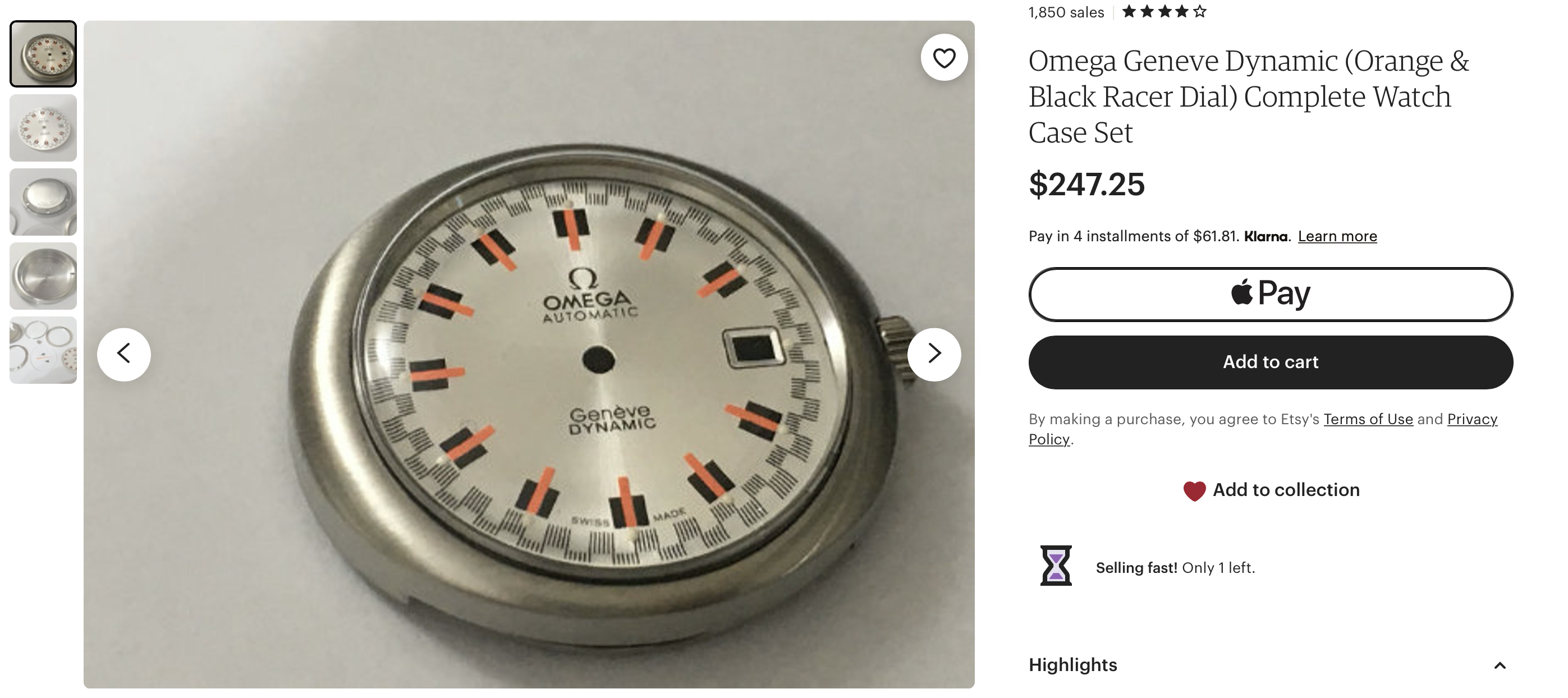

Yes, it does...unfortunately, you have a fake Omega Dynamic kit, so it is anyone's guess what would fit in there. These have been around for a while and are often found on ebay and etsy with fake Omega Seamaster 300 and 120 cases. I just took a look at one of the listings currently present on etsy and the seller said "Auto cal 1010, 1012, 1020, 1022 movements will fit nicely in this case or similar." If you recently bought it, I would return it...

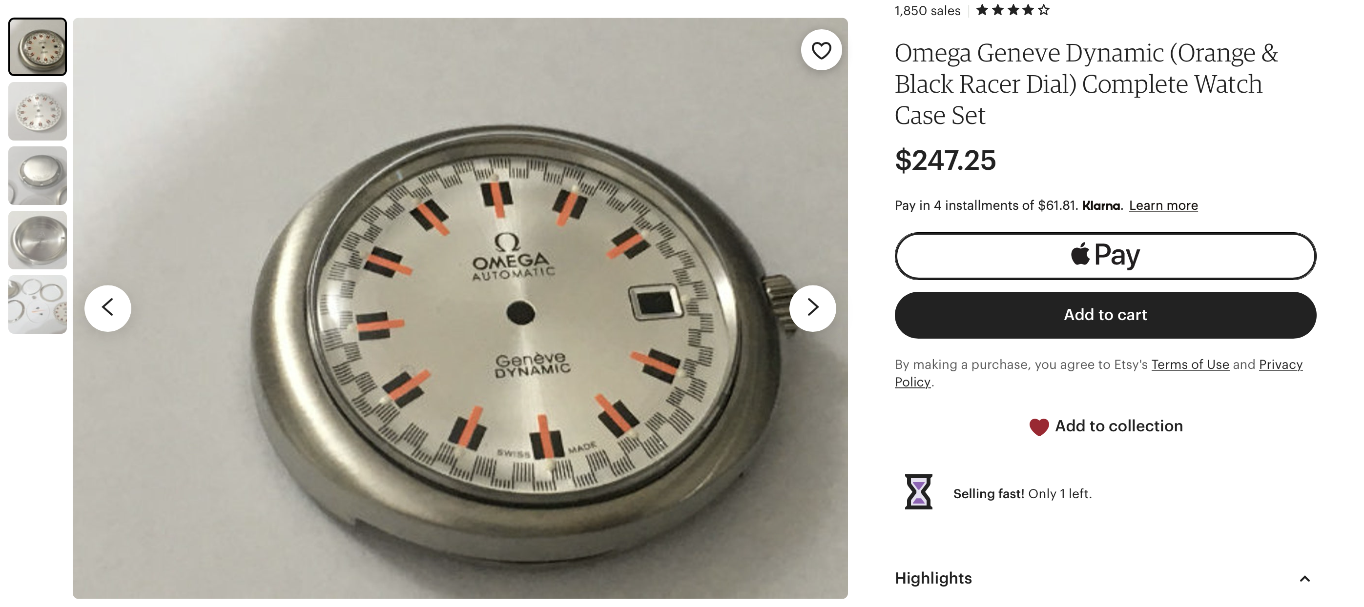

For added context and reference for others, here is a screenshot of a case set listed on etsy:

Thanks lesson learnt
