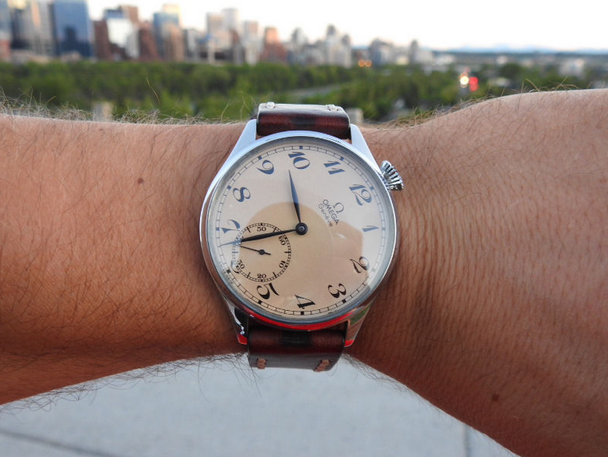

Not a fake as it's actually an Omega caliber (962?) and the dial may even be original as these were produced as Lèpine and Hunter pocket watches well into the 1970s.
Some creative "Doctor" has built a "Marriage Watch" by putting the Omega parts into a new case, most likely made in China.

Right. Sorry 'bout that. I had seen the pocket watch version but had never seen it on a strap. Or at a 45 degree angle. Perhaps the good 'Doctor' is also a chiropractor with a sense of humor?

I was alluding more to this Doctor.

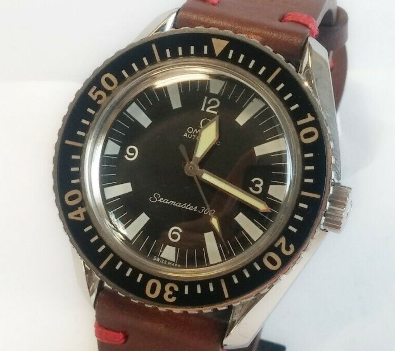

Fake Seamaster 300
fake dial, hands, bezel, case,... caseback was probably so obviously a fake that it "got lost" (how can you loose a caseback?)
the only genuine parts are the brand new caseback and the movement..

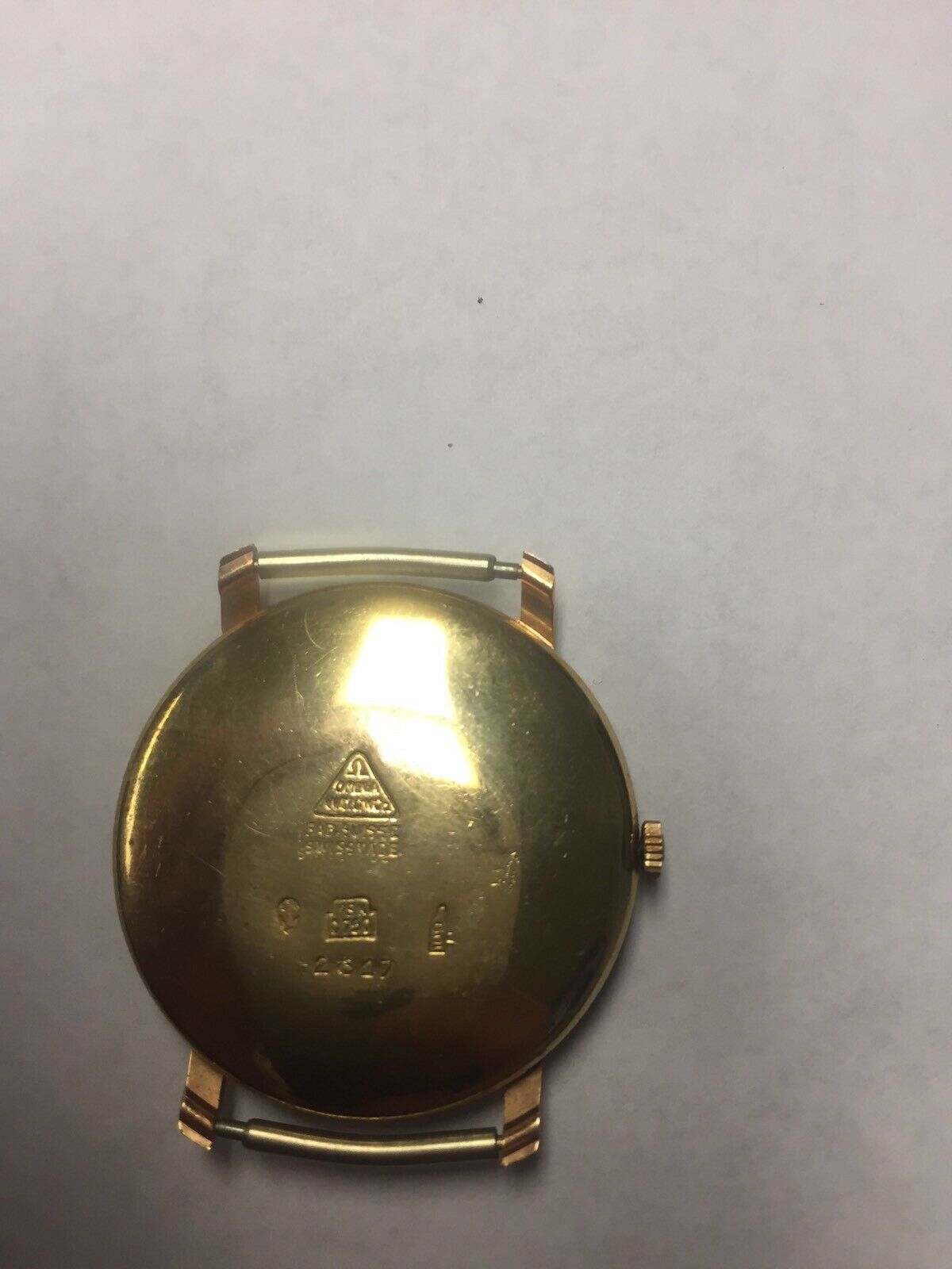

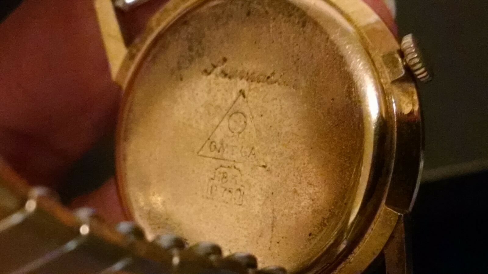

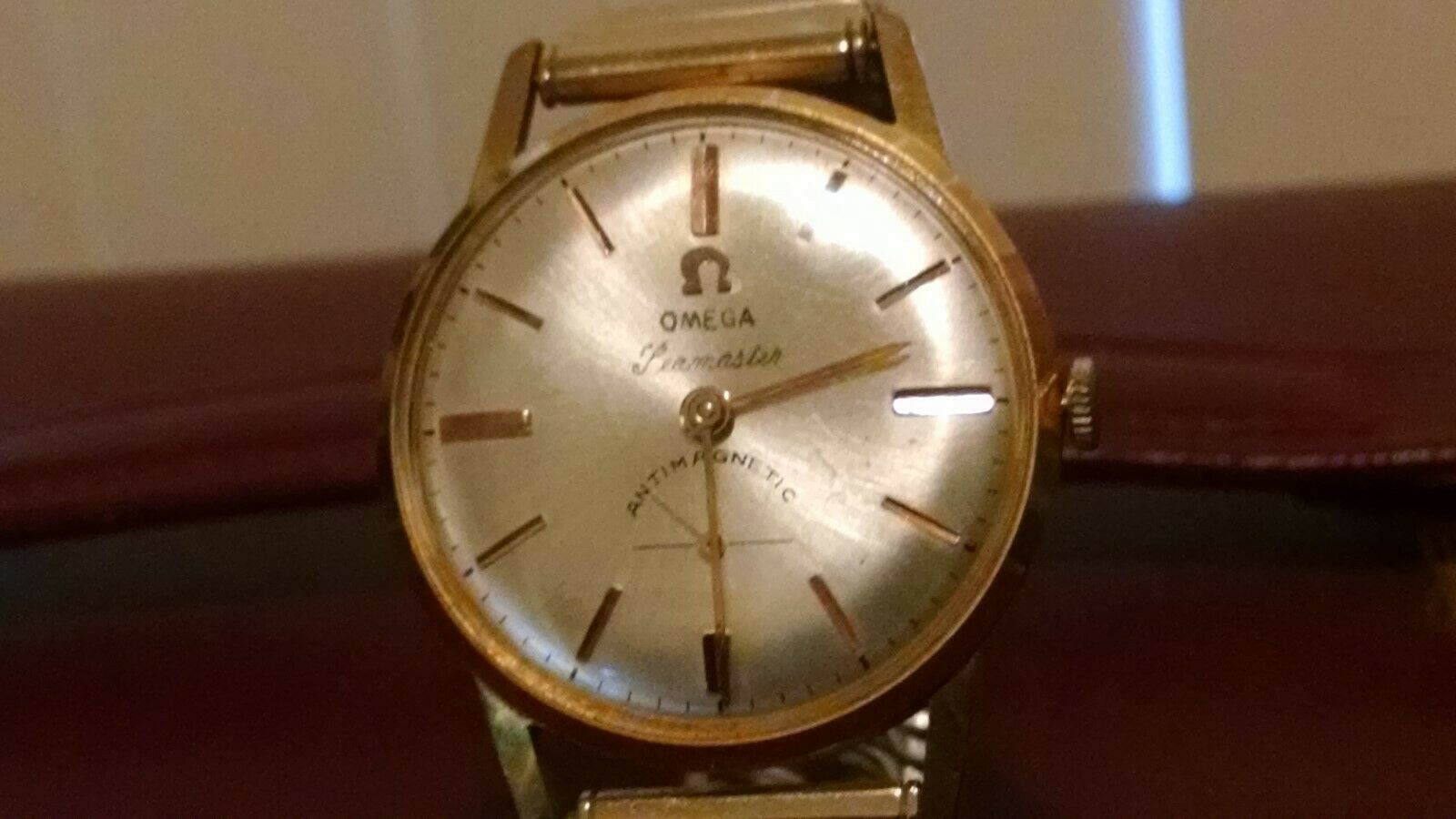

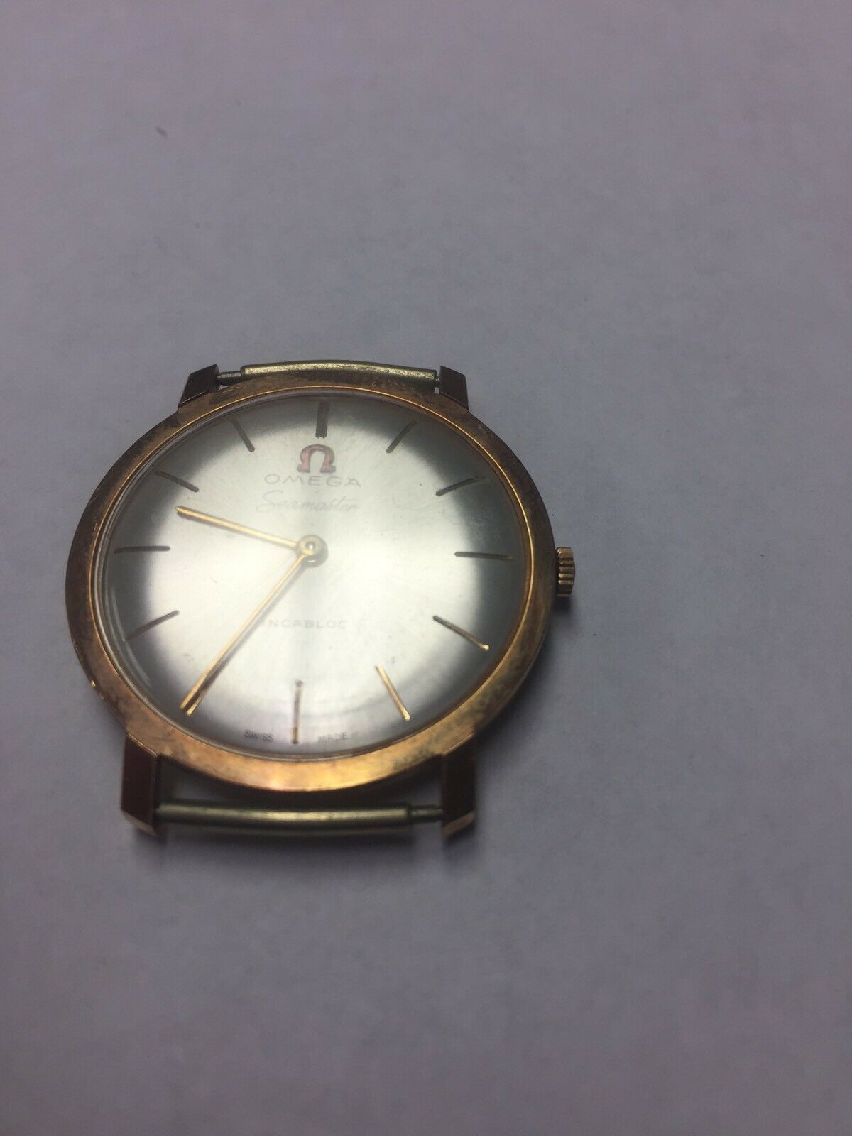

Bought for 565 movement. Yellow fake 18K case feels light. Glued on markers have fallen off
