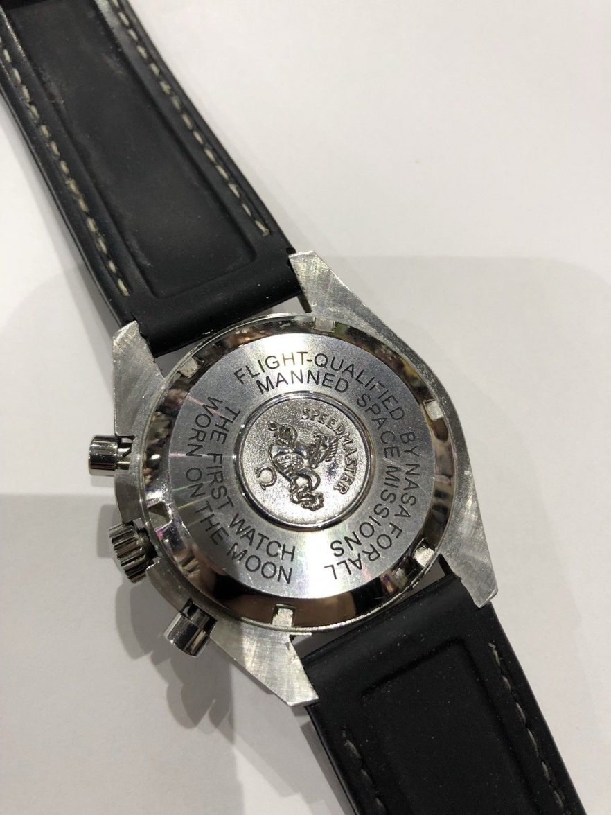

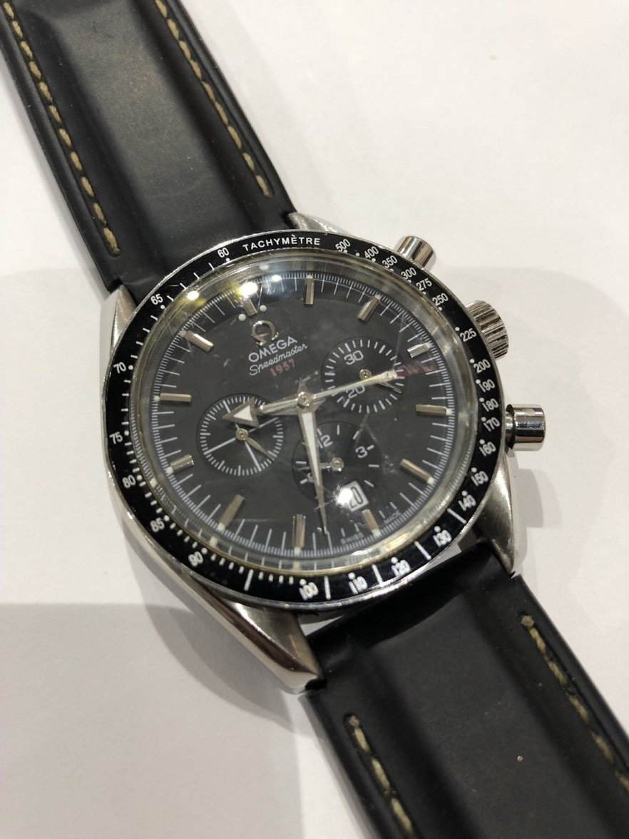

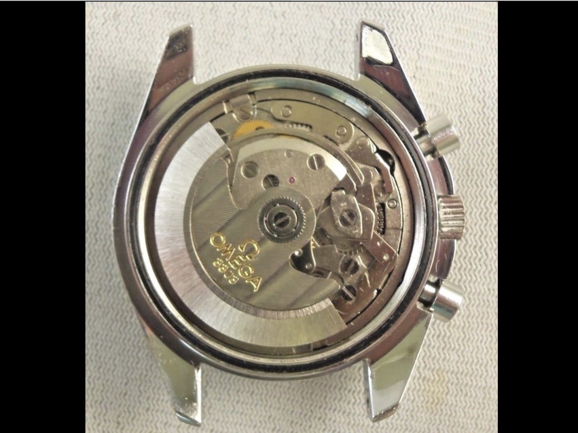

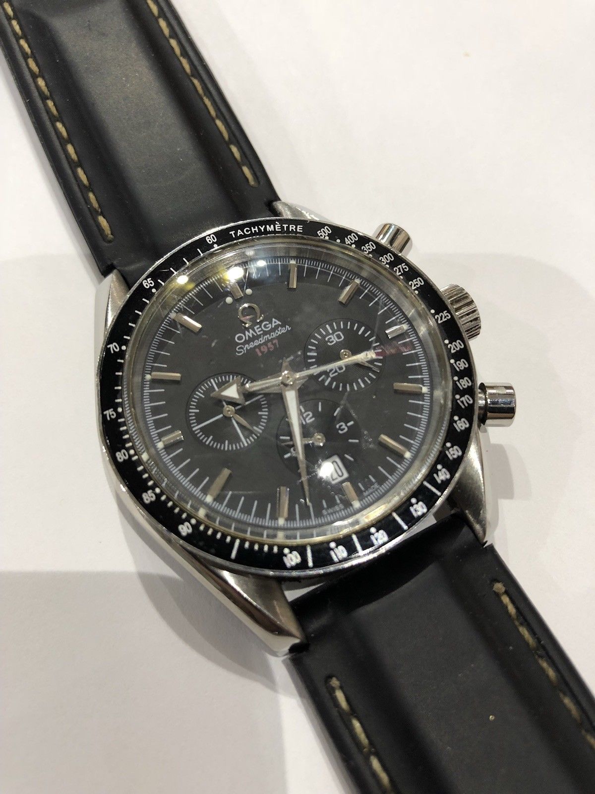

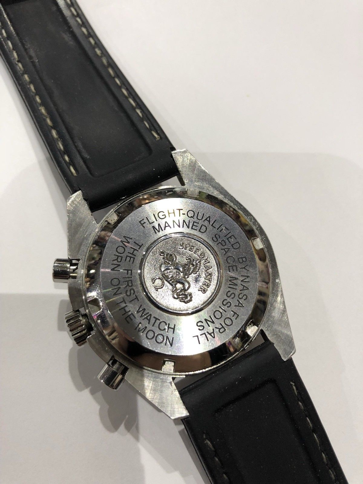

Back to our regularly scheduled programming. This along with the broad arrow shown below show a disturbing trend. Can only assume this is an Asian clone of the 7750 has been turned 90 degrees like the Omega 3330. A few more details and this would be a rather convincing fake.
https://www.ebay.com/itm/Vintage-Mens-Omega-Speedmaster-Broad-Arrow-Wristwatch-Stainless-Chronometer-WOW/282737830194?ssPageName=STRK%3AMEBIDX%3AIT&_trksid=p2055119.m1438.l2649
4,106
7,062
Perhaps I should read the description a little closer. This is a 7750 type with the seconds pinion cut off and dial glued on. Either way FAKE! Still wonder if the date works.

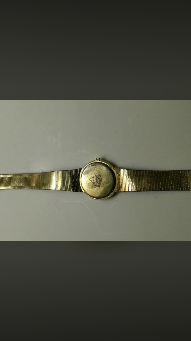

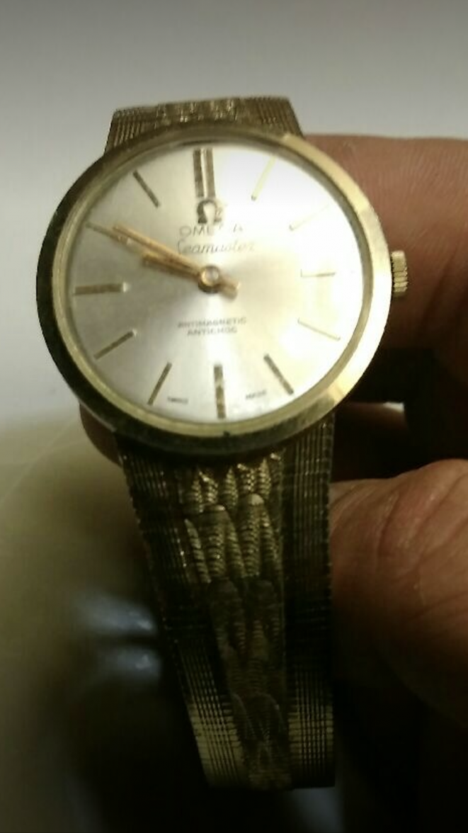

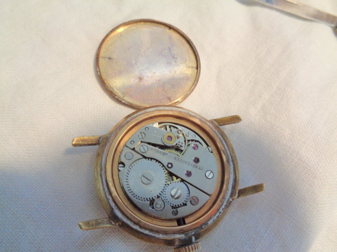

Dead Link/rover/0/0/0?mpre=https://www.ebay.com/ulk/itm/391928205043

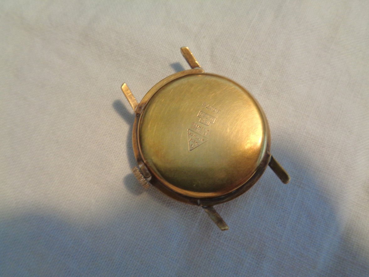

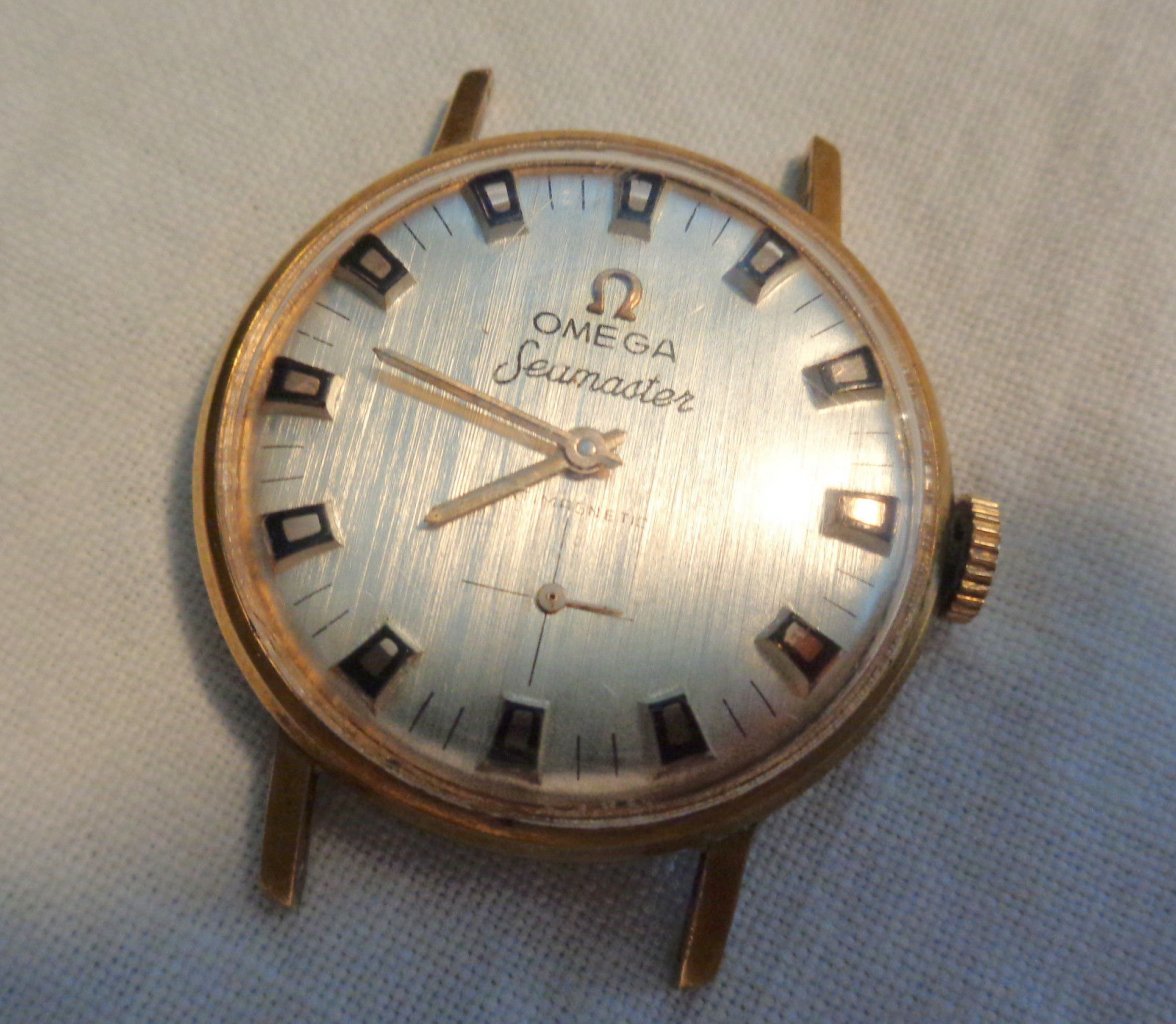

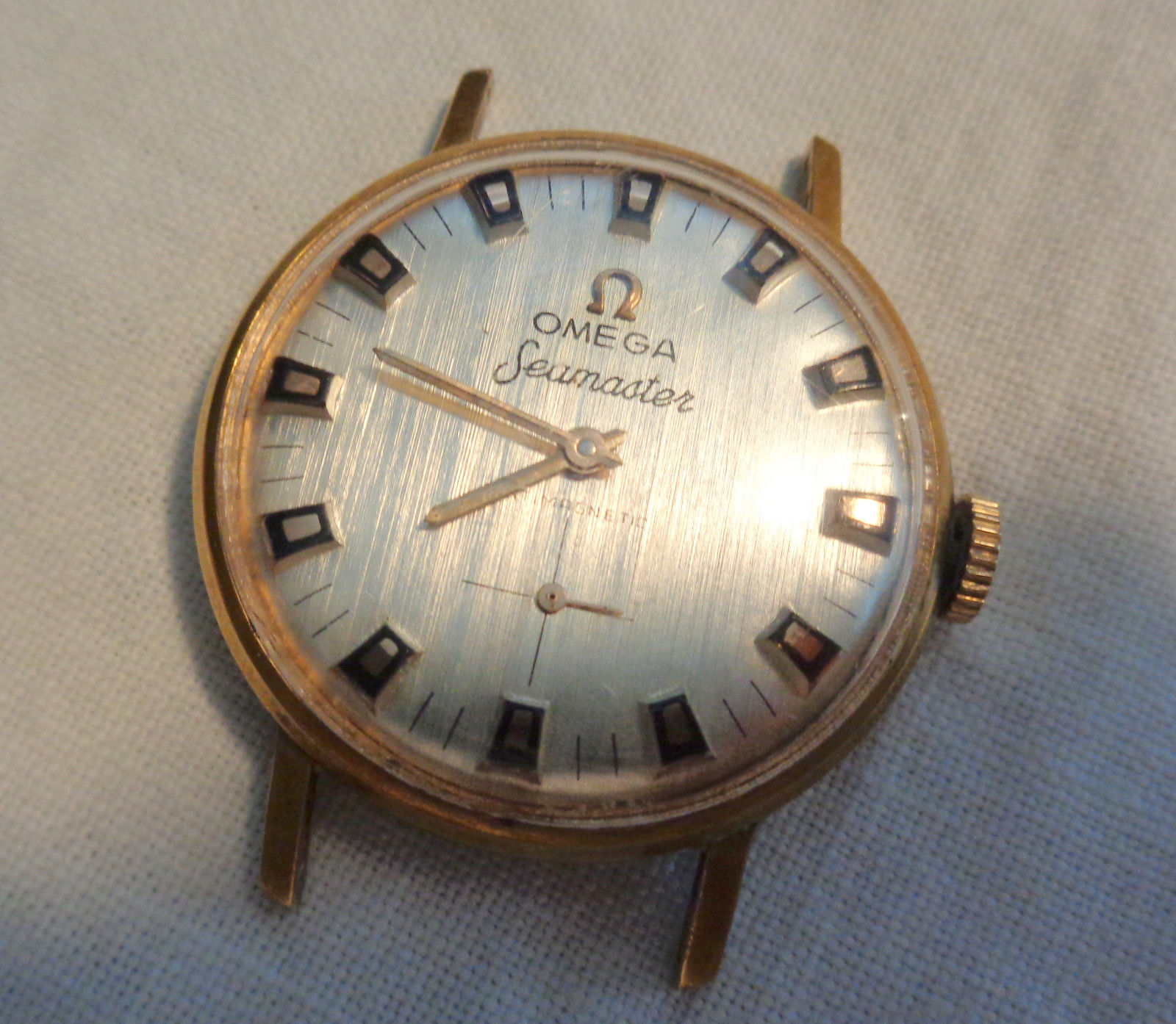

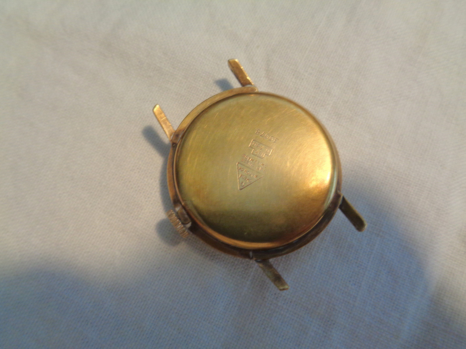

The price of this Seamaster is a tad optimistic for a blatant fake. I reported the listing. I wonder if eBay will remove it?

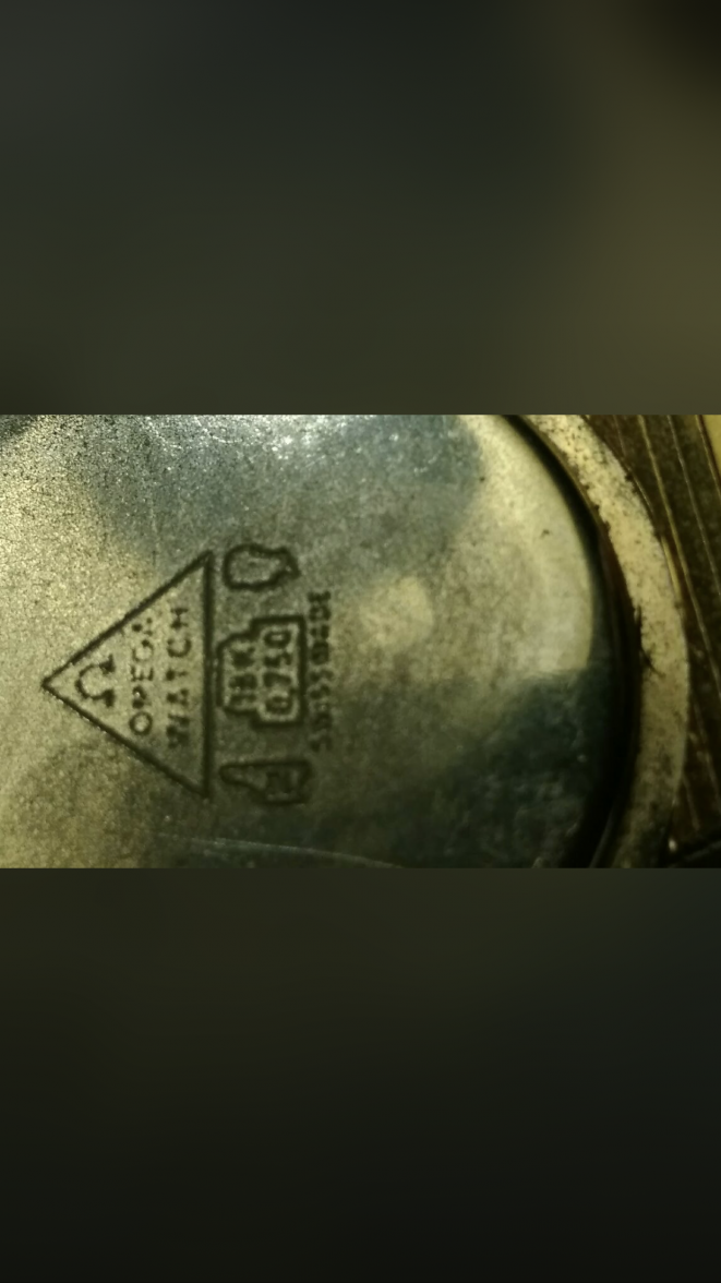

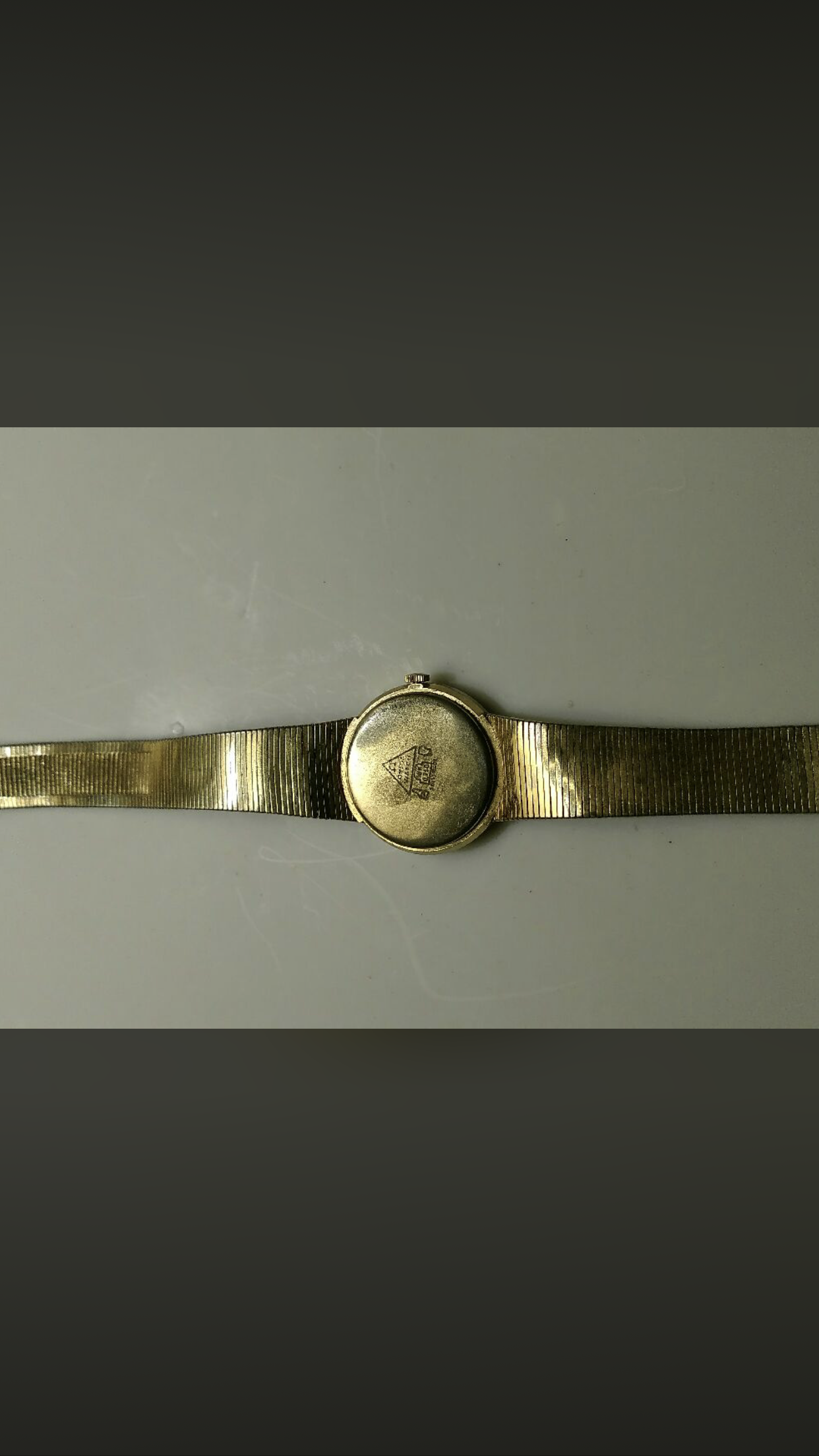

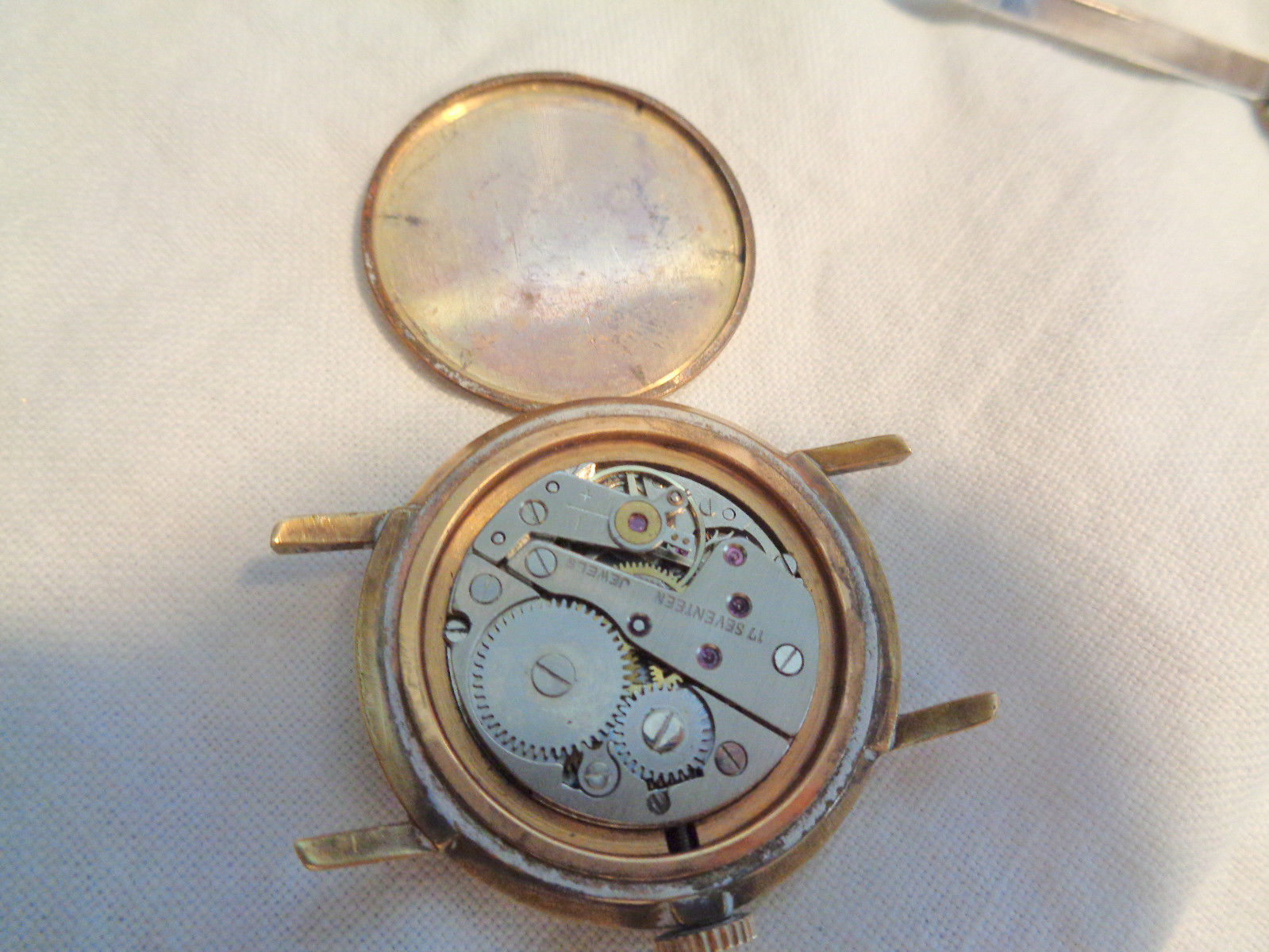

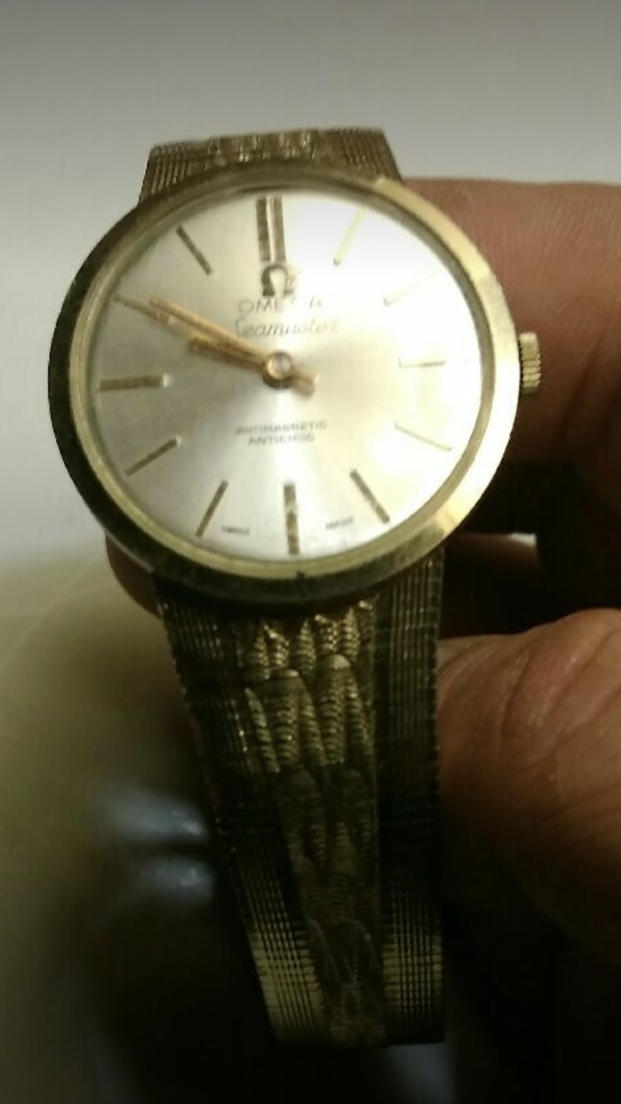

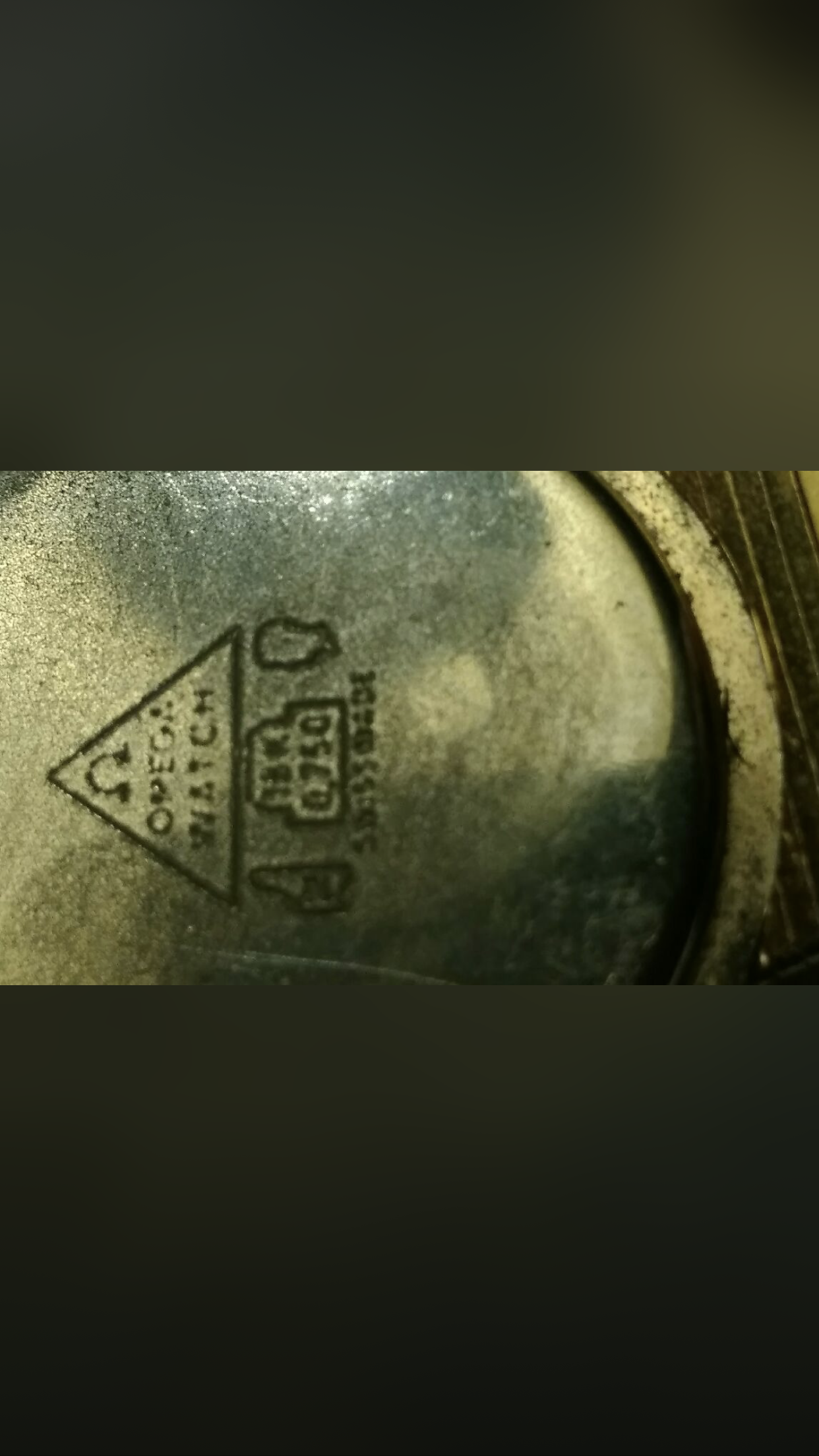

A moment of your time please:
I've read this thread with interest and would like your collective opinion on the following watch.
I found it amongst my late brother's effects and it appears to be genuine.
in anticipation, thanks for looking.
What part of the thread title don't you understand? Not for questions.
