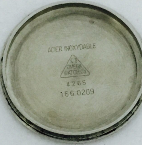

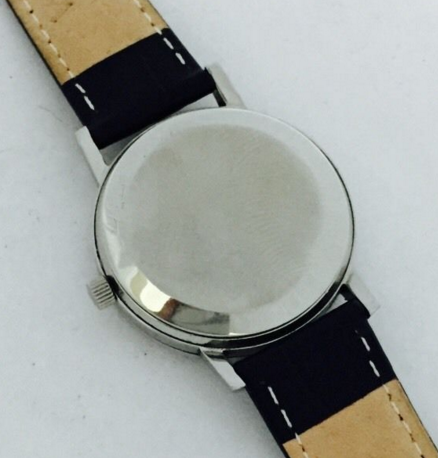

Hi all,
thanks for coming back to me.
It was a late night ebay bid, nothing too luxurious, only a a few £££.

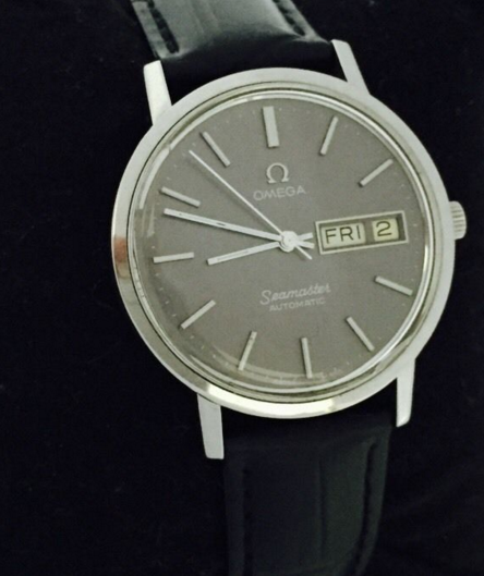

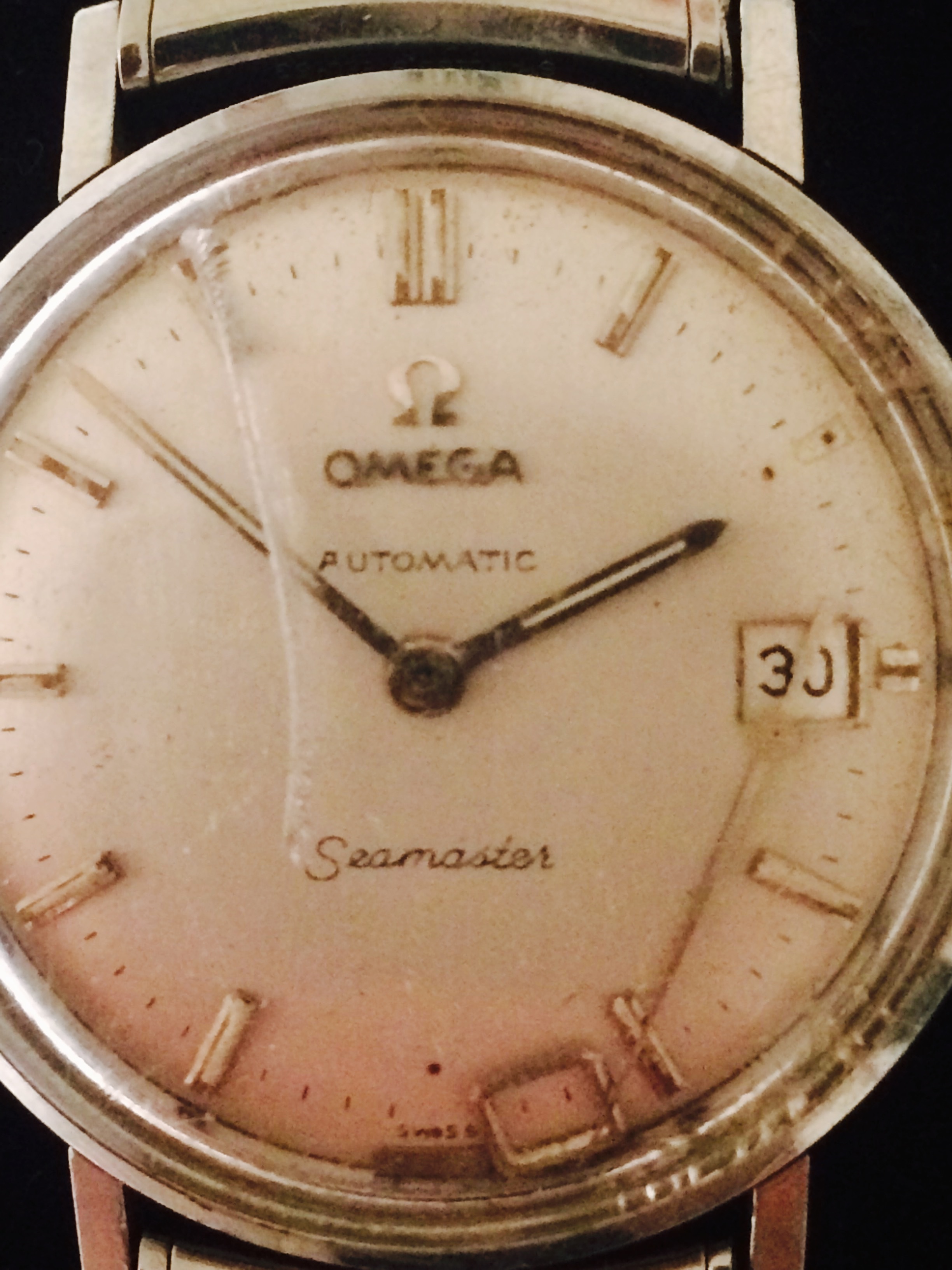

Hi all,

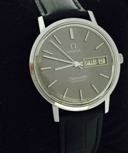

Out of interest, what jumped out at you the most?
Virtually everything on the dial. Wrong script on Seamaster, anti-magnetic, just to name two things.

Hi all,
As above a lot. But the omega on the outside of the caseback is wrong as it should be on the inside of the case back. ( something to keep in mind )
Don't forget I have seen a lot of these (1970s) fake omegas over the years.

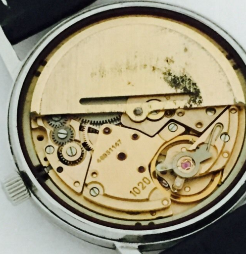

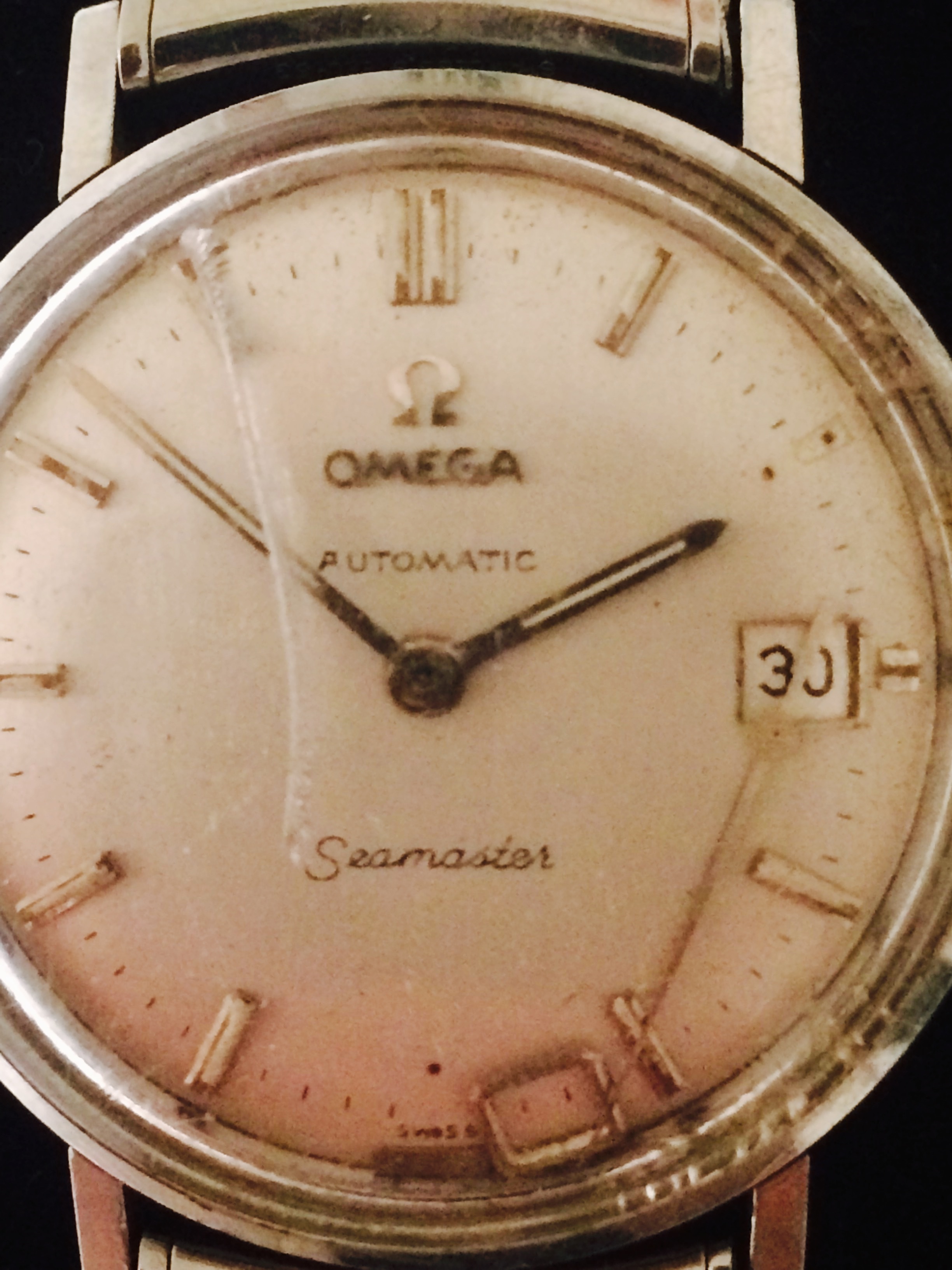

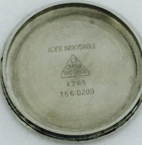

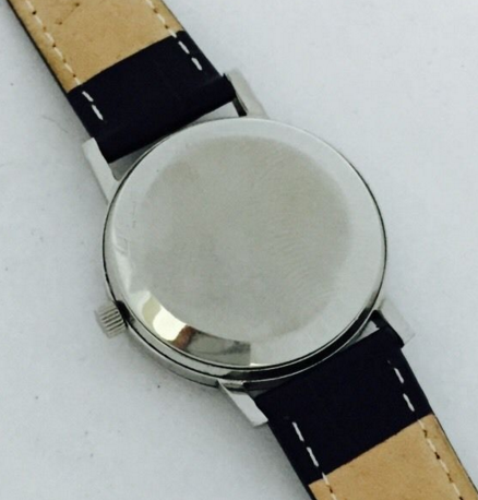

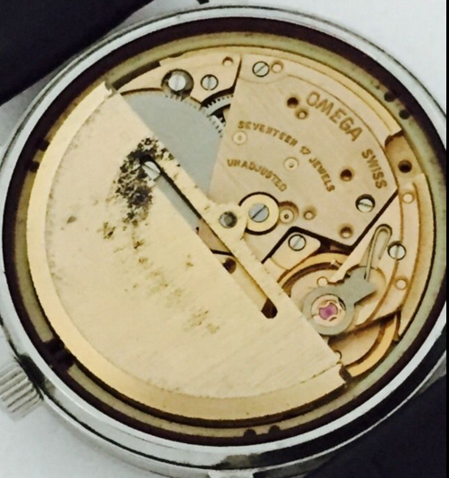

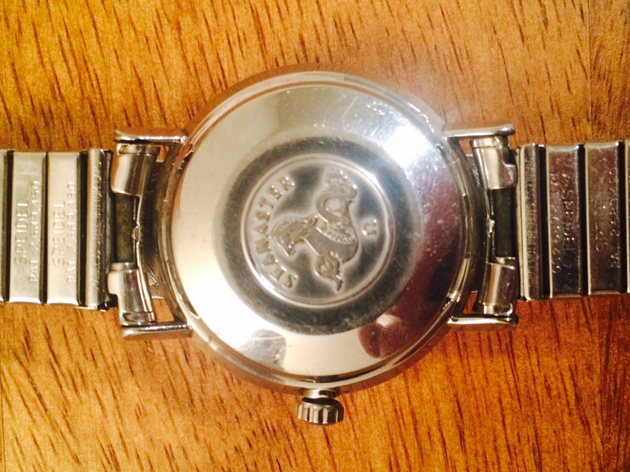

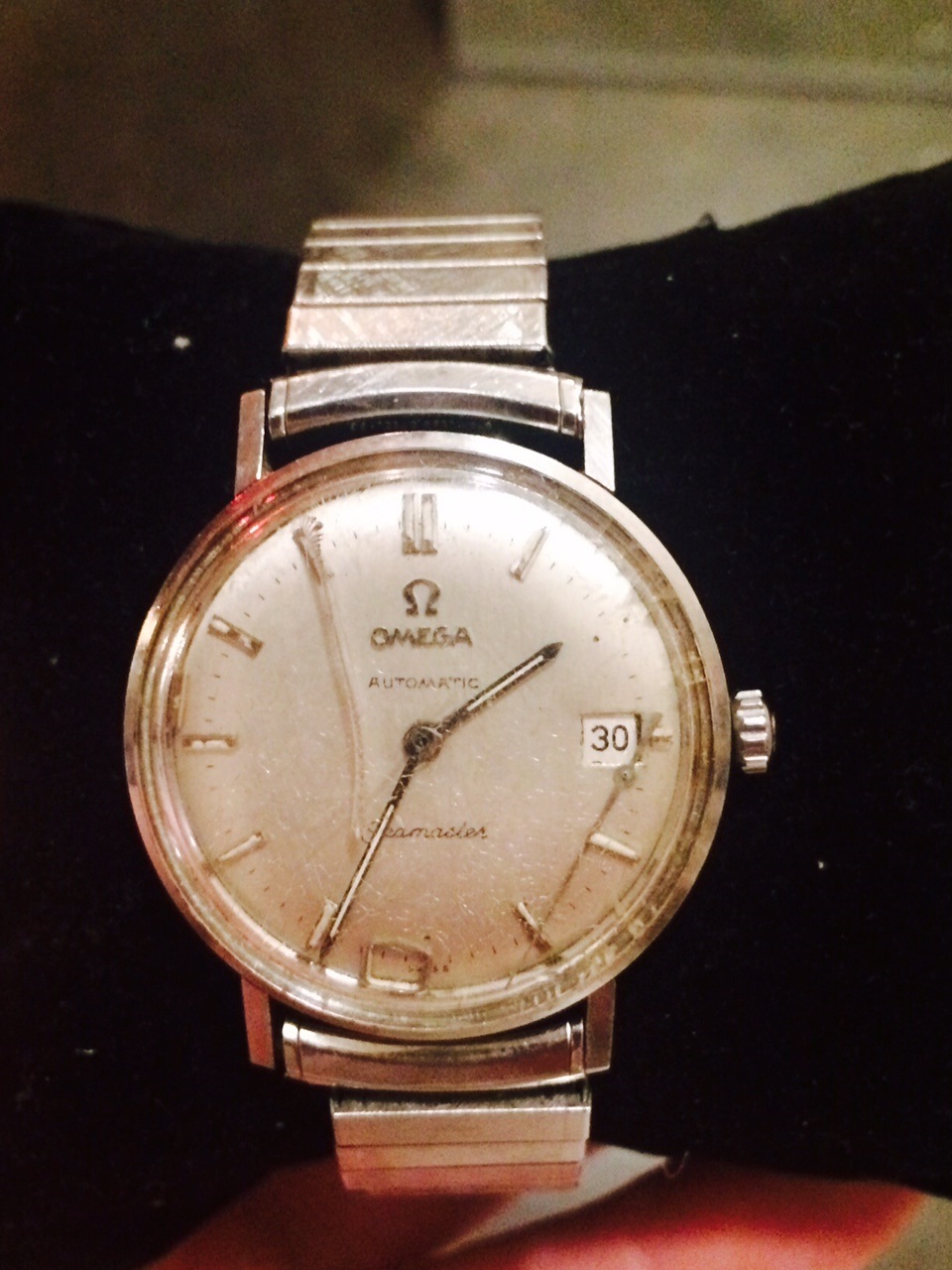

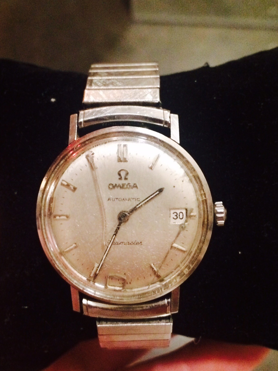

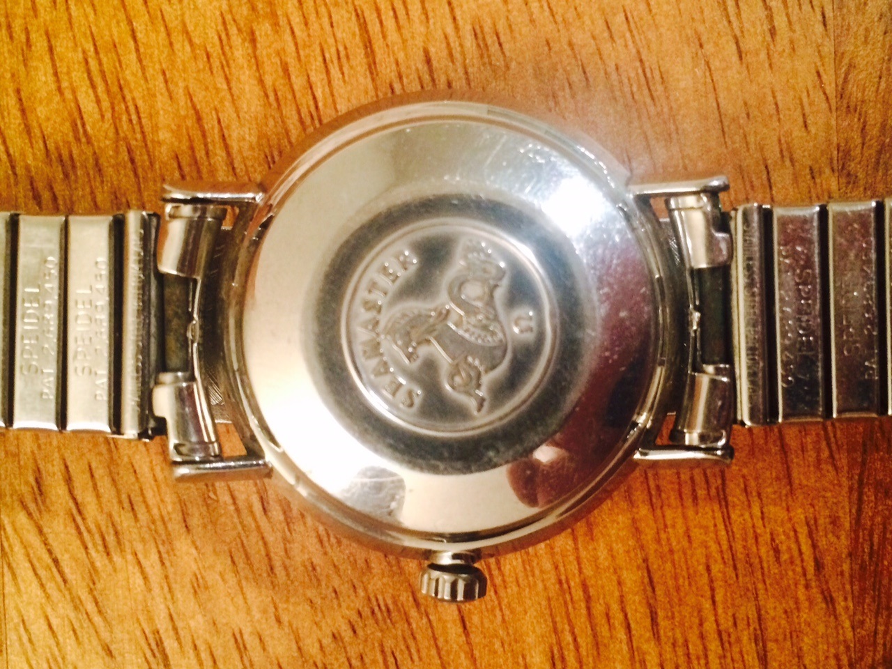

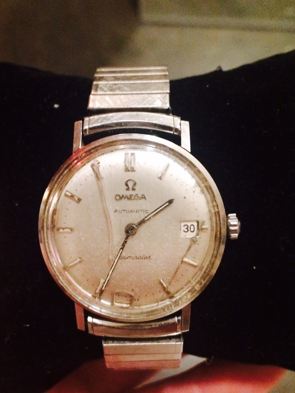

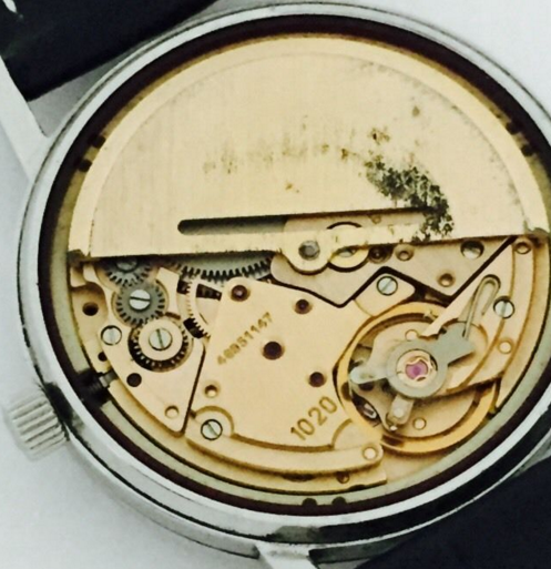

I've had an offer accepted on this watch which would be my first Omega vintage watch and just wondered if people thought its genuine? It looked ok to my untrained eye but I'm no expert!!! There are no markings on the back panel though, but I wasn't sure whether this is a feature of the era.
Thanks so much in advance for your help.

Great forum!

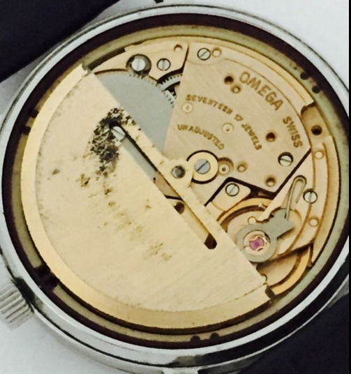

It's genuine, but the dirt/rust/grime on the movement means you should pass on it.

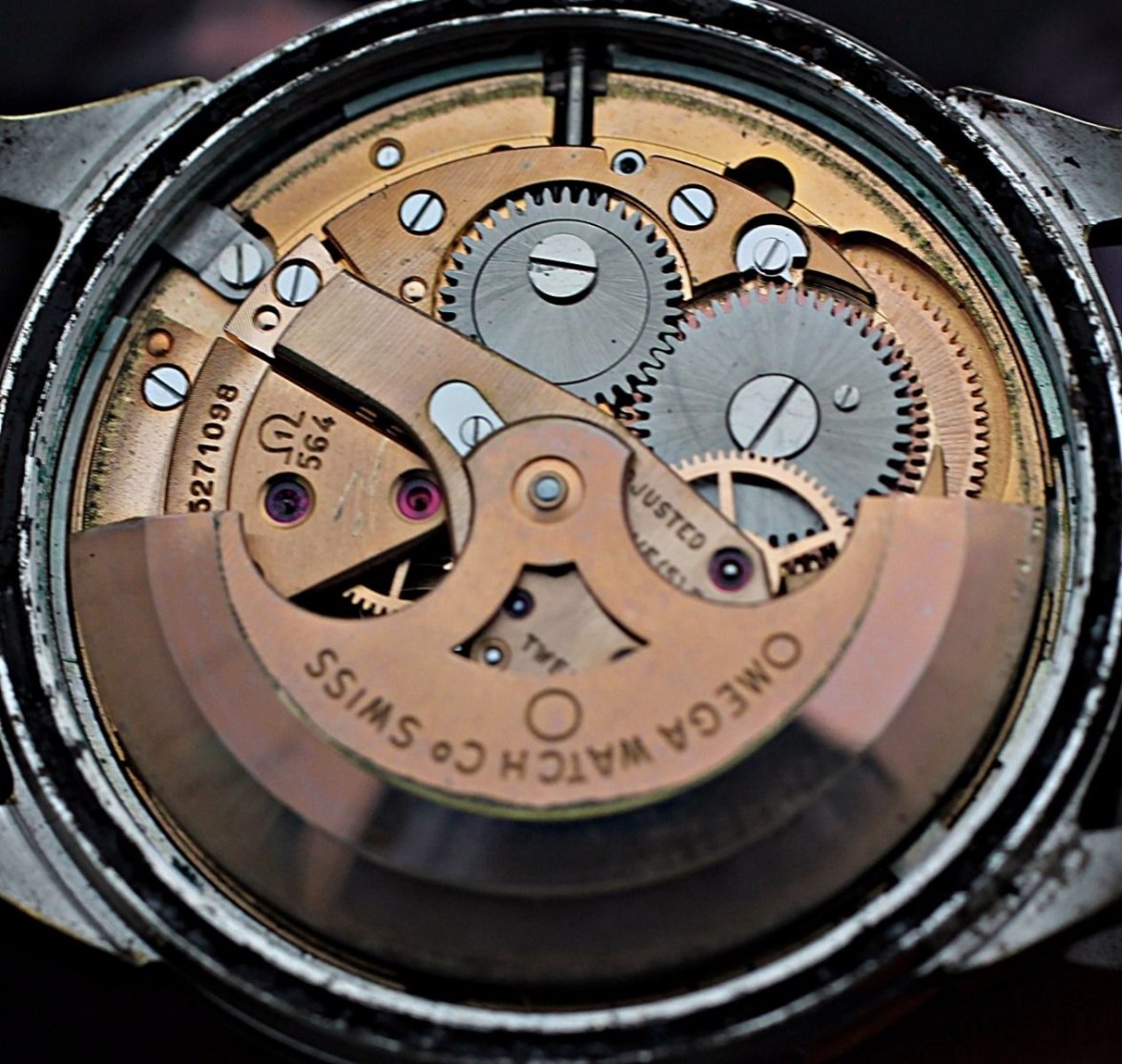

Stumbled across a very old family watch. Trying to confirm if it's a genuine Seamaster before getting it restored. Grateful for any insight this community can offer

Looks genuine, but not in great condition. To be certain we would need to see the insides.

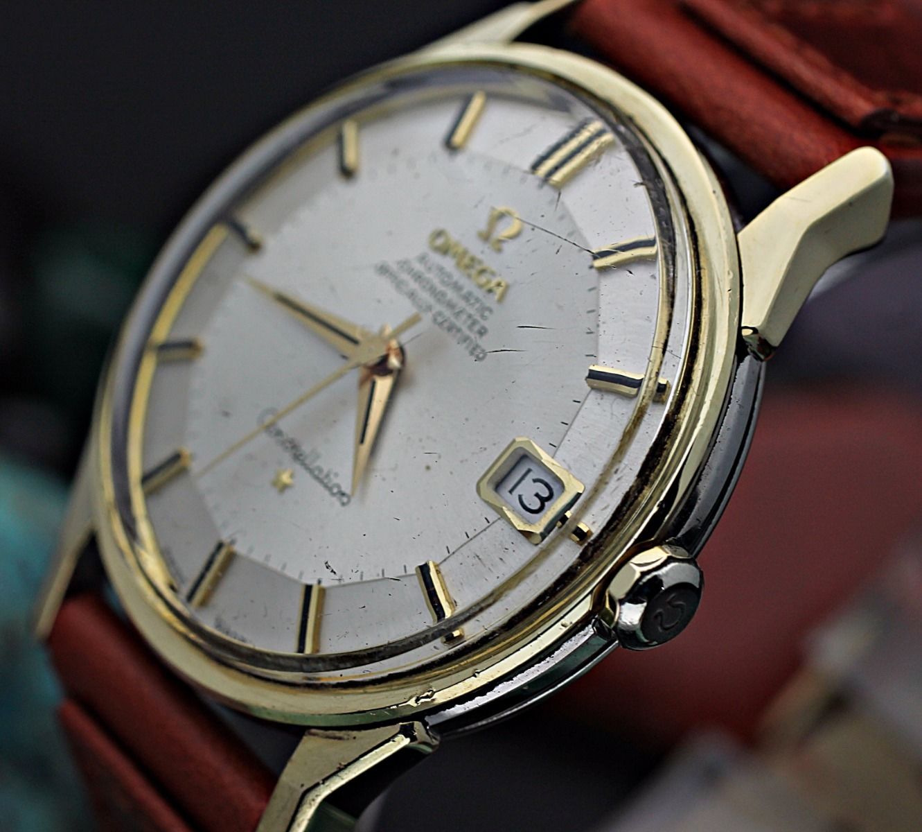

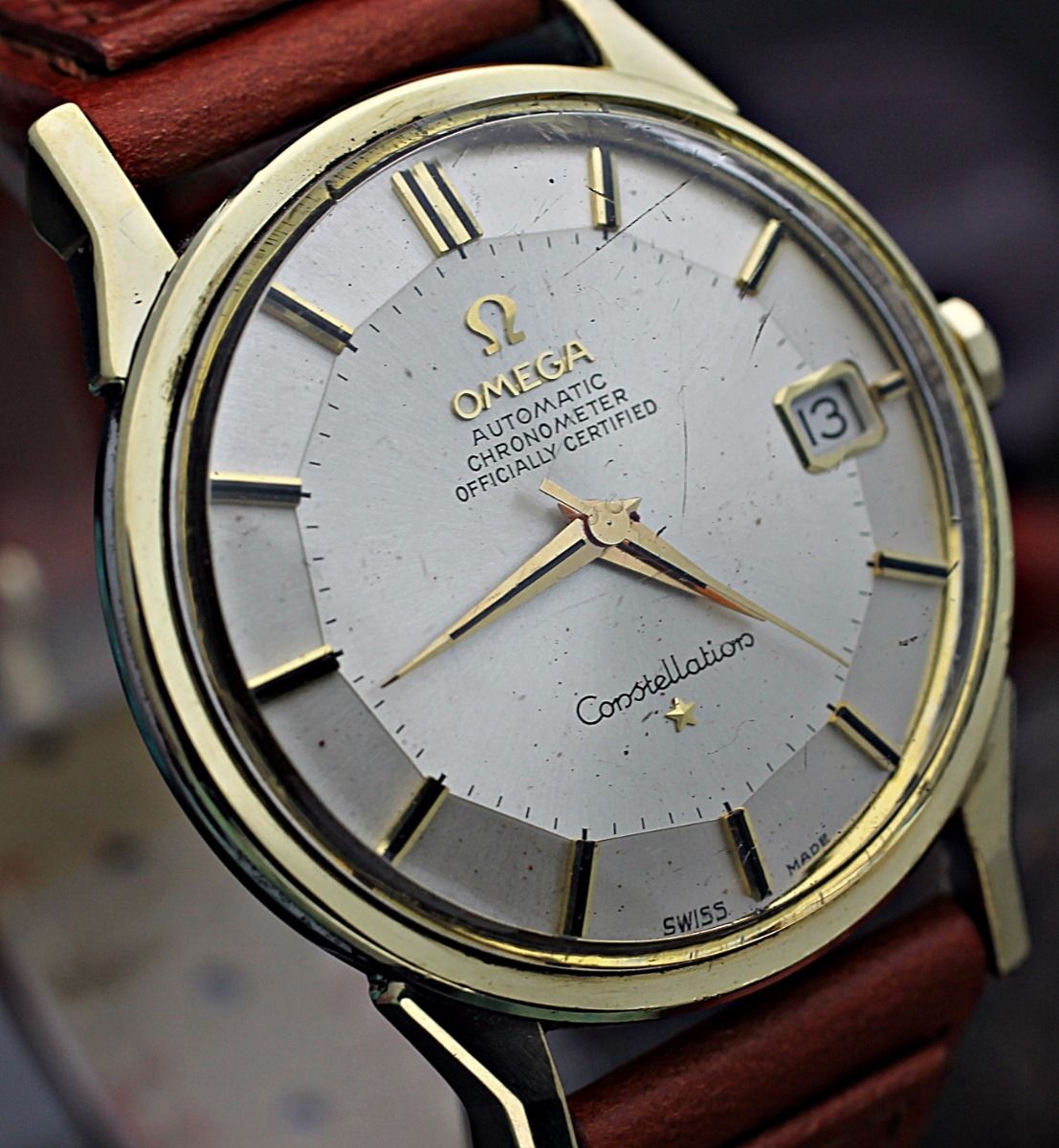

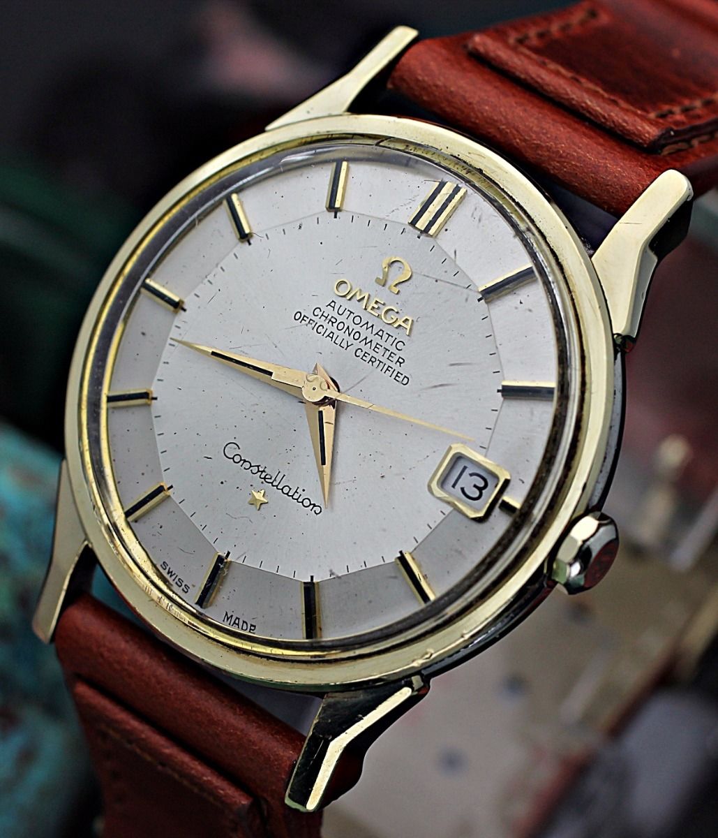

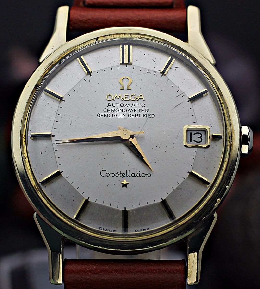

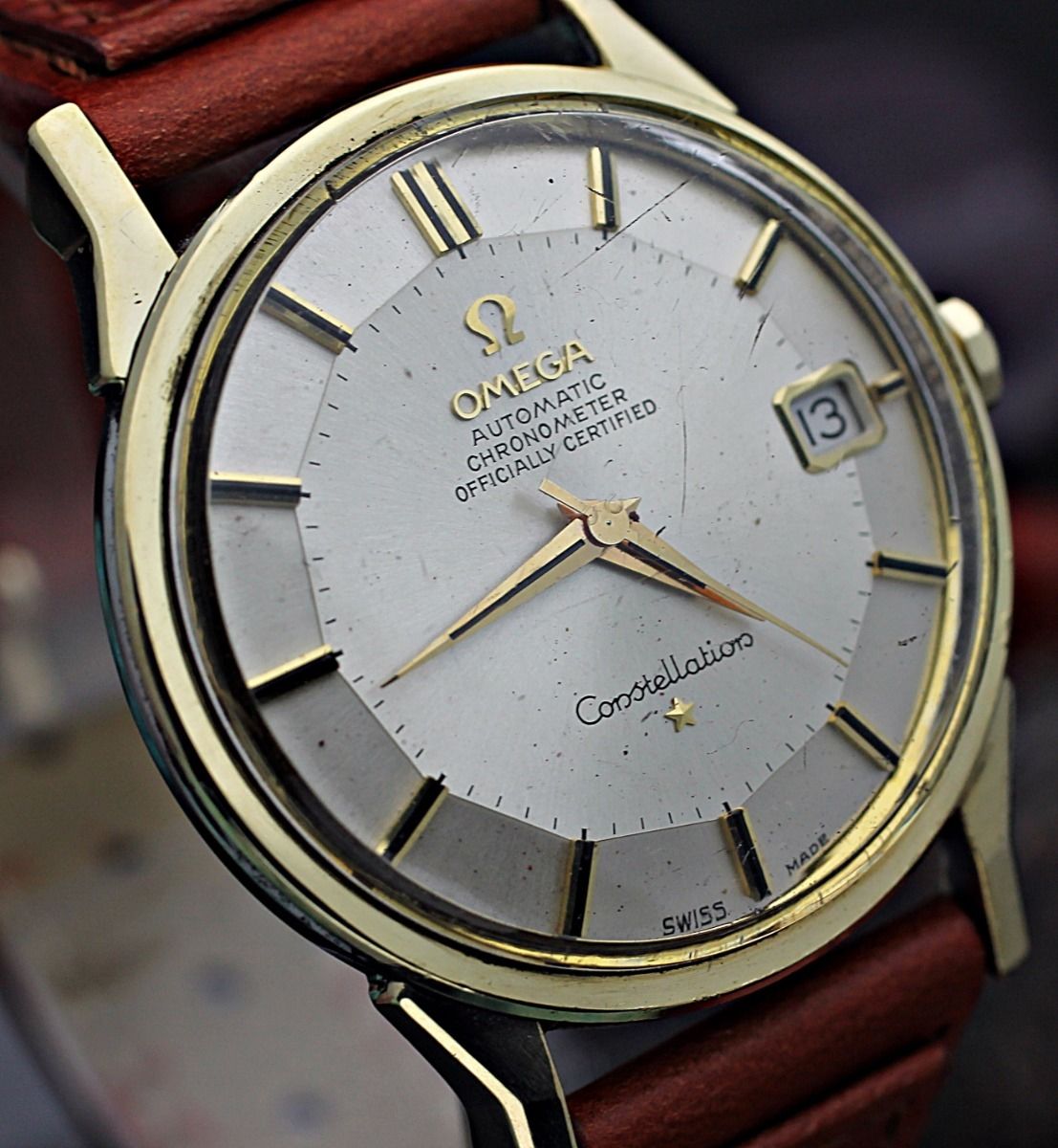

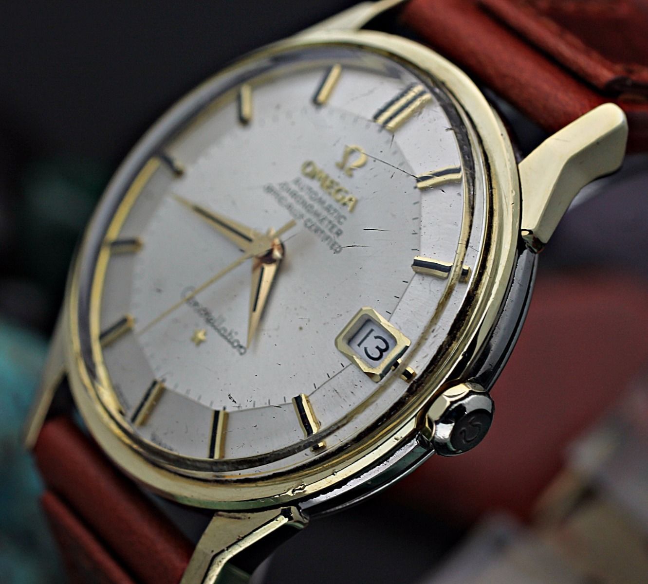

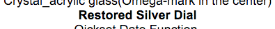

In fact I saw it. But what does it mean? English is not my language, but "restored" means recoloring it like when it was new? And my question is, is there a Omega constellation that looked like that when it was new. Or did they completely make it up? most electronic Omegas seem to have a red Omega logo.
8,701
14,612
It means you couldn't find one that looks like that because someone repainted the dial to look that way.
