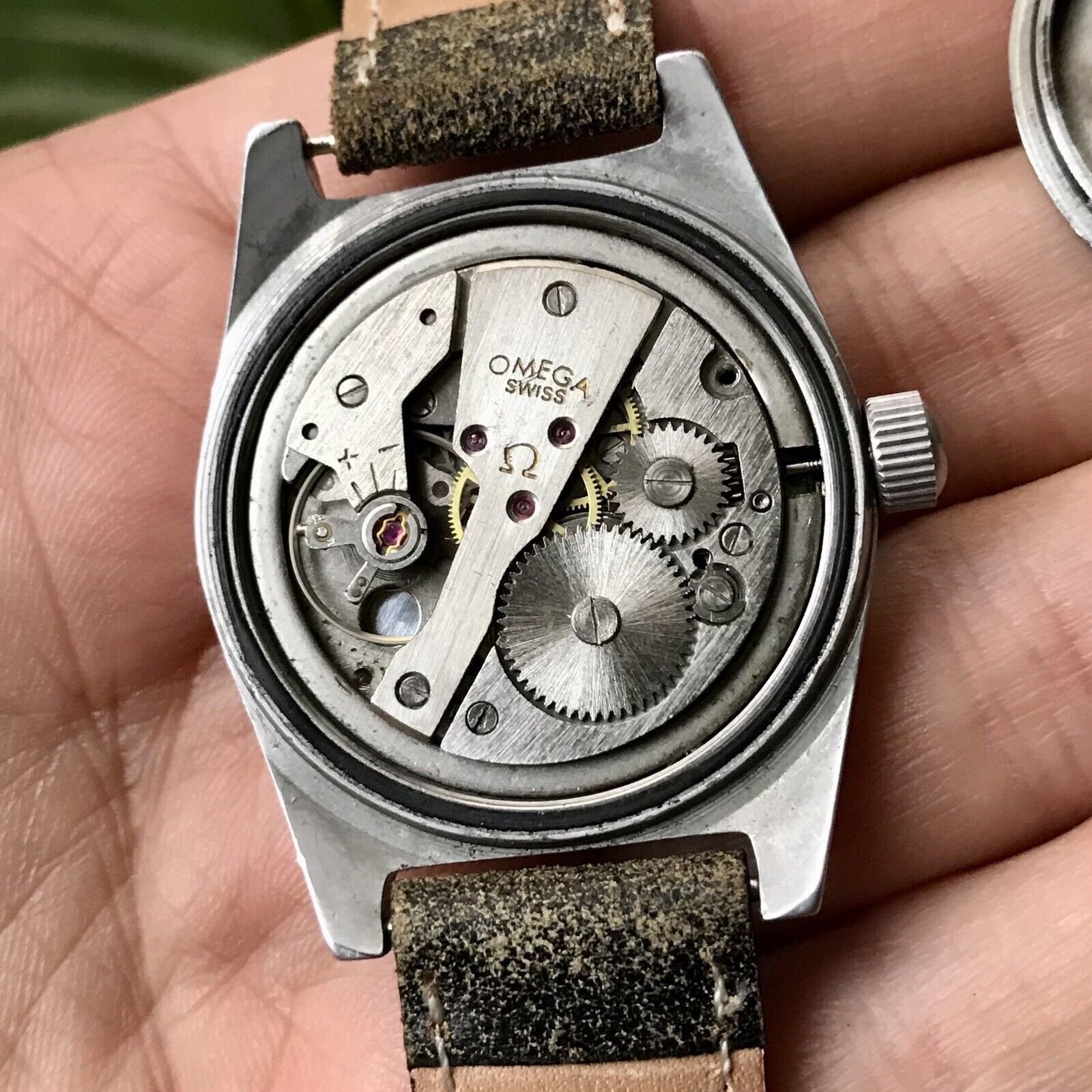

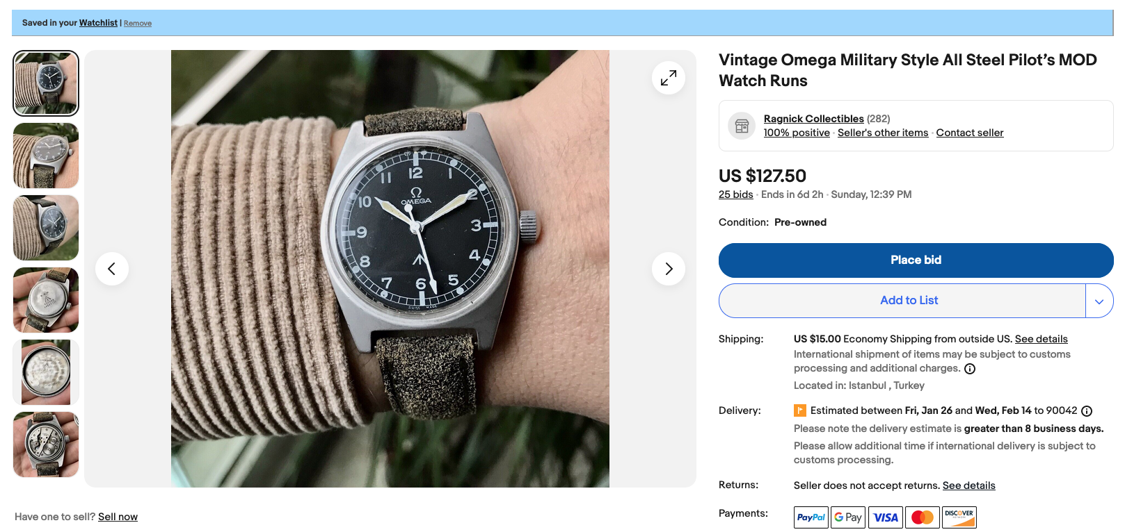

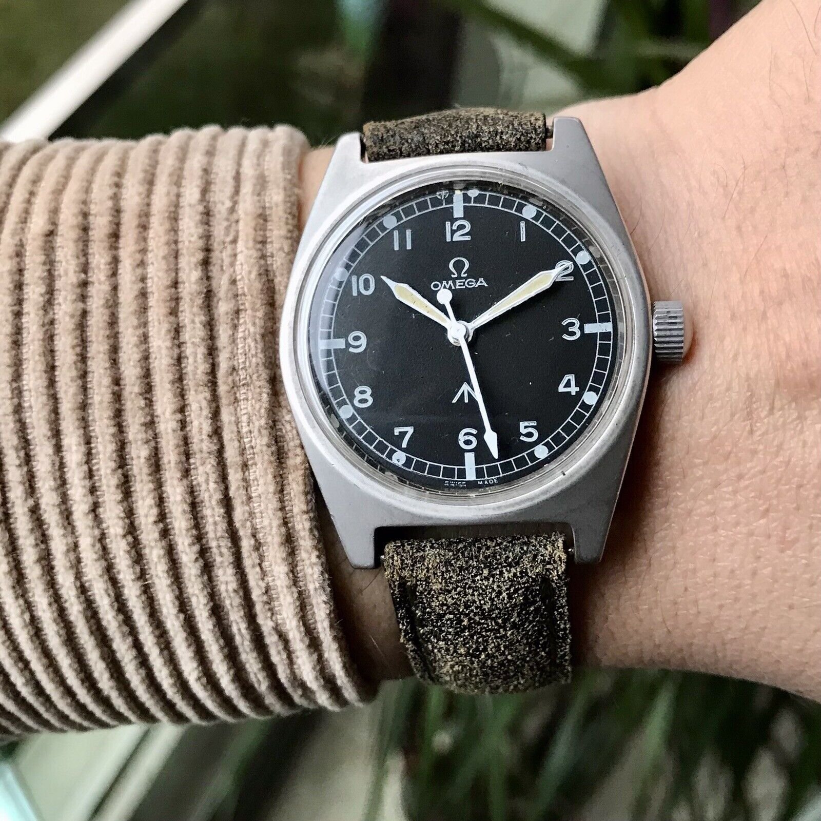

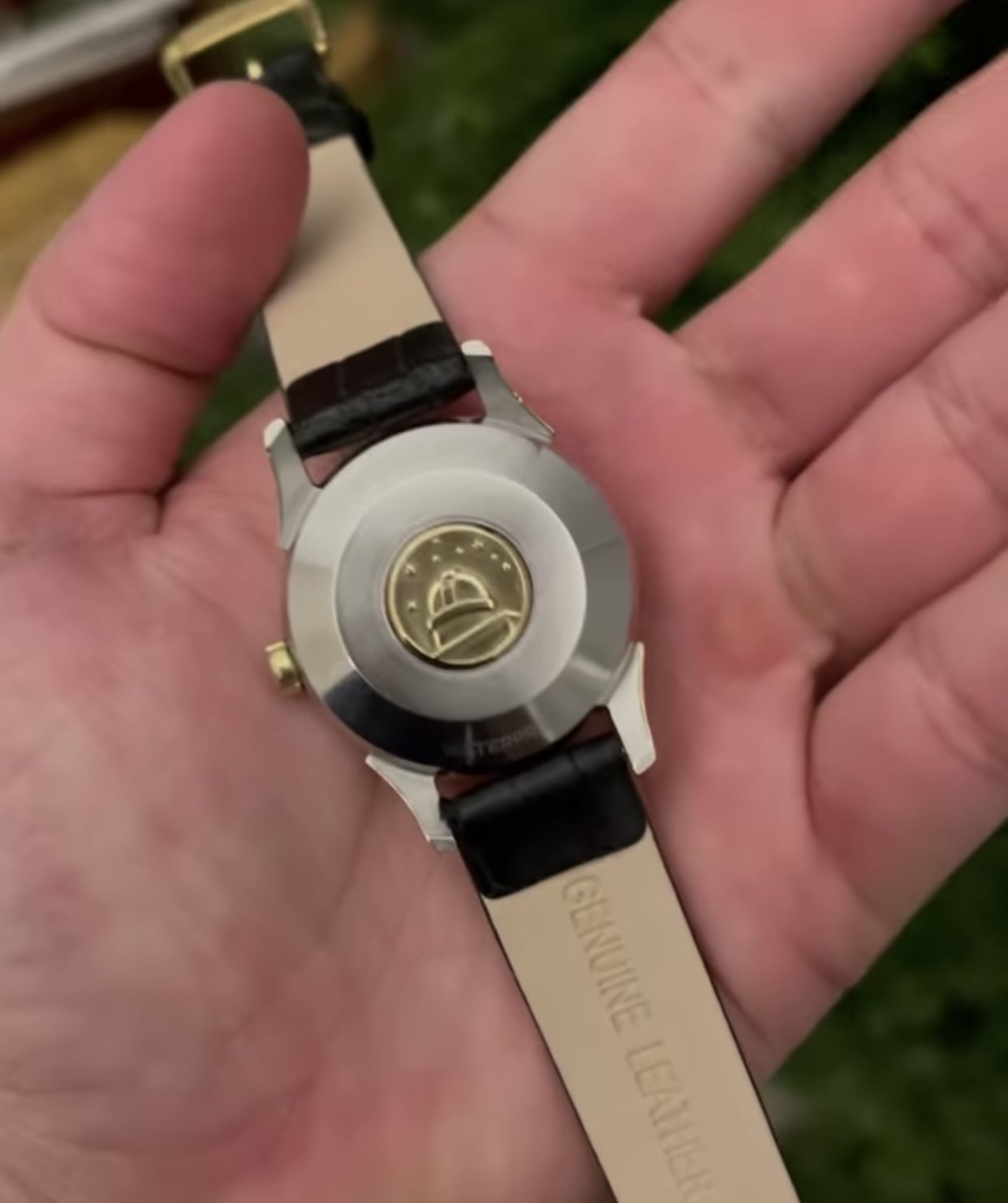

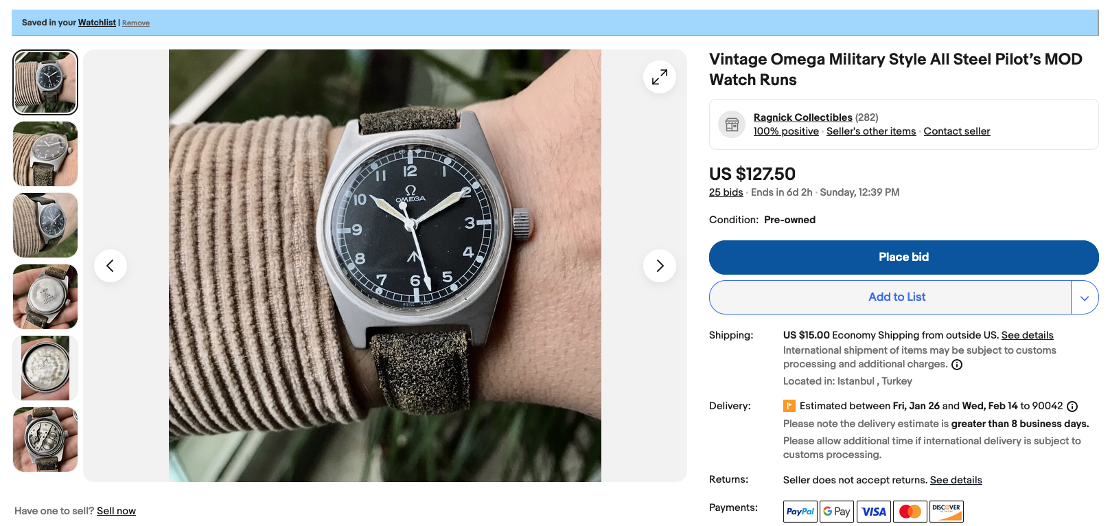

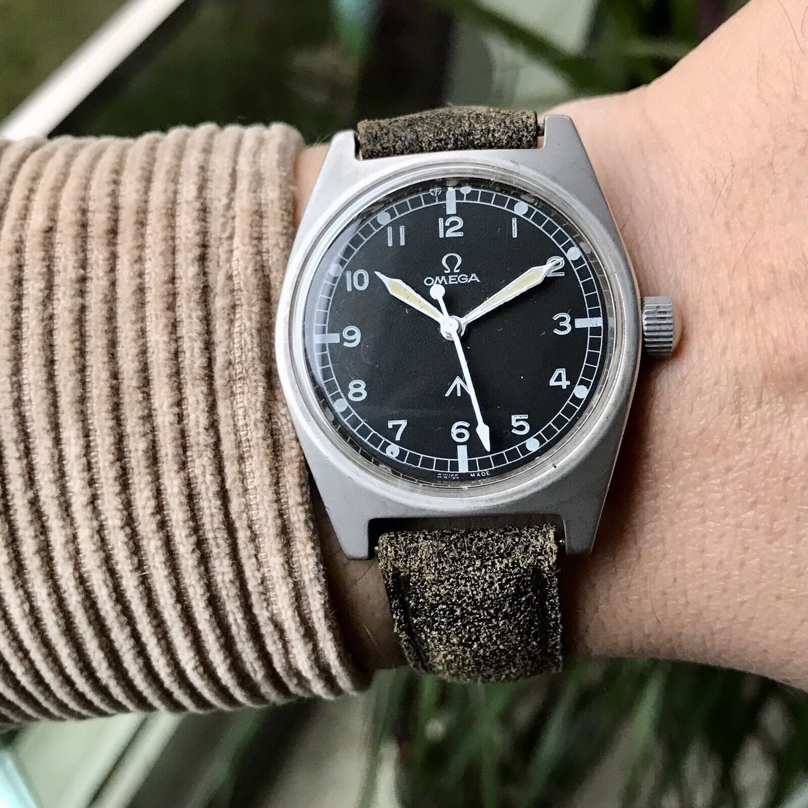

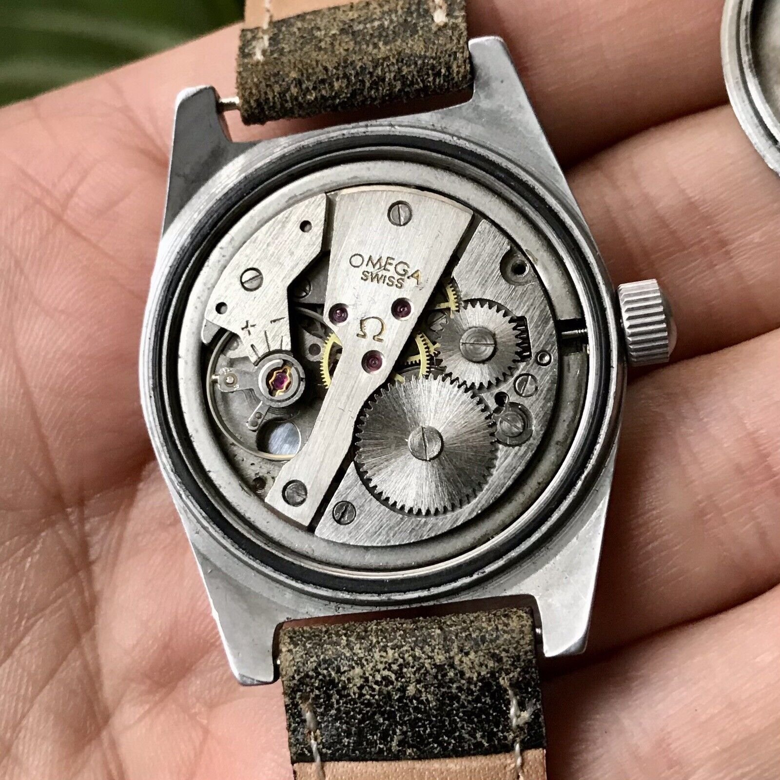

Here's a lovely piece, multiple bids and days to go. Yes, I have reported it.
Has some special features too:
"The vintage watch also comes with a variety of features such as a seconds hand, 12-hour dial, and push/pull crown".
4,526
11,140
Is that a French Savoy movement from the late 60s?
3,019
4,791
AS1130 it is a nice, and can be very accurate, movement hehe. That one looks in nice shape.
AS parts are still fairly cheap and available. I have sort of grown to like them as practice watches. They however do not belong in Omega cases or with random graffiti on them.

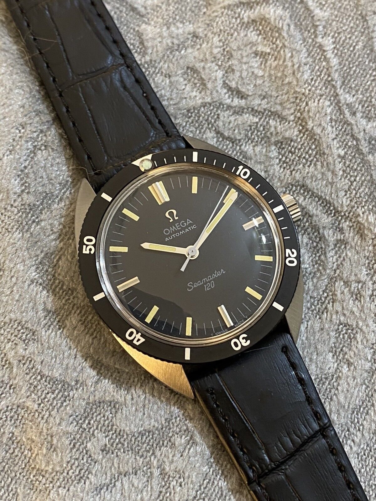

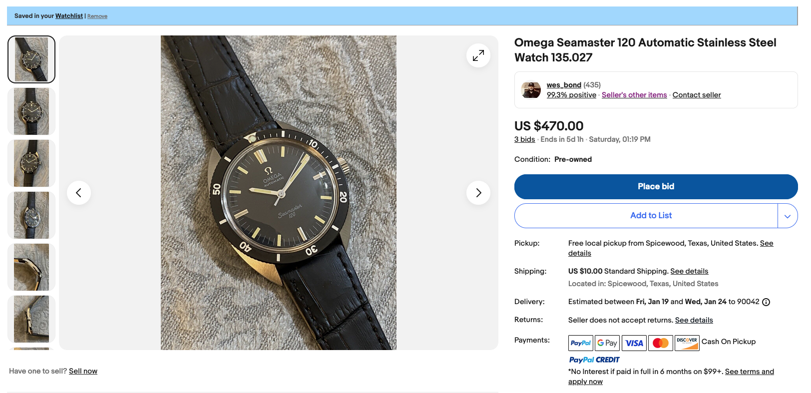

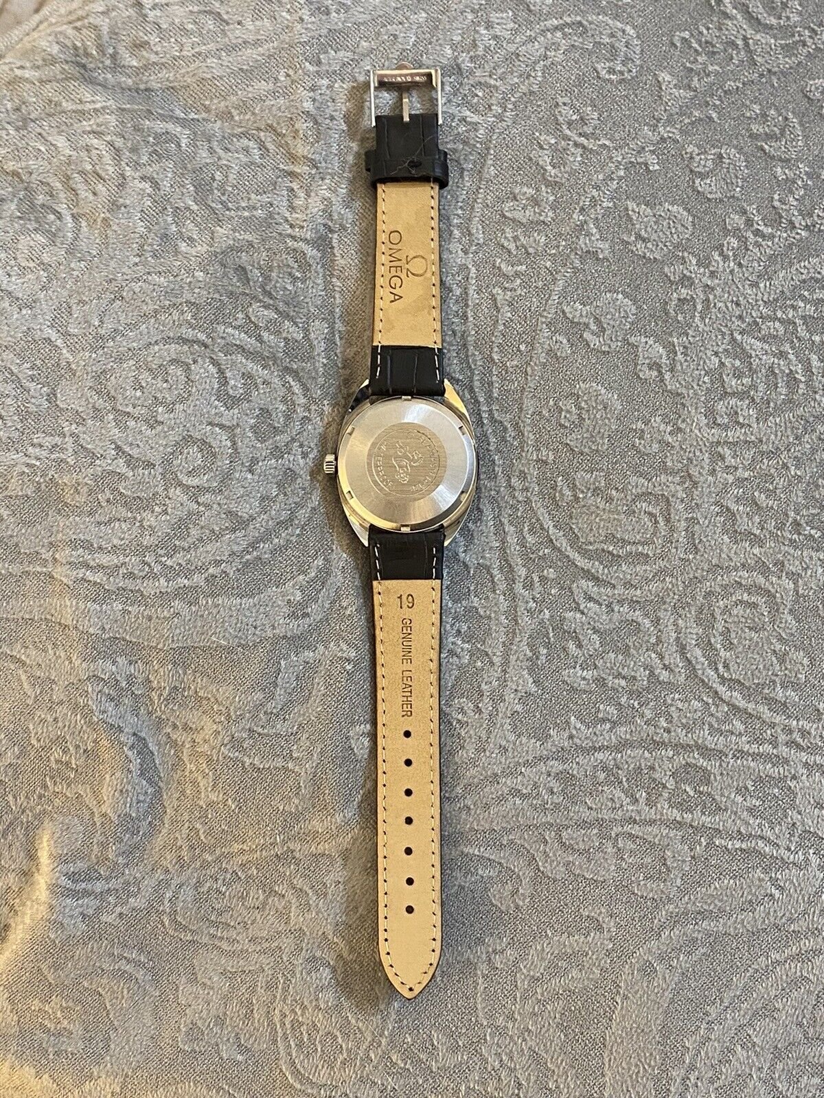

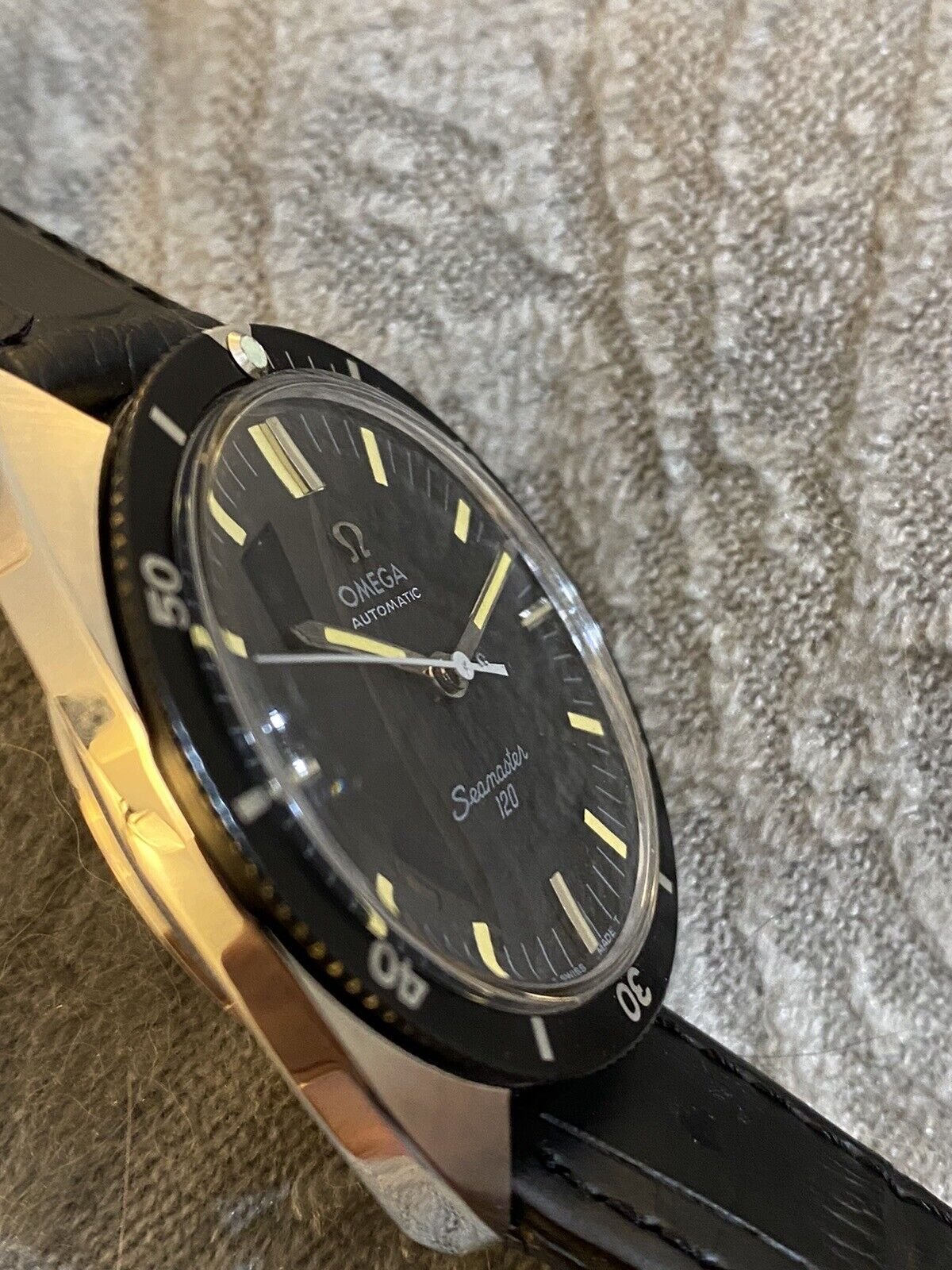

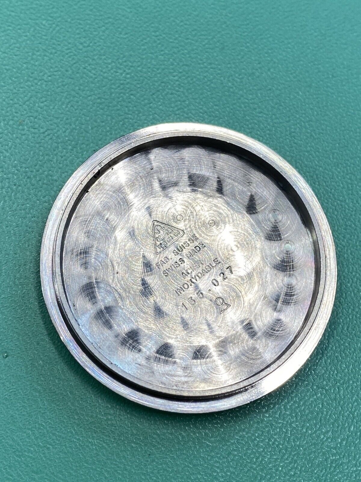

More fake shit on eBay.
Special automatic 135.027 🙄
Reported.
13,508
31,852
Now gone, eBay usually listens to fake reports.

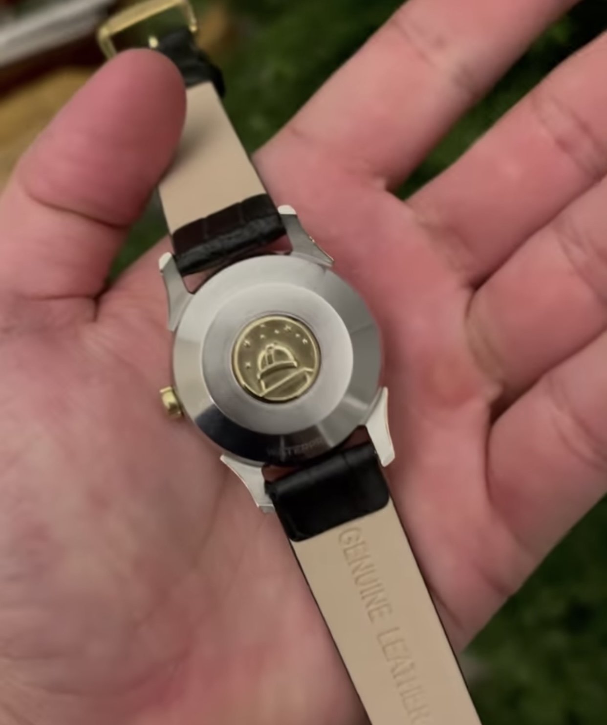

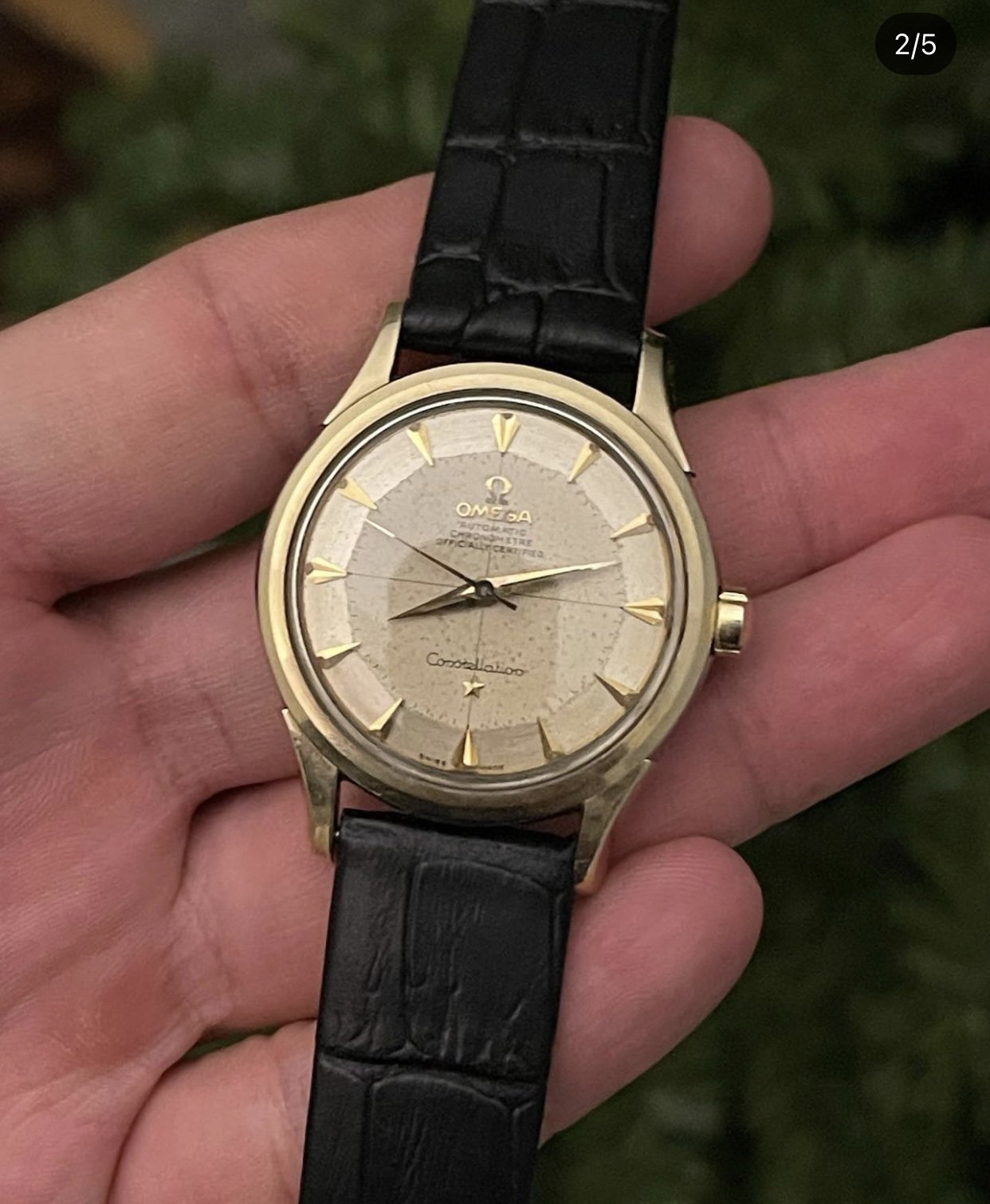

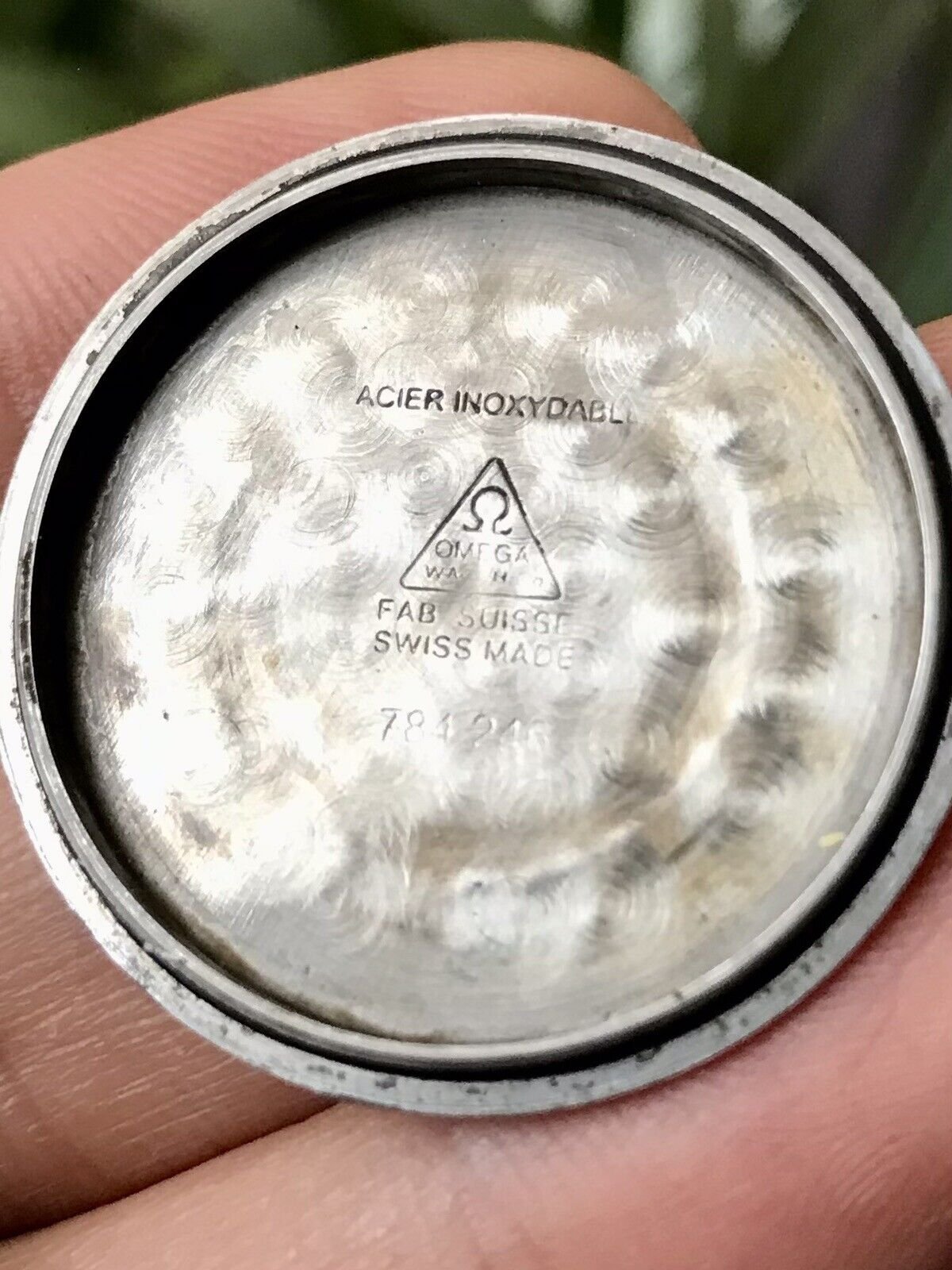

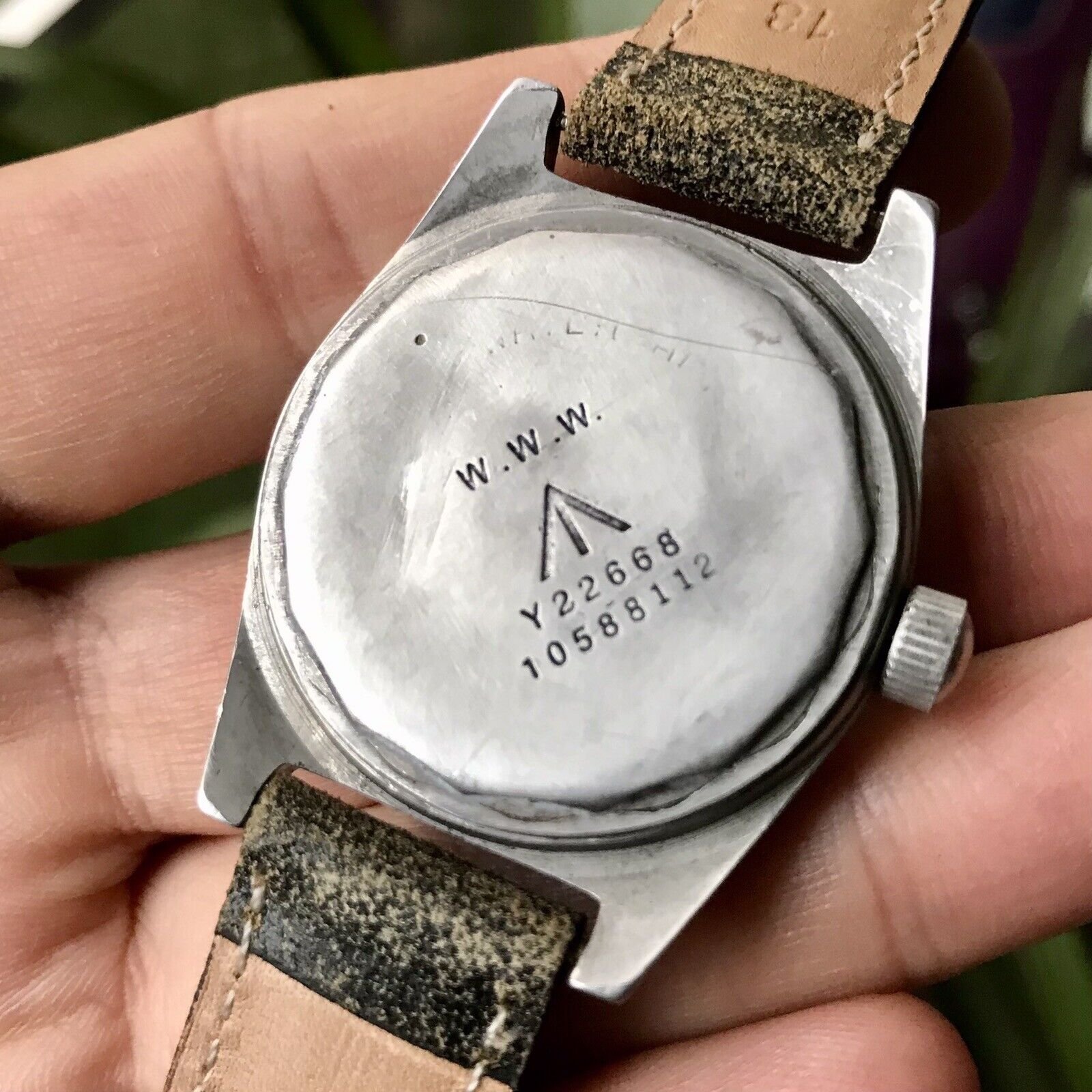

What do you think about this ?
13,508
31,852
This is NOT a thread for questions, did you not read the title for the thread?

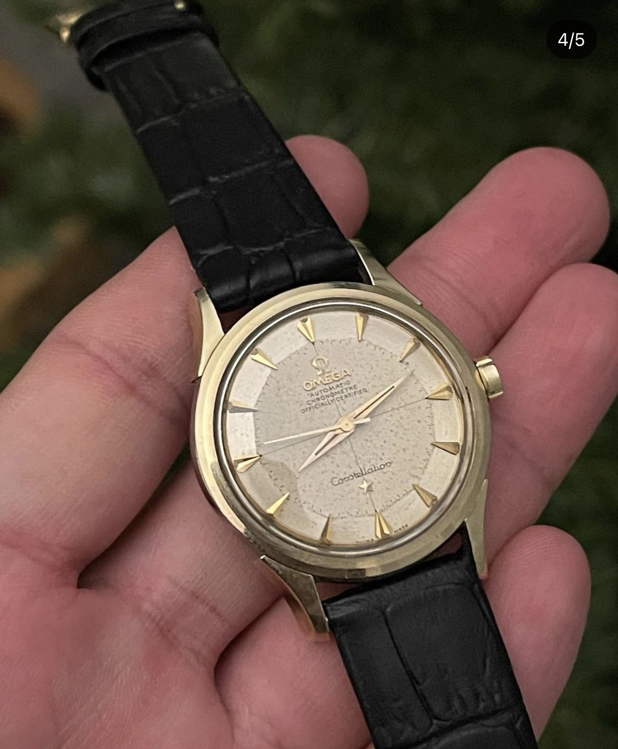

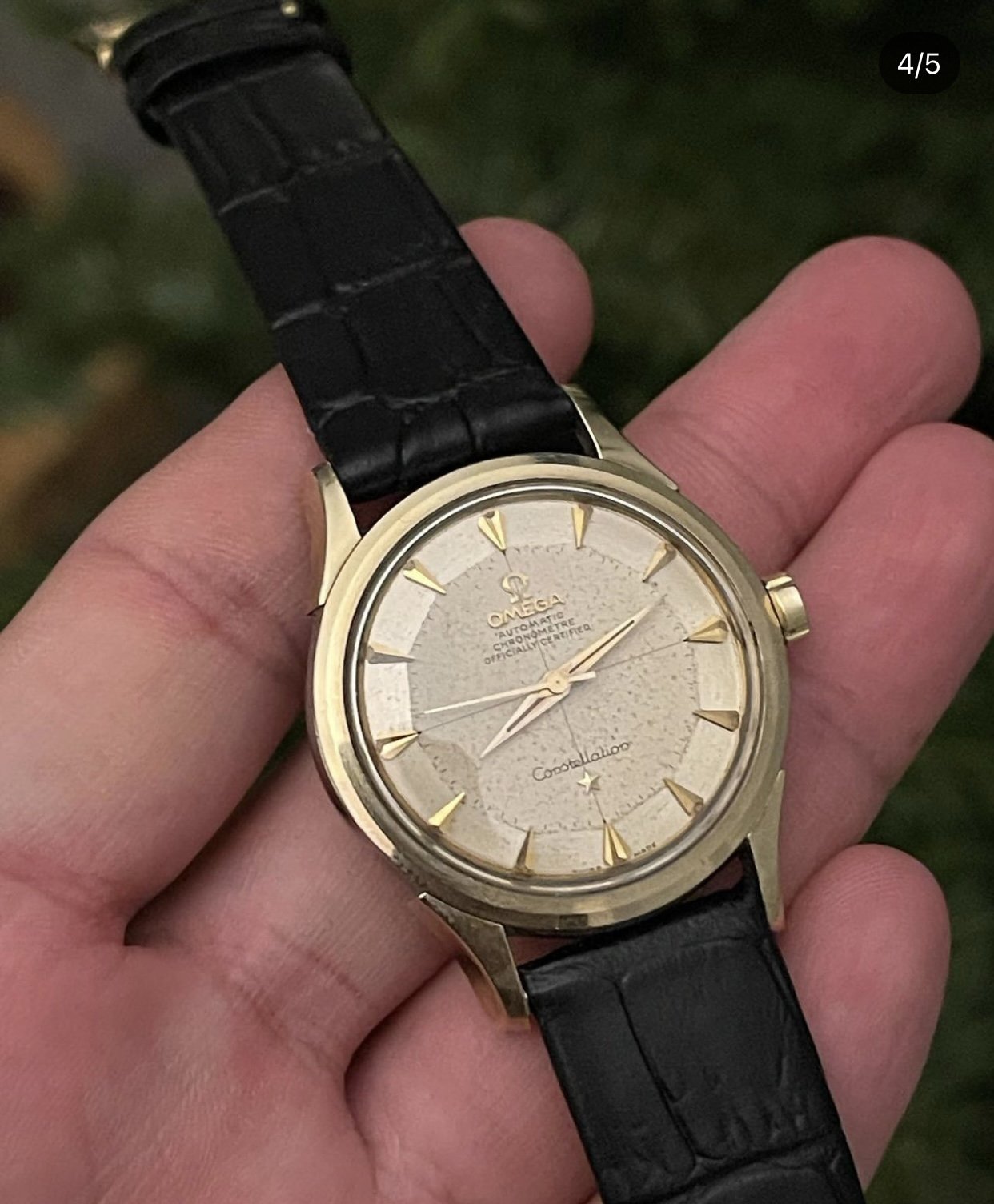

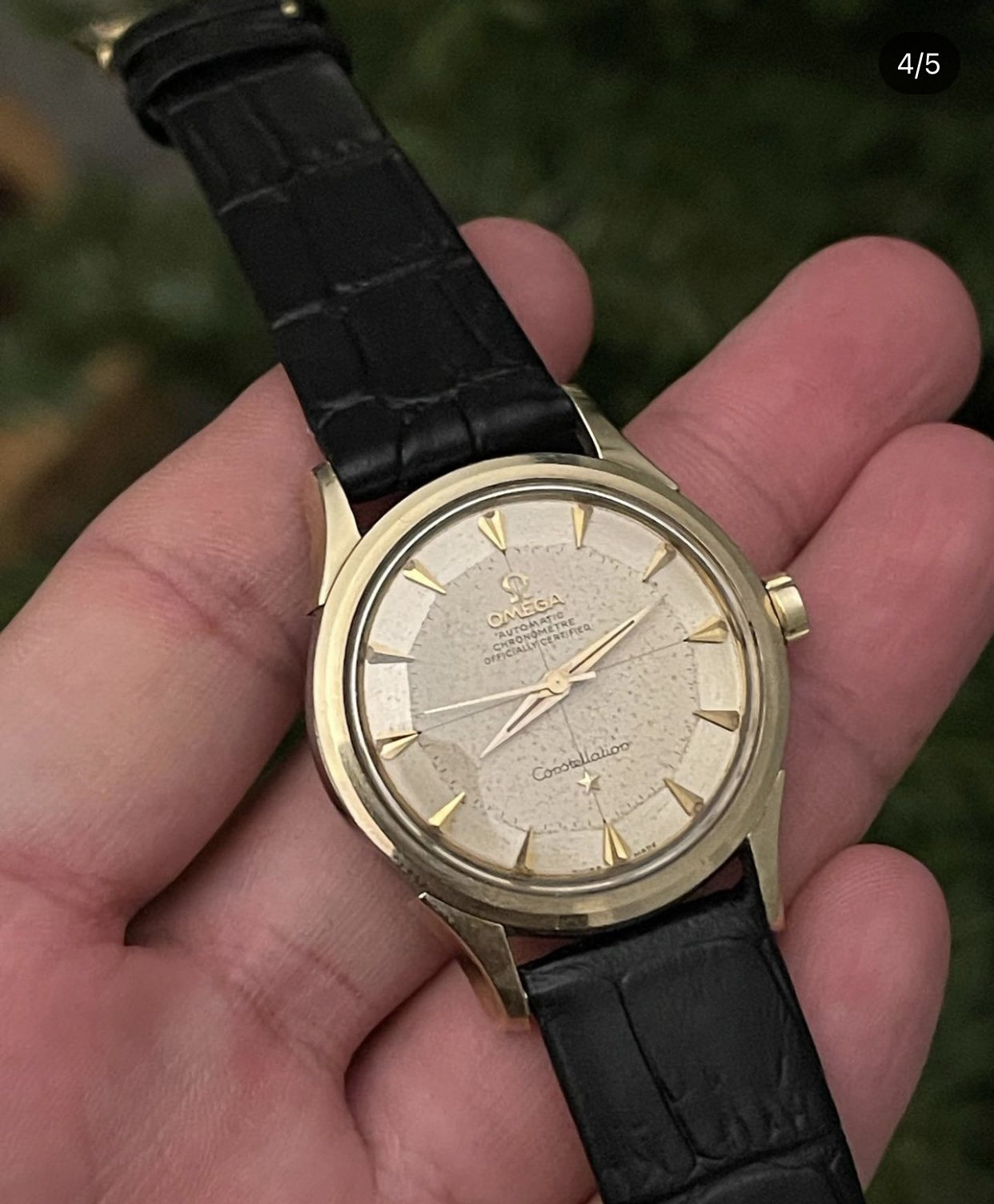

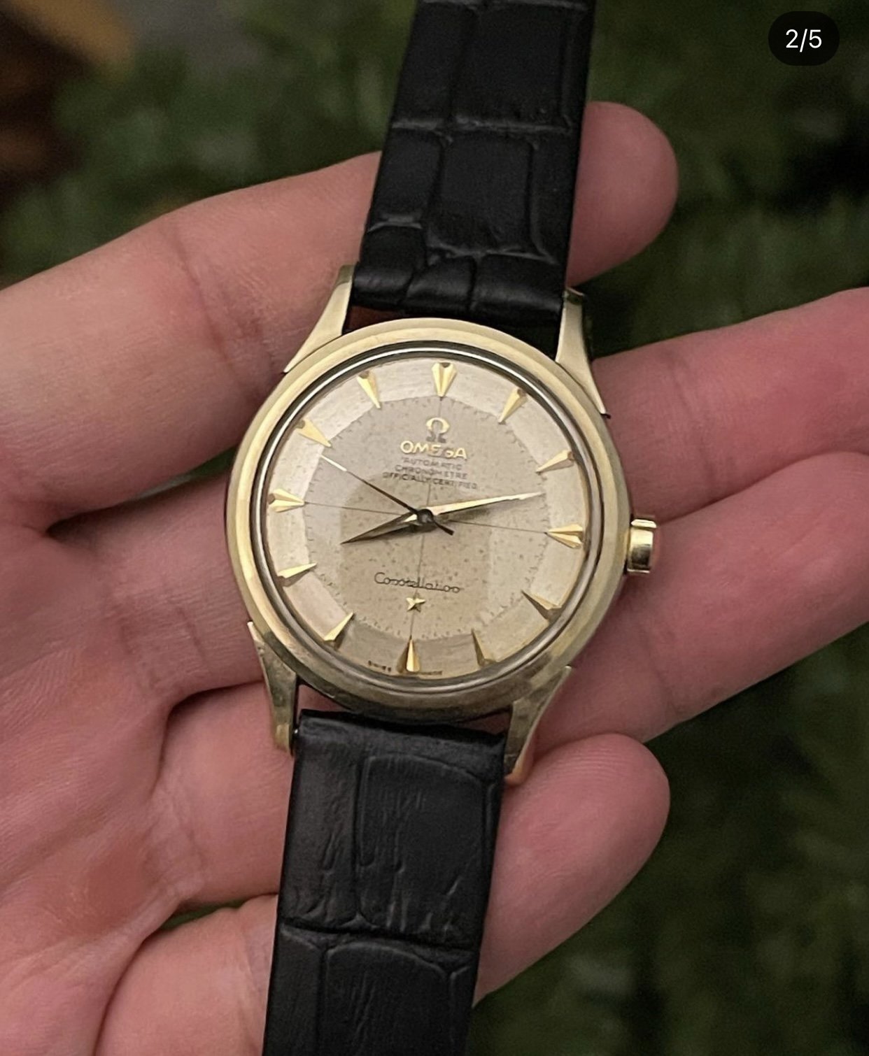

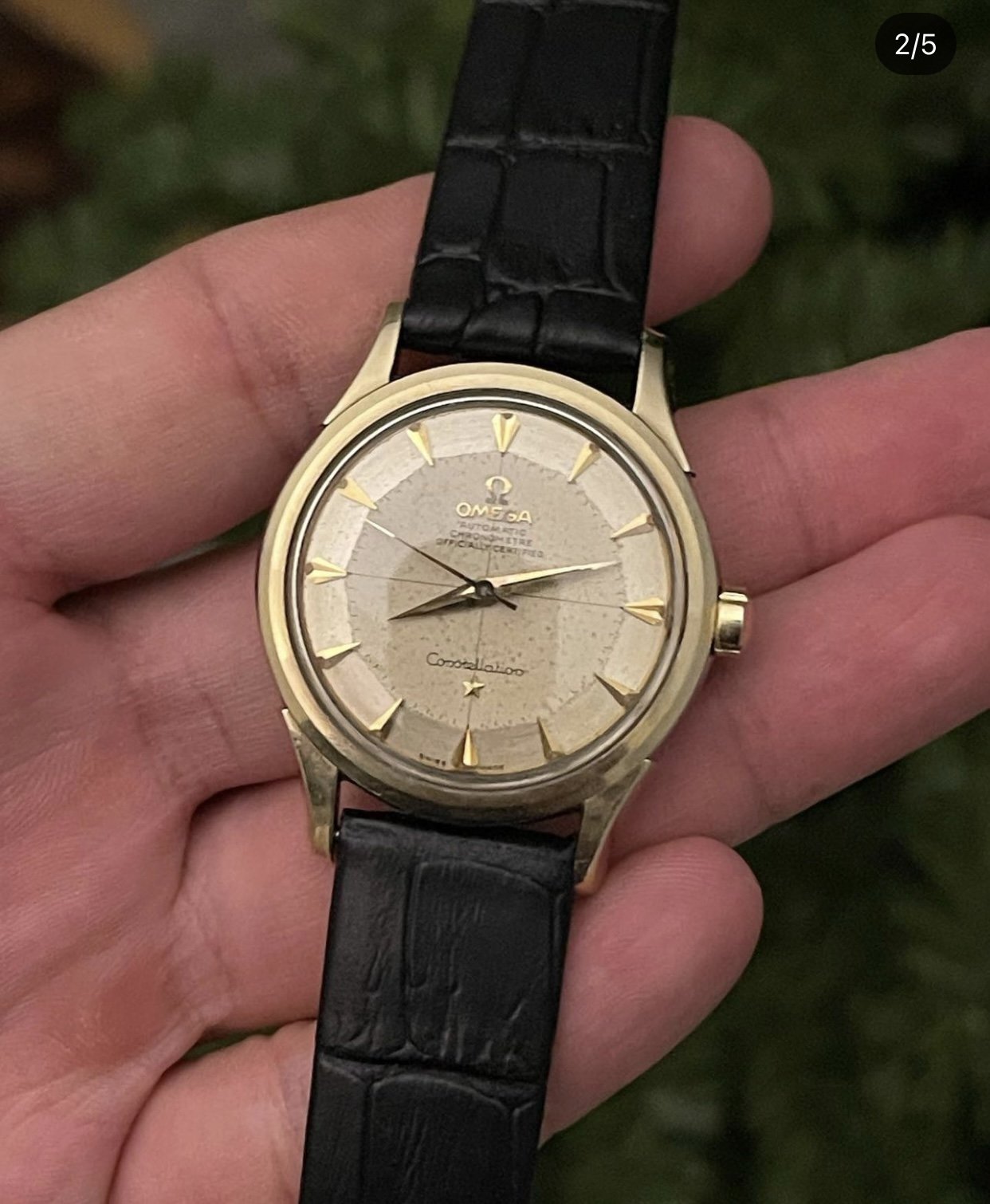

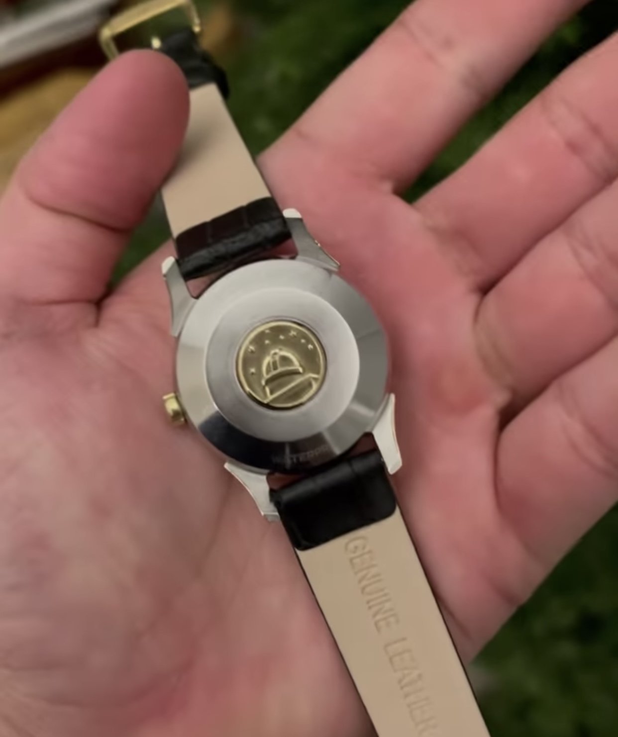

Laminated Omega Pie Pan Constellation 1956
Perhaps English is not your native language?
THIS THREAD IS NOT FOR ASKING QUESTIONS!!!!
13,571
23,563
So this means it’s not fake?
This thread is for people posting warnings and to report known fake watches. If you’re unsure whether yours is fake or not, please start a new thread in the vintage section asking for help.
23
Thank you David you are very kind, sorry for the spam.

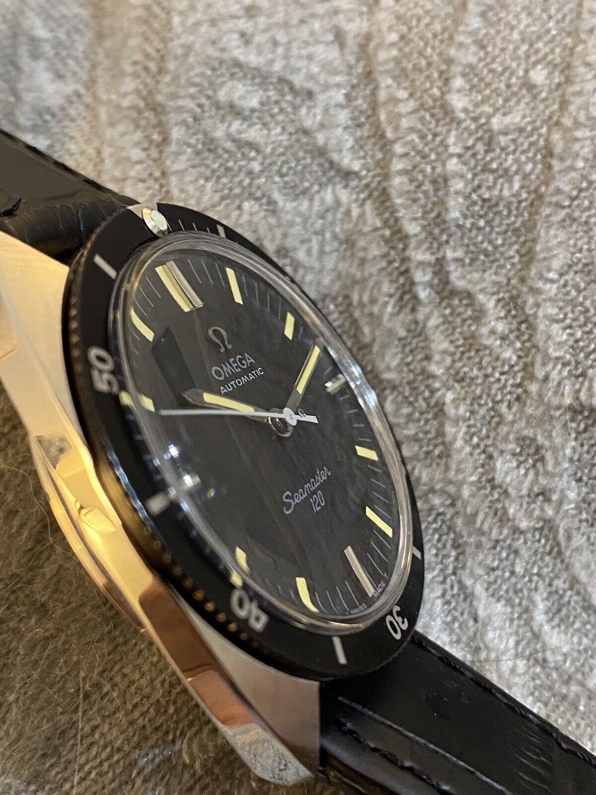

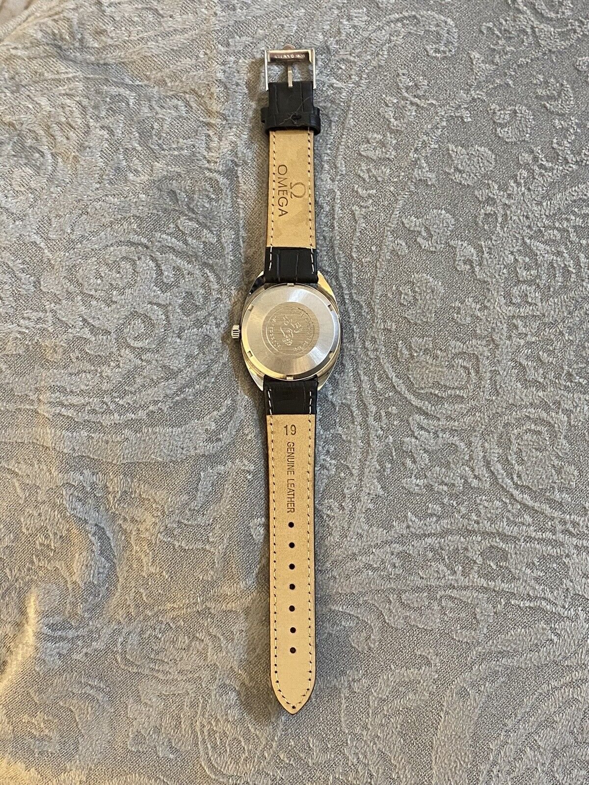

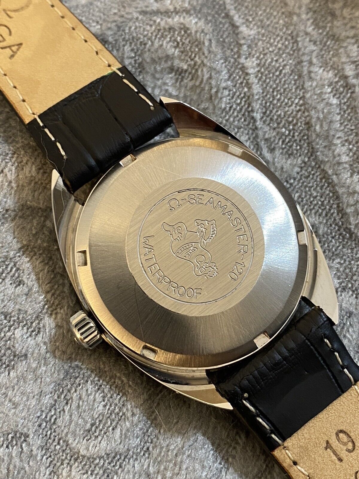

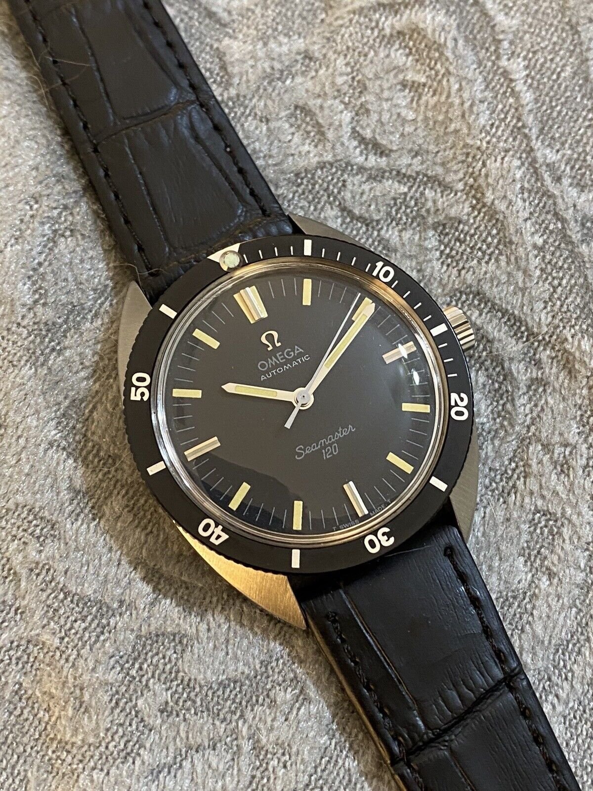

Just received an offer to buy this piece of... you call it. I'm just starting with Omegas but thanks to the Omega Forums and this thread in particular, I noticed something's wrong here. But honestly, my first concern was this uneven Ω symbol that is literally touching 12pm stick.
Also, haven't seen "Antimagnetic" anywhere. Where does it come from and are there models that write it on the dial?
file.php
file.php
file.php
file.php
file.php
file.php
file.php
6,609
26,784
Hi, the purpose of this thread is to post known fakes and as the title states, it is not for questions. Edit: it is very fake and not worth asking about.
8
Hi, the purpose of this thread is to post known fakes and as the title states, it is not for questions. You will want to create a new thread in the vintage section 👍
But I know it's fake, that's why I post it here
