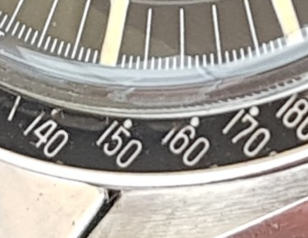

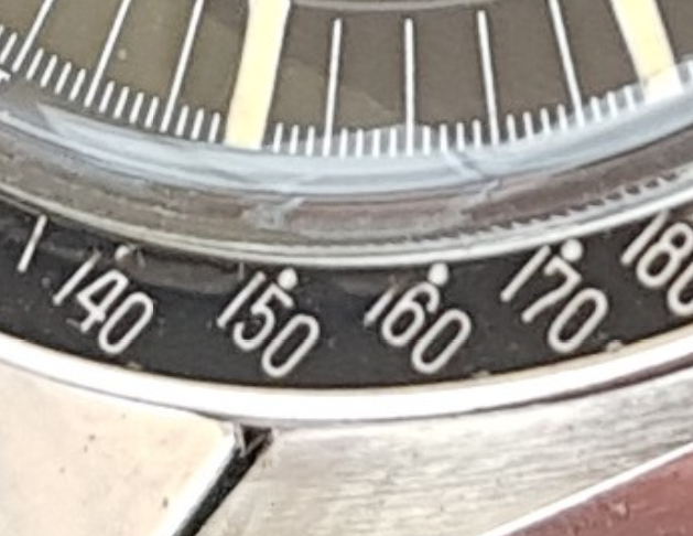

I was just perusing the bay and came across the following listing
https://www.ebay.co.uk/itm/1968-Ome...465544?hash=item2889ac5988:g:JfsAAOSw25Vd3l8s
Immediately I thought, that looks like a mint DON. Compared to my own DON it looks very neat, none of the numbers touch the outside edge and I鈥檓 not sure if I can see a serif on the font. I鈥檓 guessing there is a huge variation in these, but can you get one this consistent?

Thats a fake don.
That was my feeling. It won鈥檛 be long until these are spot on 馃檨 perhaps some are already. Be vigilant guys!
567
1,112
The font looks sans serif
The font also looks a little heavy
I鈥檝e not seen a DON with that much room (black area) to either side of the numbers
There is a very similar (badly aged) custom/new DON available on eBay
It looks more like DNN with the dot moved
I鈥檓 sure others here can spot many more issues

the 80 is the dead give away it is a fake (dot is not centered).

For posterity, here's the eBay watch:
@Spacefruit's thread on https://omegaforums.net/threads/antiquorum-fake-bezel-aq-do-the-right-thing-good-for-them.90477/ has a nice side/side comparison of a different couple of fakes, and the real thing.

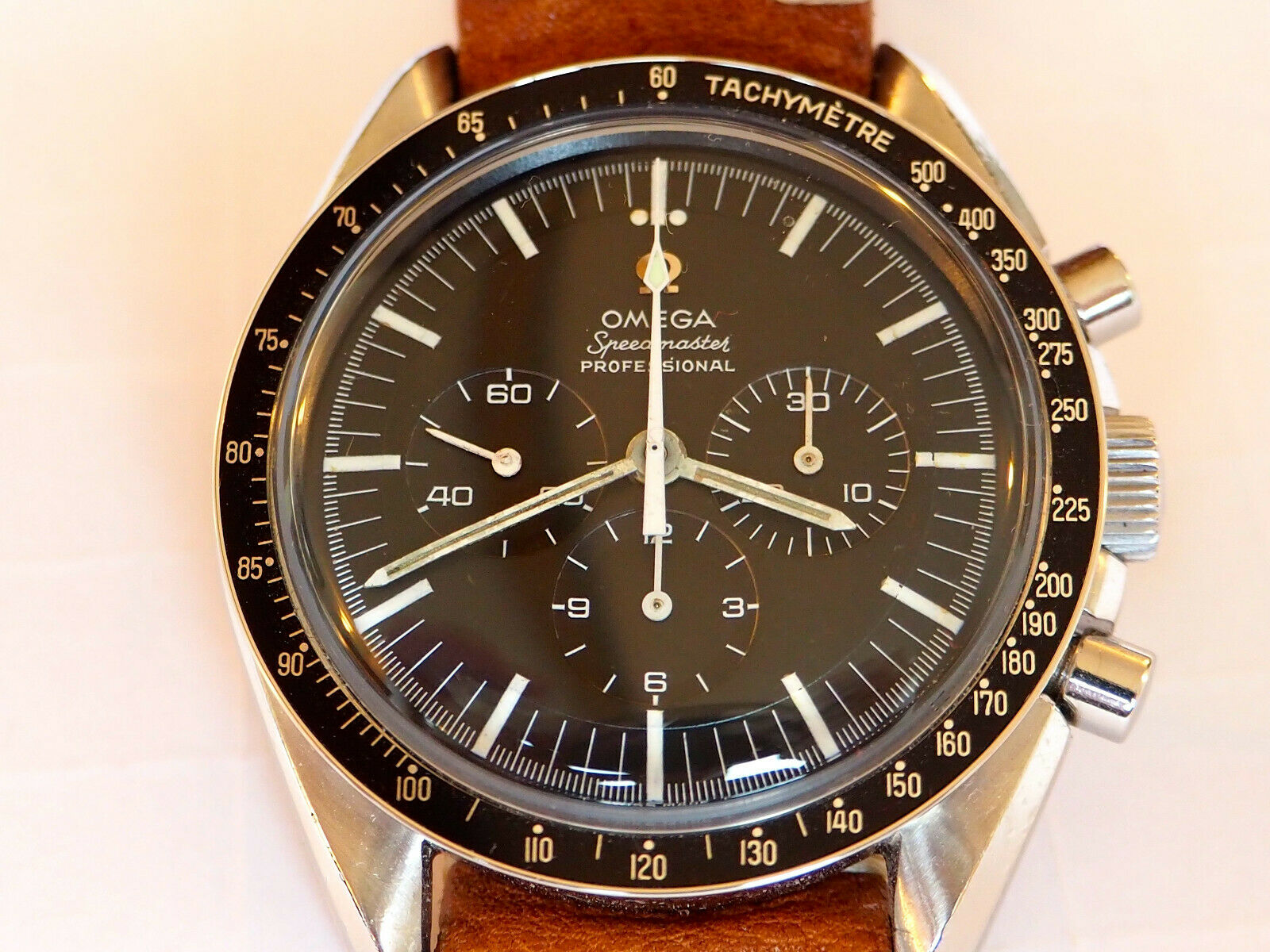

Looking at the eBay watch above, the spacing of the dots and the numbers is off in a few places - look at the 5 in 150 for example - here's how it should look:
...and the relative weight of the dots and numbers is too much as well, I think. It's a bit scary how convincing these things look until you start going over them with a fine tooth comb.
319
558
Numbers too heavy. Always look for the serif in the center of the 3. It's missing here. Agree with all above. Original DONs the lettering is always very sharp and the serifs present if subtle.
