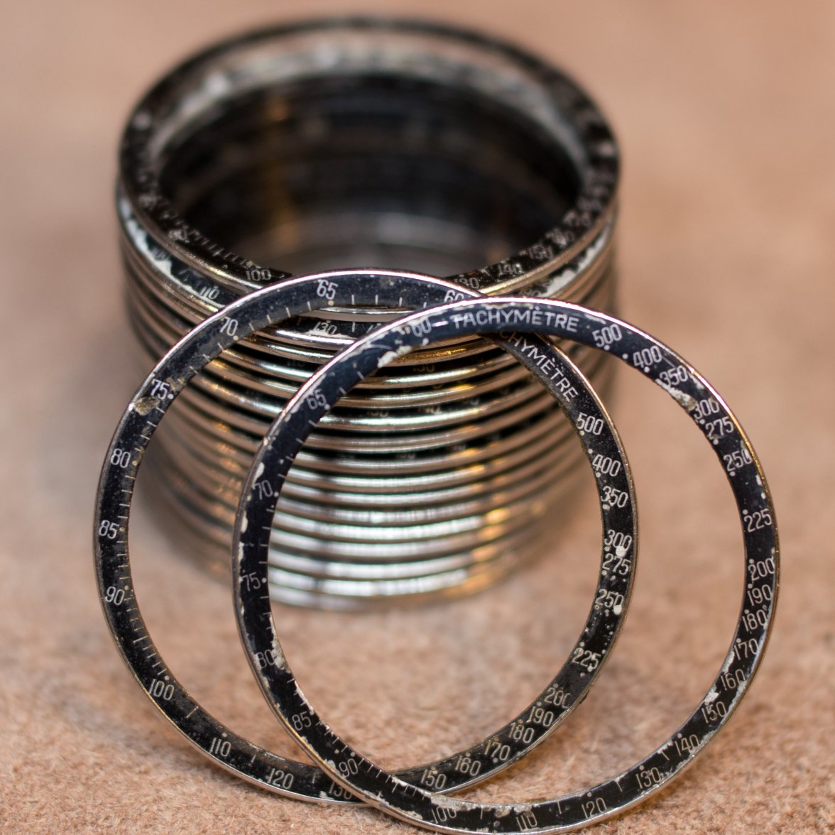

Here is an oldie but goldie photo
I see your retirement funds in this photo. Well done bro. Reminds me of casino chips in a Roulette game. 😀
Are you able to spare me a good condition DON at reasonable price? Seriously.
Look at this pile of coins 😲 !
THAT is the jackpot right there.
