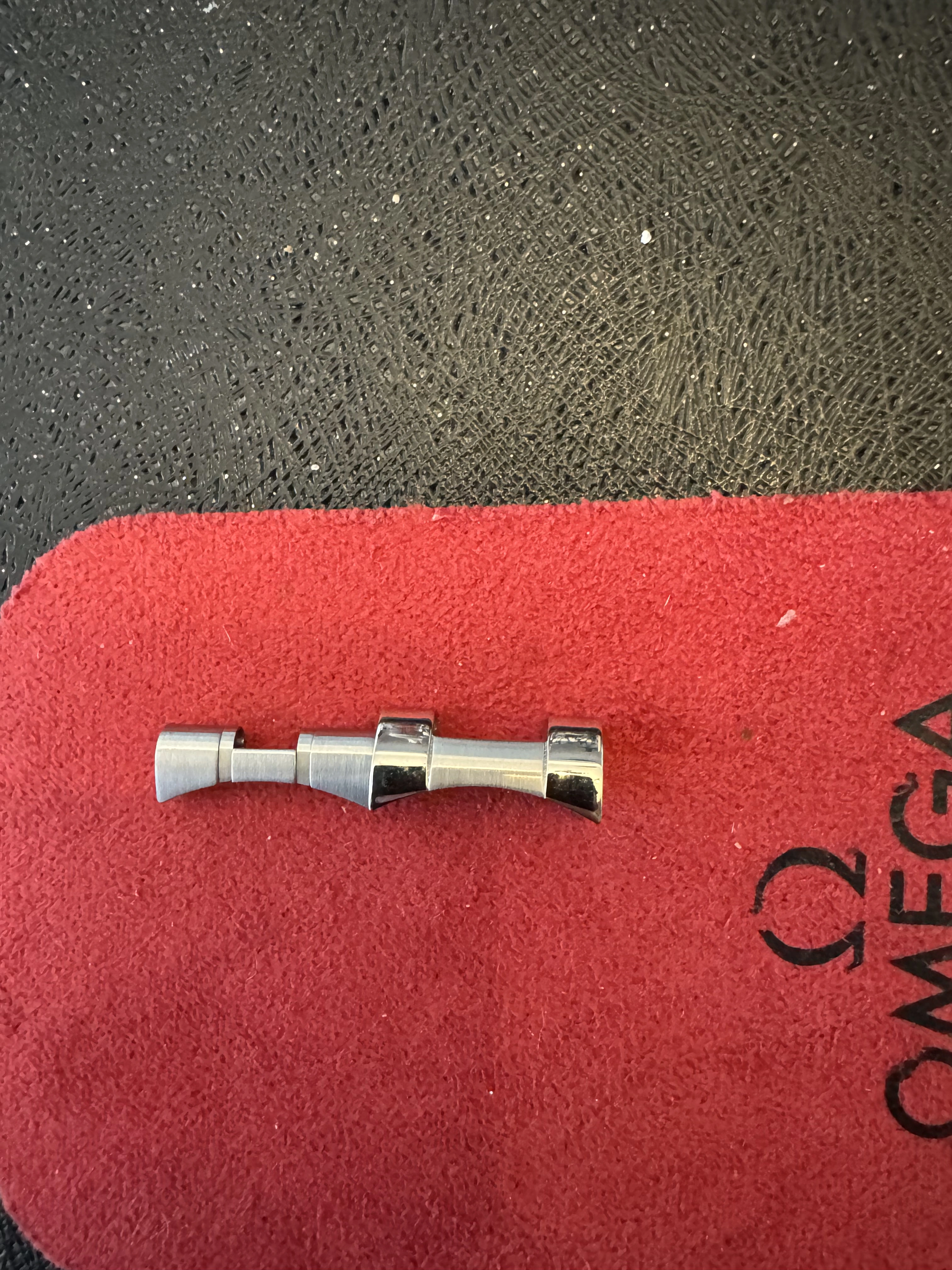

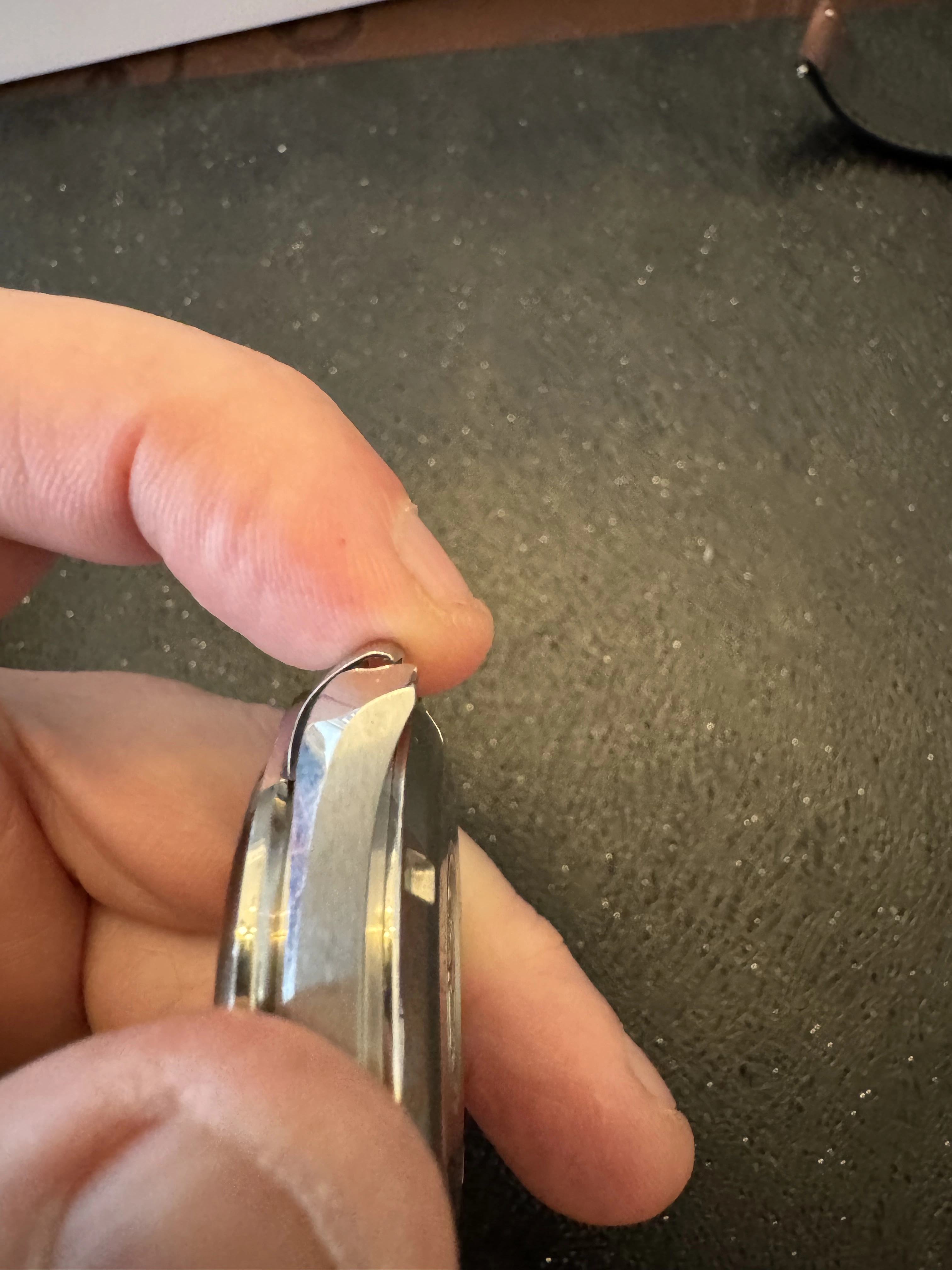

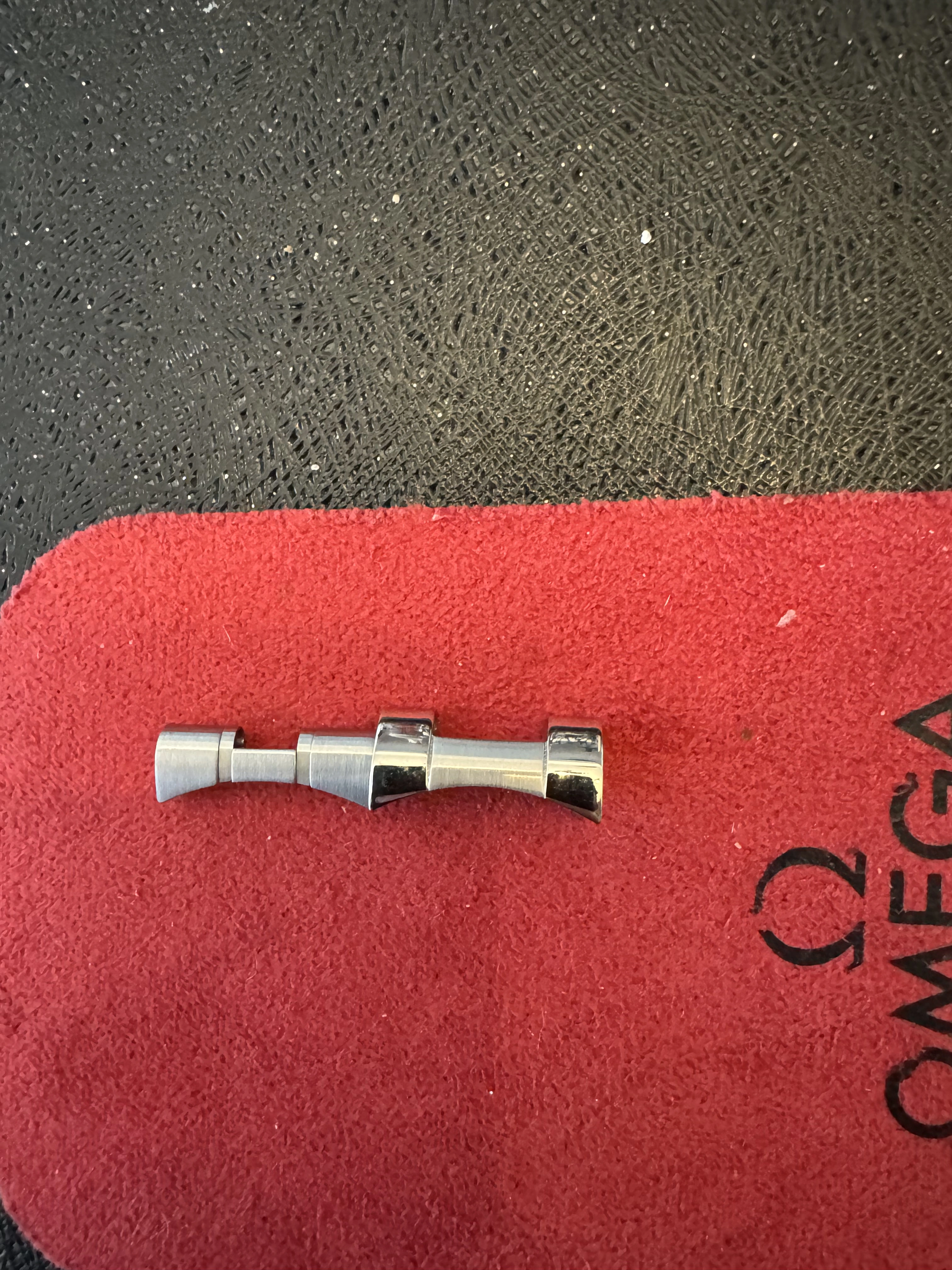

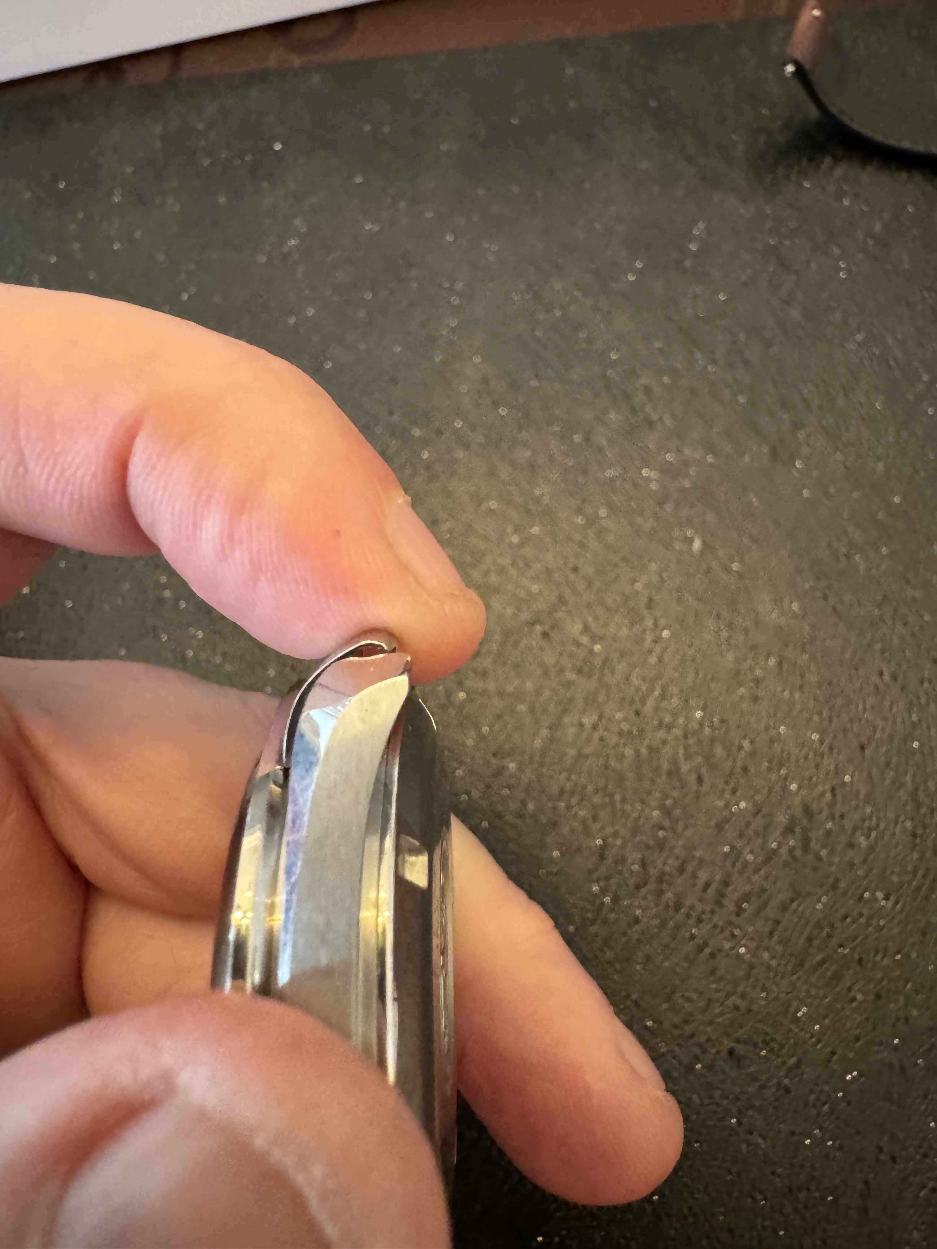

Since no thread is complete without pictures, here are a couple showing how poorly it fits. The second shows it next to an OEM endlink for the stock bracelet showing the disparity in length.

Forstner is doubling down that these are the “correct” end pieces, but they just won’t fit this specific model. Nor will they take the bracelet back because I have already removed the plastic and resized it. If anyone in the US has another model of the 3861 Speedmaster and wants a pair of flat link end links to experiment with, PM me and I will send them to you. I’d like to see if Forstner’s claims hold up.
