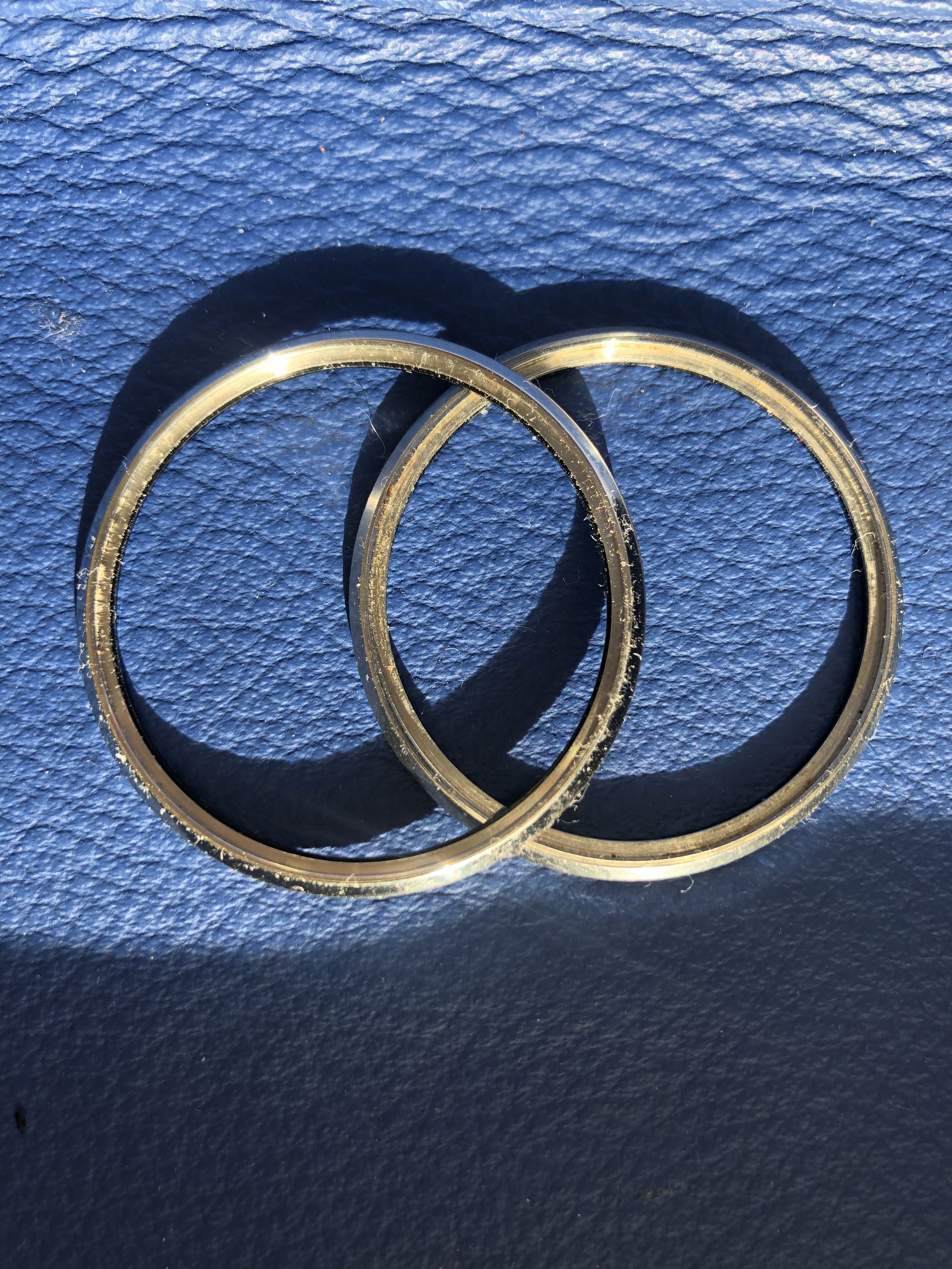

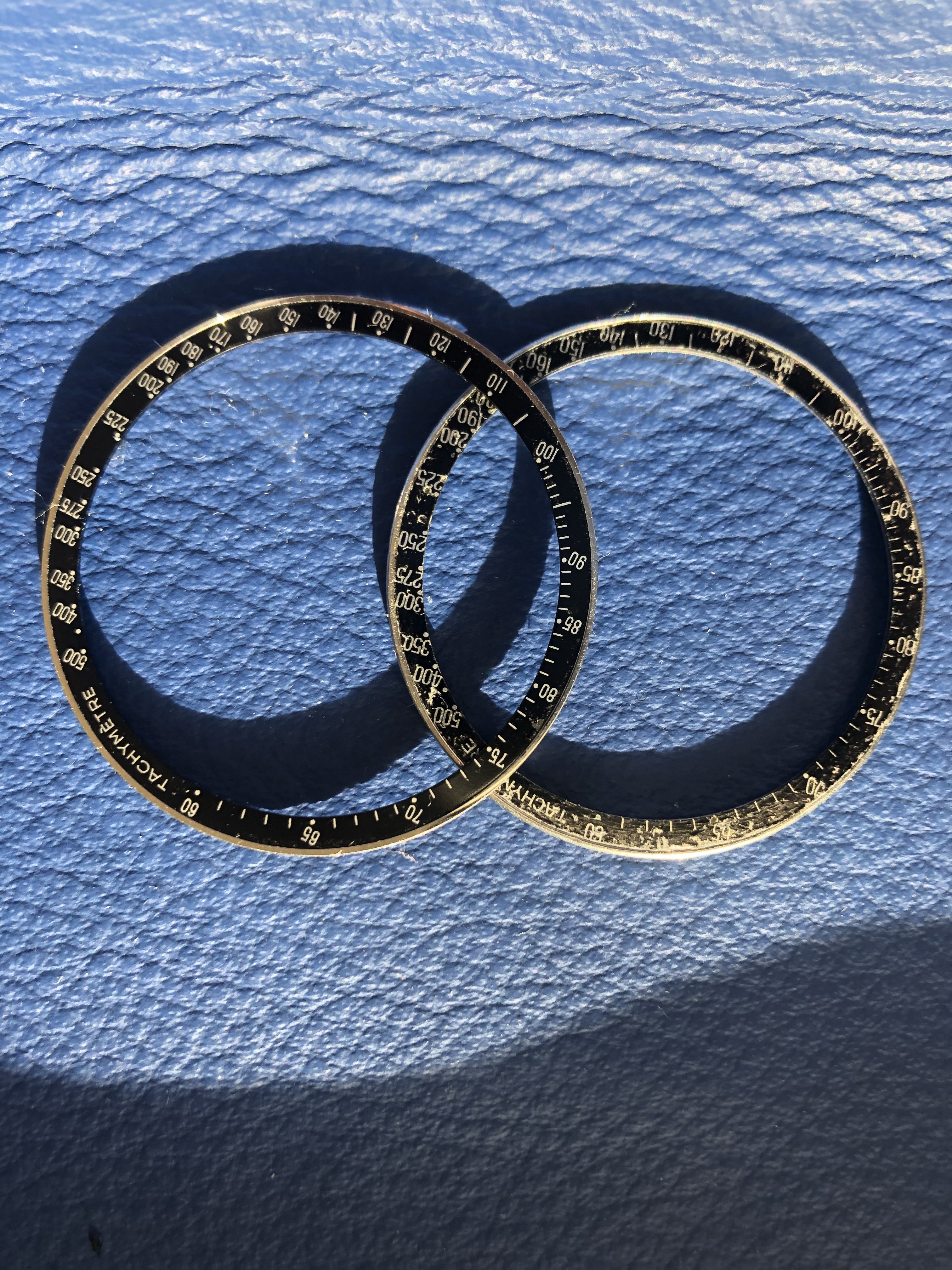

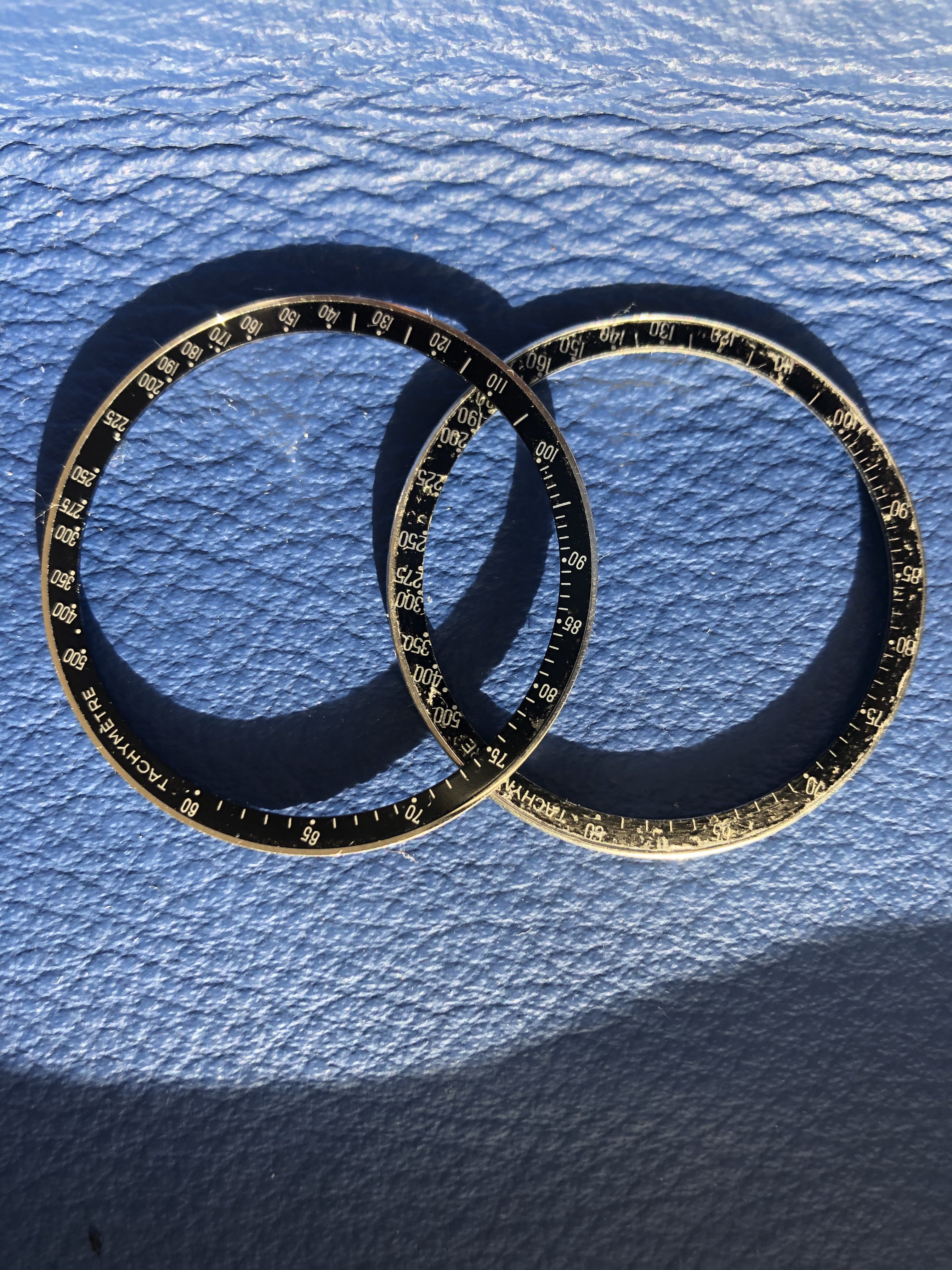

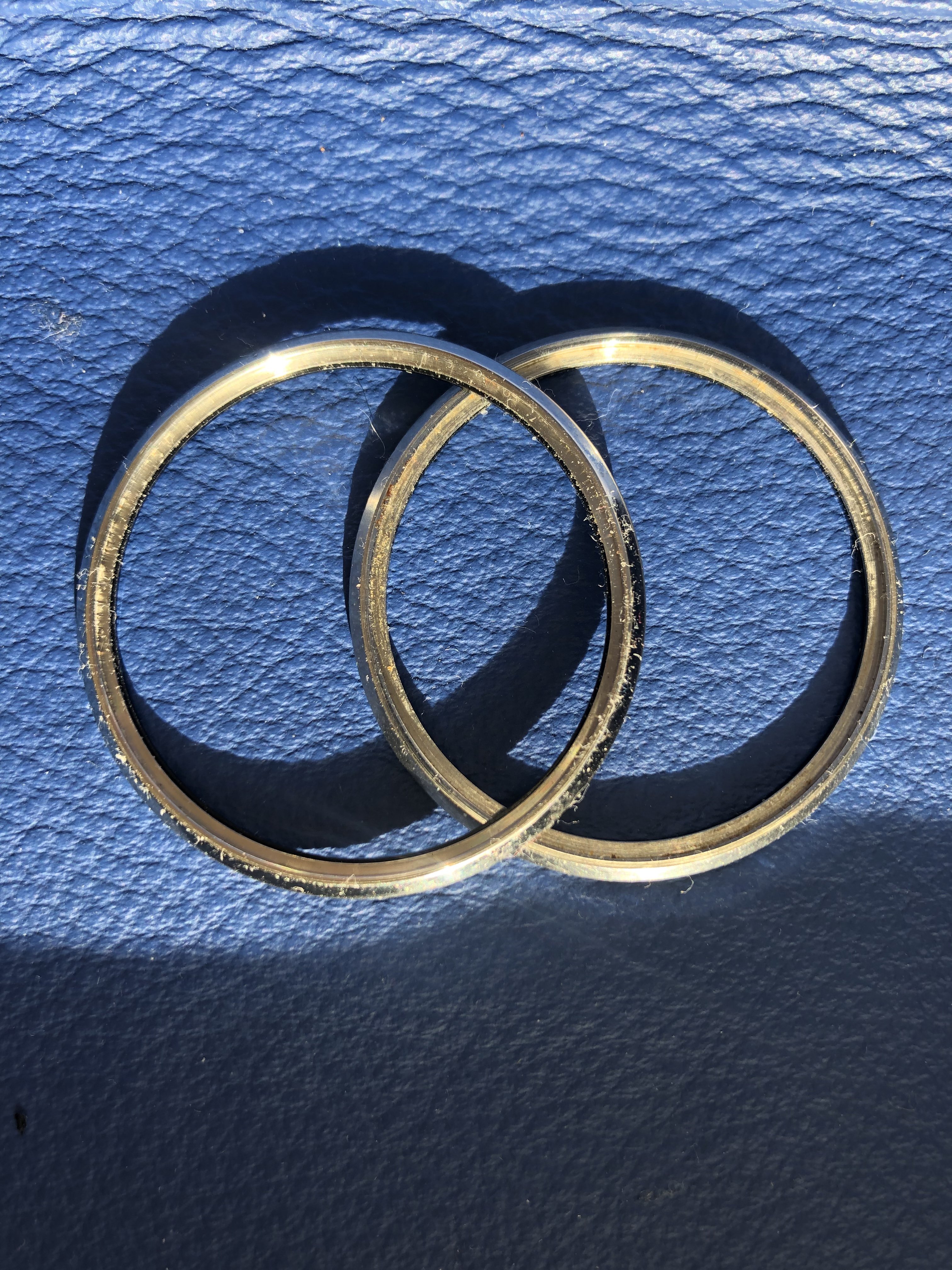

Hi everyone,
I have recently bought a DON Bezel for my 2998-6 pre moon. This came with a service bezel and my eyes were buying each time I looked. I took it to the watch maker yesterday and using the press one side fitted and the other wouldn't give the reassuring pop. He asked me to bring the service bezel as I had no issues with it and he will check the inner diameter of it against the DON Bezel. He said that he may need to file down one side after measuring bit inner circumferences.
Wondering if anyone else had similar situation to mine? Please share your experience.

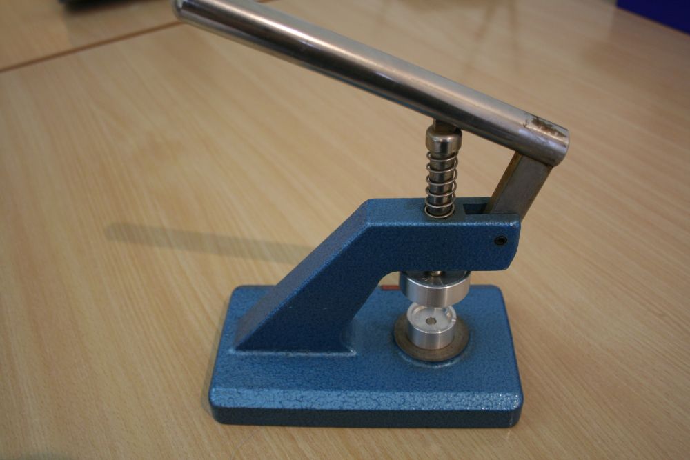

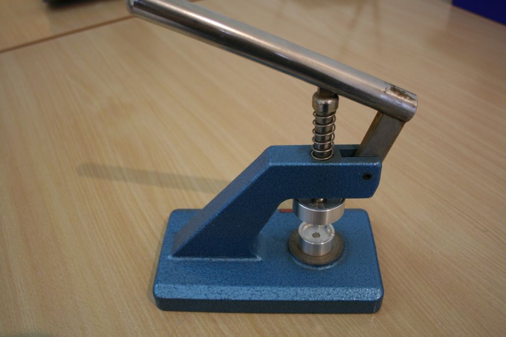

There are 2 kinds of bezel press that I experienced before. The first one I experienced is the most simple one, you squeeze with your hand when you press, sometimes don't work that well. The send one I experienced is the heavy-duty one, operates like turning a wheel. It gives more even pressure to put on the bezel.

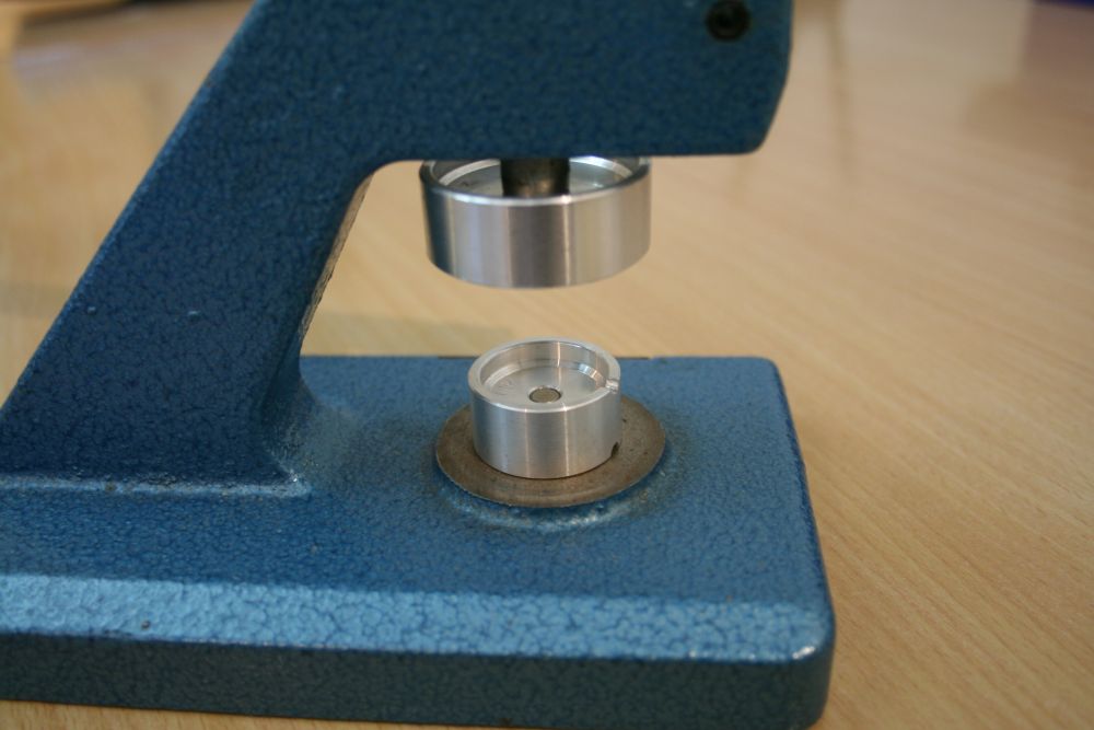

This is the press I use for bezels etc, it does a very good job of keeping the dies perfectly horizontal when trying to install bezels.
I just reinstalled a DON bezel on my 145.012, quite a tight fit but using this setup up its nice and easy. I did use a spare Speedmaster case back on the watch as I like the watch to sit perfectly flat and the watch had a Sapphire case back installed and I dont want to put any pressure on that so its easier to remove it while doing a bezel.

HI Pascs, the press the WM used was the heavy duty one. And with the the Bezel still did not fit on one side.
Thanks He was using the heavy duty one that you have to turn like a vise and it presses down. And still no good
