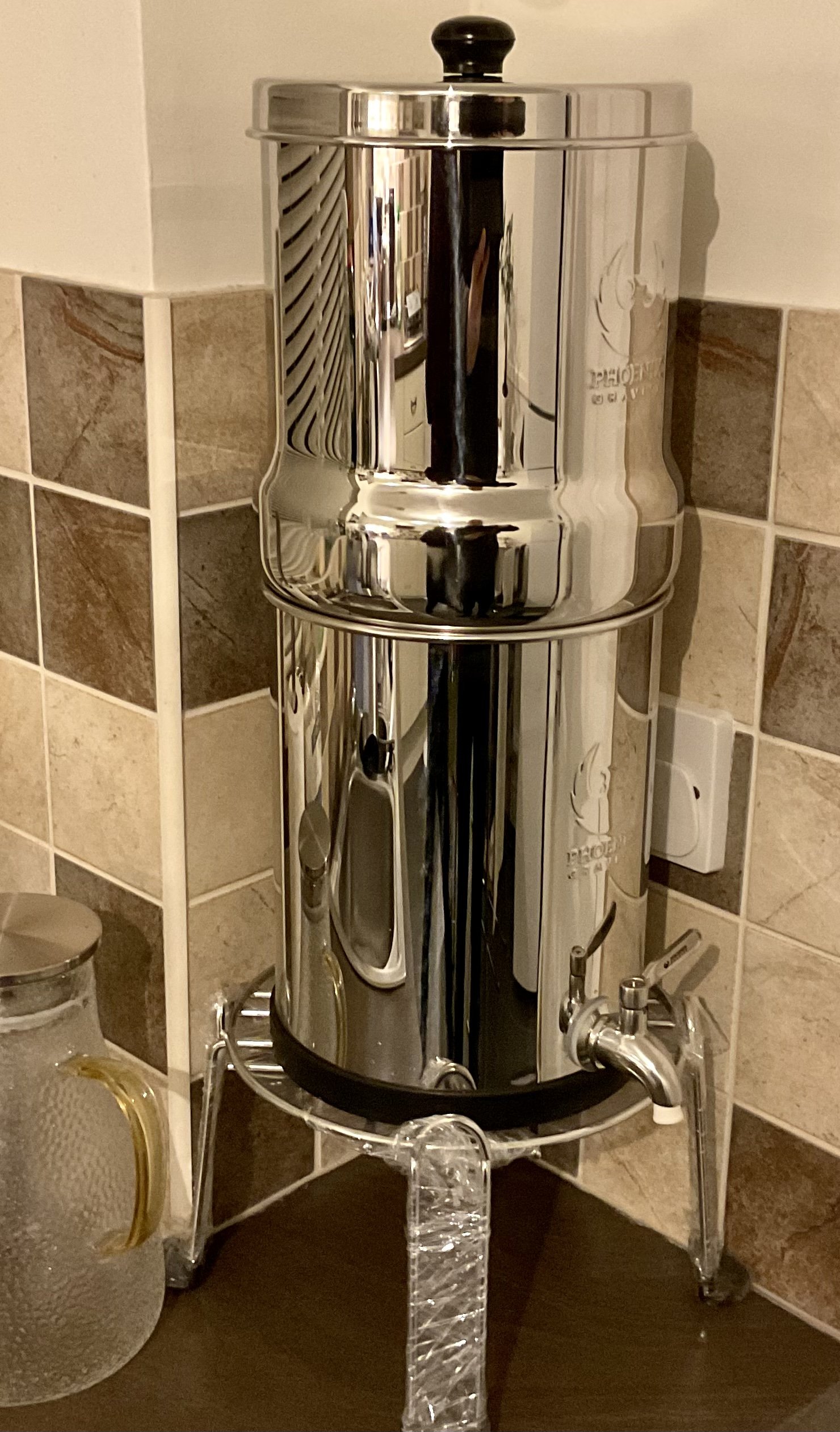

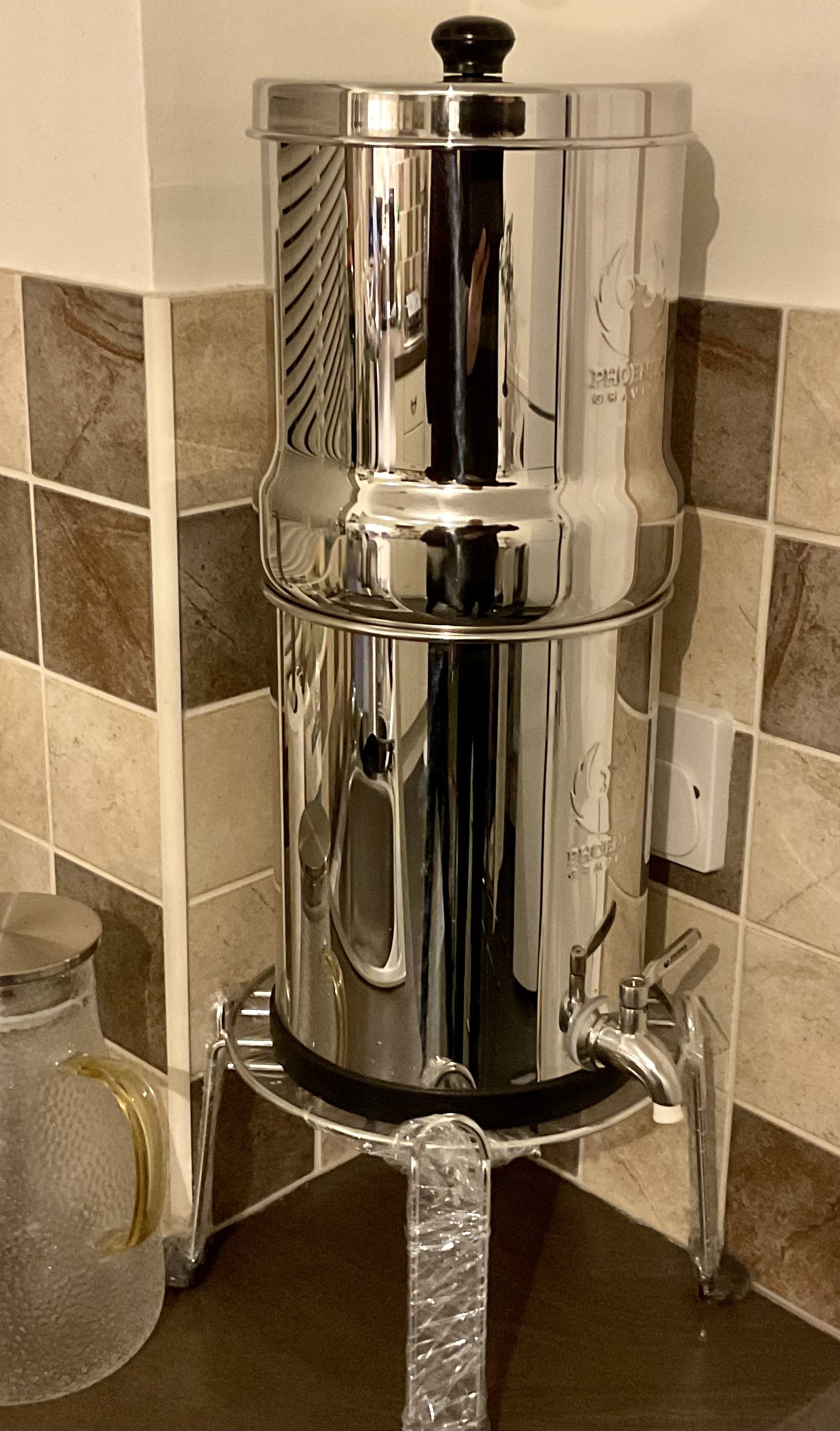

So this time around it is a gravity system and a jump up from the old Brita. Not fired it up yet but nearly ready to go. They say the filters have a silver contact to reduce the risk of bacteria growth but I will keep ahead on the maintenance anyway and see how it goes….
4,719
17,867
So a quick update......been very happy with the system but it leaves in too much calcium (yes I know it is good for you) and the kettle and pots are suffering.... So we are now using a Brita again but then running it through the Gravity filter. I will only change the Brita when the kettle furs again so I suspect we will get a long life on that. The Gravity filters should be good for a couple of years if kept clean with our usage rates.
Of course if we use Butt water ....(behave forum)... the gravity system might not last so long, a good option to have if we loose our supply for a time. I am told (thanks @Tony C. ) when the flow rate does not recover after a clean it is time for new ones. Thanks again for the help and comments by the way everyone.
