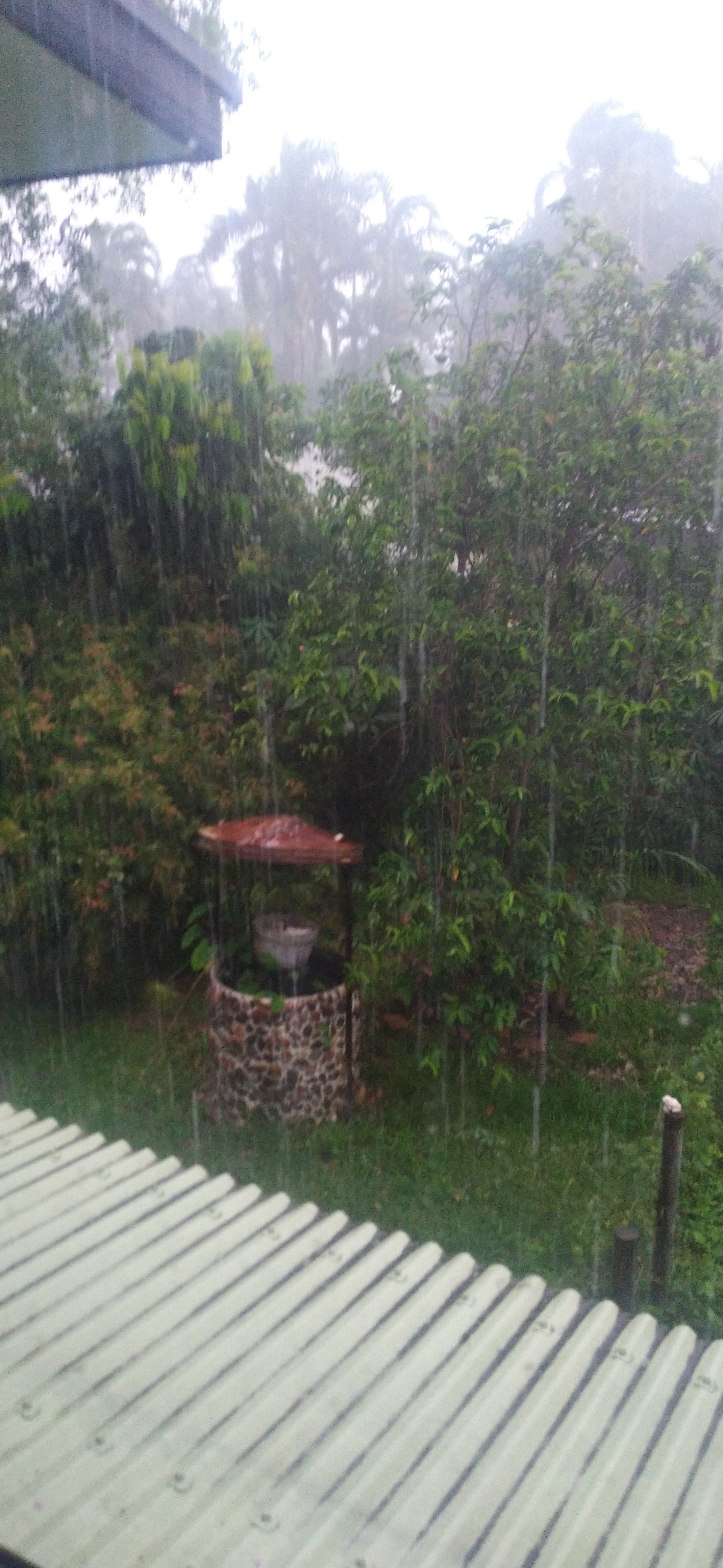

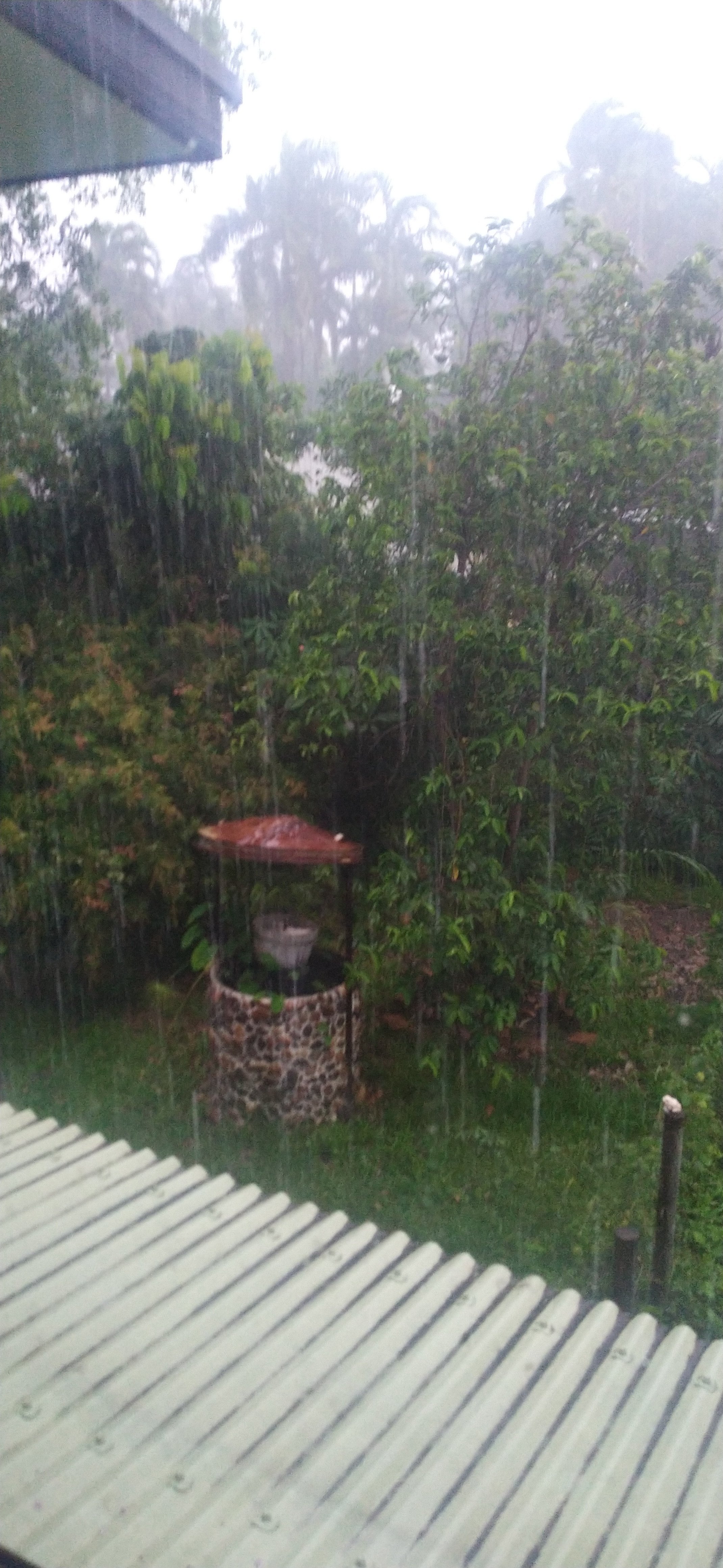

Use the sky filter method myself. Falls from the sky, I drink it.
(wet season in NT Australia our dam overflows for 3 months of the year)

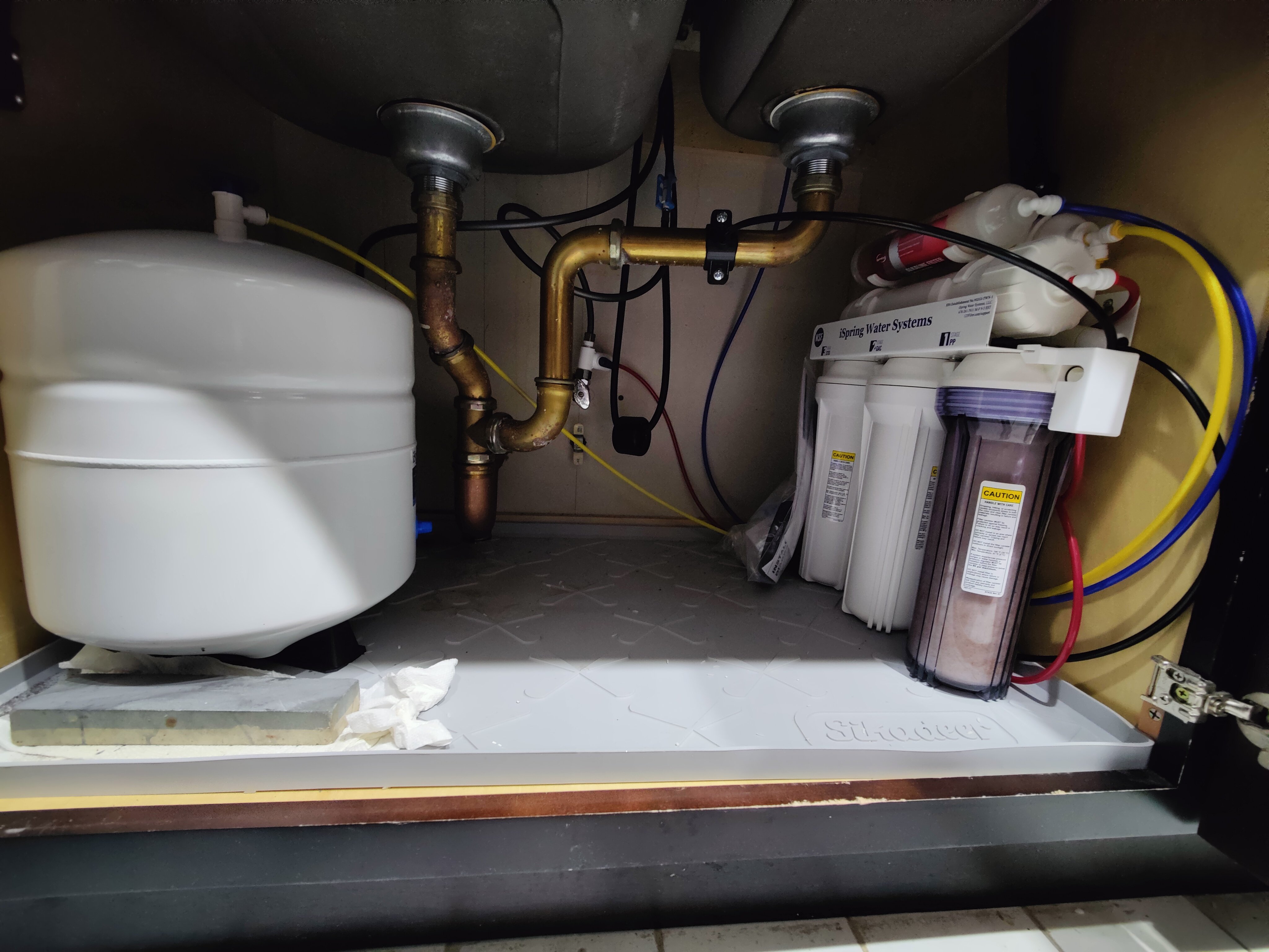

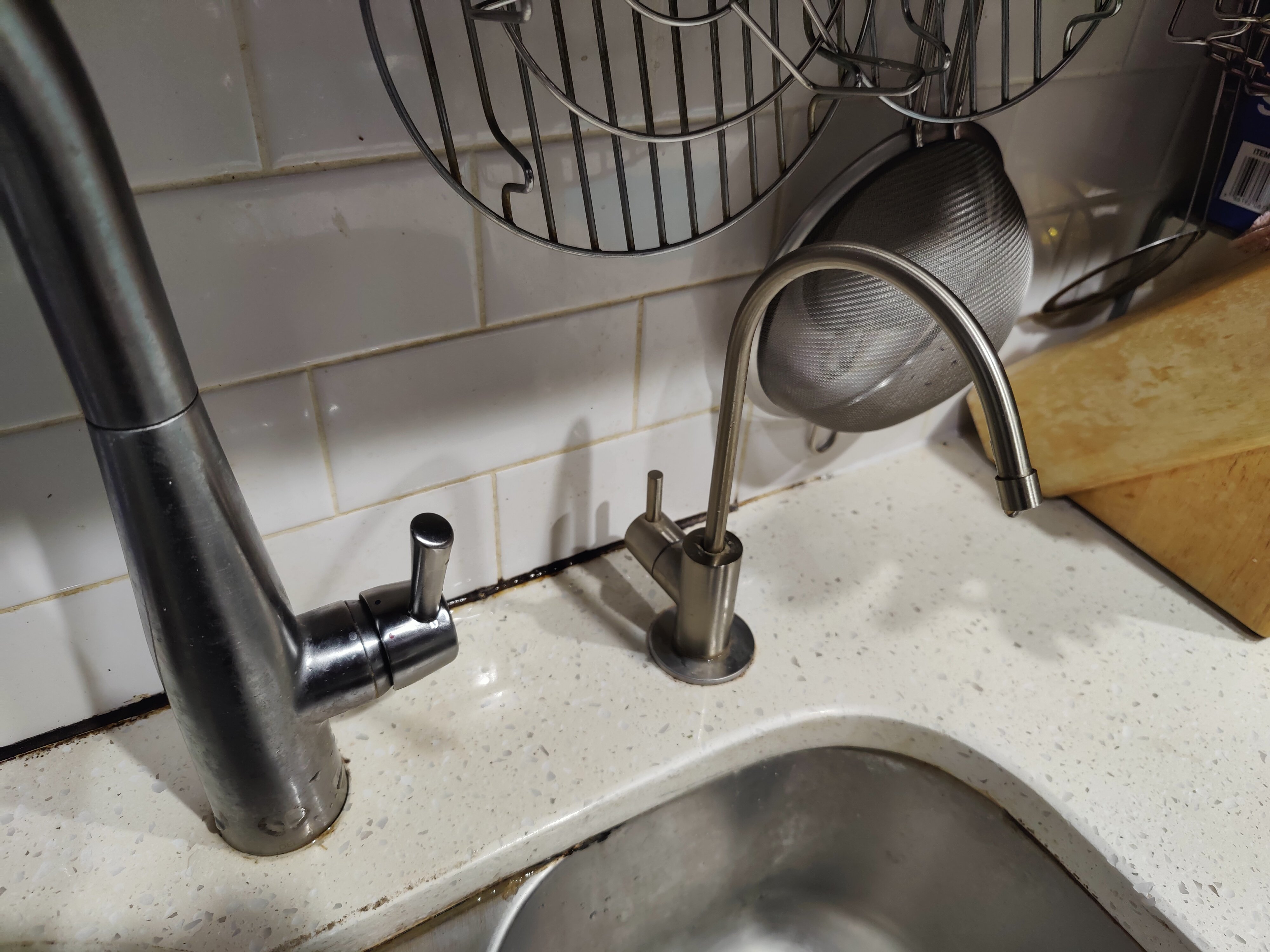

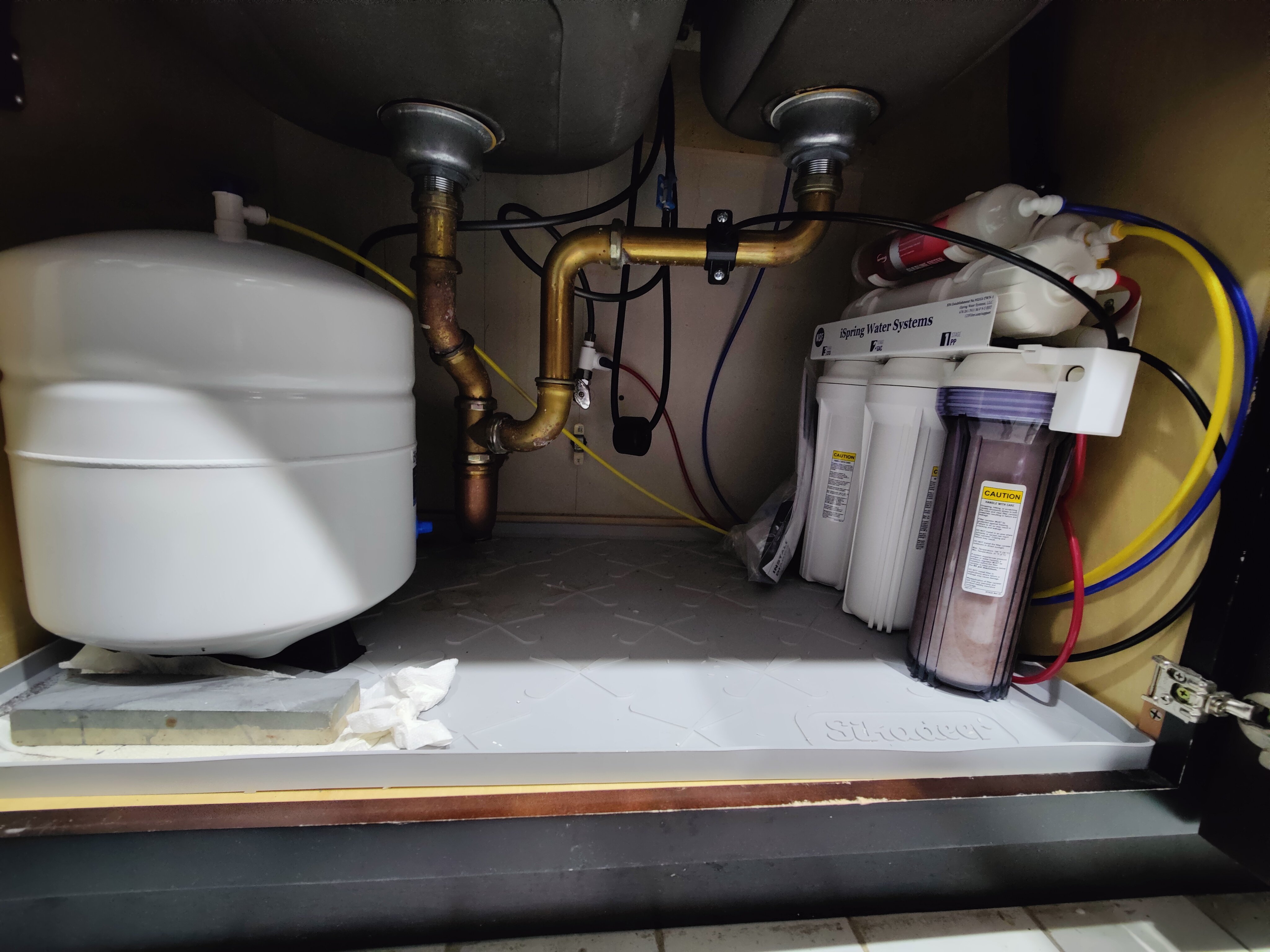

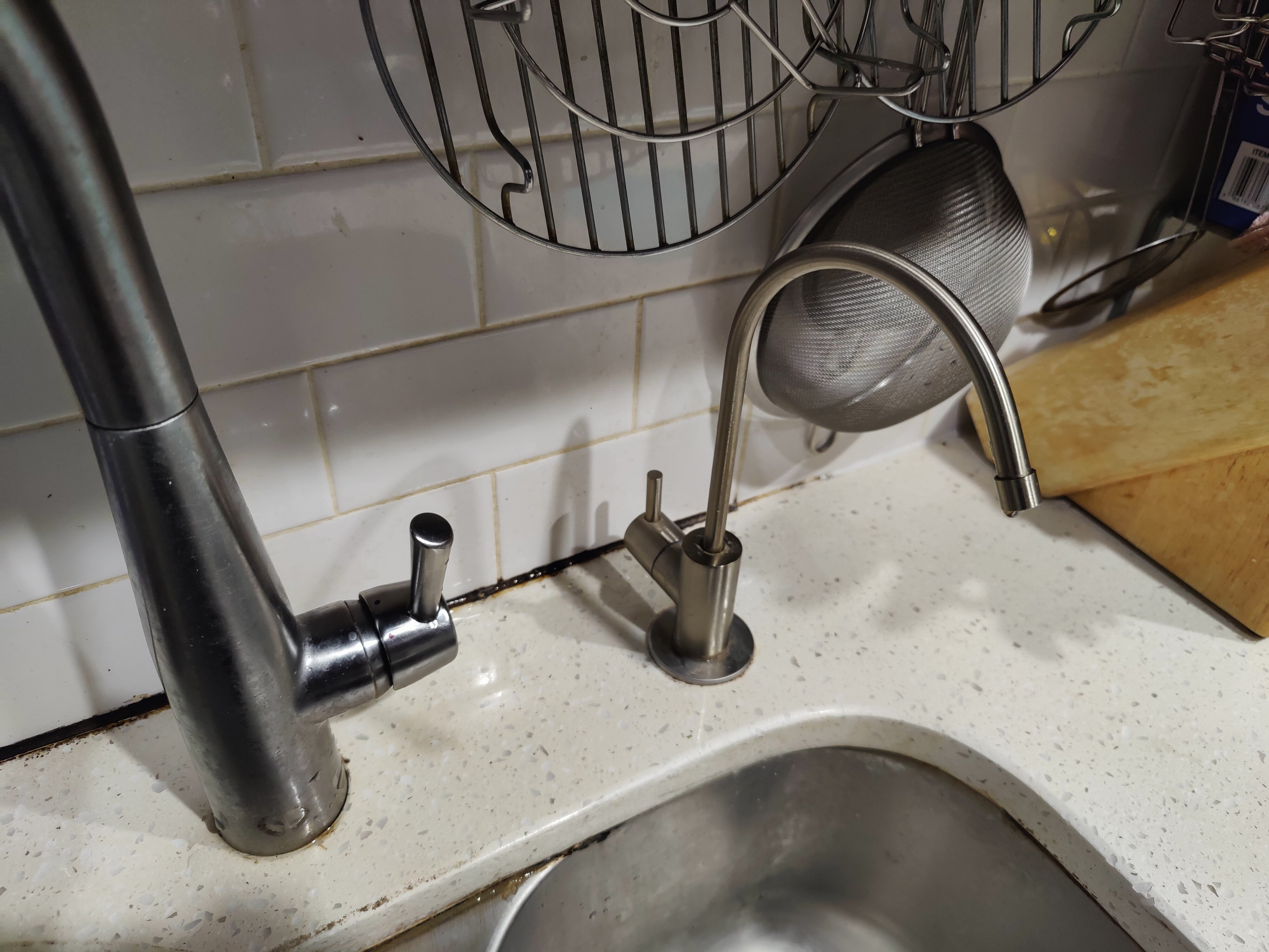

US here. I installed a reverse osmosis system last year in the kitchen sink so that filtered water comes out of the sink in a different faucet. I bought the iSpring one on Amazon. It's been working great since the filtered water gets stored in a large tank ready for use. The only downside is you have to change the filters every 3-6 months. I did it twice already and it's always a big pain to disconnect all the pipes, take the unit from under the sink, unscrew the filters, install new ones, and reattach all the pipes again. The filters themselves aren't that expensive at around $70 for a year.
Amazon.com: iSpring RCC7AK, NSF Certified 75 GPD, Alkaline 6-Stage Reverse Osmosis System, pH+ Remineralization RO Water Filter System Under Sink, Superb Taste Drinking Water Filter : Industrial & Scientific

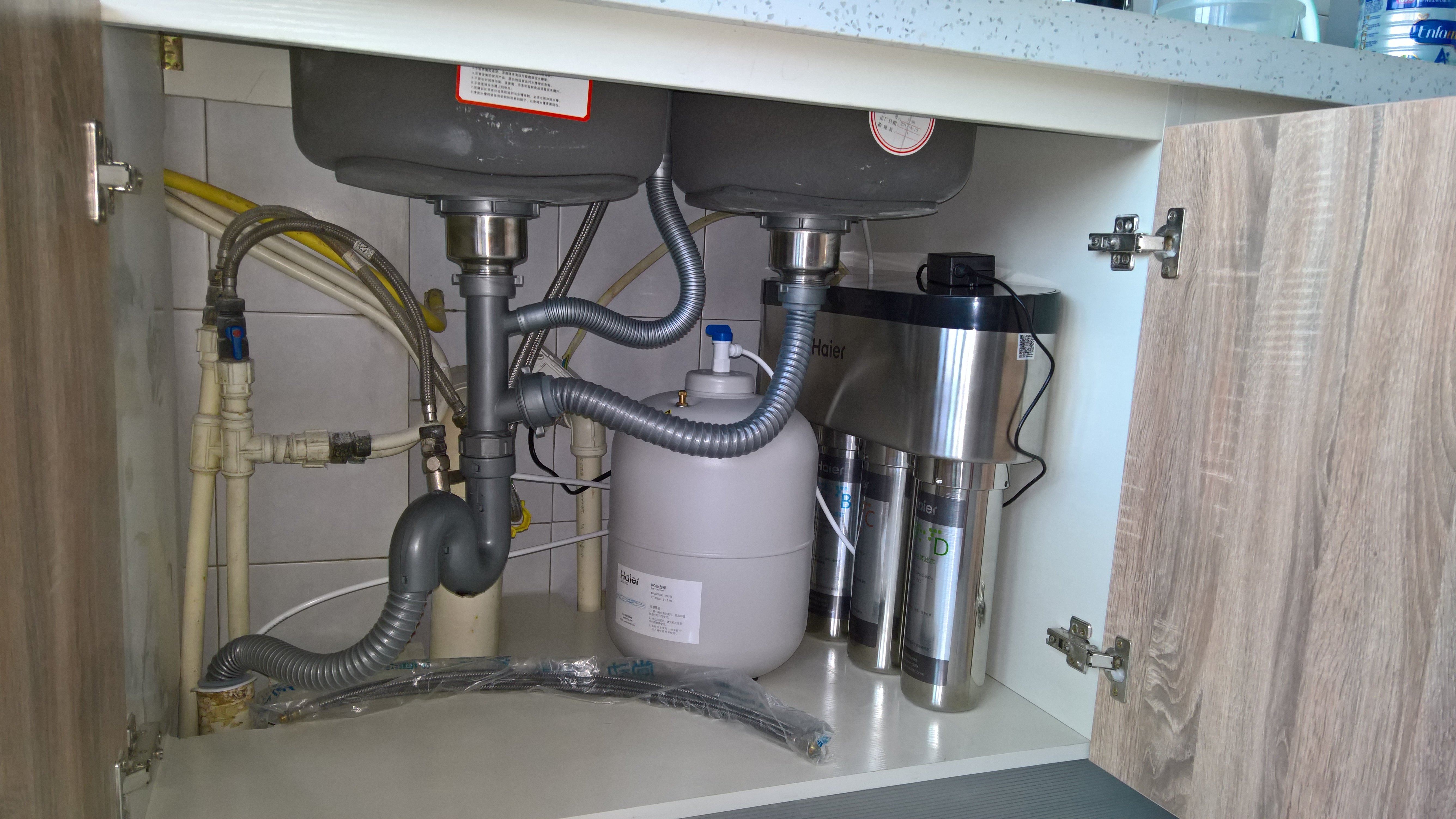

Actual picture of my setup.

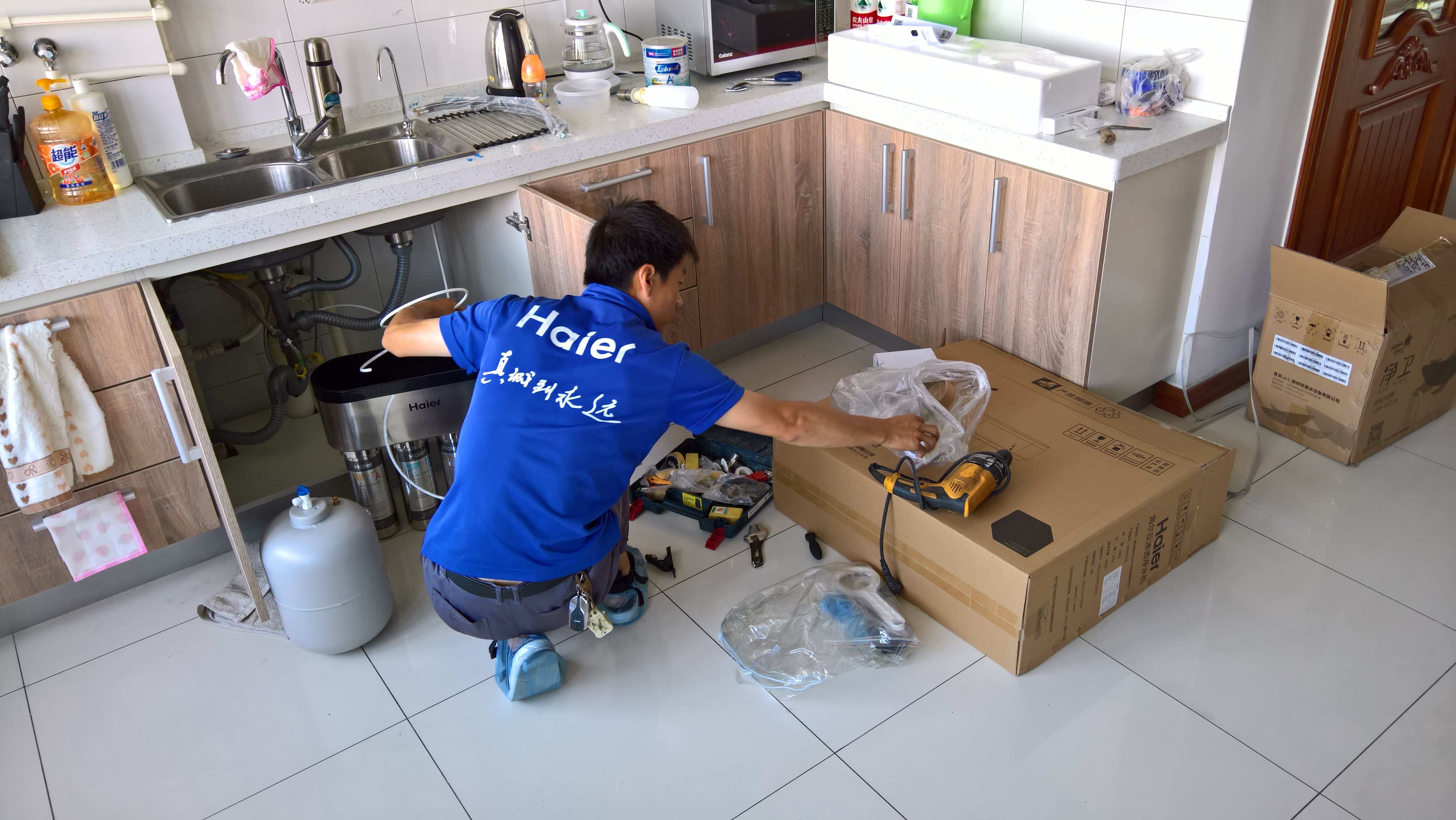

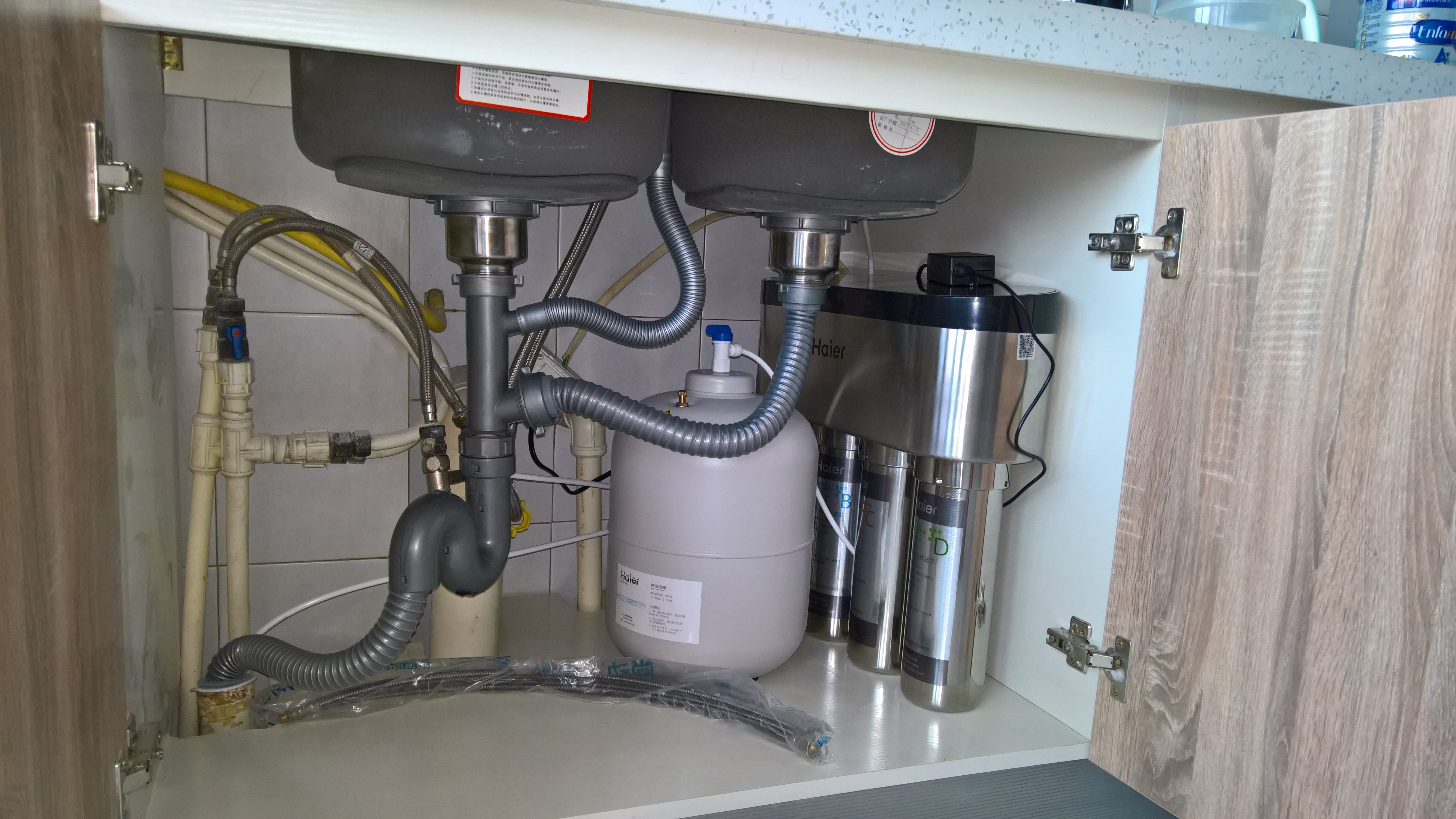

I have a similar system which we installed July 2017 in China and as you might guess it's made by Haier.
Works extremely well and came with an electronic water tester to determine water purity.

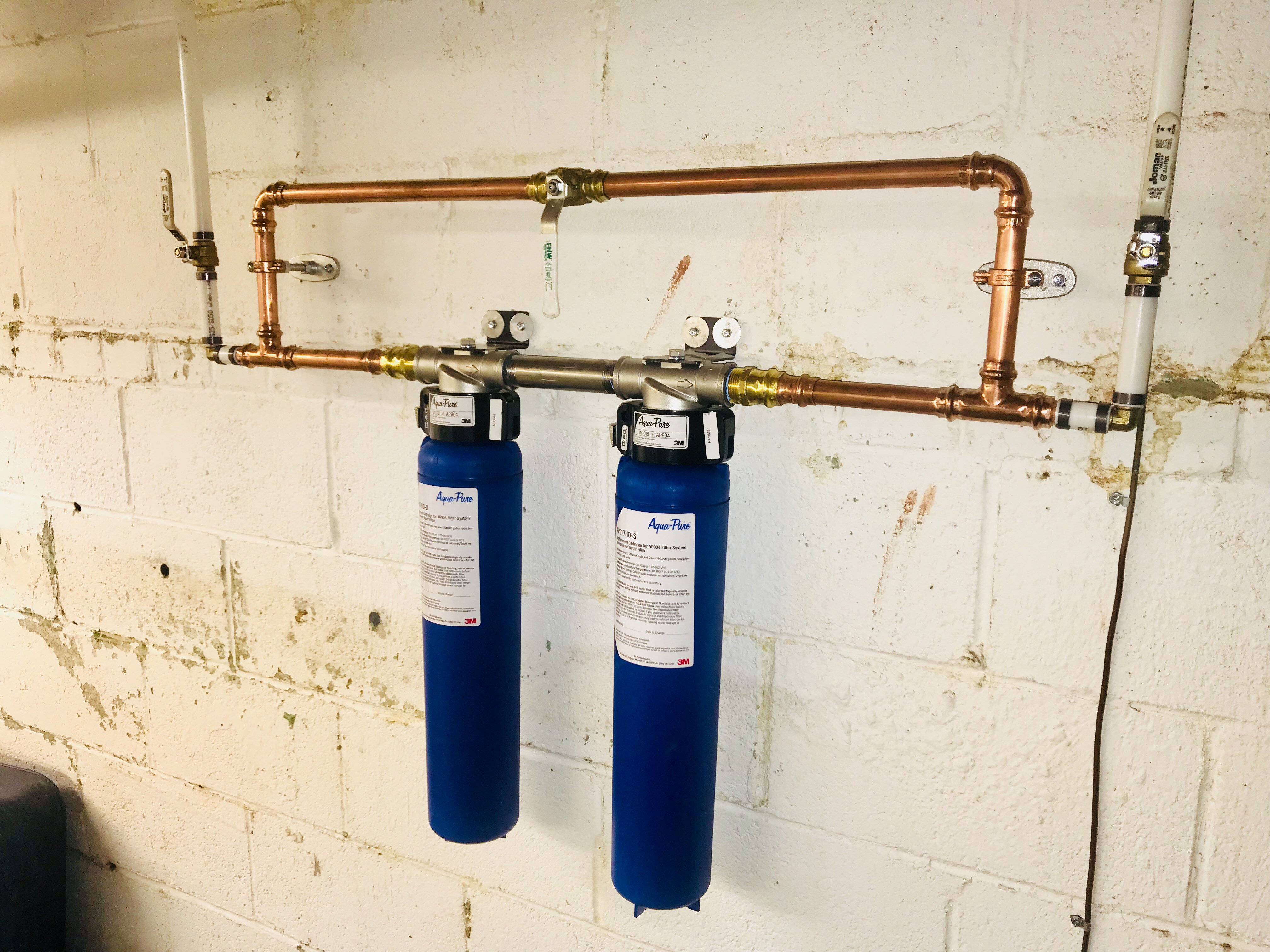

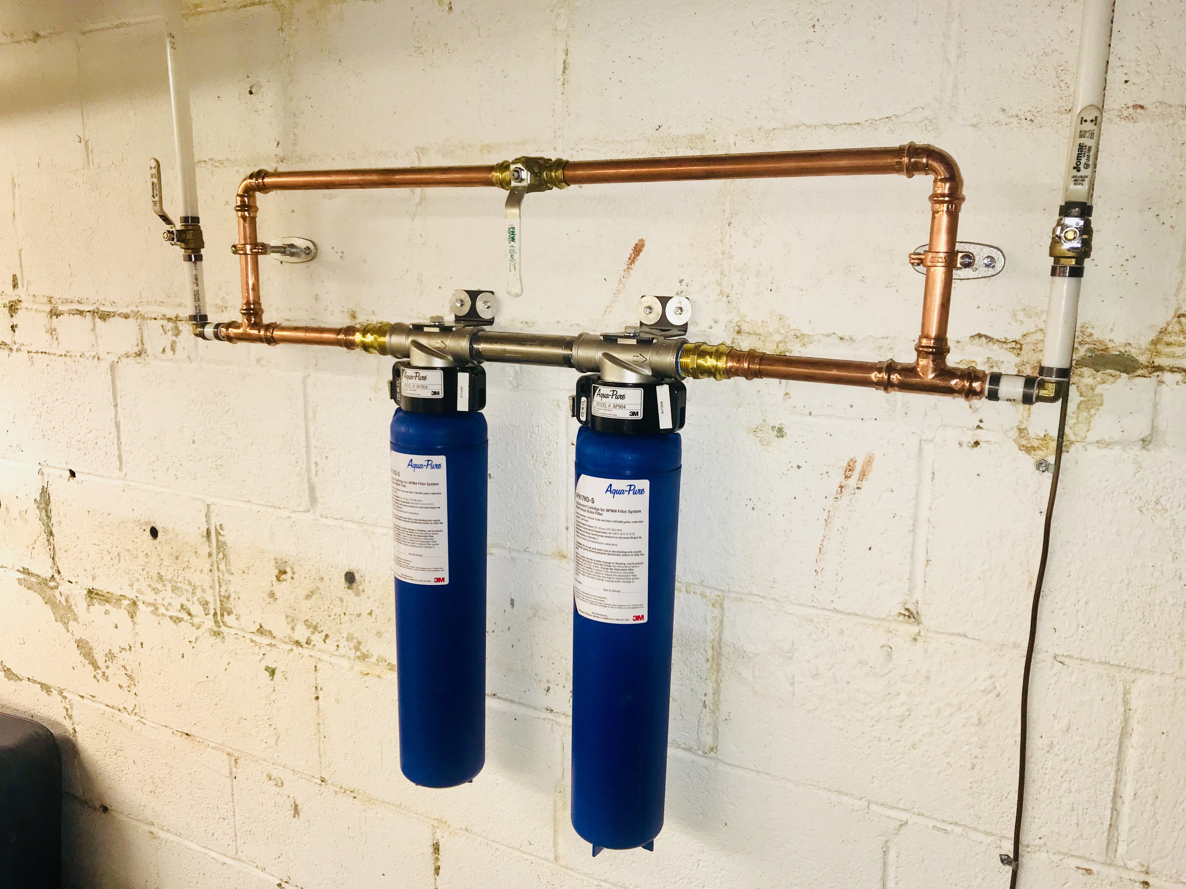

Sorry we are doing pictures
Picture of my set up....

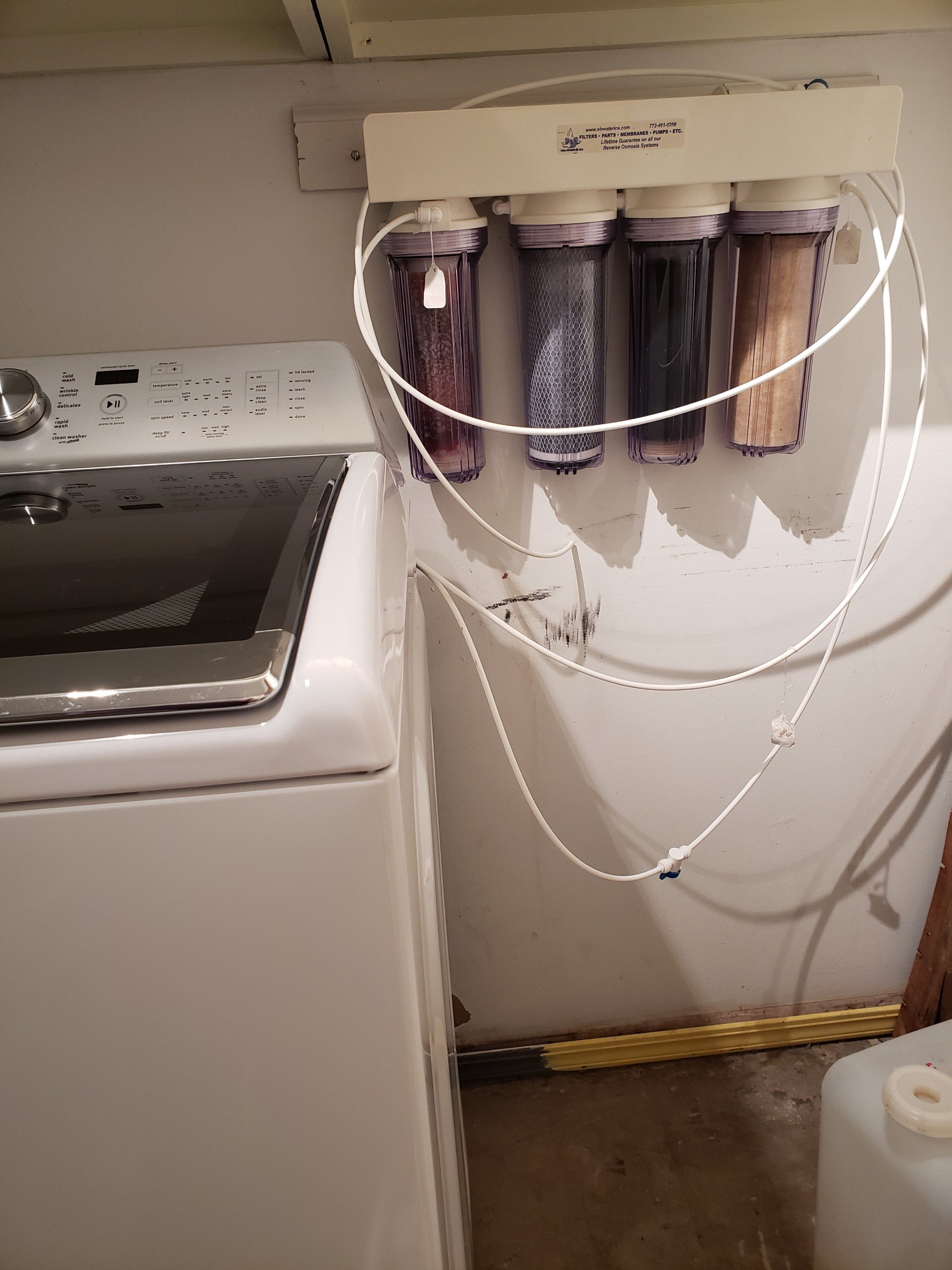

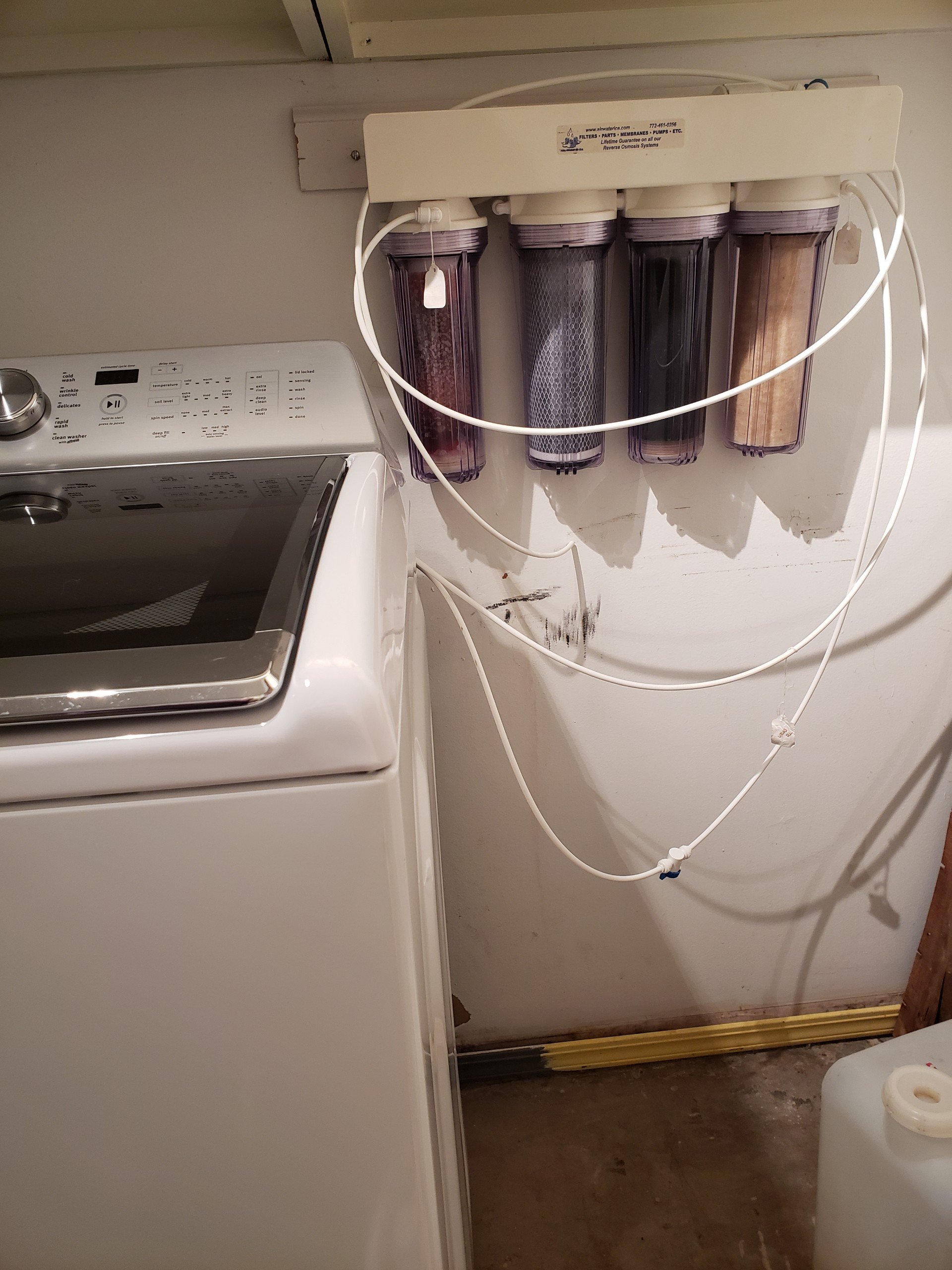

I used to keep saltwater inveribrates and I currently have a freshwater tank, and I've had a 4 stage reverse osmosis deionizing filter system for about 15 years. Beyond removing chloramines, reducing dissolved solids is critical to preventing algae growth, so I purchased a system that's probably overkill if you're just trying to produce safe drinking water. It's dead simple to use and reduces the TDS to 0.2 PPM when the filters are new. I use the Typhoon III Reefkeeper RODI from a US company called AirWaterIce.
One thing to keep in mind is that these systems produce about 3 gallons of waste water for ever gallon of purified water. When installed under a sink, the waste line goes directly into the drain. I find that wasteful, so I installed mine next to the washer. I put the drain line directly into the washer to fill the tub for laundry, or I fill jugs and use that water for general cleaning where high mineral content isn't a concern. It's a bit unsightly (as is the condition of my laundry room), but no one sees it.
223
337
