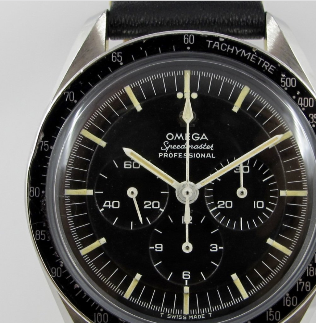

I am the proud owner of a 2998.5 (attached). Its lume is GONE. I have friend who could relume it to the point of it being almost undetectable. He does work for hi end dealers.
I mentioned here that I was considering a relume and was howled down with constructive advice not to. I would like it to look better but now realise I would be shooting myself in the wallet if I went ahead.
What we want is not always good for us. I would probably enjoy the watch more but that would be tempered with the knowledge I had destroyed some intrinsic value, unless I kept this info to myself, but invariably honesty is the best choice.

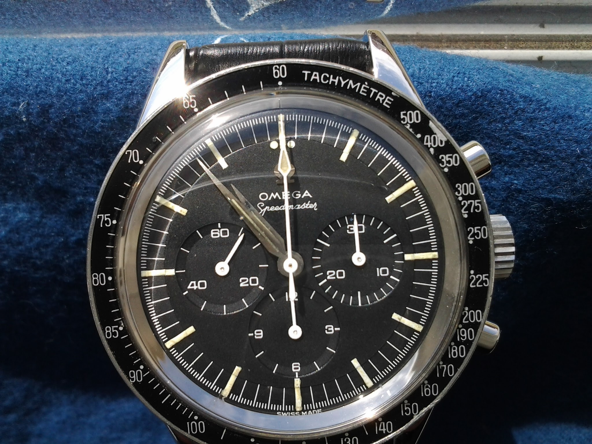

Looks like most of the lume is still present to me?
Is it just the lighting??
1,303
3,088
It's just the lighting, esecially the indices, they are a dirty white.
Using a 10x lupe you can see a very thin texture on the surfaces. This is why it was tempting to colour that texture.
The chrono hand is good.

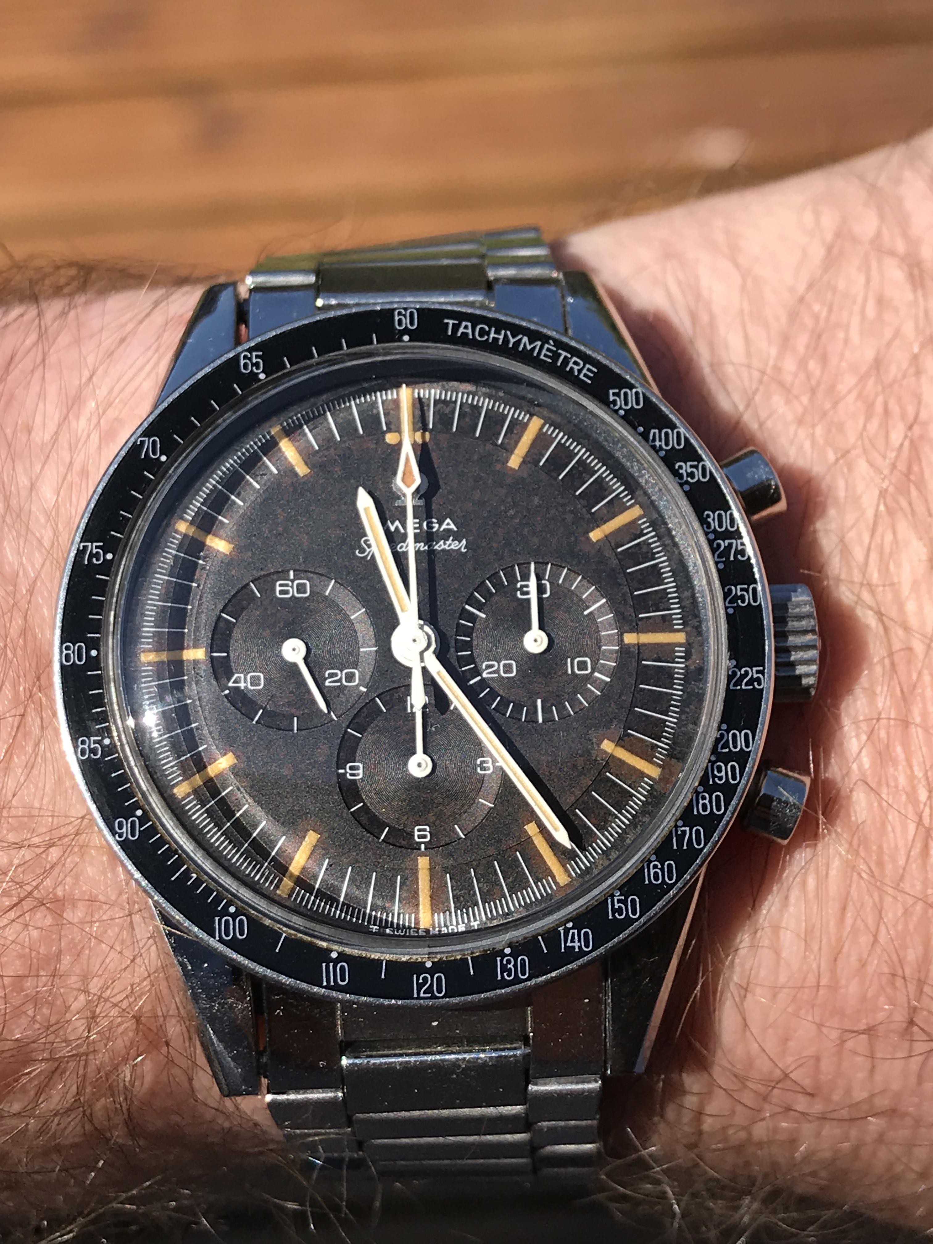

Ive been following this thread with some interest as I own a watch which has had the lume plots redone by James Hyman.
My personal opinion is I don't think the value has been hurt much as I think the watch is now more attractive
My only gripe is I feel the lume is too orange James has said its a easy fix to change the colour what do you think change the colour?

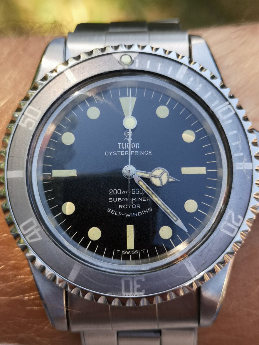

I thought I could use the competence here 馃榾
I have this (in my opinion) lovely Tudor 7016 from 67-68.
The dial is great but the minute and hour hand has some dark areas, and the seconds hand is a bit lighter. I suspect that it is newer (as the insert is so it would make sence).
I think about matchning the hands lume to the dial, but I cannot make up my mind.
Assuming I am 100% honest if I sell (which I would be), do you believe it would affect the value of the watch? Positively or negatively?
A pic on the watch

Looks nice to me, if you are going to do anything just try to clean the hands and colour match the chrono hand.
This will be a neutral value effect.
Generally reluming is negative to the watches value.
It's good, don't mess with it. To me it looks natural and is complimented by the lume burn around the indices.

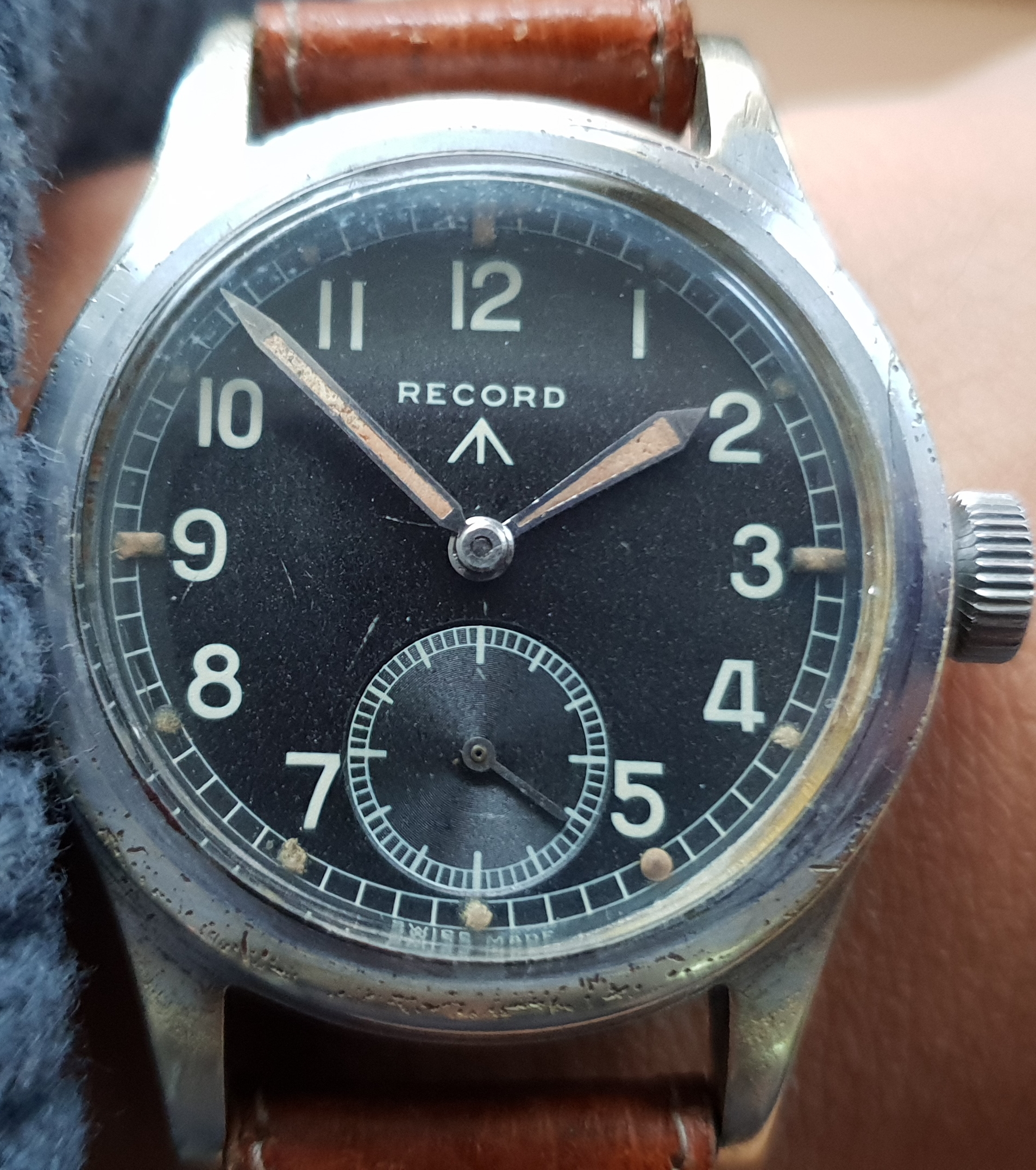

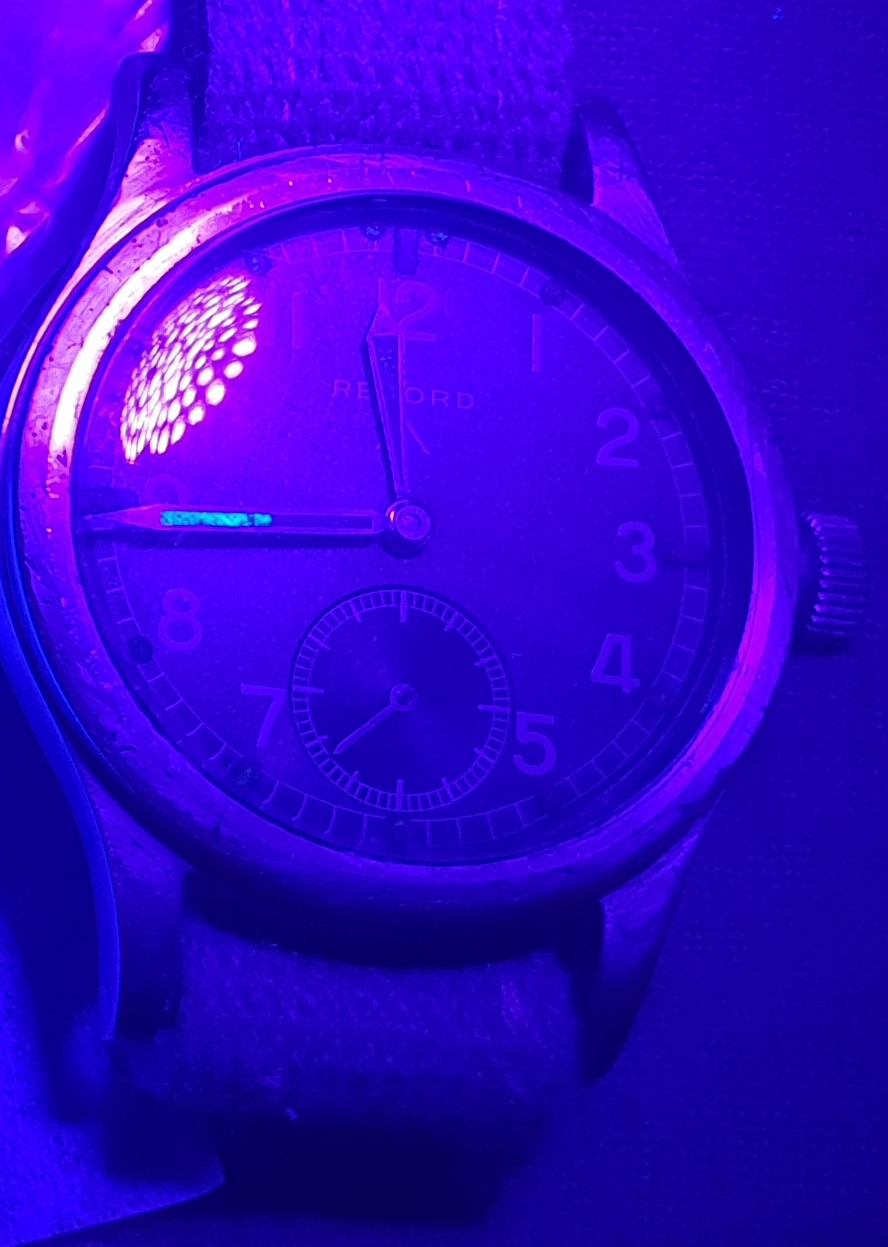

Well my Record here, if I ever sell it, has a very slight relume on the minute hand that was done most likely to replace a gap. And it has been done very well by whoever did it all those years ago (I found the watch in a broken state at an estate auction.)
Value loss? Who knows, visually the watch to me looks good 馃榾

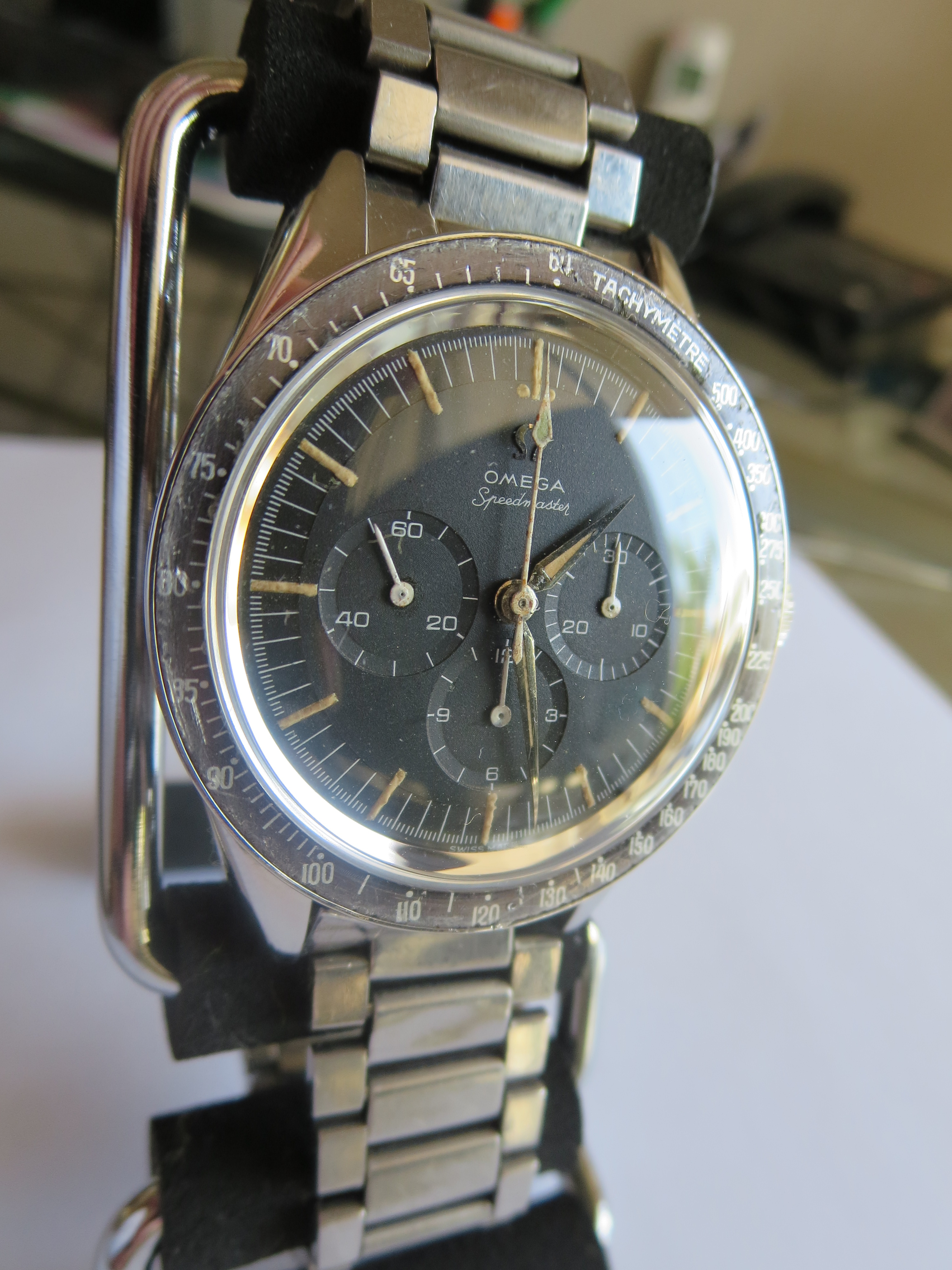

Would you consider watchmaker did a good job on relume (chronograph hands) ?
1,303
3,088
Looks very nice.
