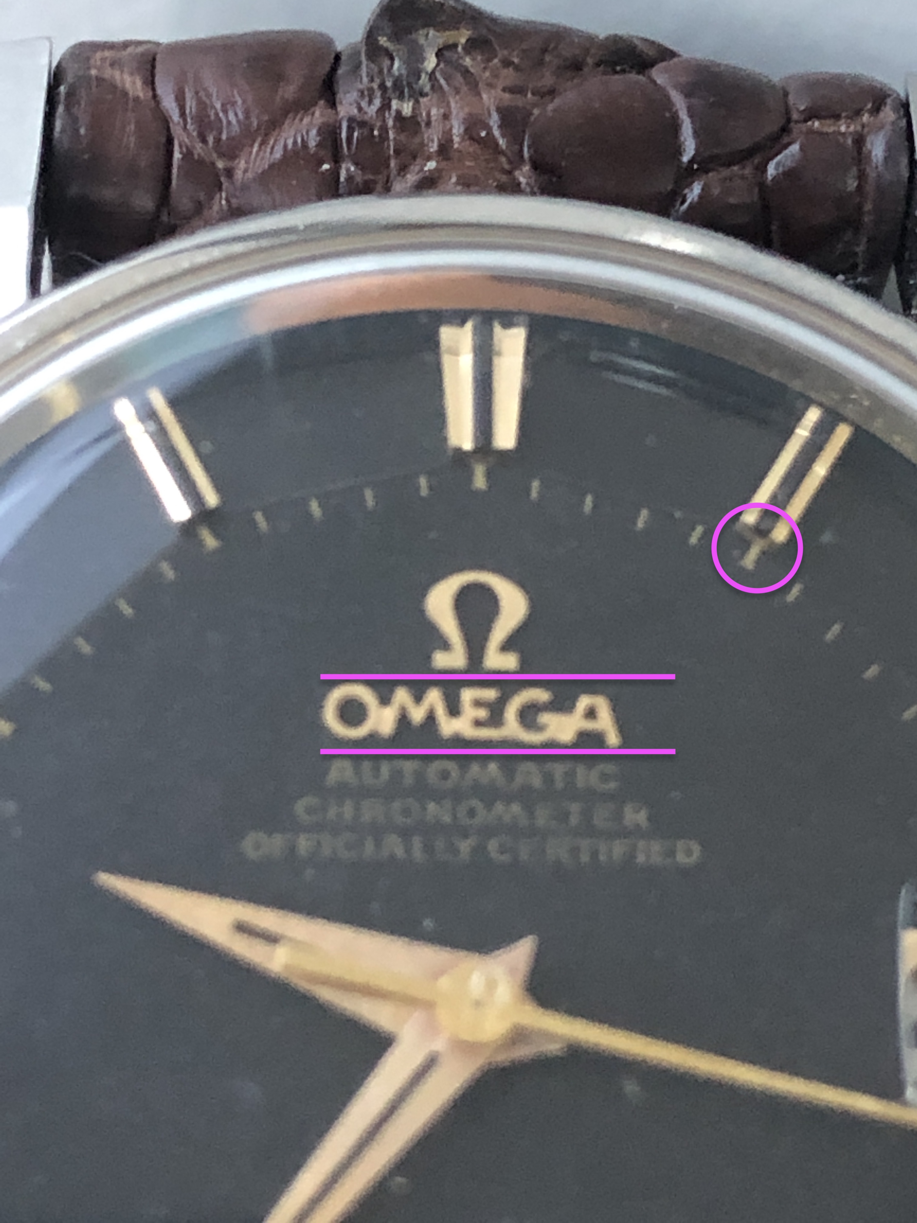

Posts 694 Likes 839 bananapeanut ·Nov 21, 2022 I would really appreciate it if the vintage experts could give me their opinion about this dial. Edited: Nov 22, 2022
Posts 13,489 Likes 31,804 X350 XJR ·Nov 21, 2022·Vintage Omega Aficionado Black dial should have gilt print not paint, looks like paint to me.

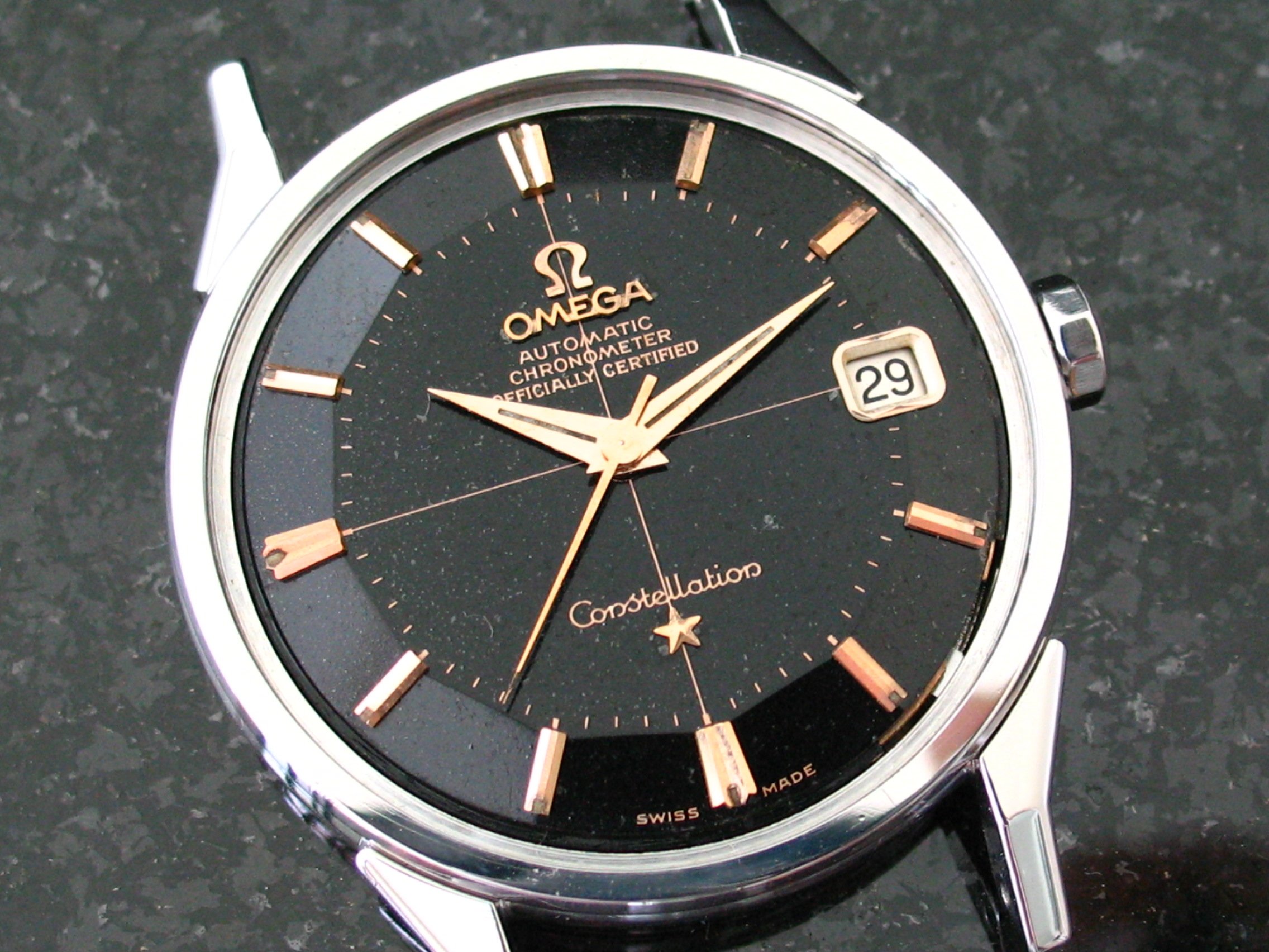

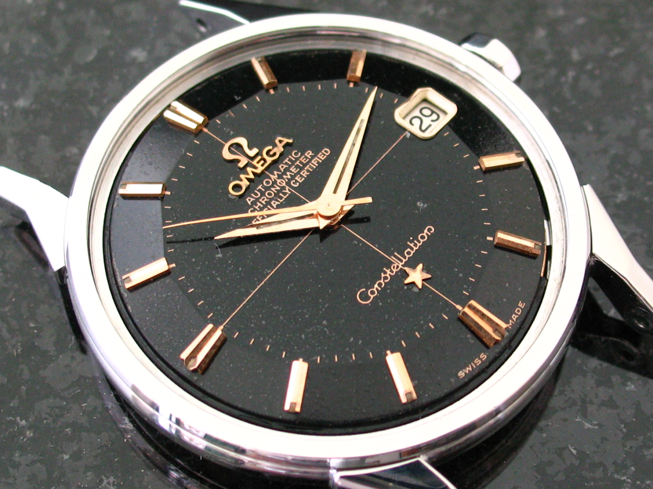

Posts 13,489 Likes 31,804 X350 XJR ·Nov 21, 2022·Vintage Omega Aficionado Here is a 14902 I had some years ago, rose gold figures and print.
N Posts 1,120 Likes 1,792 Noddyman ·Nov 21, 2022 Black indices on a black dial Connie, not seen that before. It does appear to be a redial.
Posts 694 Likes 839 bananapeanut ·Nov 21, 2022 N Noddyman Black indices on a black dial Connie, not seen that before. It does appear to be a redial. Thanks for pointing it out. Also, as @MtV noticed, the tension ring should be stainless steel in a SS case, not gold, regardless of the dial color. Edited: Nov 22, 2022
