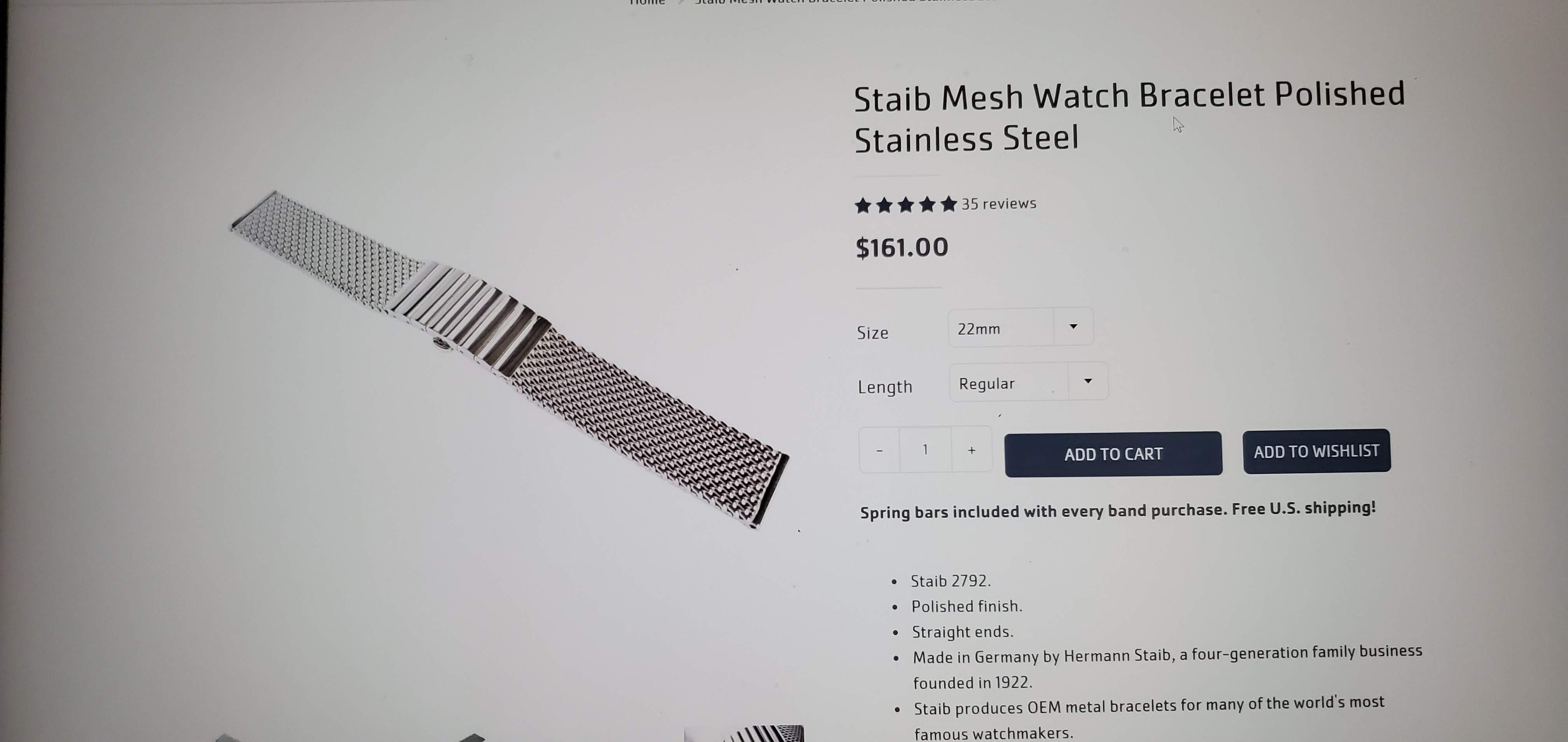

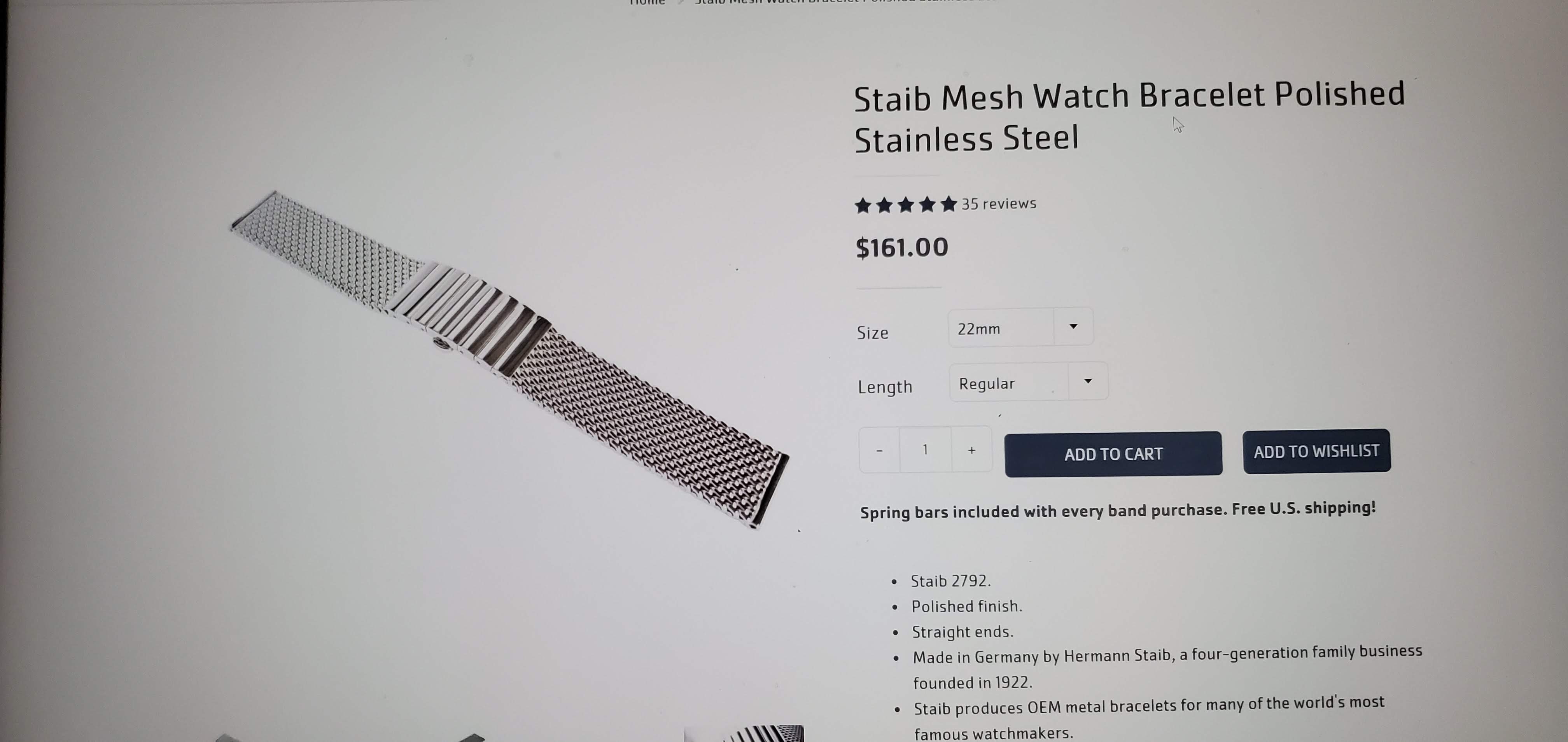

Hey guys, I want to get this staib mesh bracelet for my omega seamaster but it has a 21mm lug and for high quality mesh bracelets they simply dont exist. Has anyone ever filed down the lugs on a bracelet before? Is it a bad or good idea?

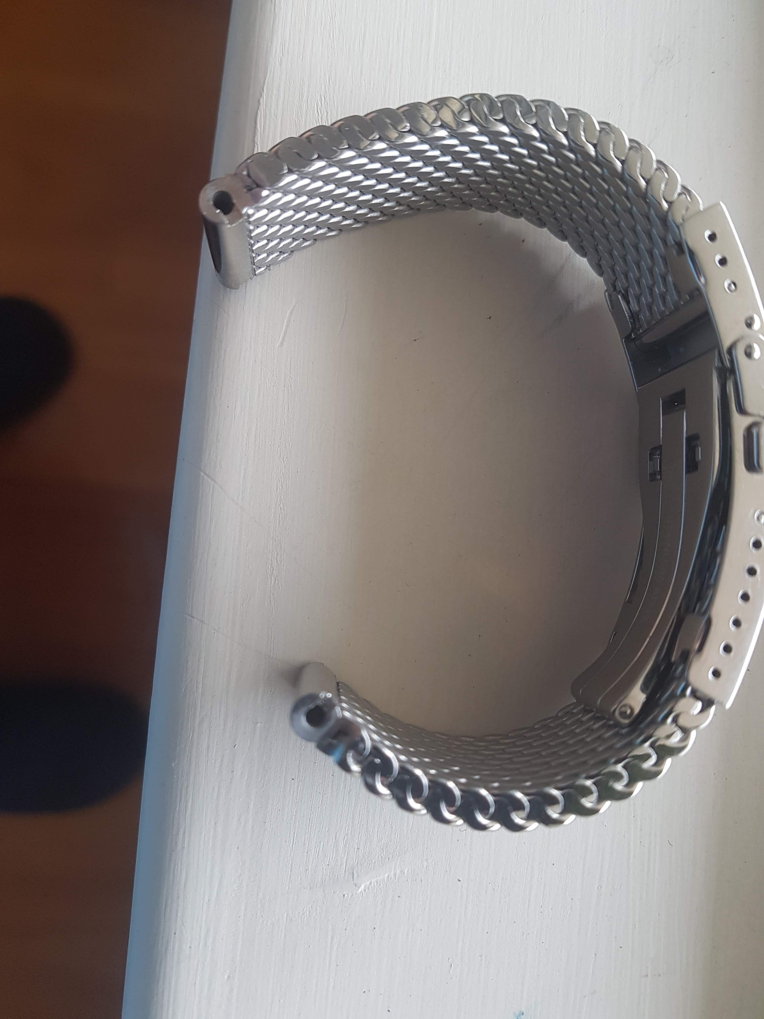

I assume you mean the end-links of a bracelet, and you're not contemplating actually altering the lugs. If I'm interpreting your question correctly, could you just post a photo of the bracelet. It might be fairly easy depending on the shape of the bracelet ends.

That is not going to work so well because the mesh is the same width as the end. You will be better off finding a bracelet where the end of the bracelet extends wider than the mesh. They exist.

I assume you mean the end-links of a bracelet, and you're not contemplating actually altering the lugs. If I'm interpreting your question correctly, could you just post a photo of the bracelet. It might be fairly easy depending on the shape of the bracelet ends.[/QUOTE

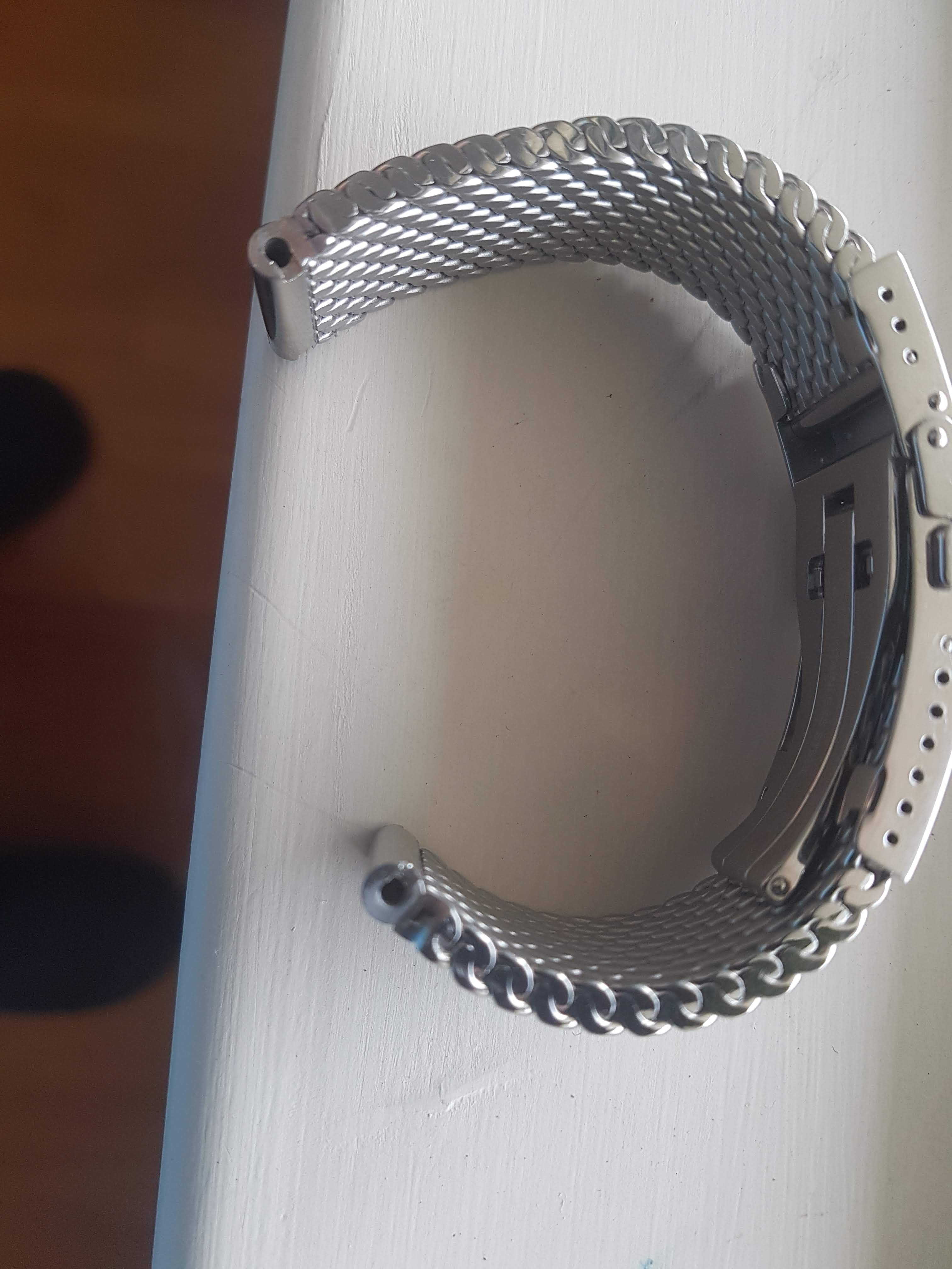

I just posted it, and yes I am not planning on touching my watch case. Only filing the bracelet itself

I assume you prefer the Milanese mesh, but if you would consider shark mesh bracelets, they have quite a bit of play at the ends because the links are separate. The shark mesh is better for a sport watch, and the Milanese for a dressier watch. Not sure what your watch looks like.

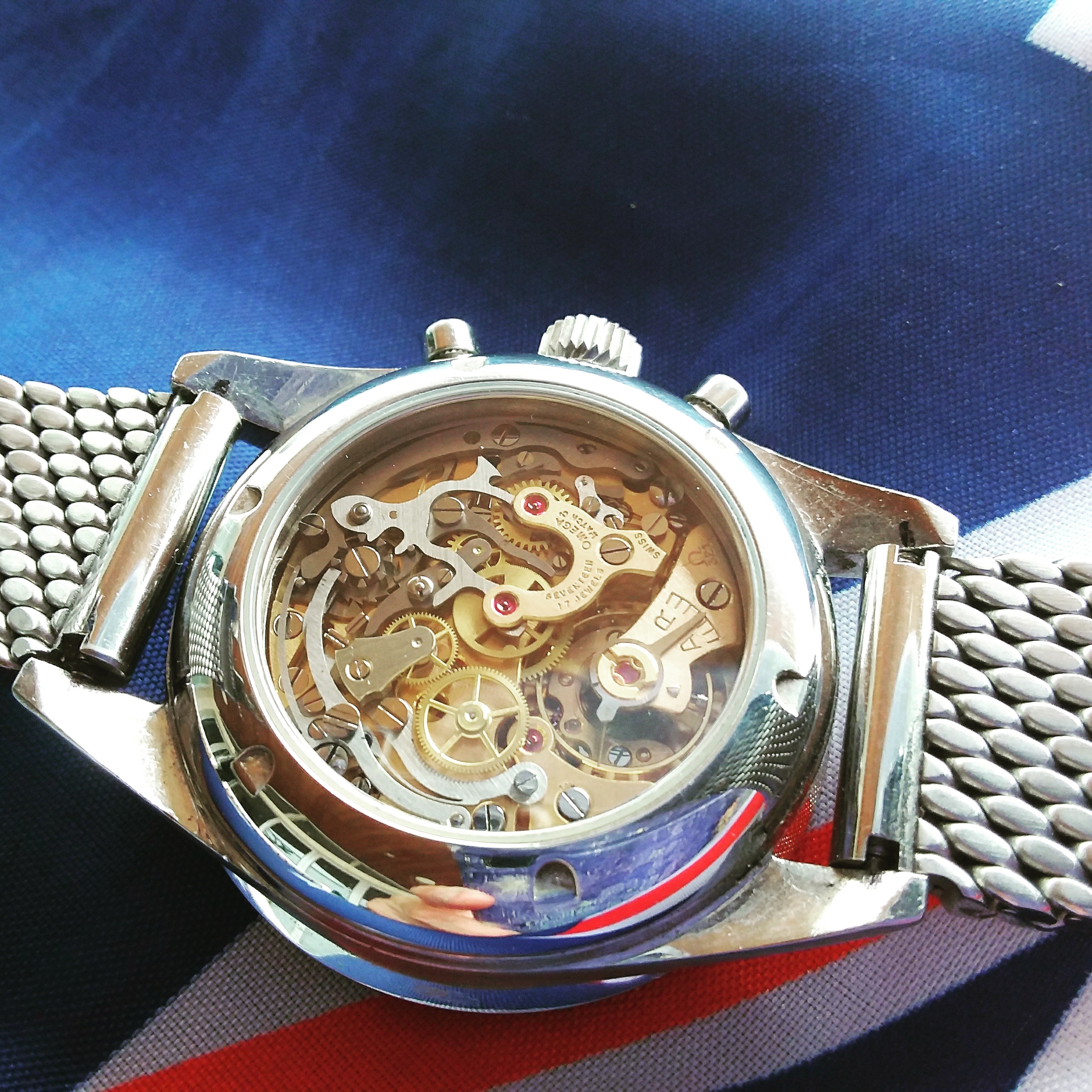

Yes, but I was young and foolish. The watch had been constantly on my wrist for 5 years and the original Corfam strap was getting rather smelly. The bracelet had already spent 8 years holding a Submariner on the wrist of a North Sea diver. Two bottles of moderately cheap wine and a bit of filing later I had a replacement for the old strap. If I could find the old strap the buckle alone is worth 500 quid today.
Still together after 45 years 👍
Today I would not use a hand file, I'd use a machine tool and do a neater job. Might fix the mismatch between case diameter and the end-piece too.
However, unless you are young and foolish and have access to machine tools get the right size!

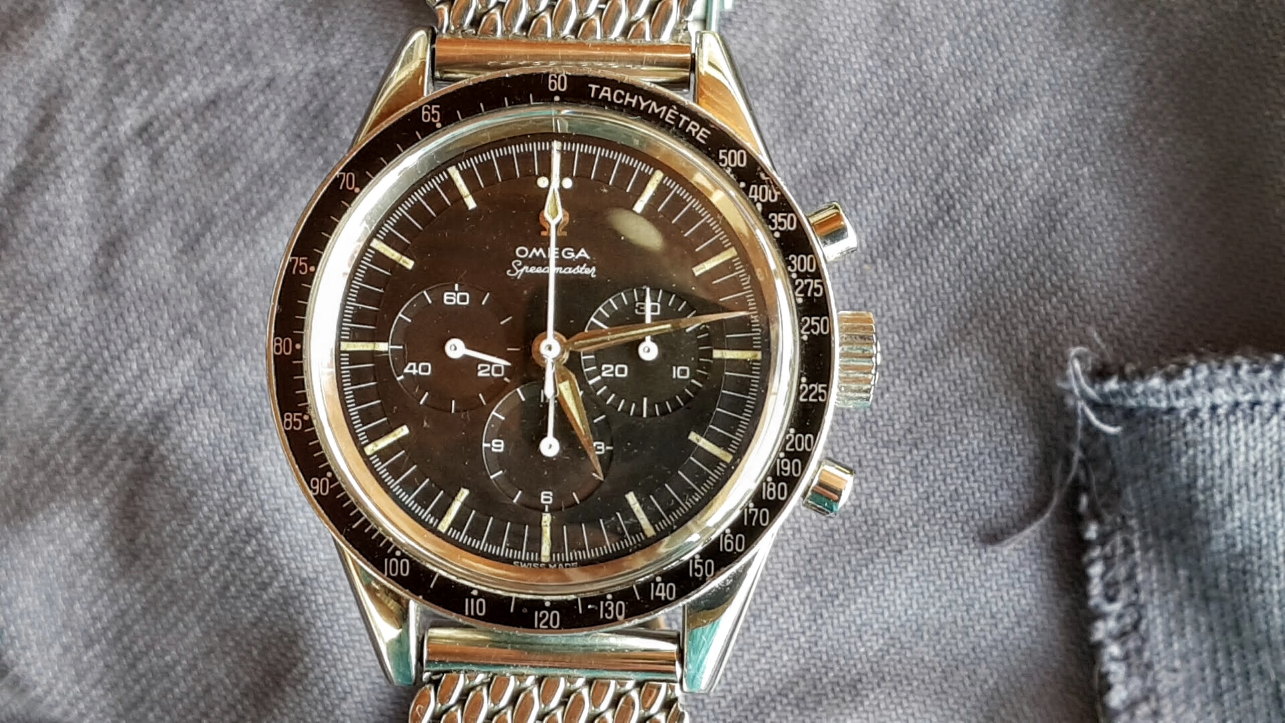

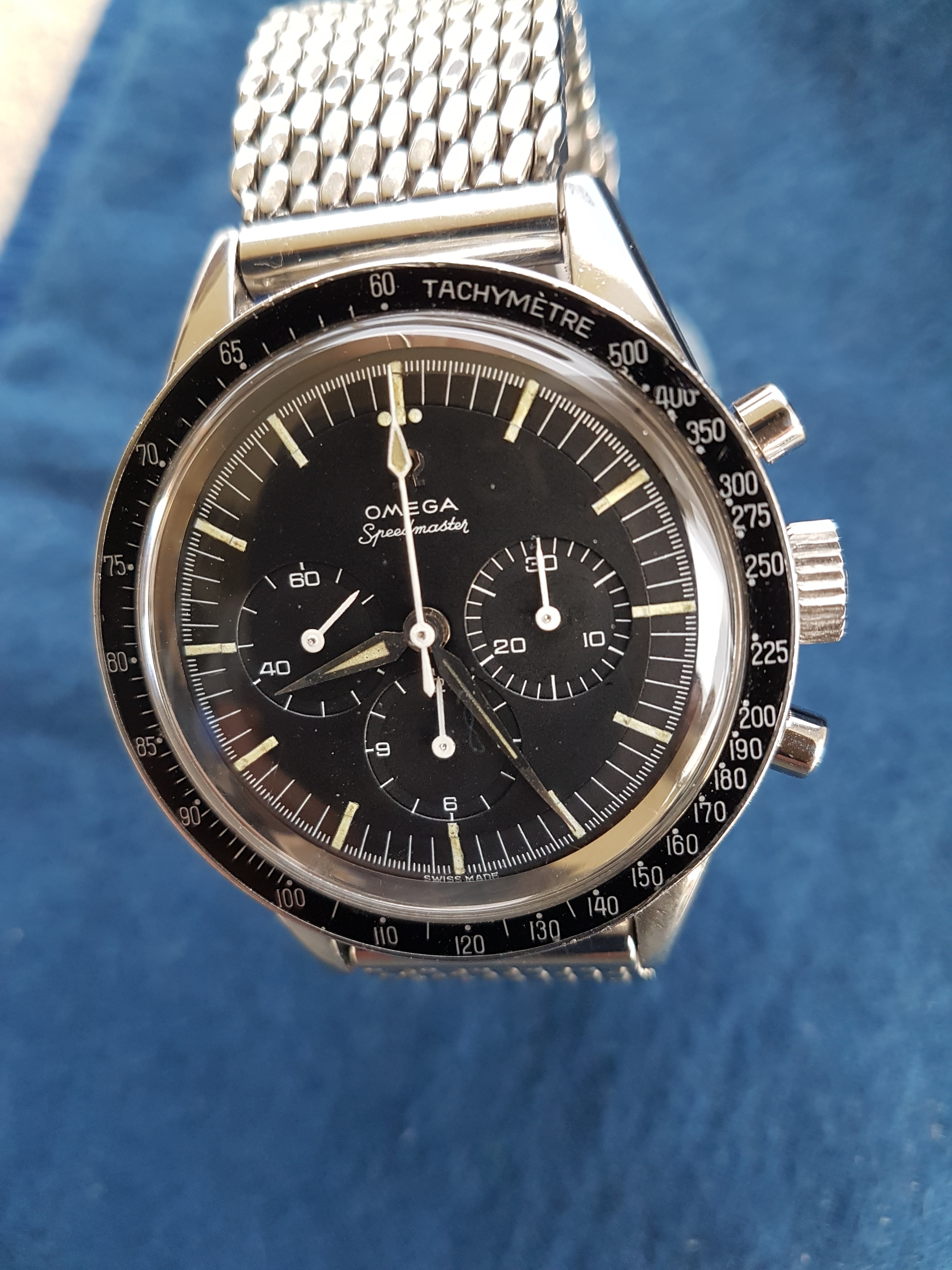

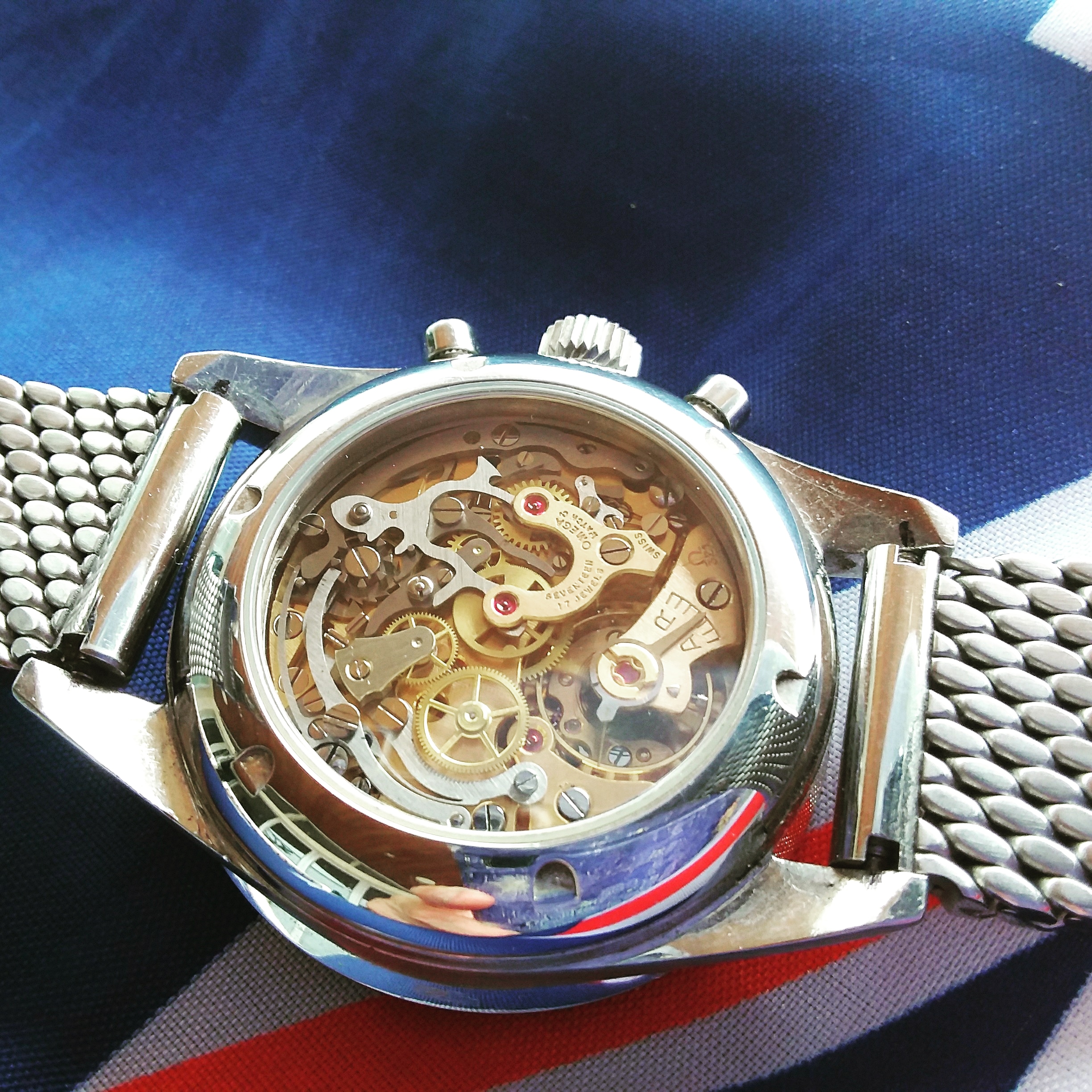

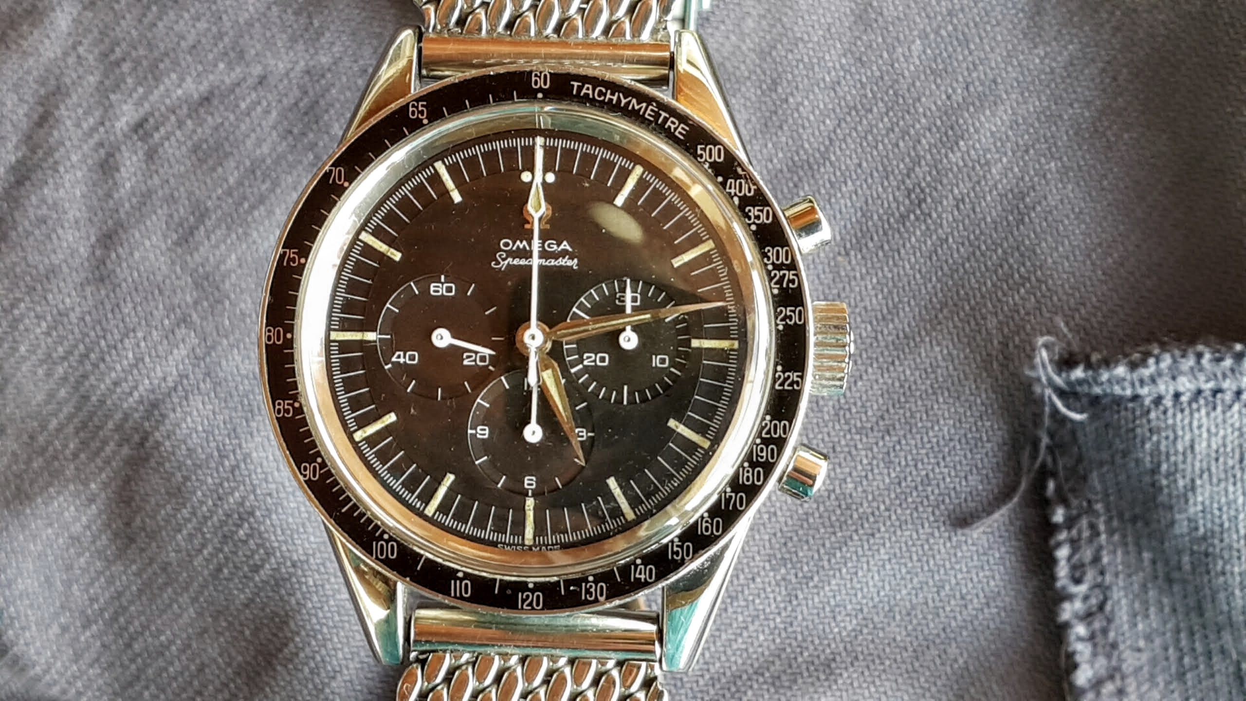

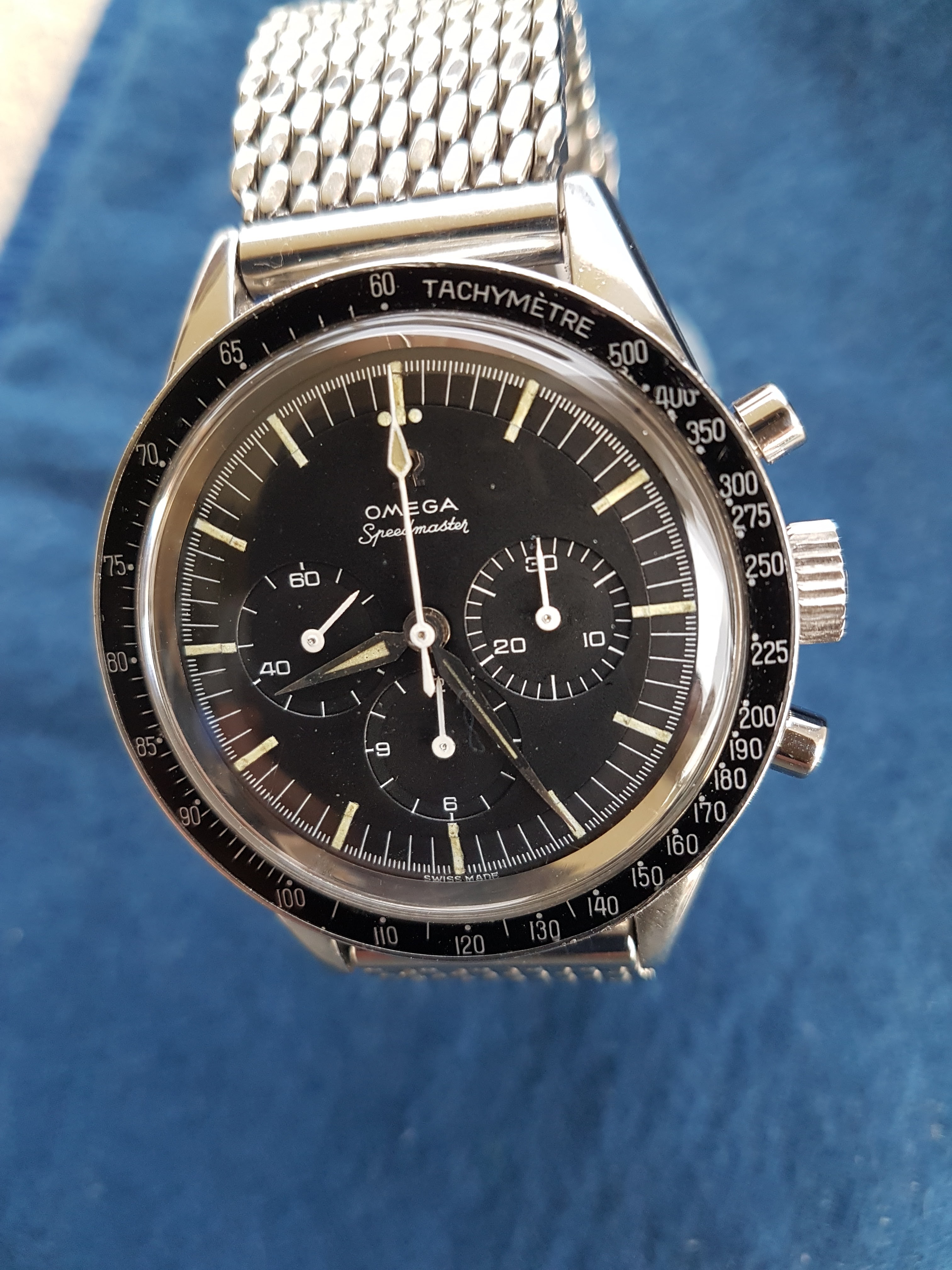

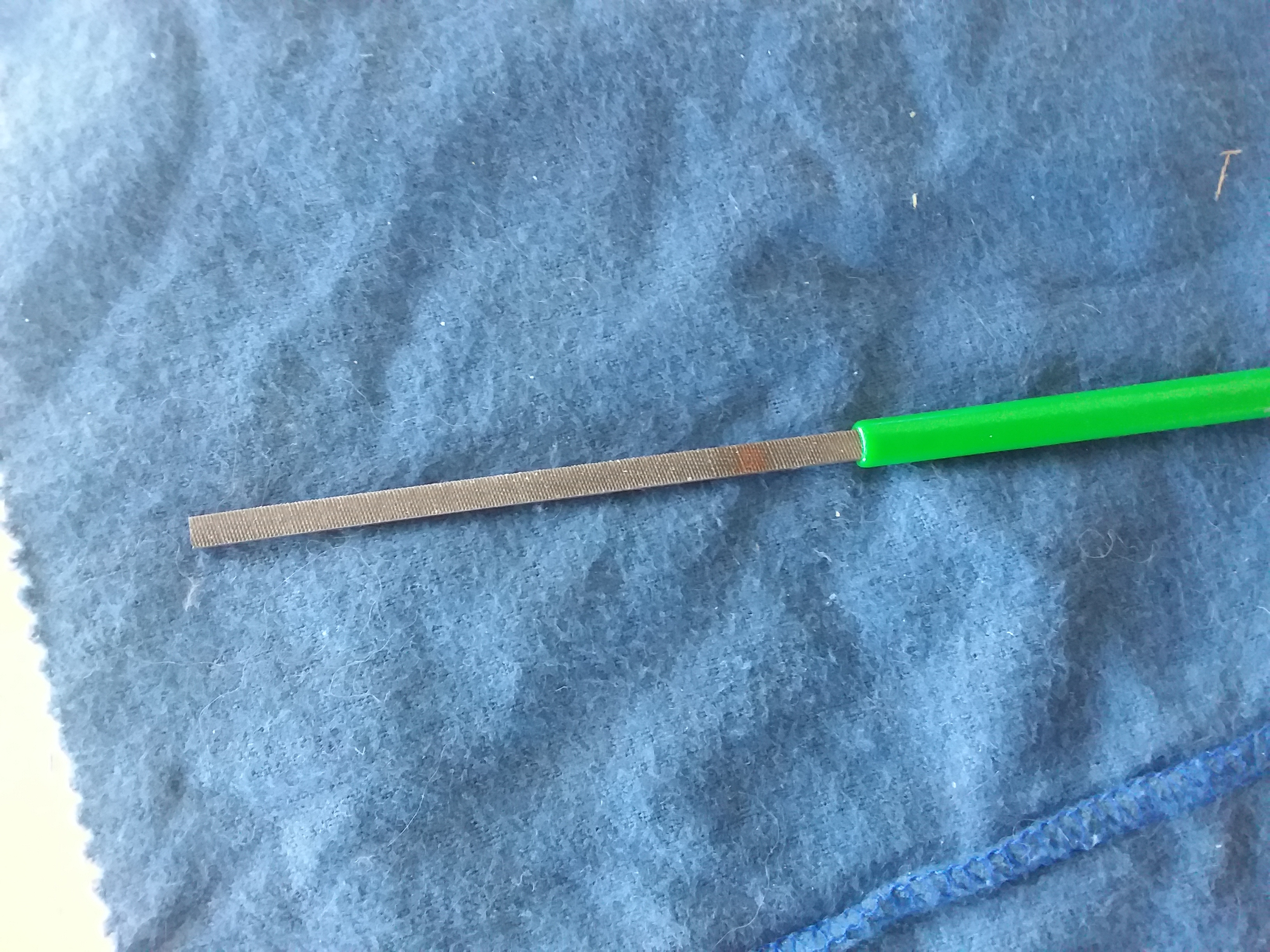

This is not a problem with high quality Staib bracelets. A 20mm Millanese is easily filed down to 19mm. Just be careful not to go too far. Measure and measure again using a digital caliper.
Thank you, that is exactly what I was looking for. You used a hand file correct?

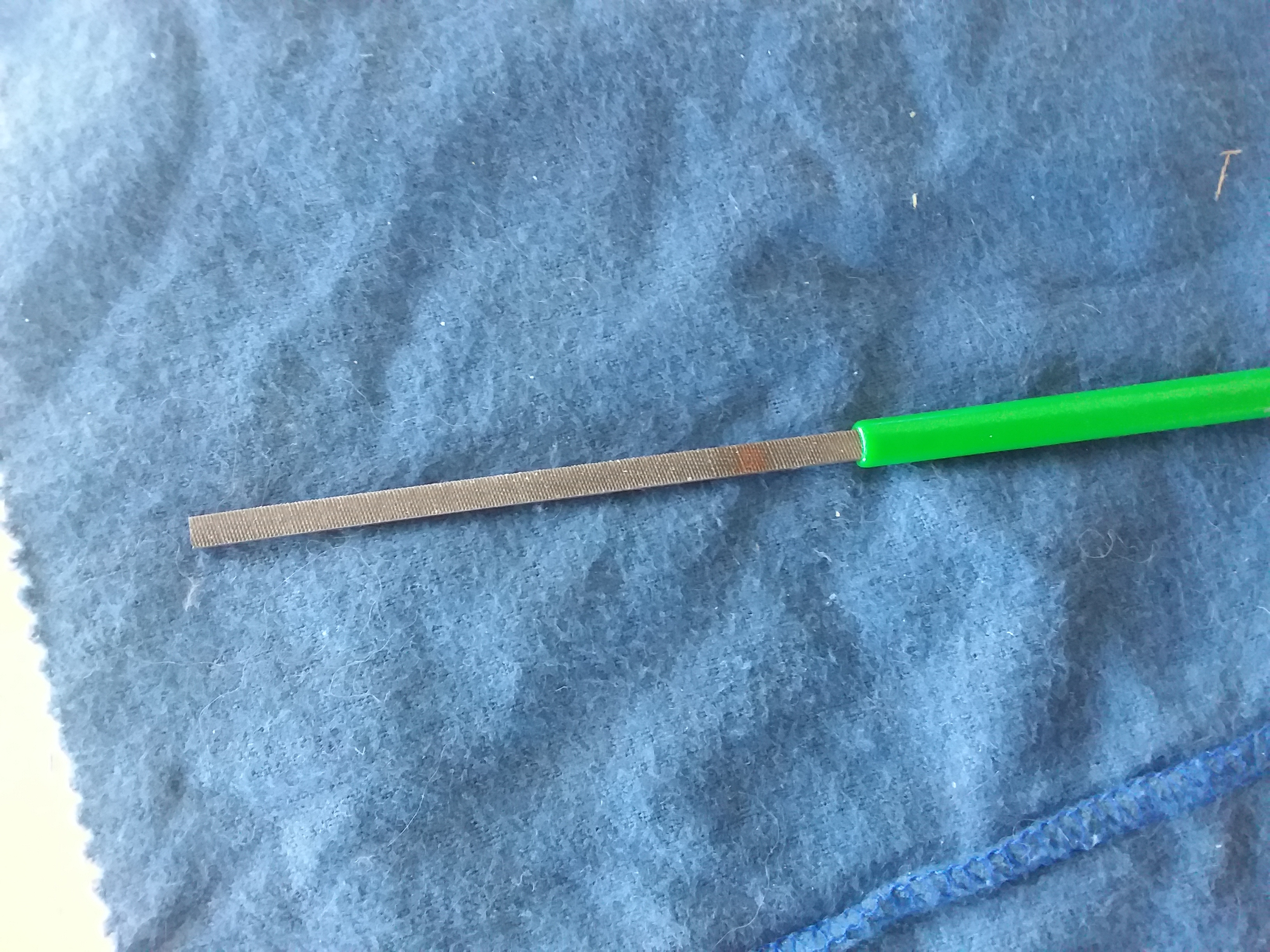

Yes a small modeling hand file.
Cheap and can be found in electronic parts shops. You can probably use a bigger file but more care needs to be taken.If you look very carefully I over did it on one end by 0.05mm, fortunately it doesn't notice on the wrist.

You may want to polish the raw edges after filing, or they may be a bit sharp.

Filing neatly needs a lot of practice, if you have that then OK. But if not pay for a jewellery workshop to do it.
