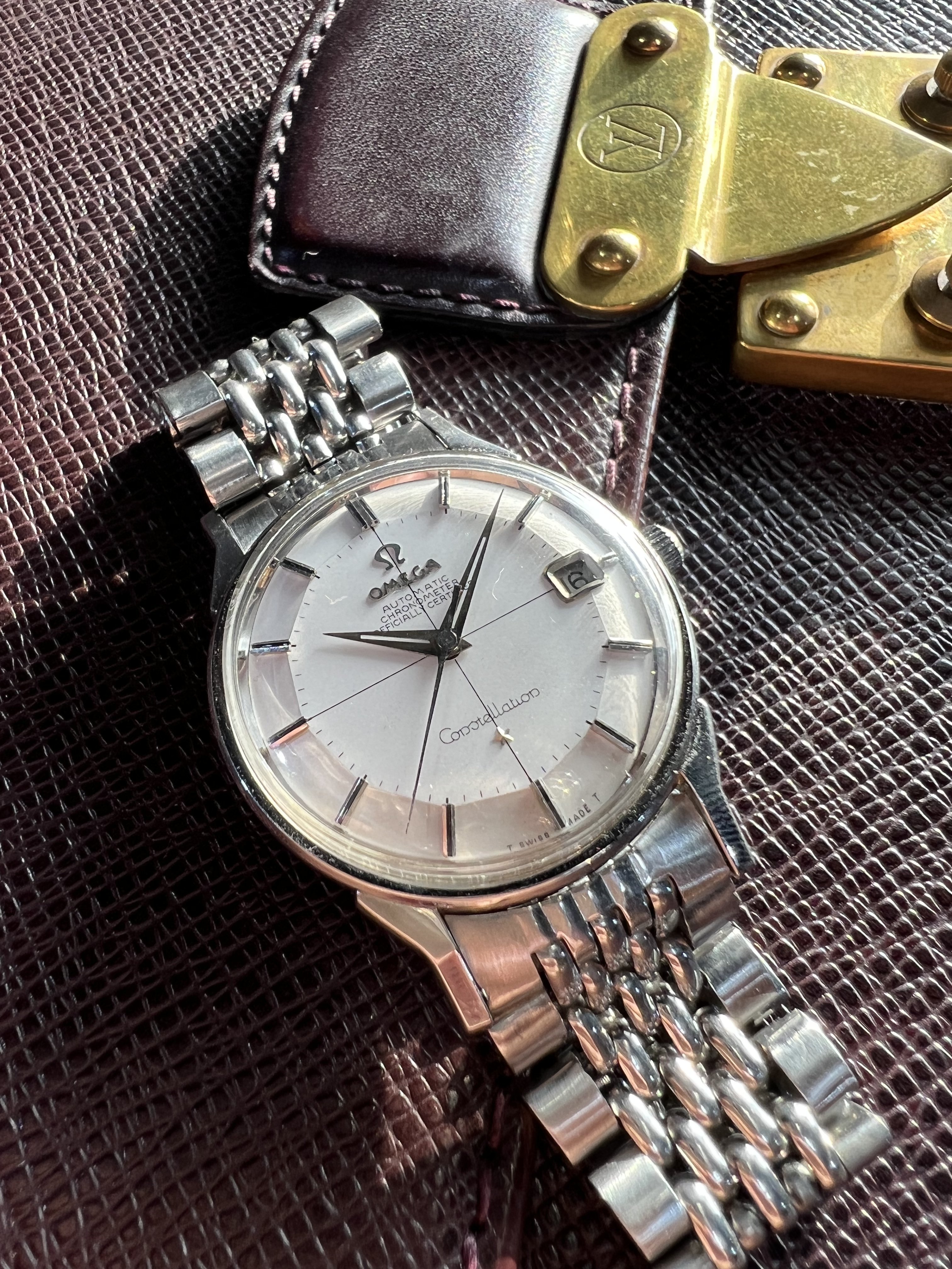

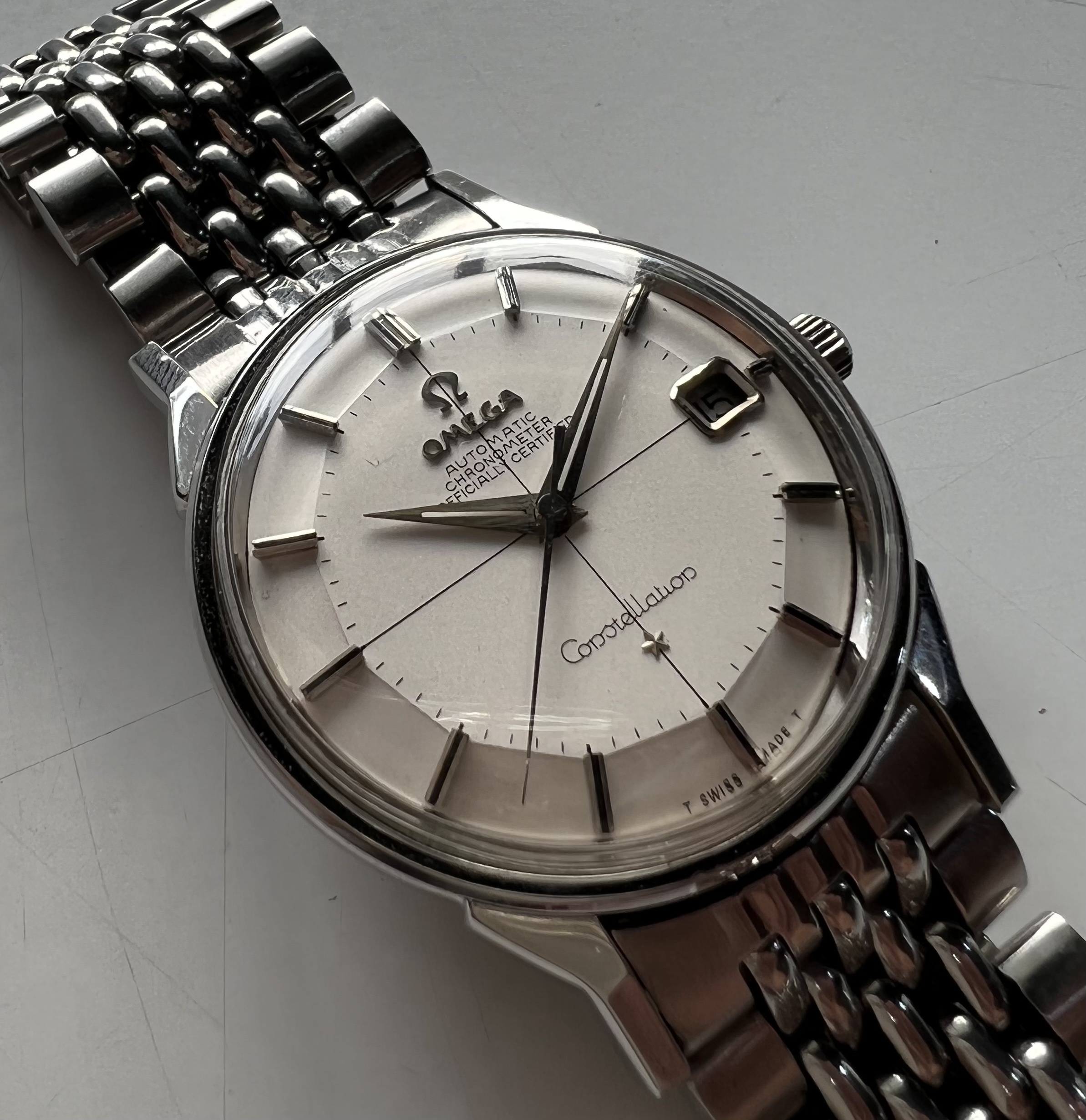

Just got this watch, it’s in pristine immaculate condition. Need some expert eye if the dial is fake or a redial.
1,258
2,738
I dont see any pristine detail in this watch. If you can return it, please do right away

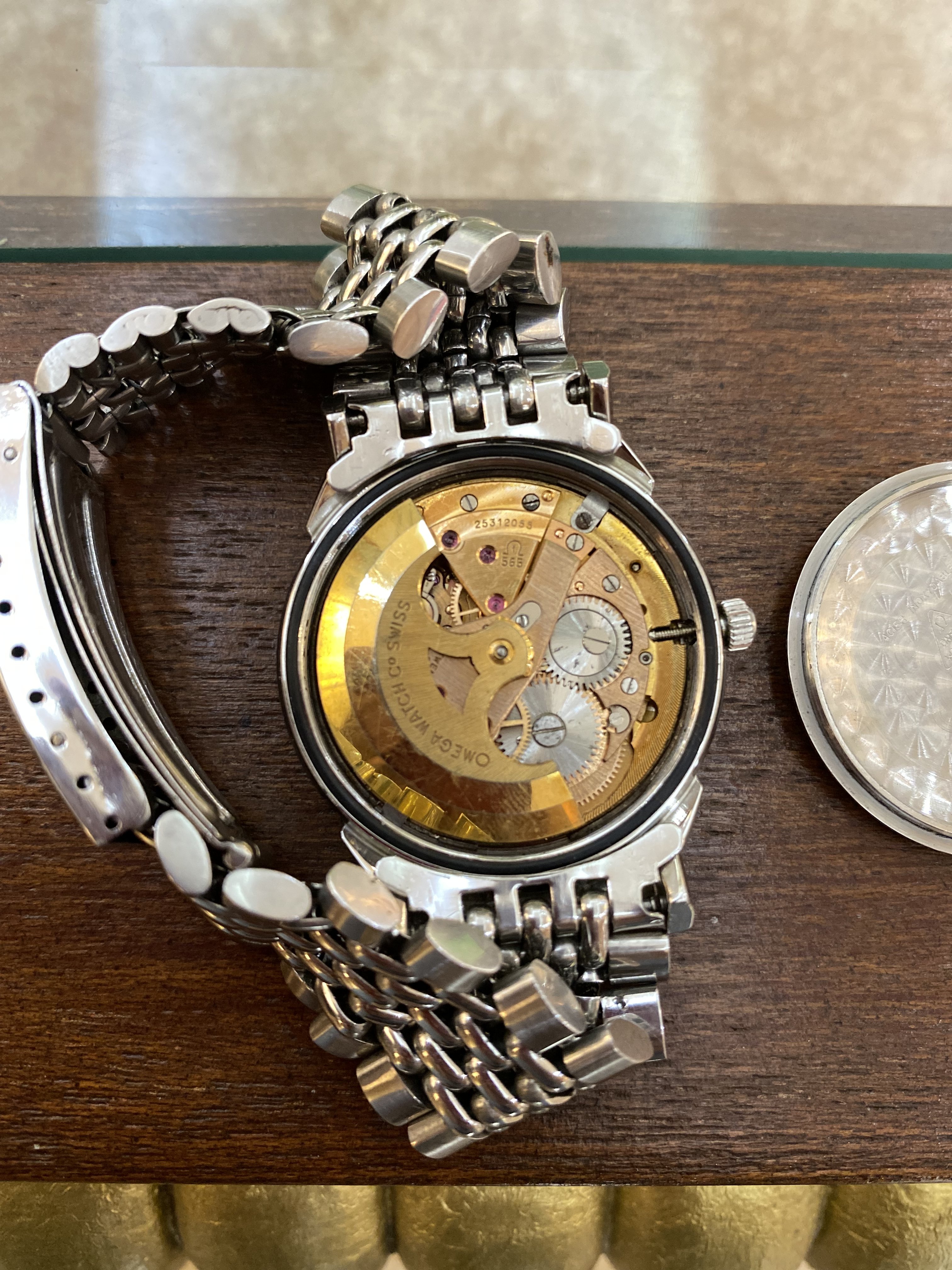

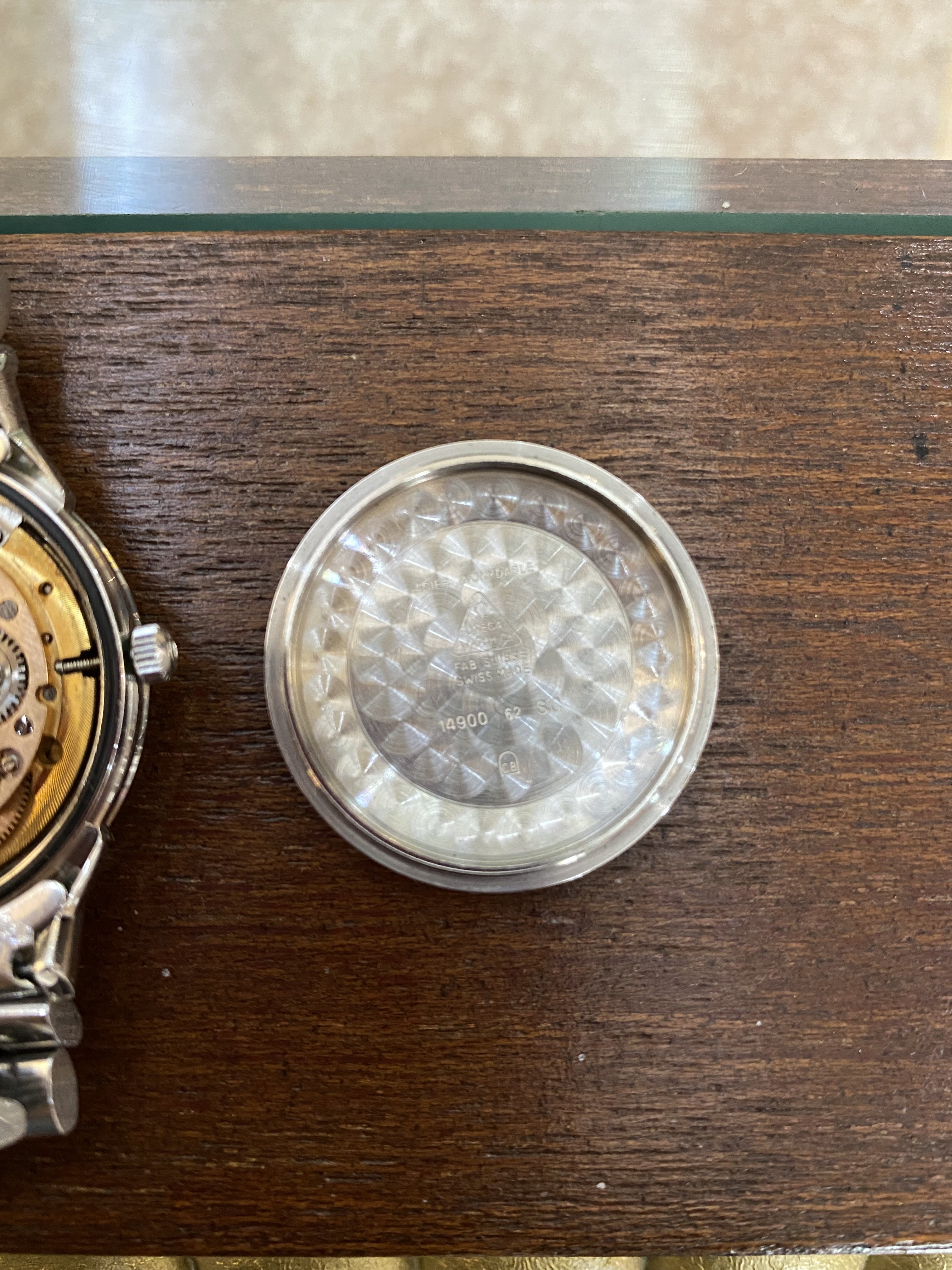

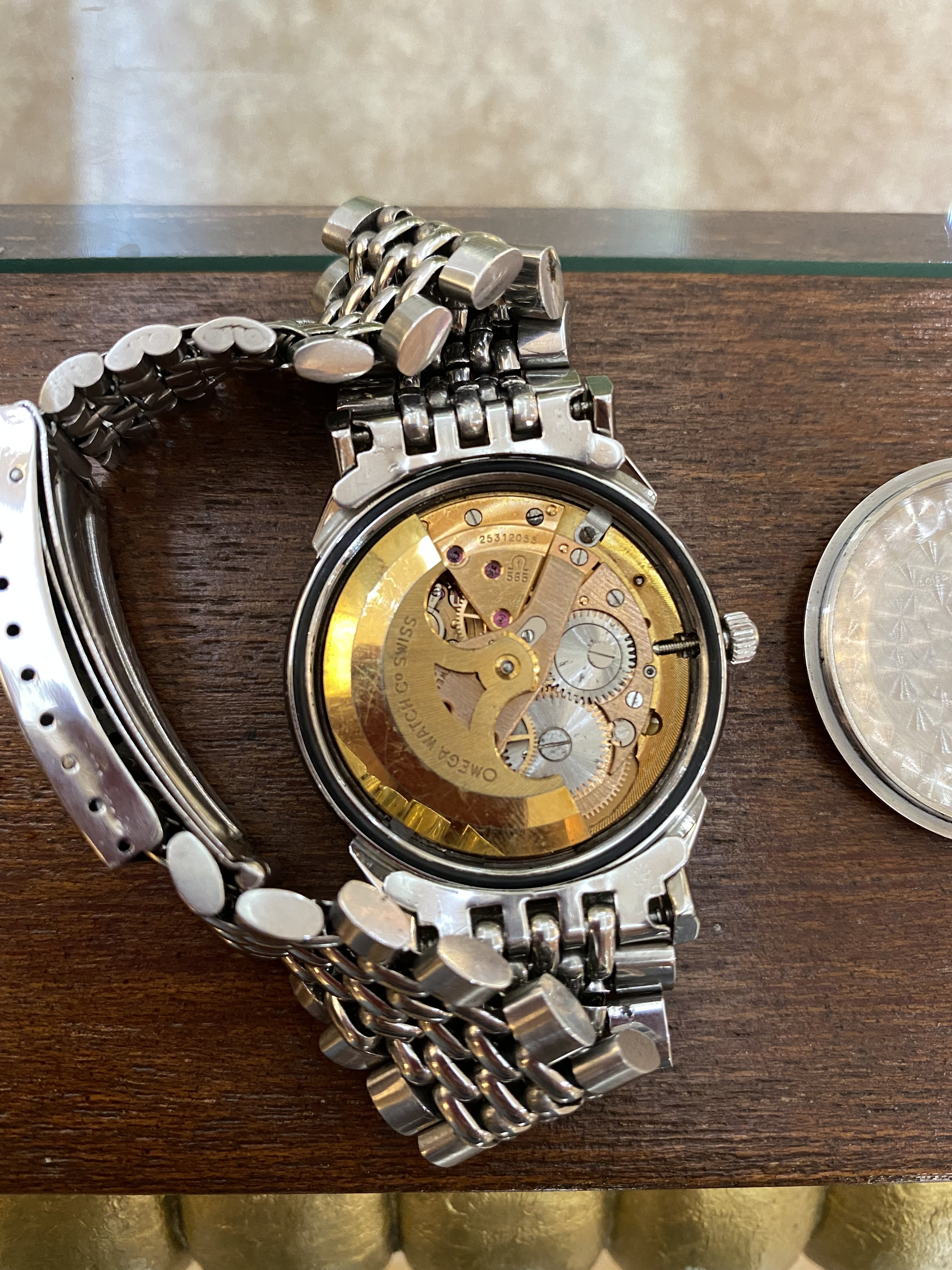

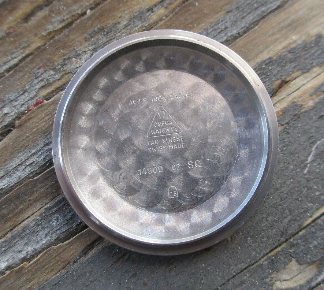

Forgot to send pics of the caseback. I was told it probably is a caliber 564 because the date adjust by moving to the second position
13,493
31,814

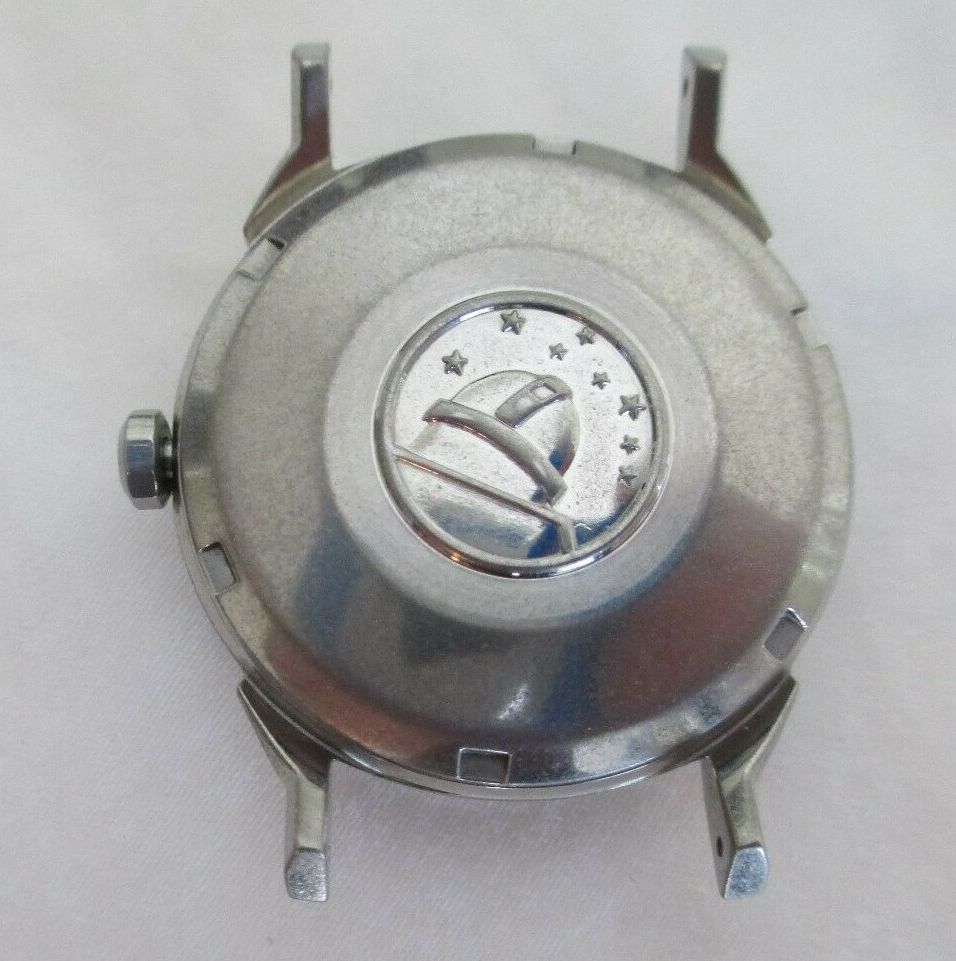

Can we see the outside of the back?
Inside of the back looks like a common fake.

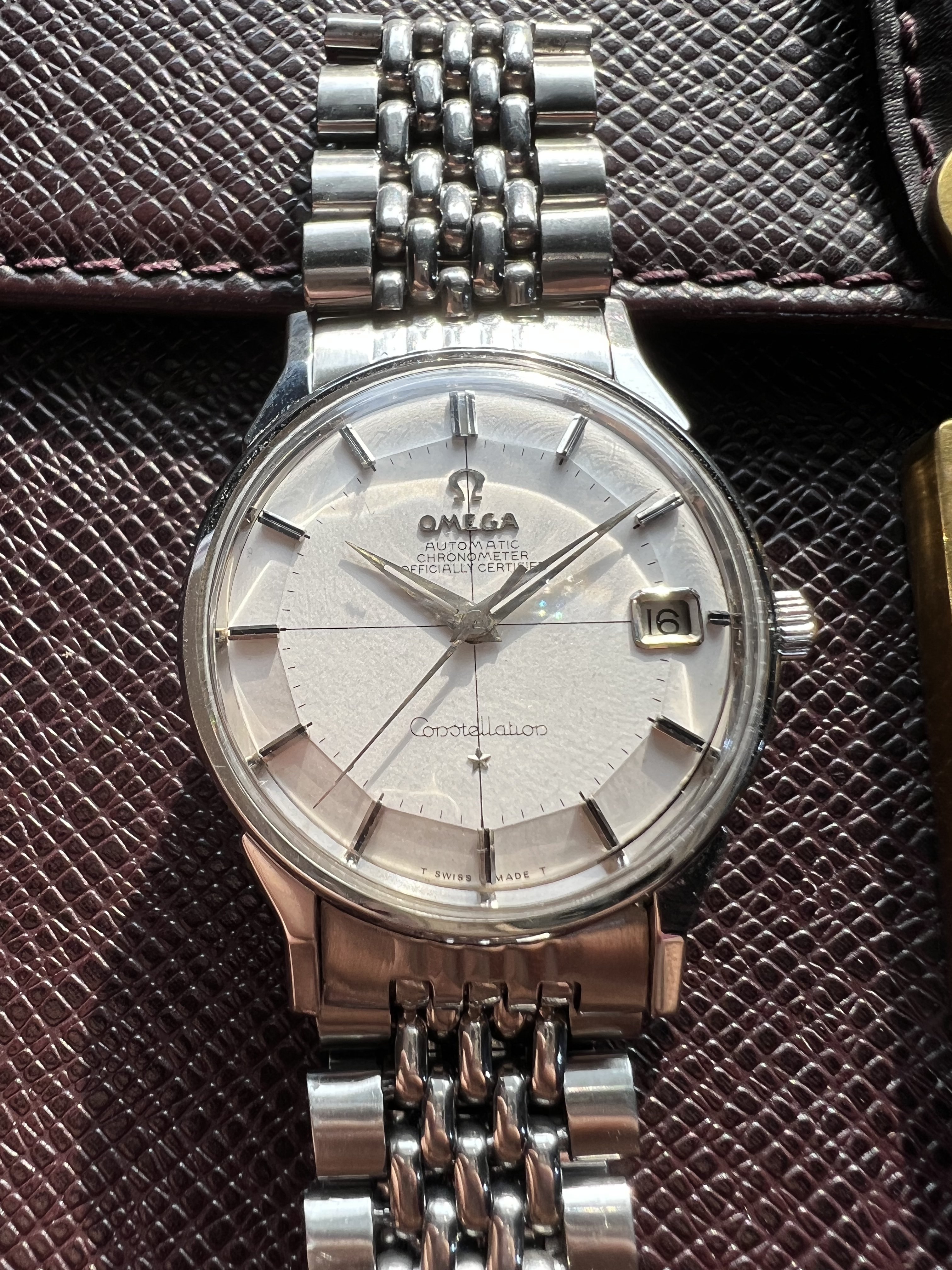

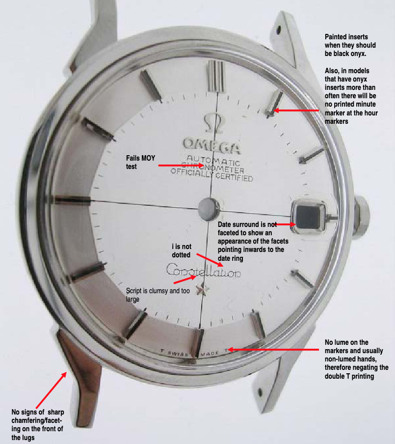

Fake dial, wrong non-chronometer movement and also looks like a fake case.
I’m afraid you’ve bought a dud.
As above, return it if you can.

Hi @augustusron,
Well, there you have it - which is a shame. I hope you didn’t pay too much. You haven’t posted where you bought it or how much you paid.
Best to try to get a refund but if you can’t, if you were to try to sell it on, you’d have to admit that it’s a fake or franken.
So, if you can’t get a refund, and can’t get your money back re-selling it, you should probably treat it as a 'stylish' expensive 'beater' and wear the hell out of it. 99% of the people who see it on your wrist will have no idea it’s a fake

Couple of thoughts from fairly new Omega collector and I have to say the pie-pans are not my specialty. Nothing in the watch is original, that I can see, wrong typeface, wrong movement and the caseback is not detailed and markings look too modern.
But: do we know that the case and dial are really counterfeit ie of modern making? I would think that making a pie-pan dial from scratch requires a little more special tools than a flat dial would, for example. The printing is wrong, that thing is clear to me. Also the case (to me) just looks like it's been polished too far.
I mean is it financially feasible to manufacture these parts for this kind of watches? After all, they are not in _so_high prices compared to some others.
But: do we know that the case and dial are really counterfeit ie of modern making? I would think that making a pie-pan dial from scratch requires a little more special tools than a flat dial would, for example. Also the case (to me) just looks like it's been polished too far. I mean is it financially feasible to manufacture these parts for this kind of watches? After all, they are not in _so_high prices compared to some others.
There are many many fake constellations on the market and have been so for decades. especially the 14900s and 14902s

This watch was a rookie error but the immediate red flag is a dial with Ts but no lume. The 5 row BOR bracelet is also widely faked and not normally seen on the dog legs so that is also suspect.
This watch looks ok from 3 feet but is a disaster up close. It fails nearly every test.
Thanks for the info, this is how one learns! And now that I look more closely, the case dimensions look bit off too. Bezel looks too thin etc.
