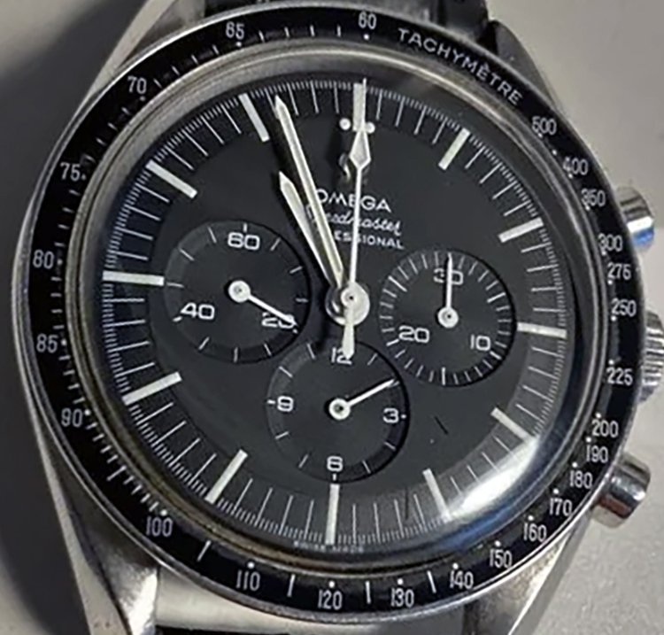

Hello!
My first question here, and sorry for the bad pic, it's not taken by me, kindly stolen from an ad, the watch is supposed to be a -65, i'm a noob regarding Speedy's but if i say this is a service dial am i totally wrong or?
guess the hands are correct but new.
Thanks in advance.Thommy.
52
29
And the bezel?
Did'nt ask cos it's pretty obvious, not a D O N, so my quallyfied newbie guess is it's perhaps a mid -90 bezel, maybe dial, hands and bezel was swapped then.

so it's a service dial then?
And just about everything else as well
By the way, just found this:
A service dial. Swisslimitededitions are just a reseller of parts they acquired.
52
29
Looks like service everything.
That was my suspicions to, even though i'm a newbie.
