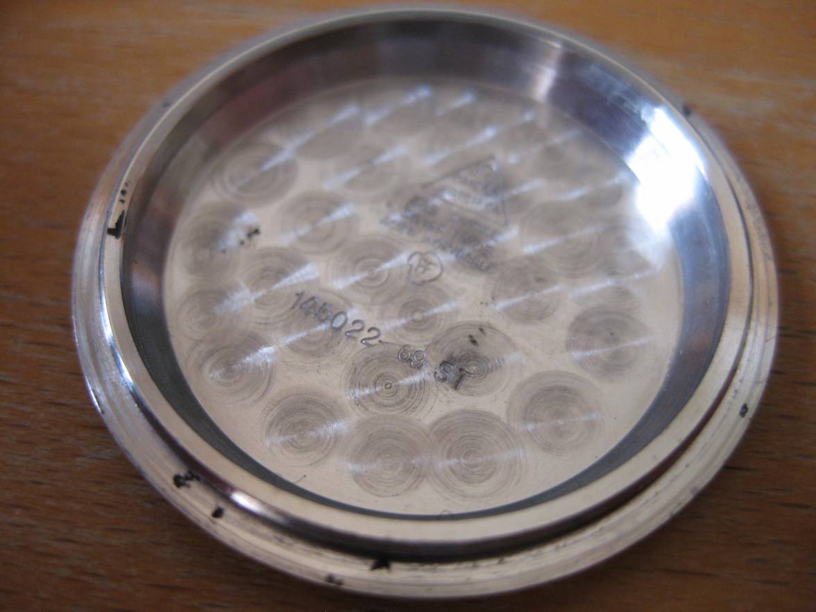

I got this not long ago. I understood it to be a transitional...a later, possibly last year of the transitional. But, with all that's in thread i'm not so sure. So here are my photos. The only thing I'm certain is the bracelet is a 1039, with 516 end pieces, ca. 861 and serial number dating to 1971. Any and all comments encouraged and welcomed. .
446
531
That is a '69 premoon. I'm wearing mine now. It's not a transitional. The transitional has the 321 dial with the applied Omega. It's often referred to as the '69 transitional. Yours has the 861 dial. The caseback has no inscription about the moon, hence it's a premoon. Some people refer to it as transitional because it has the premoon caseback.
1,159
110

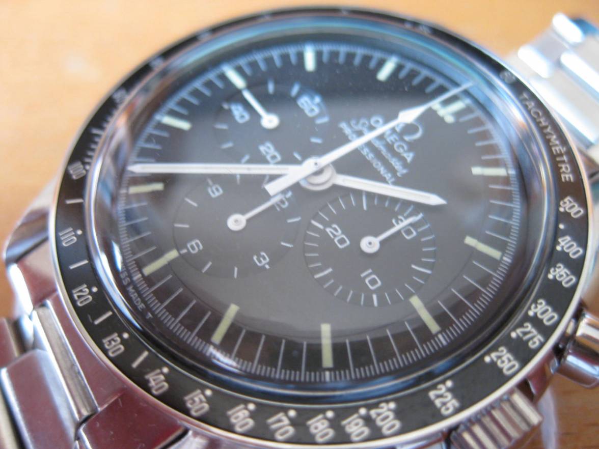

These are my to 1968 Speedmasters. Both have the 861 movement, yet both have very different dials. The difference in the dials is the main reason I keep both because visually they are two completely different looking watches.
The one of the left has the dial that I most associate the 145.012. I have often wondered where the one on the right falls in the spectrum of dials. I had once asked if there was sort of transitional dial between the 145.012 and the current day 145.022 because the one on the right seems to fall in between. The left appears to be the exact dial on the 321 145.012's. The right is similar, but very different, when held side by side. The right has larger 5min markers (longer), longer second markers, and the outer ring a larger diameter. Visually, side by side, the one on the right looks like a bigger dial.
Also, one of the most attractive difference is that the dial on the right is jet black while the dial on the left is lighter. At first I attributed it to fading but the older one shares the same color as my modern 145.022.
Left 2655369X Right 2655531X
597
406
Maybe it just looks that way because the minute hand of the left one is shorter😕 because the right one touches the second marks, the left one doesn't, my 145.012 original hand also doesn't touch them.
