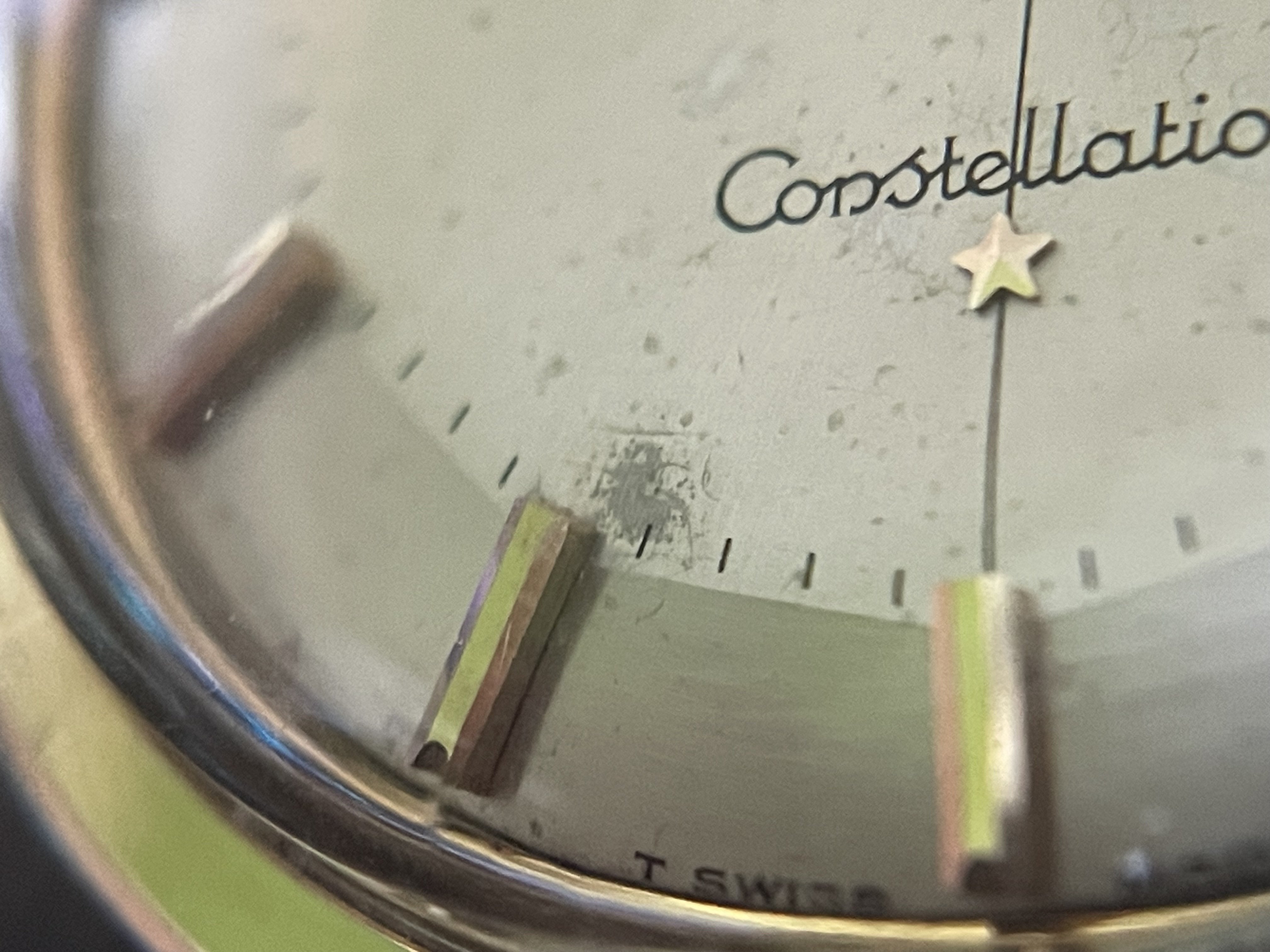

Hello, last friday, some moisture condensed on the watch crystal of my Constellation (not even droplets, just a bit of fog), after being indoors for a bit it went away and now the dial has this darker spot on it, which kinda pisses me off. Should i do something with it or will i just make things worse? I have no idea how something like that is even possible... IMG_7592.jpg

The damage is only going to get worse- get the watch into a ziplock of rice with the crown in the set position (will allow some moisture to escape) and get it to a watchmaker asap. Either the back or crown seal (or both) is toast and let moisture in.
Unfortunately, moisture ingress is one of the most common causes of dial damage.

i might be wrong, but i initially thought that the moisture didnt get inside, that it was just the one already in condensing. I wore it on a hot day and it started to rain, so couple droplets got on it...
i will, thanks for the reply
Moisture can certainly get inside a watch unless it is properly sealed. And you don't know if it is sealed unless you have the watch pressure checked.
