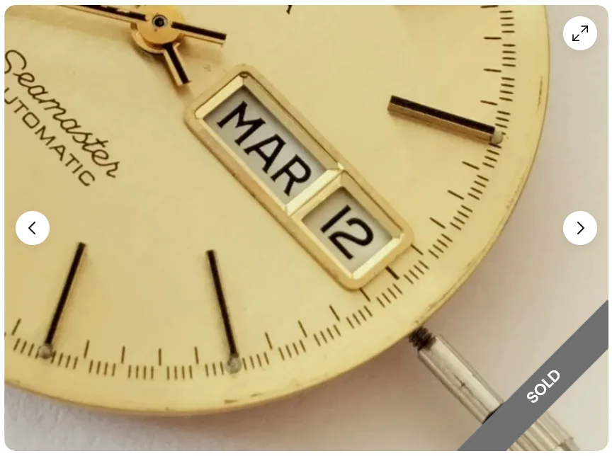

I am stuck with one of projects: Omega Geneve day-date on cal.1022 - I am missing the date disc (non plastic) in white. (
I can not find this part in nos condition.
I will be grateful for your help with this task - I am almost sure that this is not a rare part, the caliber is quite common, so if someone knows where this part is available for sale, please let me know.
Omega part number for this item is: 1020-1580.
Thank you.

Caliber may be common, but not so with parts.
Jules Borel shows black on beige
One on EBay at $64 and used.
Used on 1020, 1021 and 1022
Also mention3d used on a Tissot 2940 caliber
Guy on eBay selling what he thinks fit, but his caliber numbers don’t match, so avoid those

Thanks for the info.
Then I'll take a donor mechanism with good calendar disks - it won't be a new part, but in good condition, it will also be a reserve in case of unforeseen technical problems with the project.

He lists it as fitting the 1020 and 1030. They’re not interchangeable. 1030 was not in the list I posted
I edited and removed the link when I saw the 1030 and rechecked. Don’t know why it still showed up
Email and cancel if possible. Sorry about that😵

Pls. don't worry about: nothing needs to cancel, as I purchased complete movement 1022 from another vendor.
