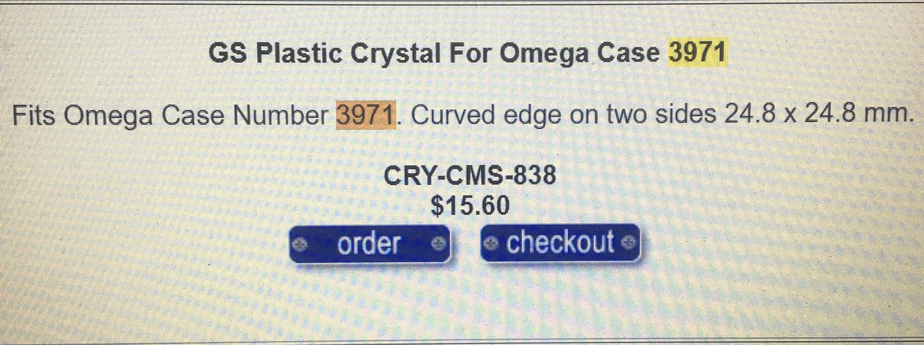

You can also try using either Sternkruez or GS catalogs to track down a generic crystal after removing and measuring your original crystal.

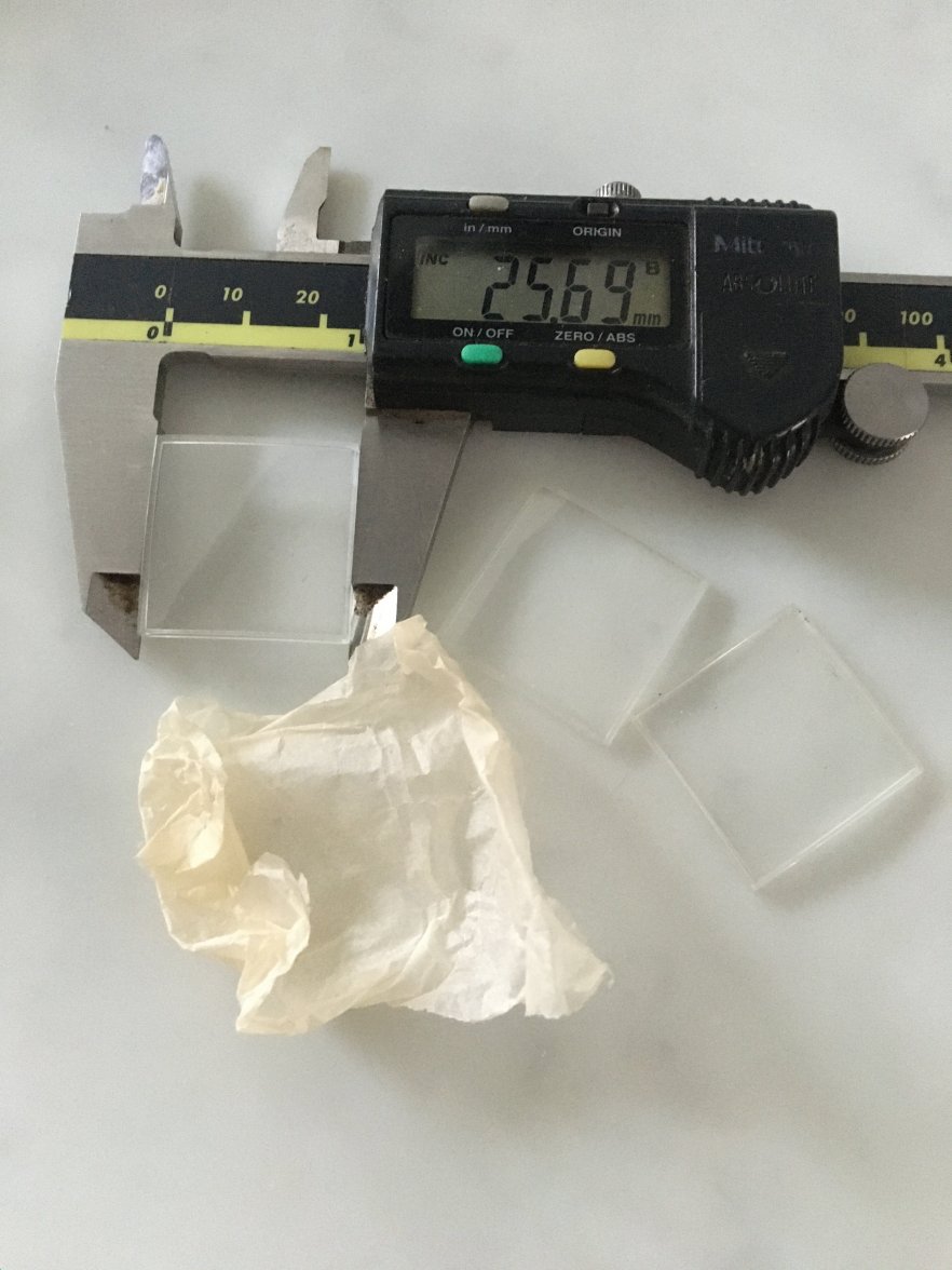

Just found these Omega plexi.
Might be correct? Although no reference number.
