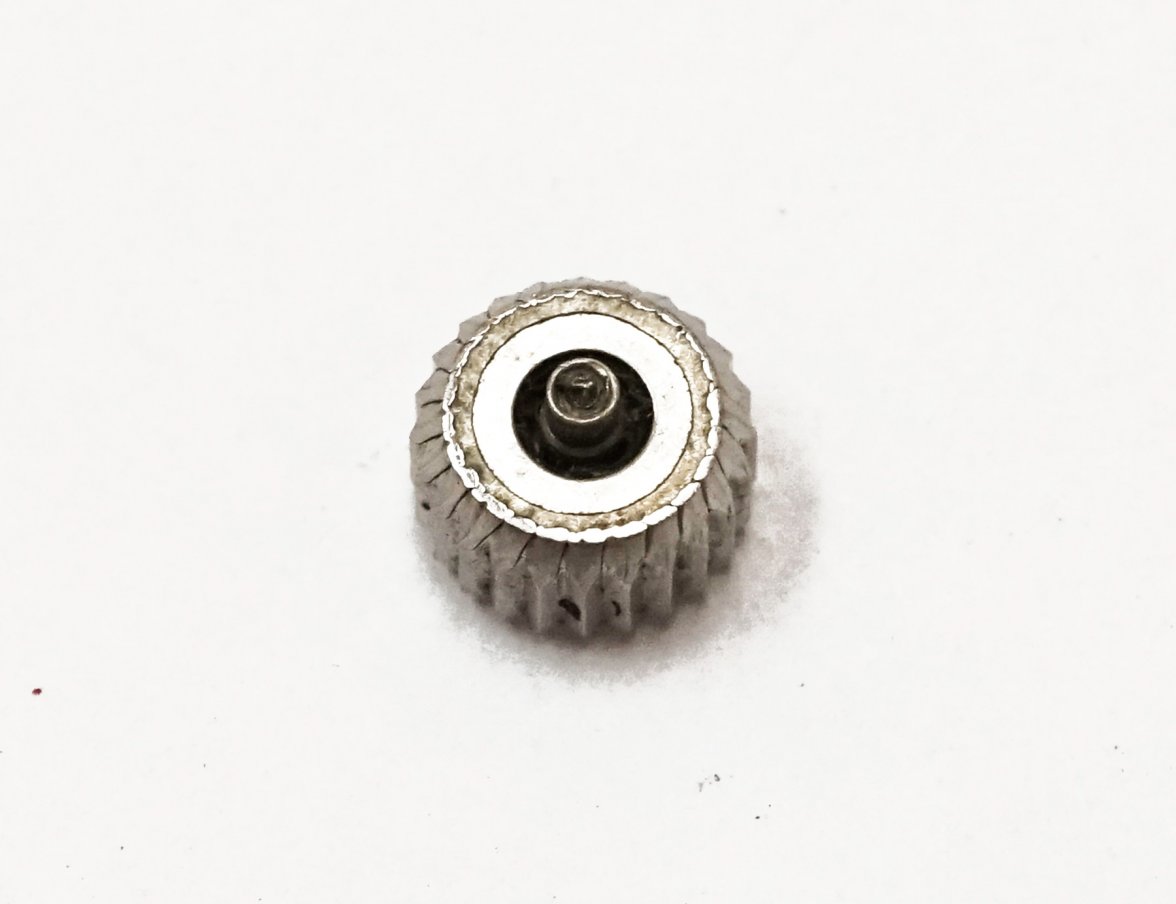

Posts 7,390 Likes 23,858 M'Bob ·Mar 9, 2021 So I purchased the pictured A1 crown, and in my haste, failed to read the fine print where is was mentioned that there’s a bit of stem left behind. Any suggestions on how to remove it, without also killing the gasket, would be most appreciated.
A Posts 31 Likes 13 Andy F ·Mar 9, 2021 As long as that bit of stem is steel alum should disolve it (thanks Archer). If its stainless, its not going to dissolve.
Posts 13,492 Likes 31,811 X350 XJR ·Mar 9, 2021·Vintage Omega Aficionado https://omegaforums.net/threads/removing-a-broken-stem-from-a-speedmaster-crown.61416/
