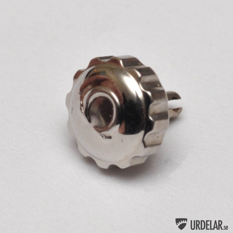

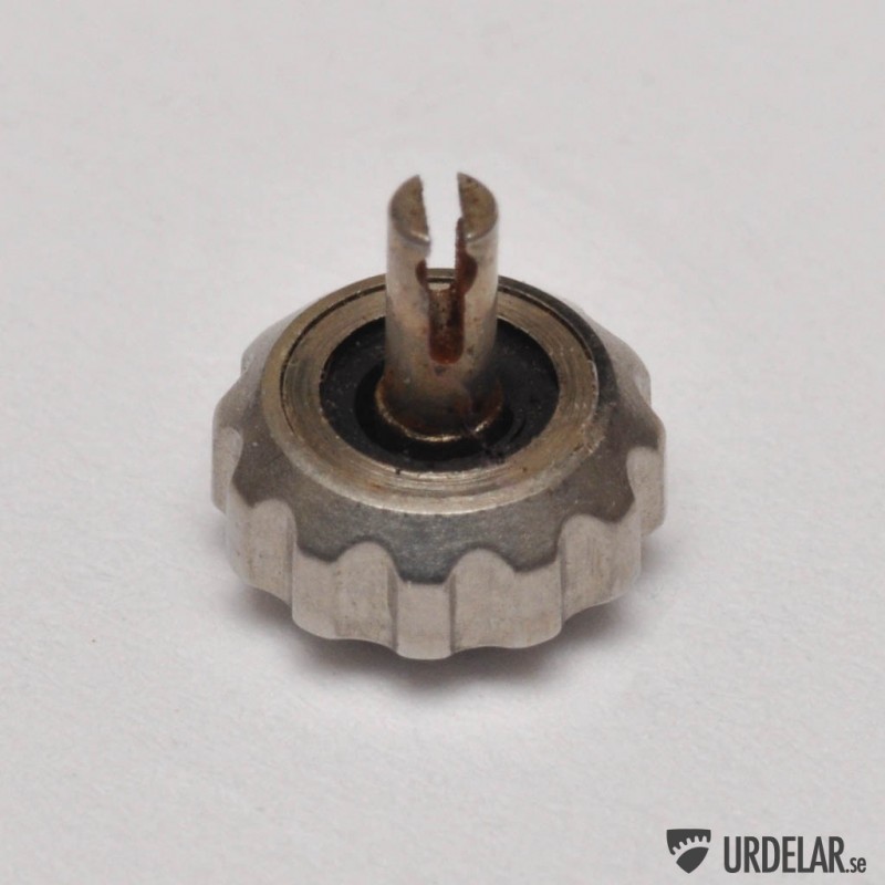

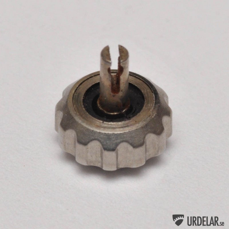

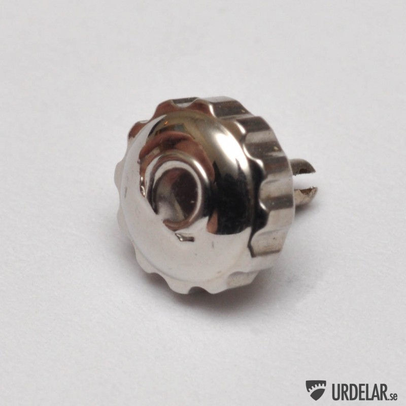

I've tried a few sources of information and from what I can piece together, I should be looking for a crown with the outer winding stem attached (female), similar to the pictures below:
http://www.urdelar.se/index.php?route=product/product&keyword=43041&product_id=1542
The specs according to this website are:
  • Diameter: 5.0 mm.
  • Complete with outer winding stem, length: 2.7 mm.
  • For tube: 2.0 mm.
This website lists this crown being suitable for a 166.020 SP, but I get a different part number from the "BILL OF MATERIALS OF 055ST1660020 - STEEL CASE CAL. 0565" extract from cousinsuk.com website, which lists the part number as 069ST42531 & 081ST9993.

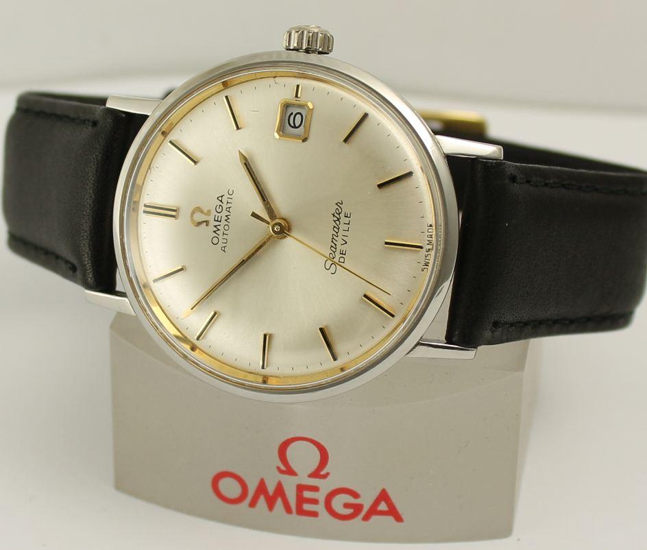

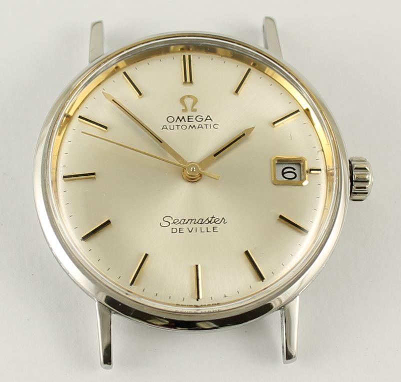

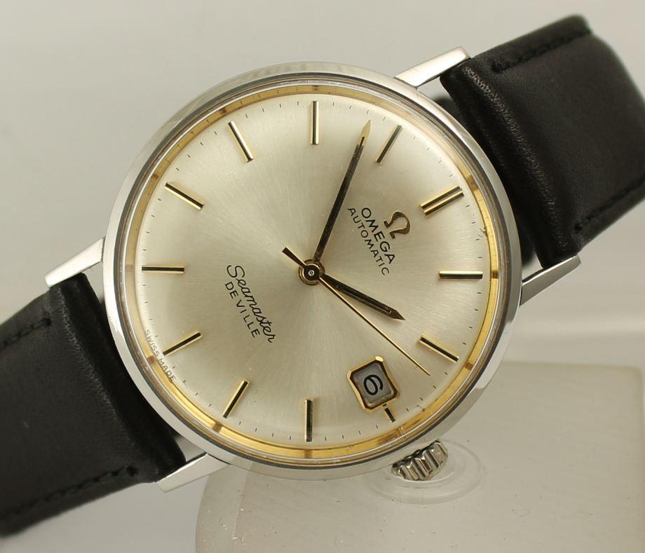

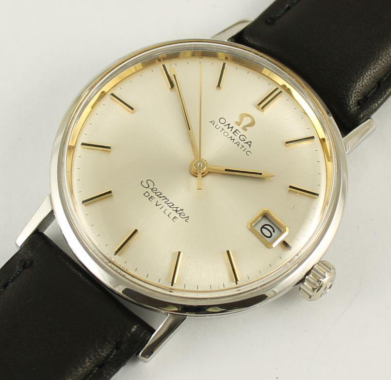

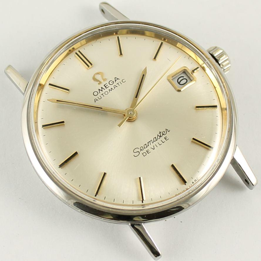

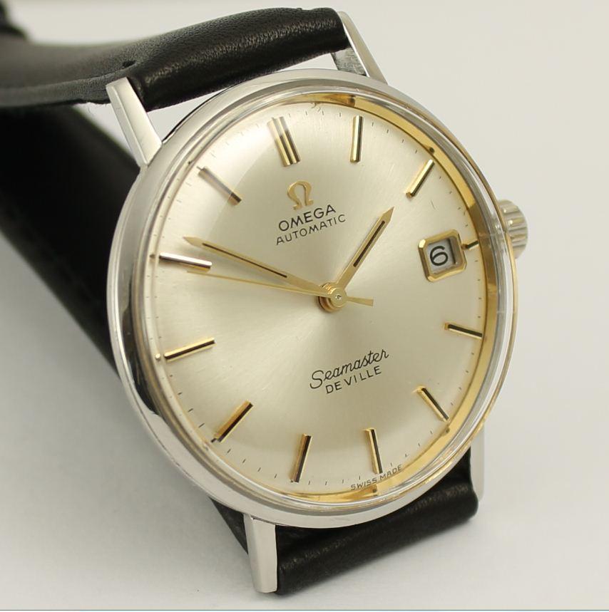

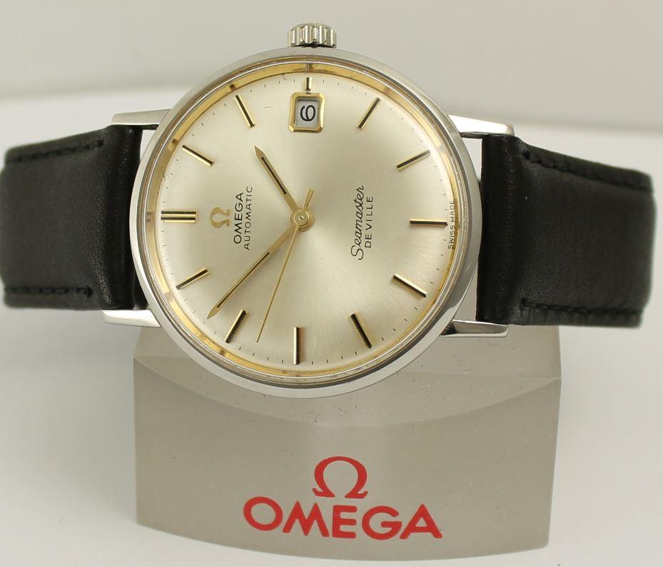

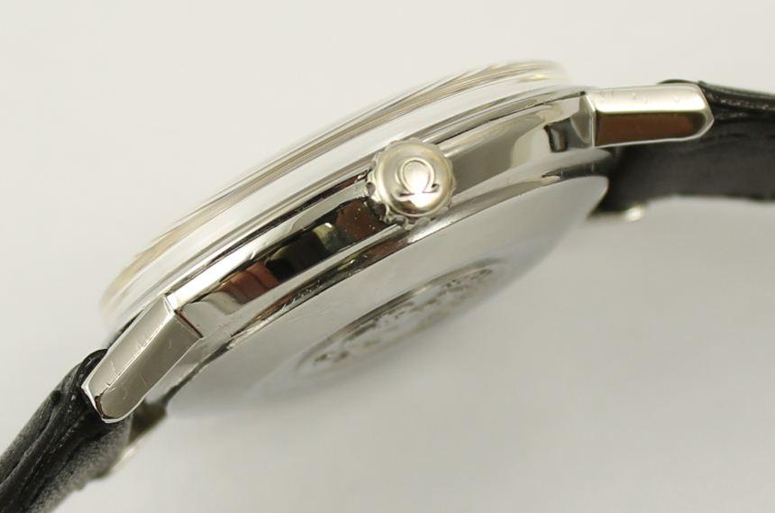

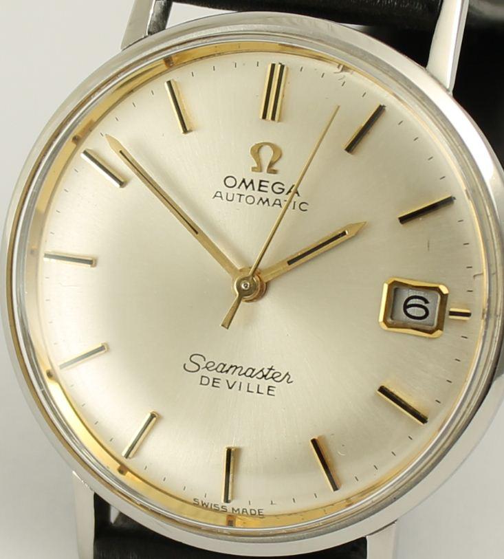

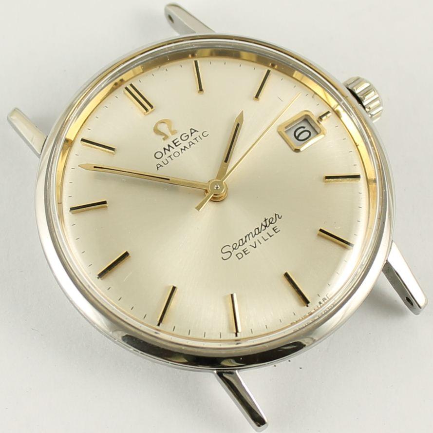

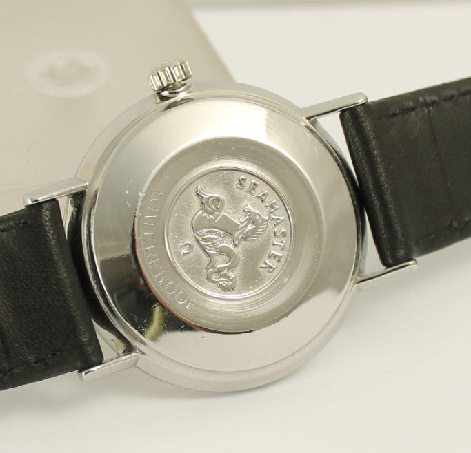

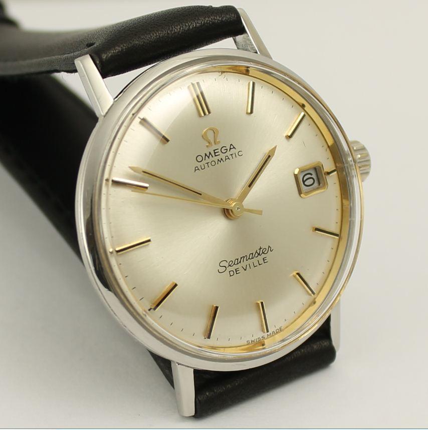

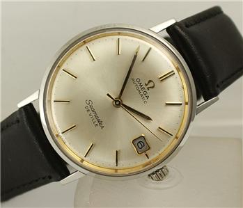

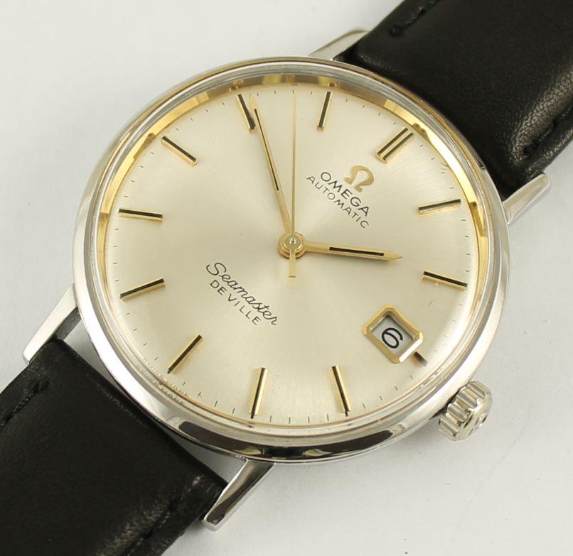

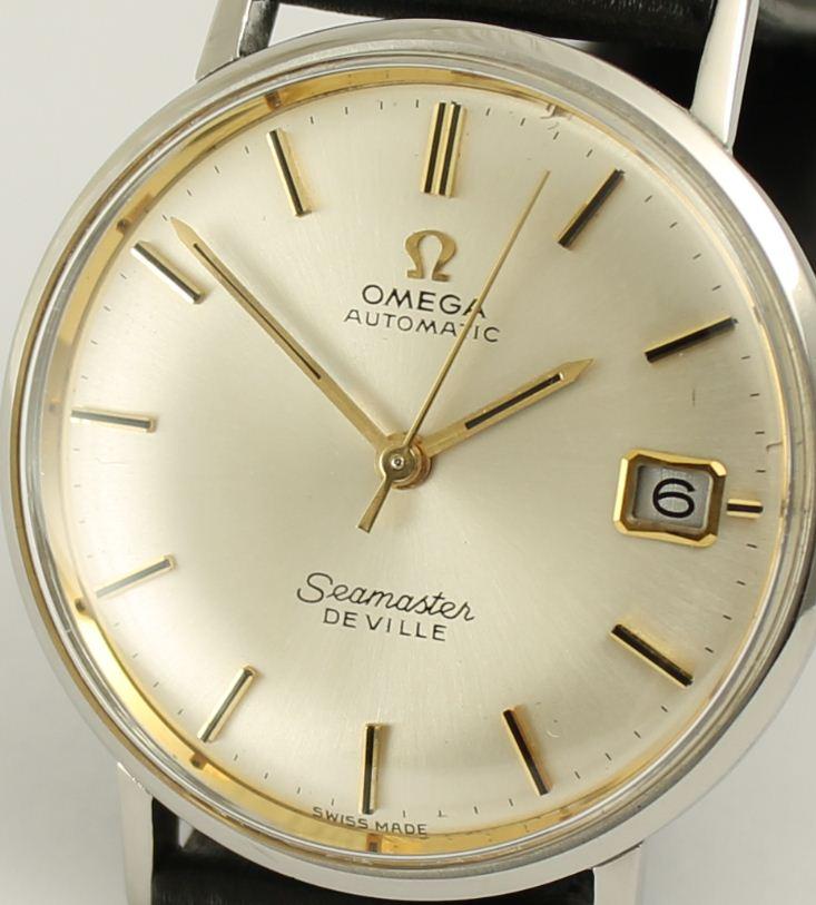

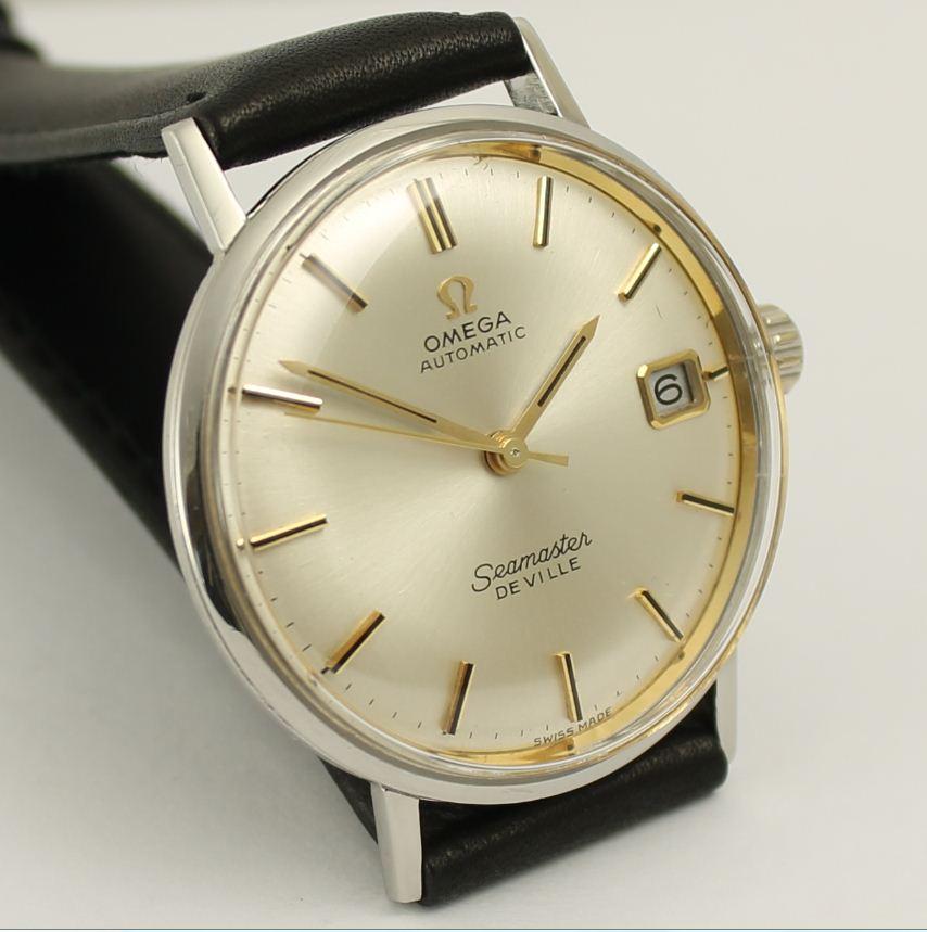

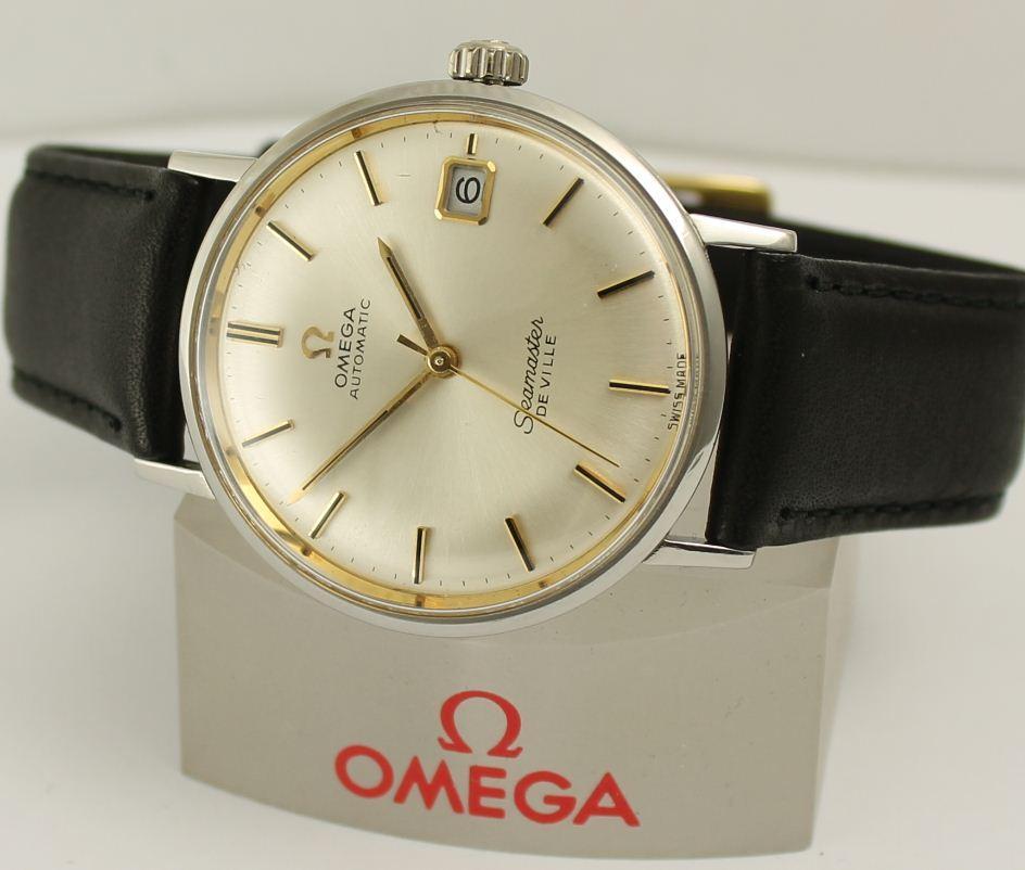

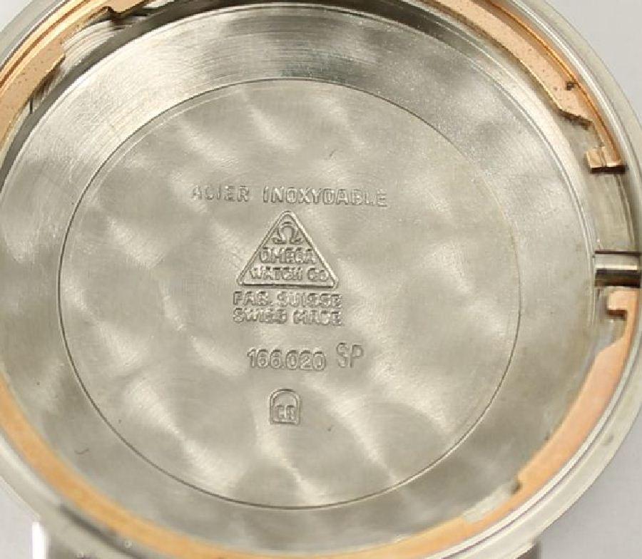

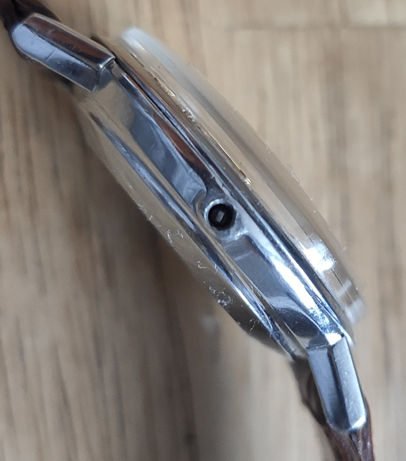

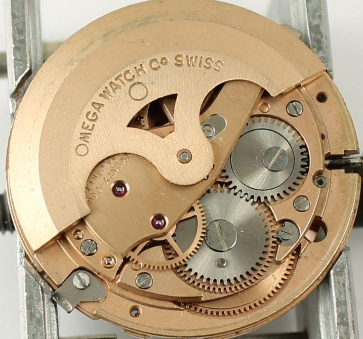

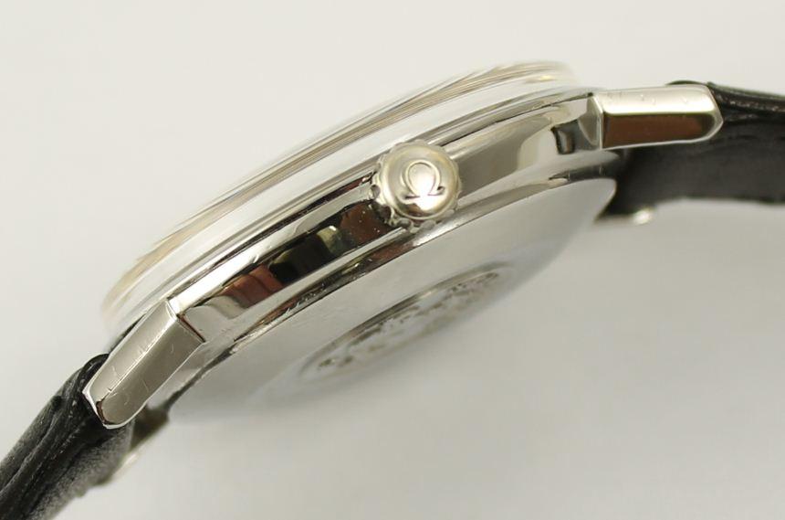

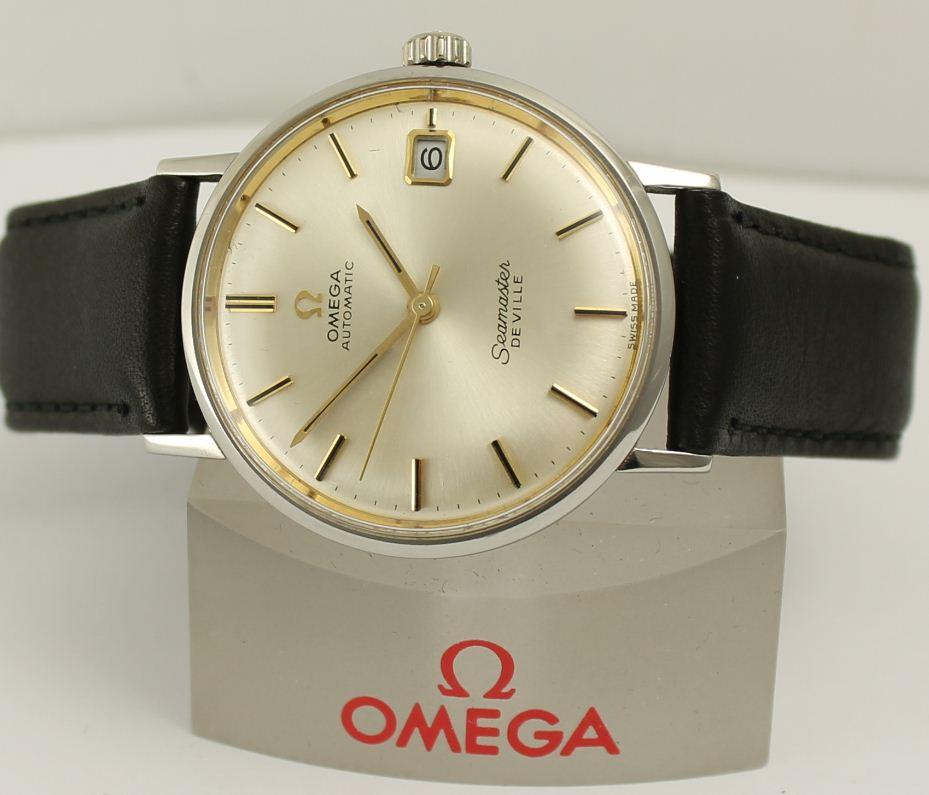

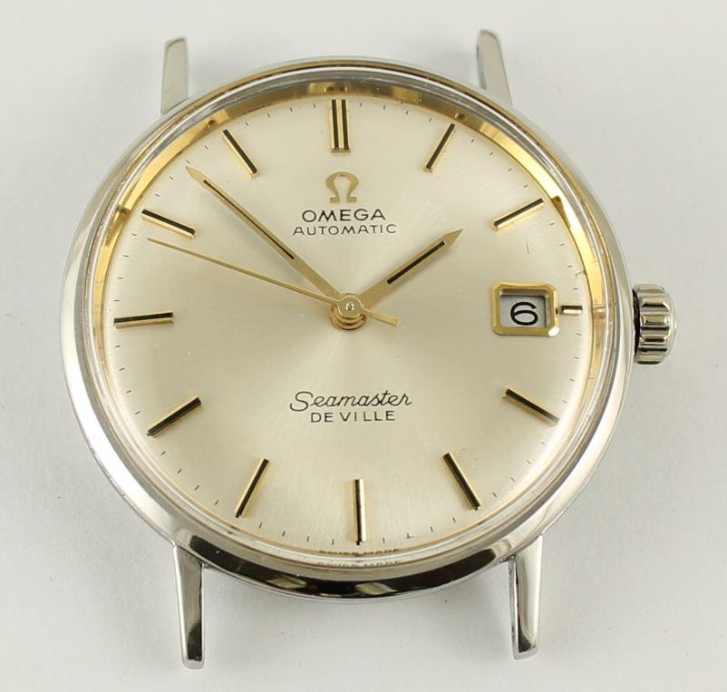

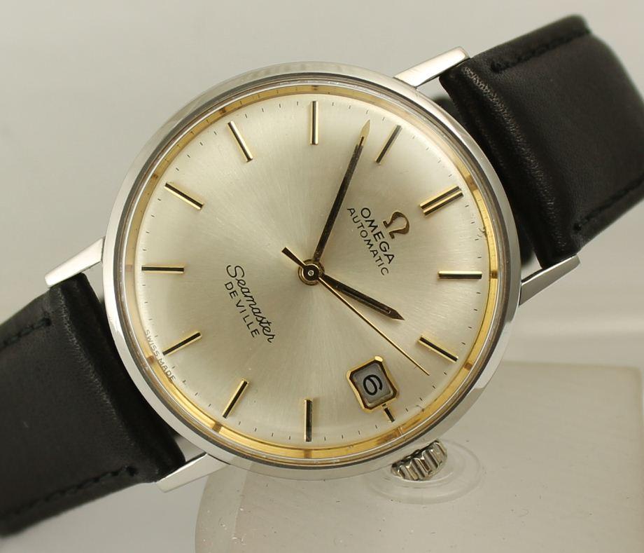

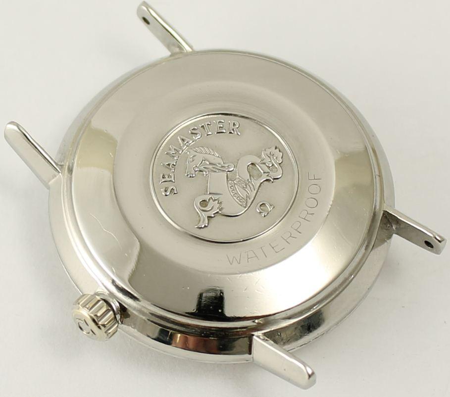

Below is a picture of how my watch currently looks (missing crown) and further below are pictures from the original eBay listing.

Current replacement crown is 069ST42531.
Case tube is 090STZ001091.
And the crowns don't come with the female split stems attached - they are bought as a separate part and trimmed to the correct length.
Female split stem part is 081ST9992.

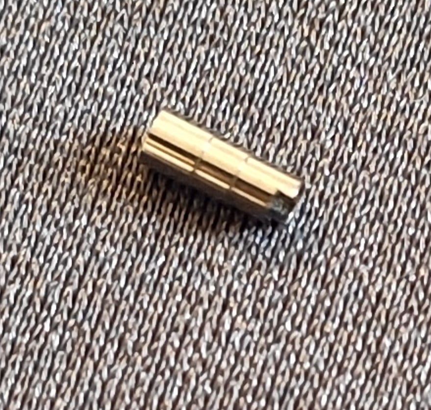

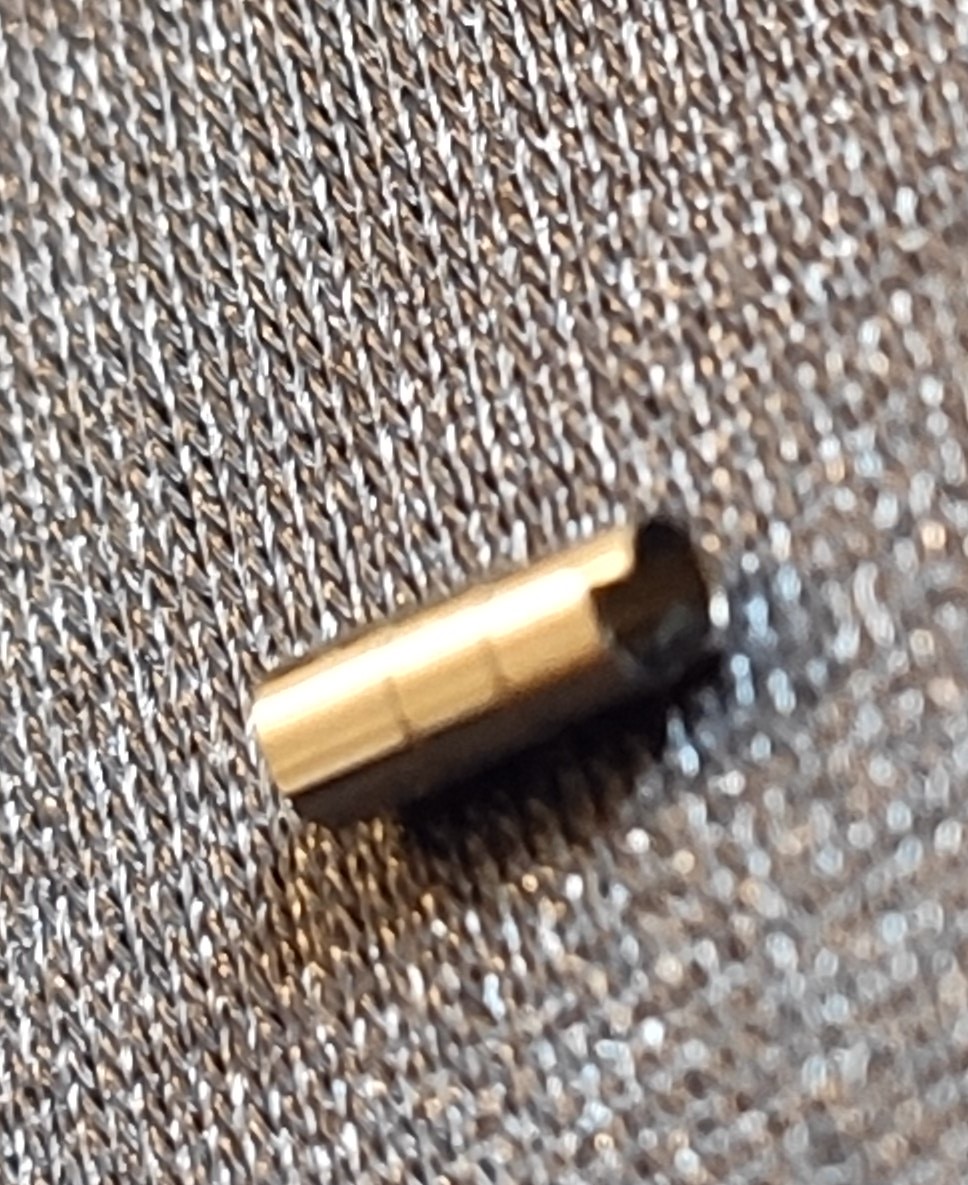

5

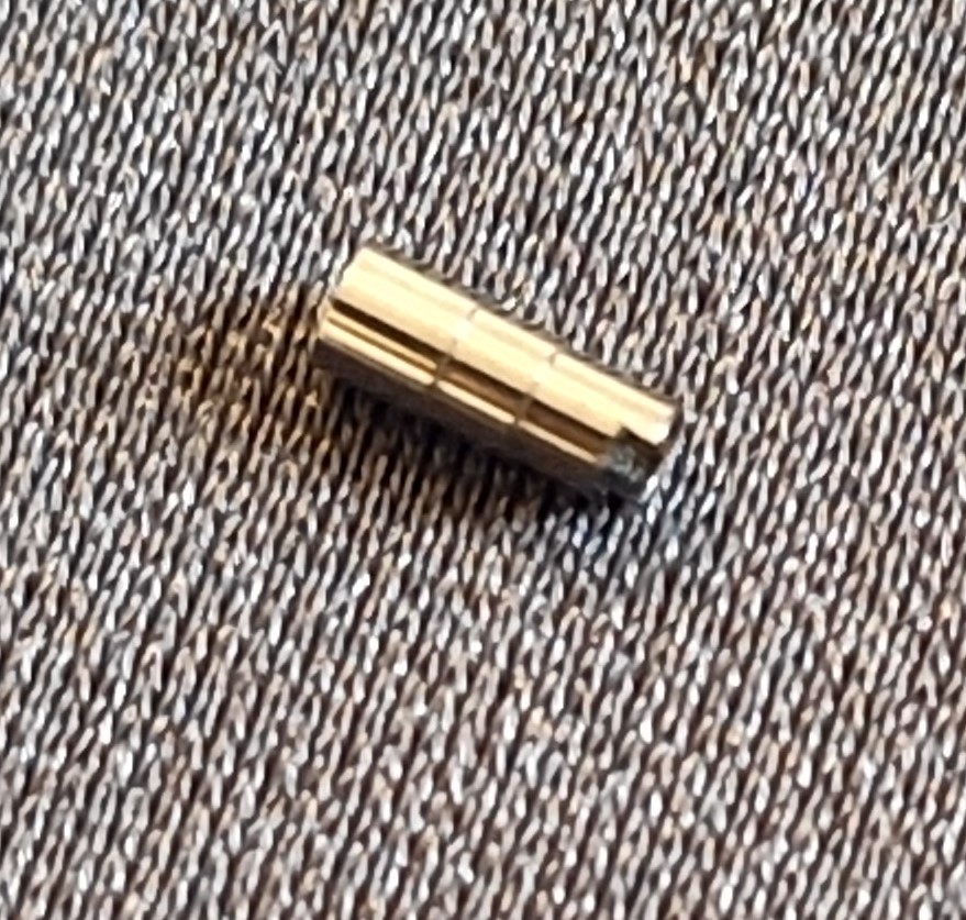

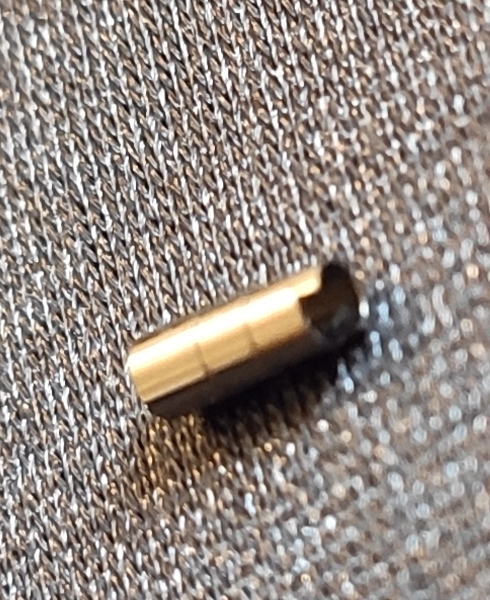

Thanks, I've received the parts and am wondering - can I carefully tap the stem in using something like a nylon mallet, without removing the crystal and movement?
I see that there's a step in the rim of the narrower end of the tube, so I'm wondering if it's not possible to line it up correctly without removing the crystal and movement.
