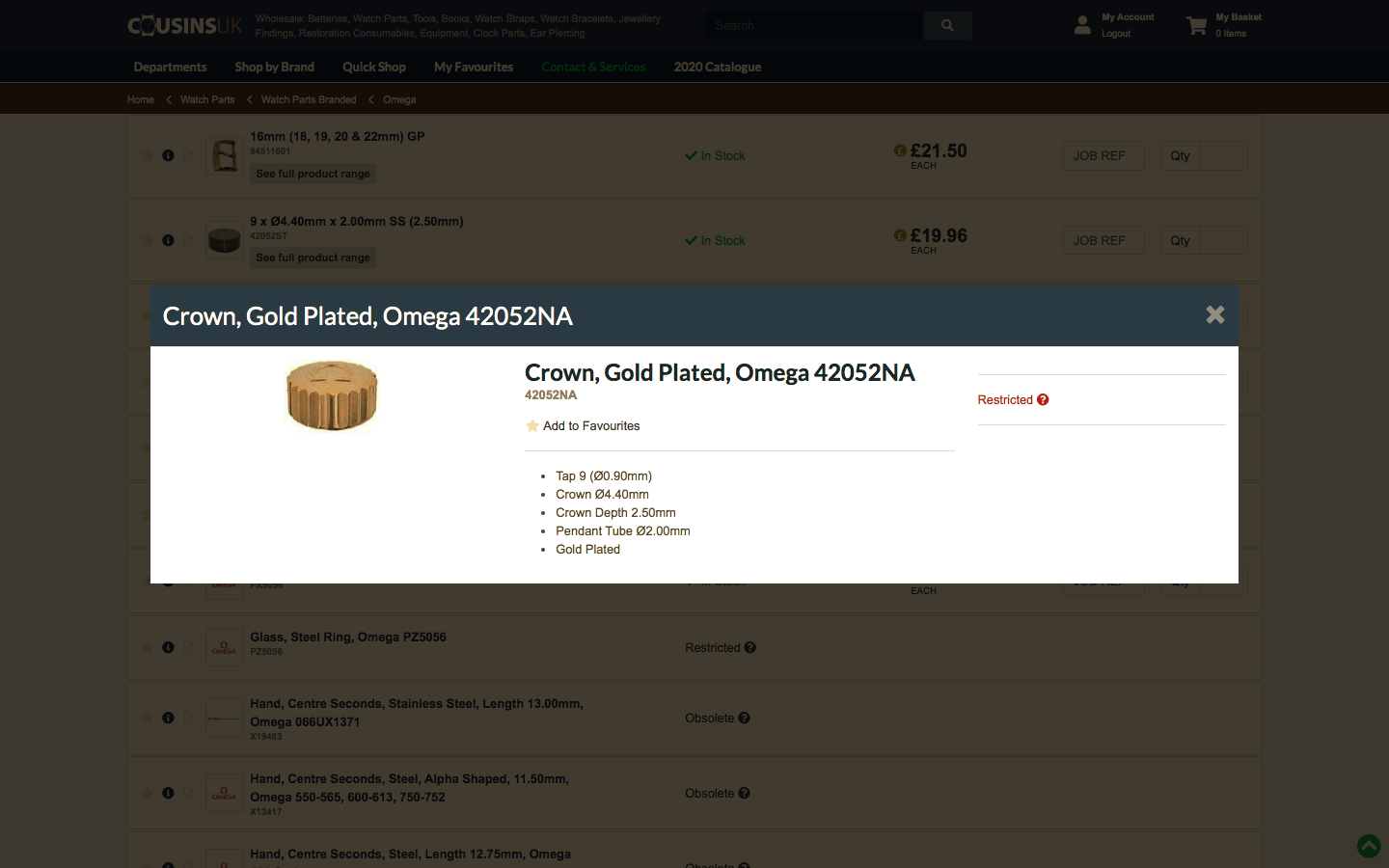

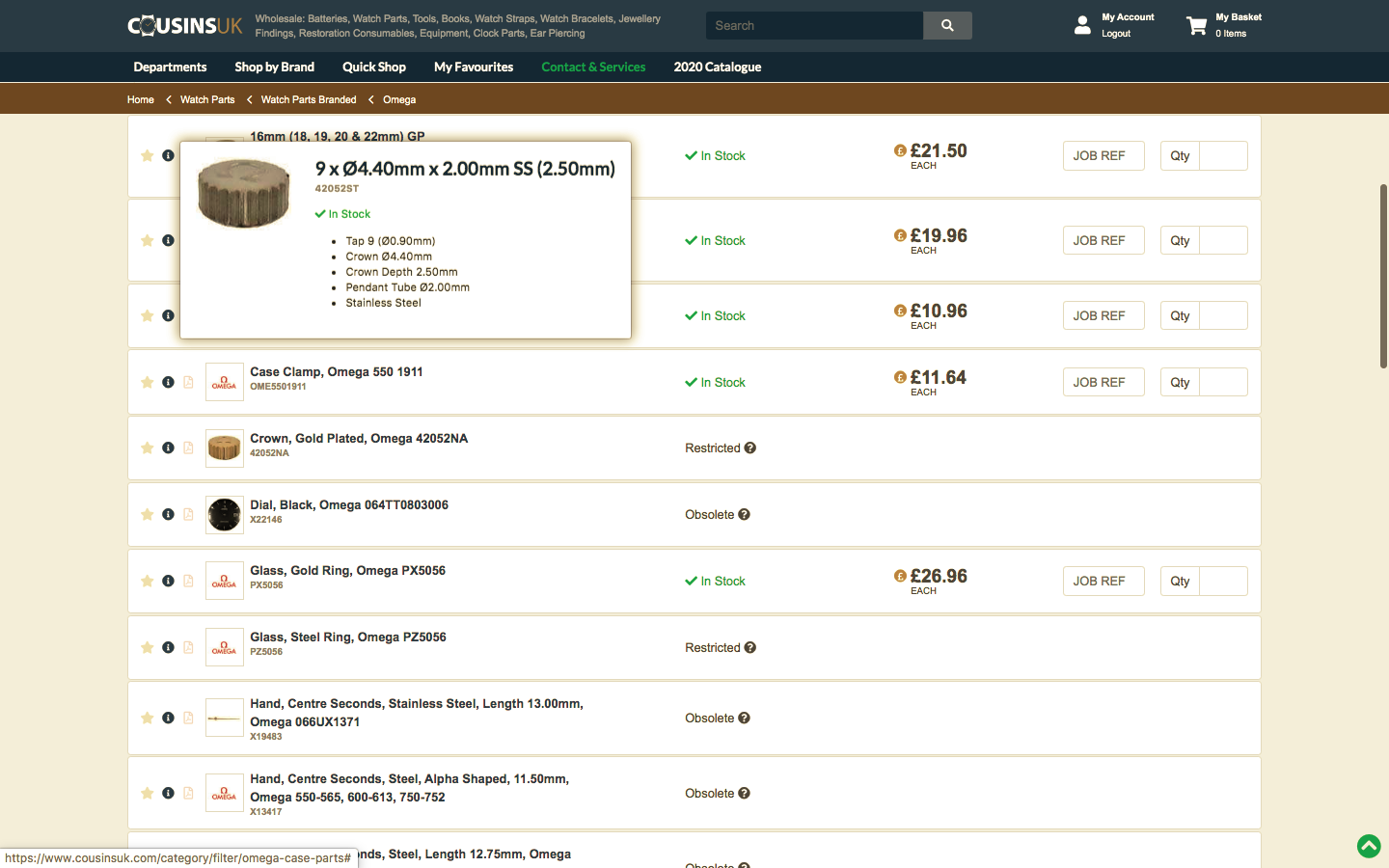

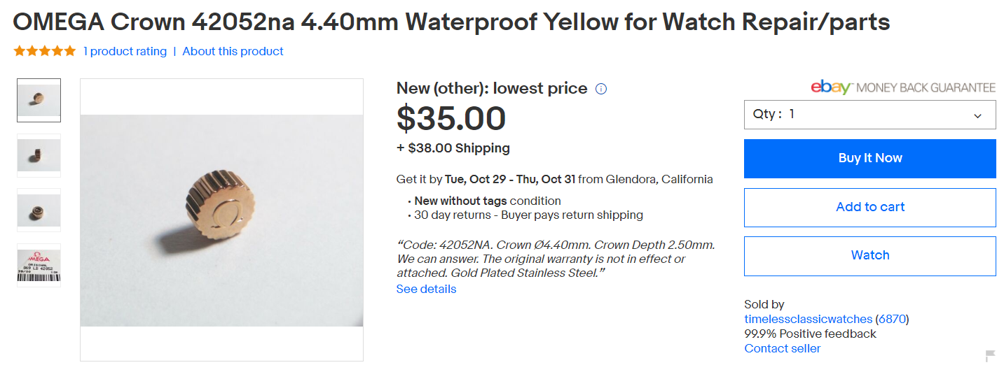

Thanks for the feedback. Yes, it's 166.002. Any clue what crown would fit on that? Thanks
13,493
31,814
You may want to get a new stem as well. If the current crown on the watch is not original the stem may be to short.

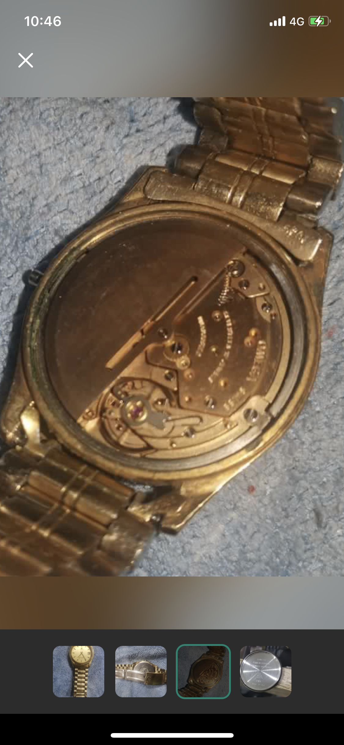

Hi guys, I need help. I have a 166.0263 that is missing crown and stem, can anyone suggest me the size and etc. it is in gold plated. Thanks.
