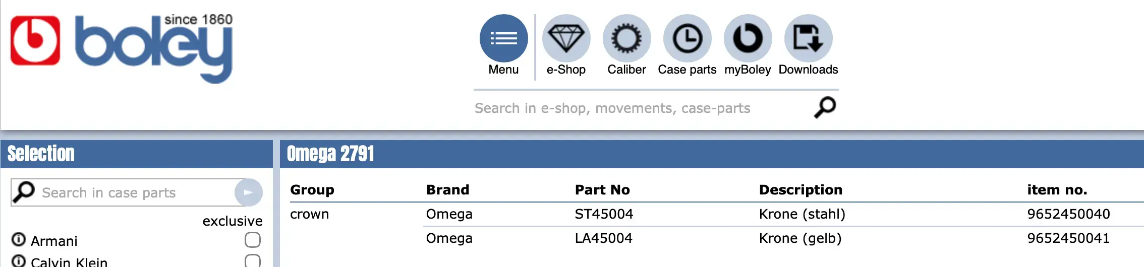

Boley in Germany list the steel crown as ST45004, so this may help you find other sources.

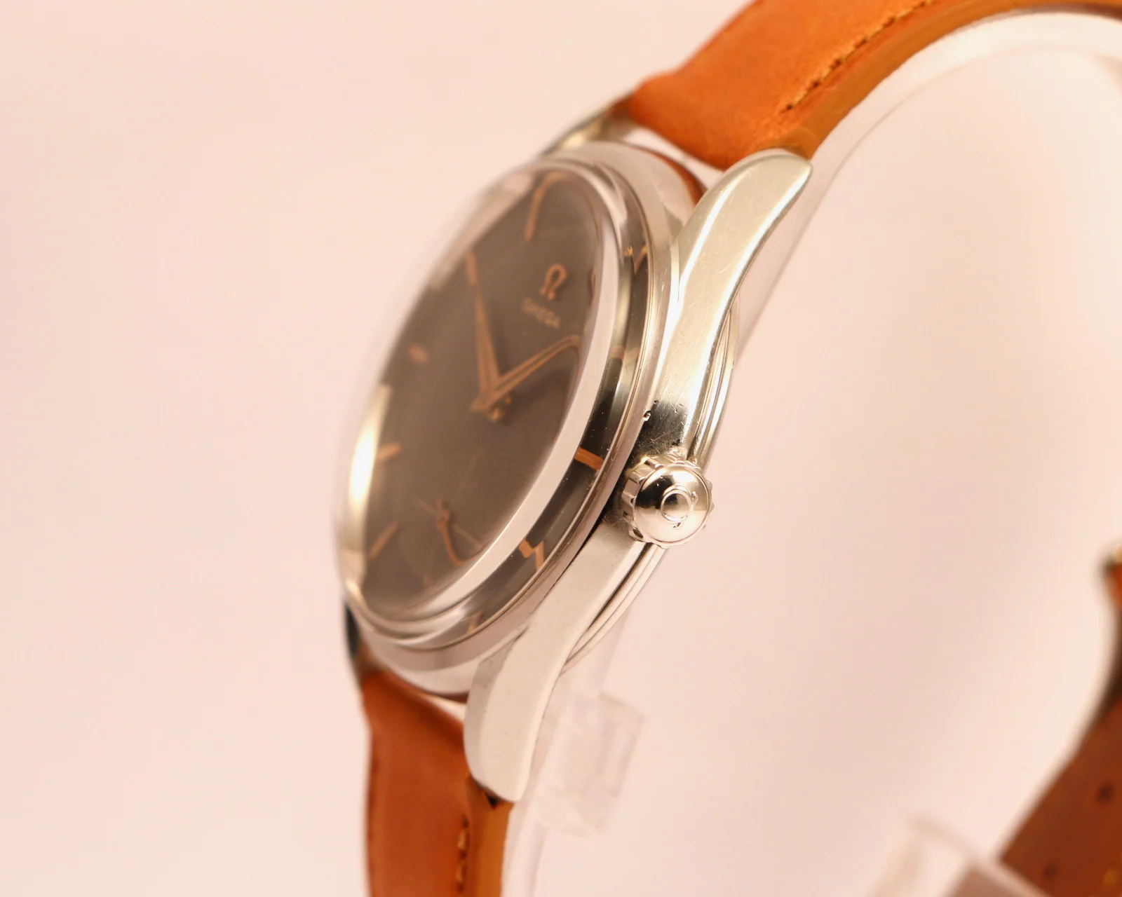

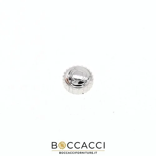

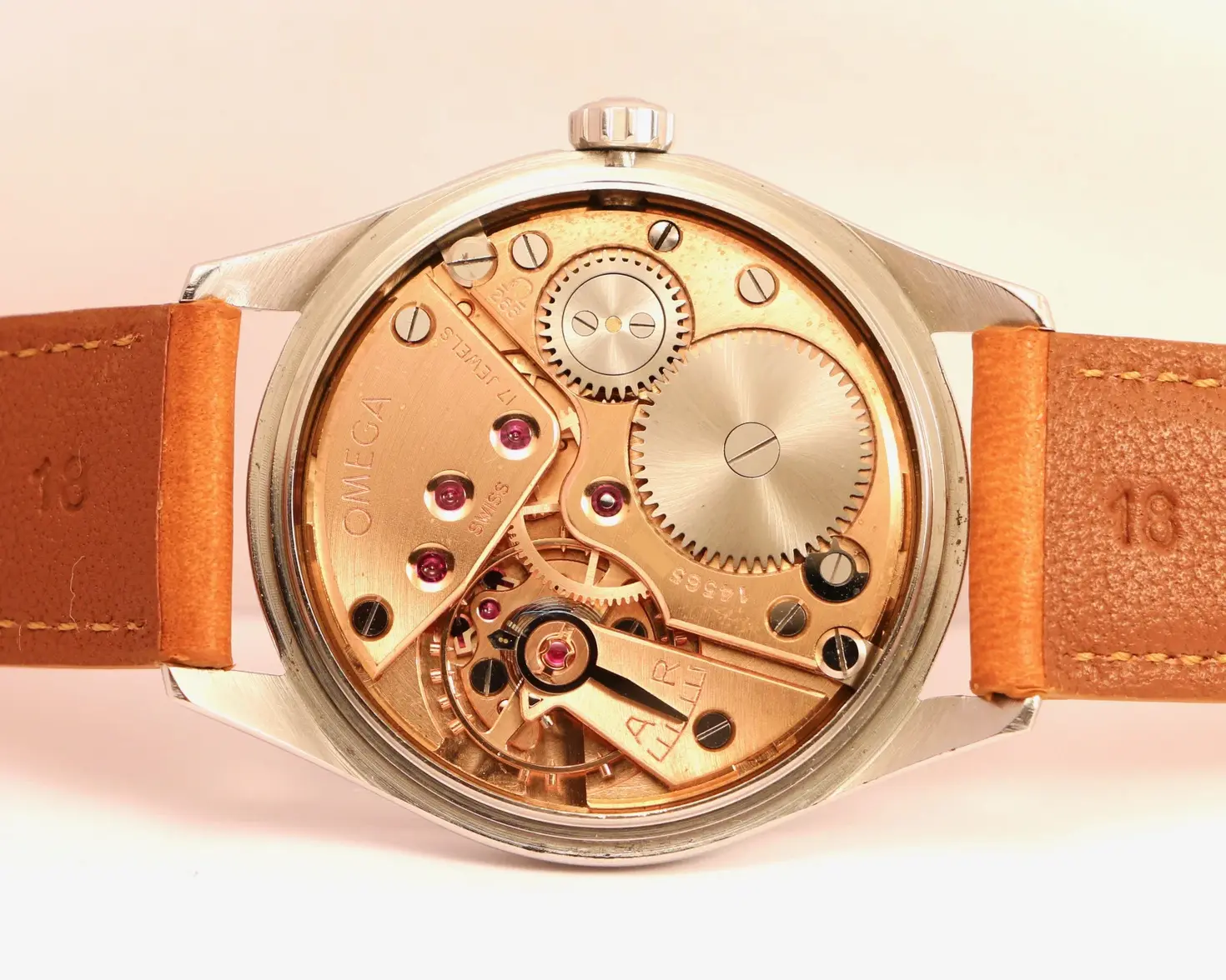

Do you have a picture of the original crown type that you need? I may have one.
Unfortunately I don't have my own photo of an original st45003 crown. I found this picture on a closed Ebay auction. The crown parameters: Diameter: 5.5mm, Tube: 2.5mm, Tap:1.2mm
9
I found these photos (crown of omega 2791, cal.266), but I don't know if they are correct.
