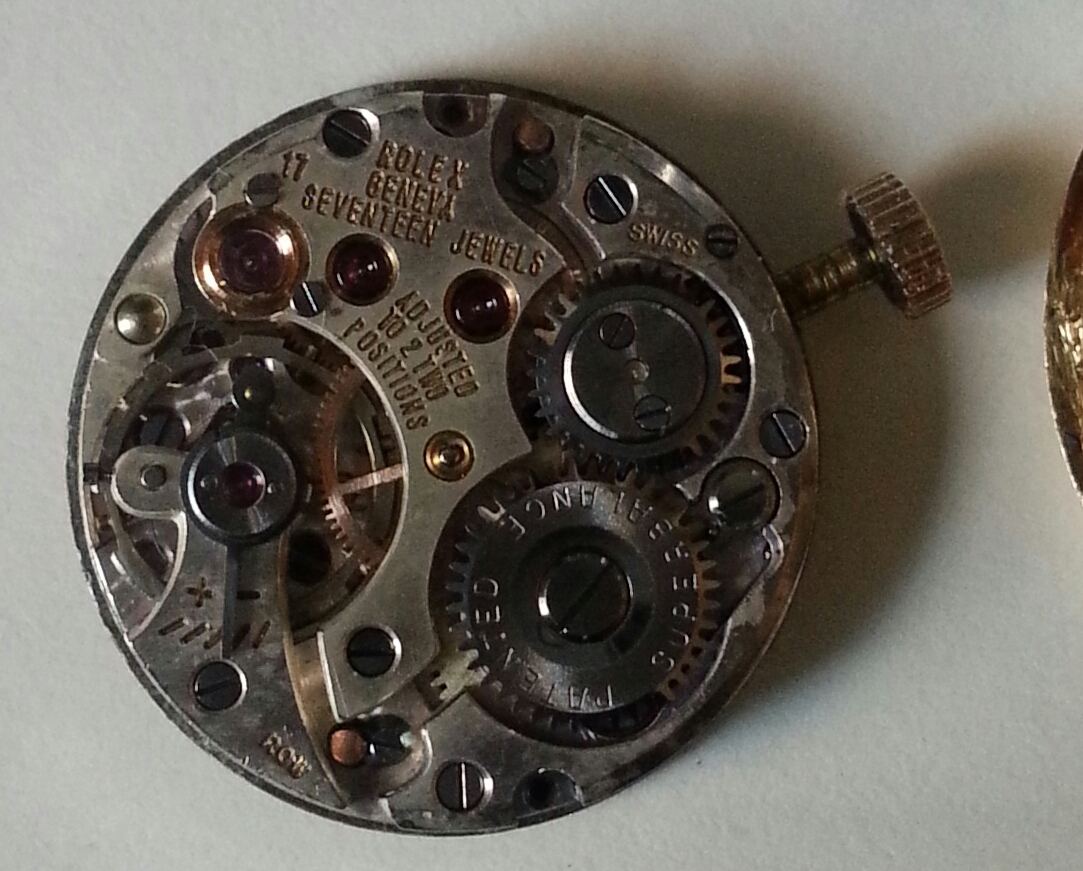

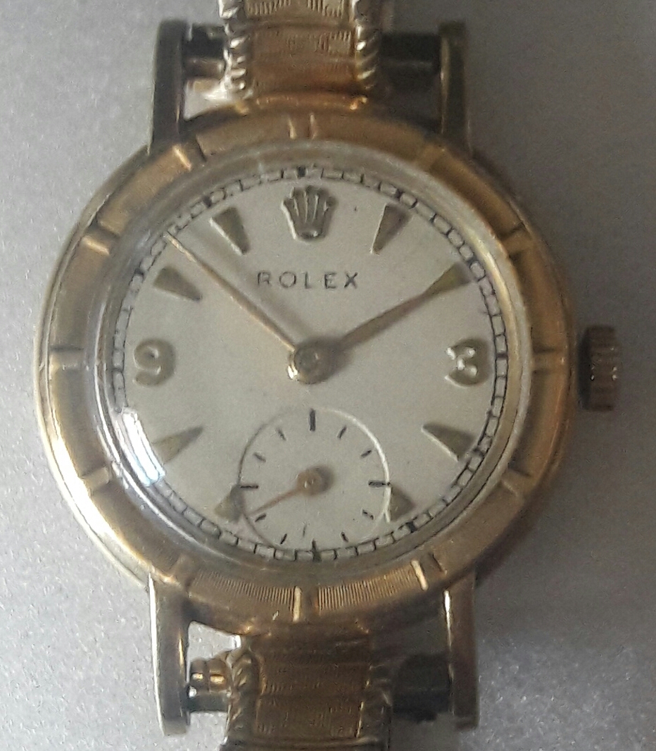

Just picked up this adorable 14kt watch,sadly with a slightly broken balance.
Can anyone please identify the calibre please? It is 19mm across and I am wondering if I am likely to find a Ronda staff anywhere in London or New York? (or anywhere)

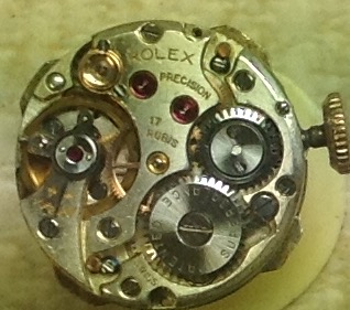

I'd say caliber 700. A closer look at the pictures you've uploaded tells me this is a woman's watch. In which case it is not a 10 1/2 ligne caliber 700, but more likely an 7 1/2 ligne caliber 1100. They look pretty much the same. Good luck on the balance staff. Let us know if you succeed. As a last resort, I have a complete running movement which is in good shape. Note that it is running in the picture I uploaded. Look for a private message.

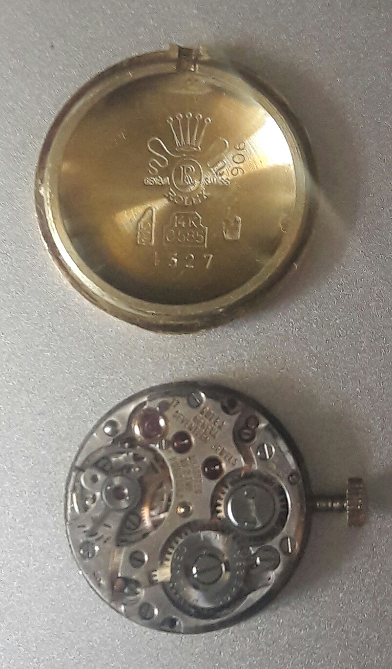

Glad to dredge up this thread with an update but I took the dial off and suddenly can see the number 7¾H on it. Curiously a Mr Bechir at Rolex in Geneva who is authorised to speak to customers about things like movement identification has never heard of a 7¾H and doesn't recognise either the movement or the size! Which I suppose says a lot about the competence of Rolex employees?
The trouble is, my parts supplier did easily identify a 7¾H and found the proper staff for it.
But it doesn't fit!! Having a shaft that is too broad for the balance wheel. Does anyone know what is going on please? Is the 7¾H so unusual?

If you are desperate, the movement I showed in this thread (above) is available. However, NOT as a parts watch the staff is good, and it is innexcellent order. PM me.
