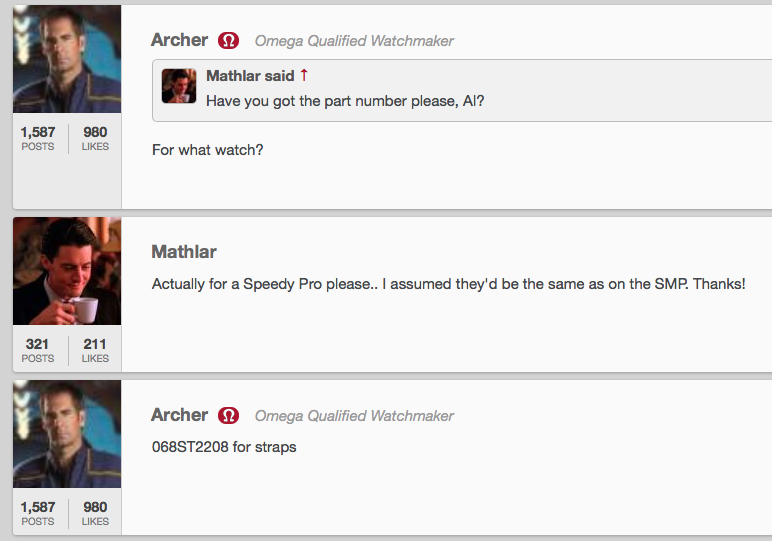

As said here, the correct spring bars for Speedy pro on strap are 068ST2208.
