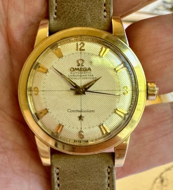

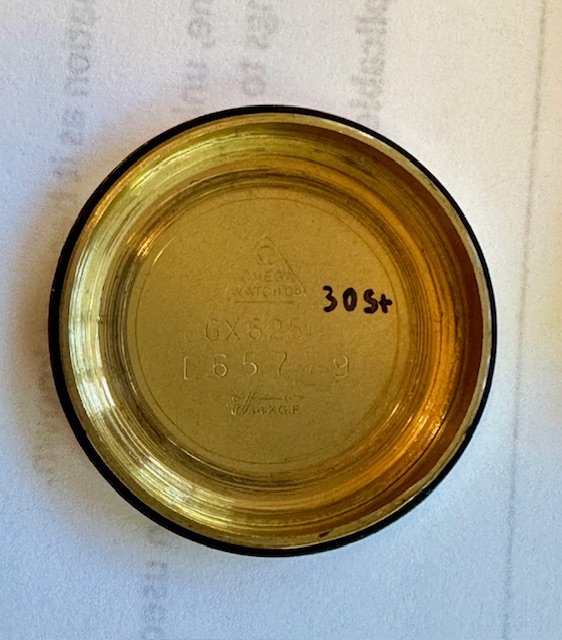

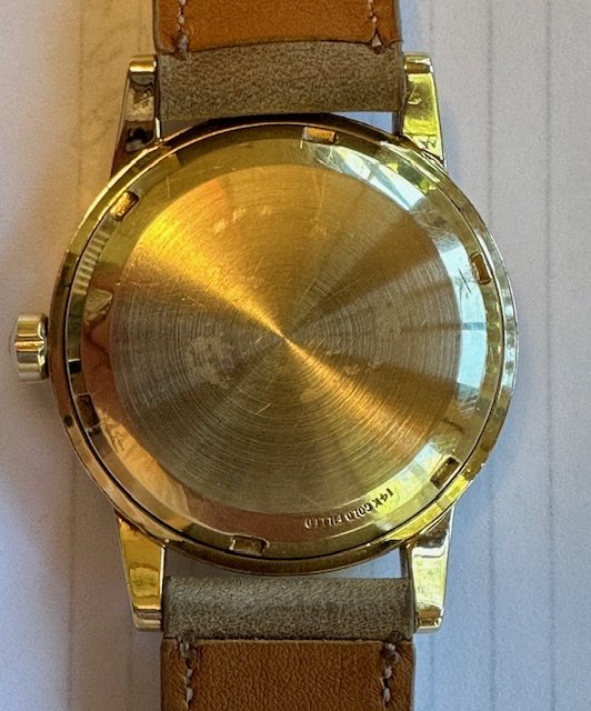

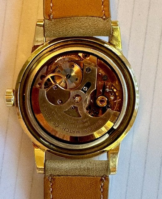

Posts 7,320 Likes 23,729 M'Bob ·Aug 14, 2024 Could this be correct? Early waffle Constellation dial, GX6250 case ref, and 470 caliber movement. Movement serial # of 16.6 million dates to 1958. Literature says GX6250 is a Seamaster reference and should have a caliber 500 case. Thanks.
Posts 13,489 Likes 31,801 X350 XJR ·Aug 14, 2024·Vintage Omega Aficionado Total franken. Look at that weird spacer used to make the movement fit. Butchered multiple watches to make this monster.
Posts 7,320 Likes 23,729 M'Bob ·Aug 14, 2024 X350 XJR Total franken. Look at that weird spacer used to make the movement fit. Butchered multiple watches to make this monster. Perfect. Thanks a lot.
