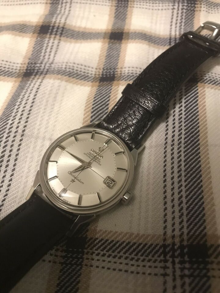

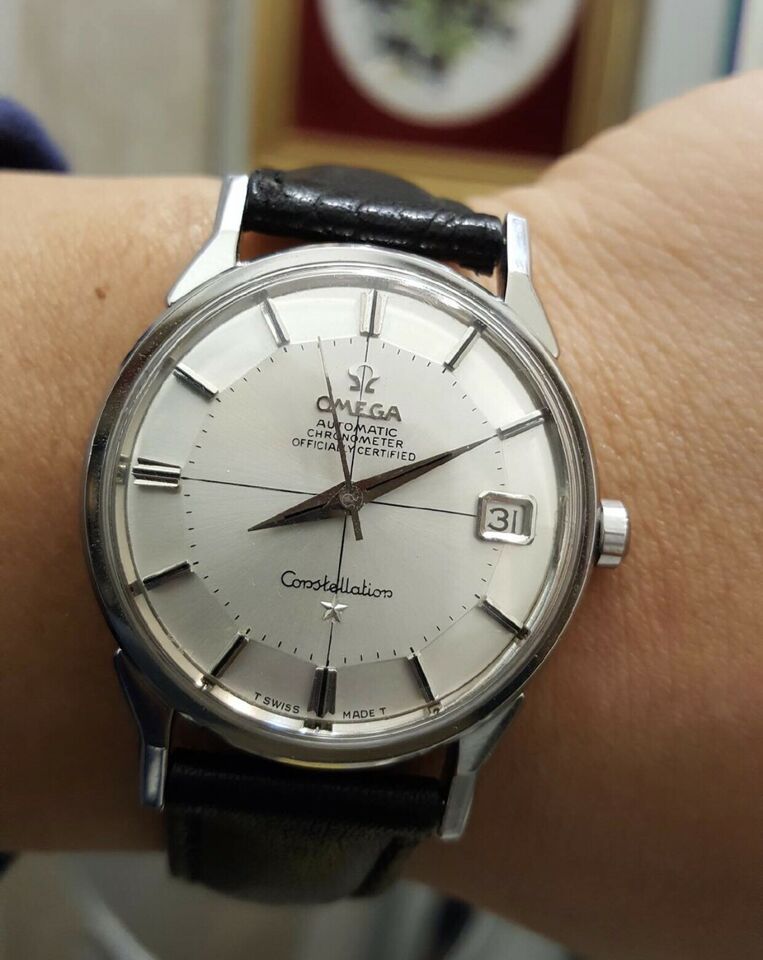

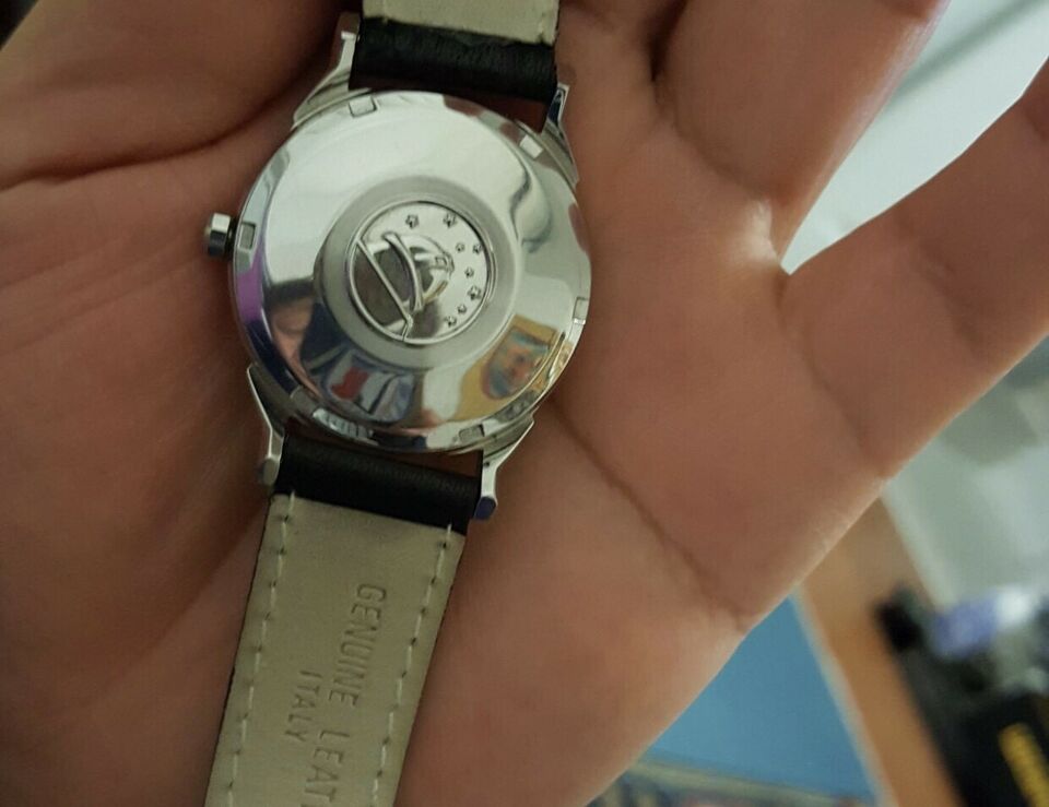

Hi. I've been offered a Pie Pan for purchase. The seller said that his grandfather is the original owner, and he has inherited it. There aren't any inside photos provided unfortunately. What can you subtract from the three photos I've been provided with? Is the dial original? Case unpolished? Can you tell if the crown is right from the photo? What is a good price for this piece? Thanks

Is the dial original? No
Case unpolished? No
Can you tell if the crown is right from the photo? Crown is wrong

Case may be fake as well? I don’t like how close the stars are to the outside edge in the medallion.
13,674
19,043
Not loving the dial either. Font on “Constellation” is totally wrong and arms of the star look wrong. “T” on dial, but no tritium is present on the dial.
My guess is that this is a fake dial.

Fake case and dial. Look at the star array on the back.

Not to pile on, but I will😎 for those that follow..........The tip of the star is too close to the lettering, printing too bold plus crosshair, font in Constellation wrong.
