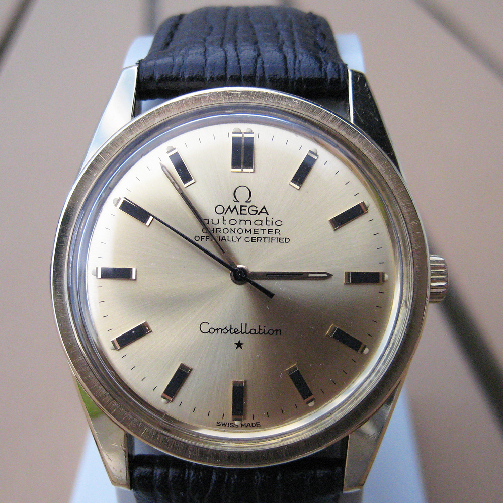

Hi, I'm new to vintage Omegas, I found this constellation on eBay and wanted to purchase it. I found it on the omega vintage database https://www.omegawatches.com/it/planet-omega/heritage/vintage-details/20554/ and it looks original to me, but I would like to hear the opinion of someone more experienced. If it is all original what should i pay for it?

Please look and compare again.
I’m seeing, and better pix would help a bunch, a small “a” in automatic which is always a no-no.
And a pointed “A” in Omega.
Just for starters.
If you want an original, do not buy this one.

Thank you for pointing that out! I'll definitely not buy. Do you think I should share the picture in the fake Omega thread?

These Connies were a departure from the usual fonts at the time.
It could be correct.
Better pics required though to be certain.

This is the best picture of the dial I can get

I'm not into this style of Connie but all looks correct to me
The case looks to have some polishing as I think the lugs should have a better defined bevel
There is evidence of rotor rub on the case back so will require a service
hope that helps
To give an idea another £200 on its current price is about as far as I would go.

I used to own one of these, not stainless steel though but gold-capped. Beautiful, elegant watch. Due to the compact cal. 712 it wears very low to the wrist.
And yes - the dial is correct. If I had a dollar for every time someone yelled "redial" when they saw it, I would be rich 😉
Is that yours or a web-pic?(doesn’t look gold capped)
If yours - Do you recall what year / serial yours was @Woodward ?
OP’s is quite early.
Interesting to define the transition from curly N to straight N and no Ts for lume.
It is the actual watch that used to belong to me. I sold it less than a year ago.
I haven´t got the actual serial number but i made a note that the watch was from 1971, so it must have been around 33 millions.
Just for starters.
