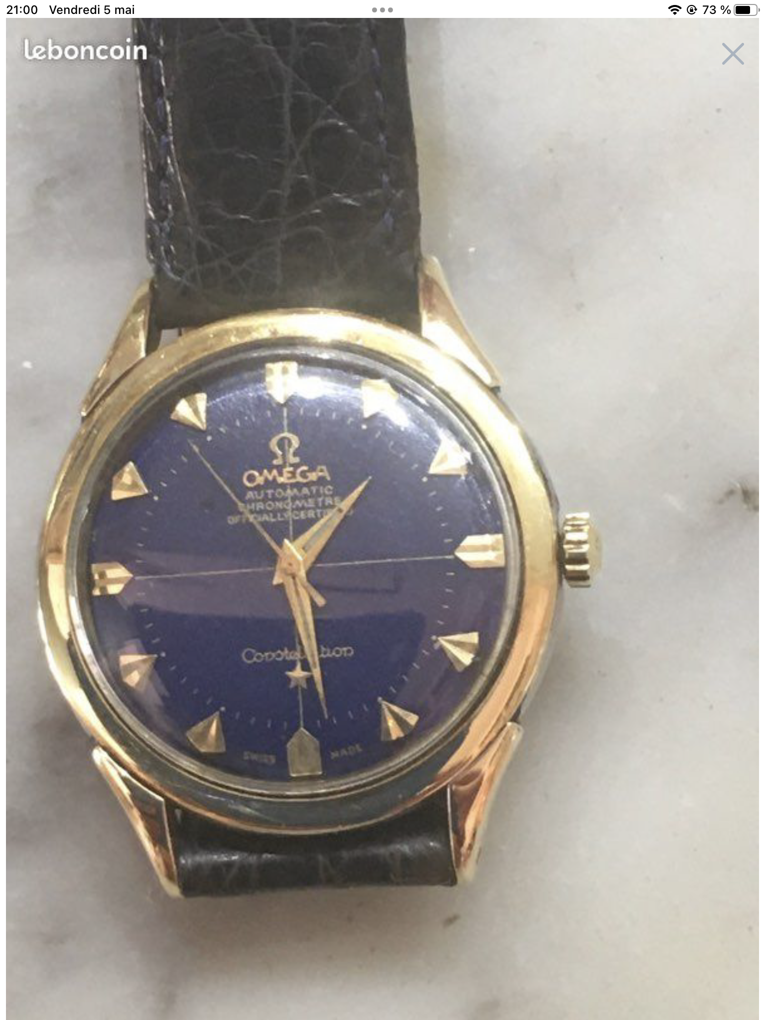

I know that blue dials are normally redials but what about mine ? It shows an aging dot left of "Chronometre" visible when using the numerical loupe effect. Thanks for any help. It is 20 years I own it.

Well if it is a bumper movement I'd generally expect printed 'Omega' and double crossed t's.
It looks like it's missing the dot from the i in Constellation and the Swiss Made is too high. This too would also be the first blue dial I've ever seen.
Unfortunately, I'd say a redial.

+1, the positioning of Swiss Made alone is an instant give away.

Other issues,
Crosshairs cover "l"
Crosshair should extend to dial edge
Lume hands but not dial
Uneven minute markers
Minute markers too close to centre

Yeah redial I’m afraid. The font just isn’t right, Swiss Made is too high and hour marker/minute marker alignment is out.
