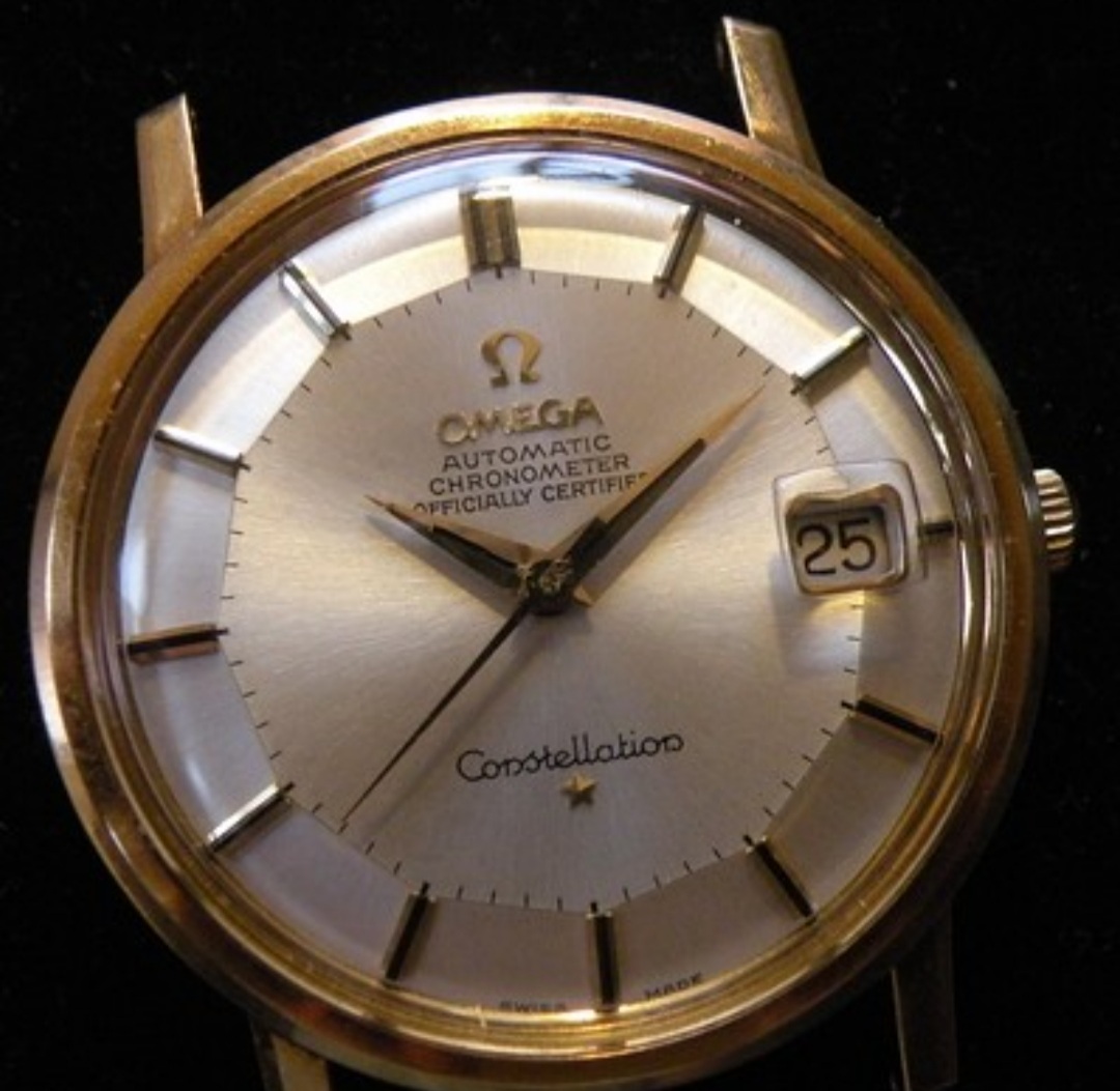

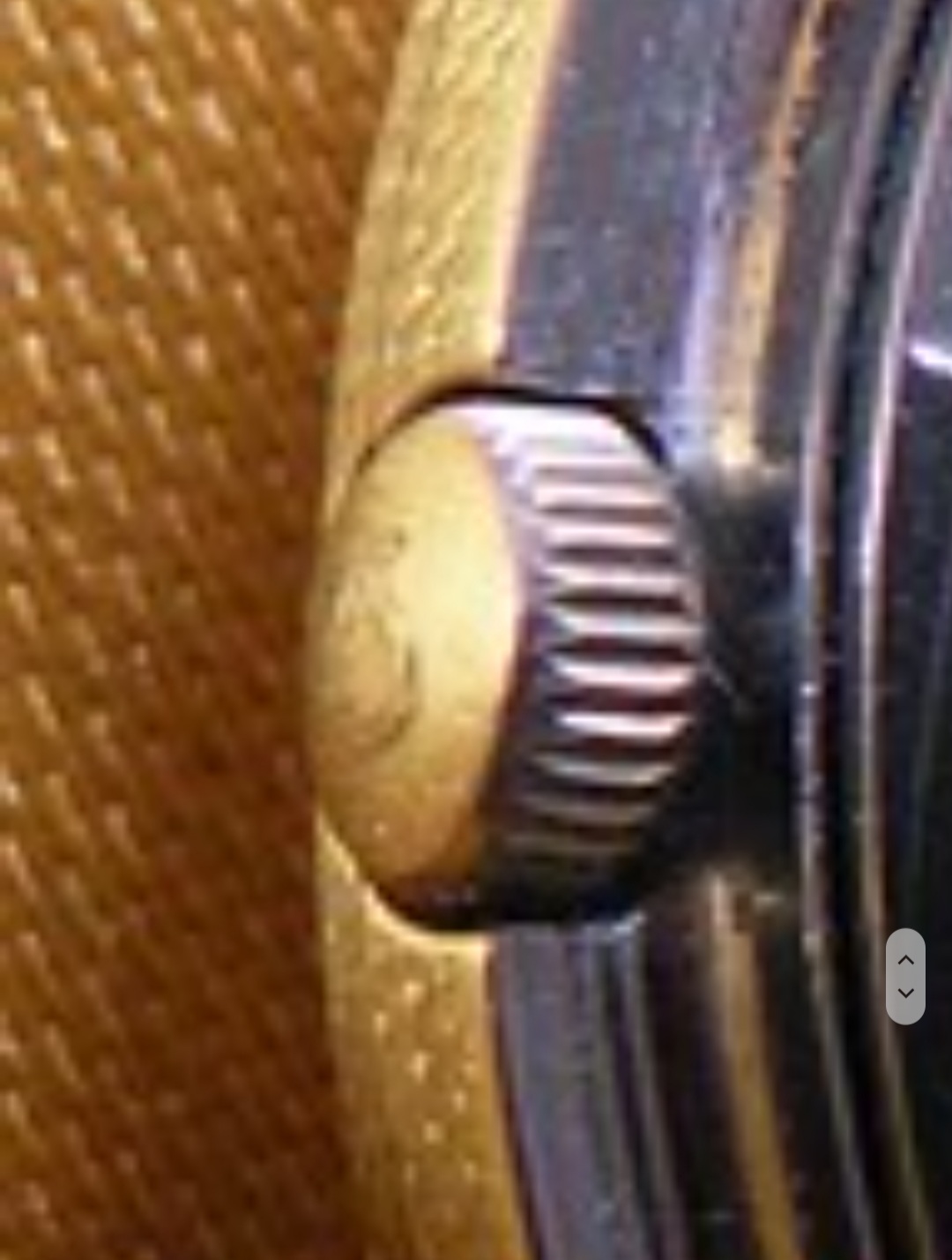

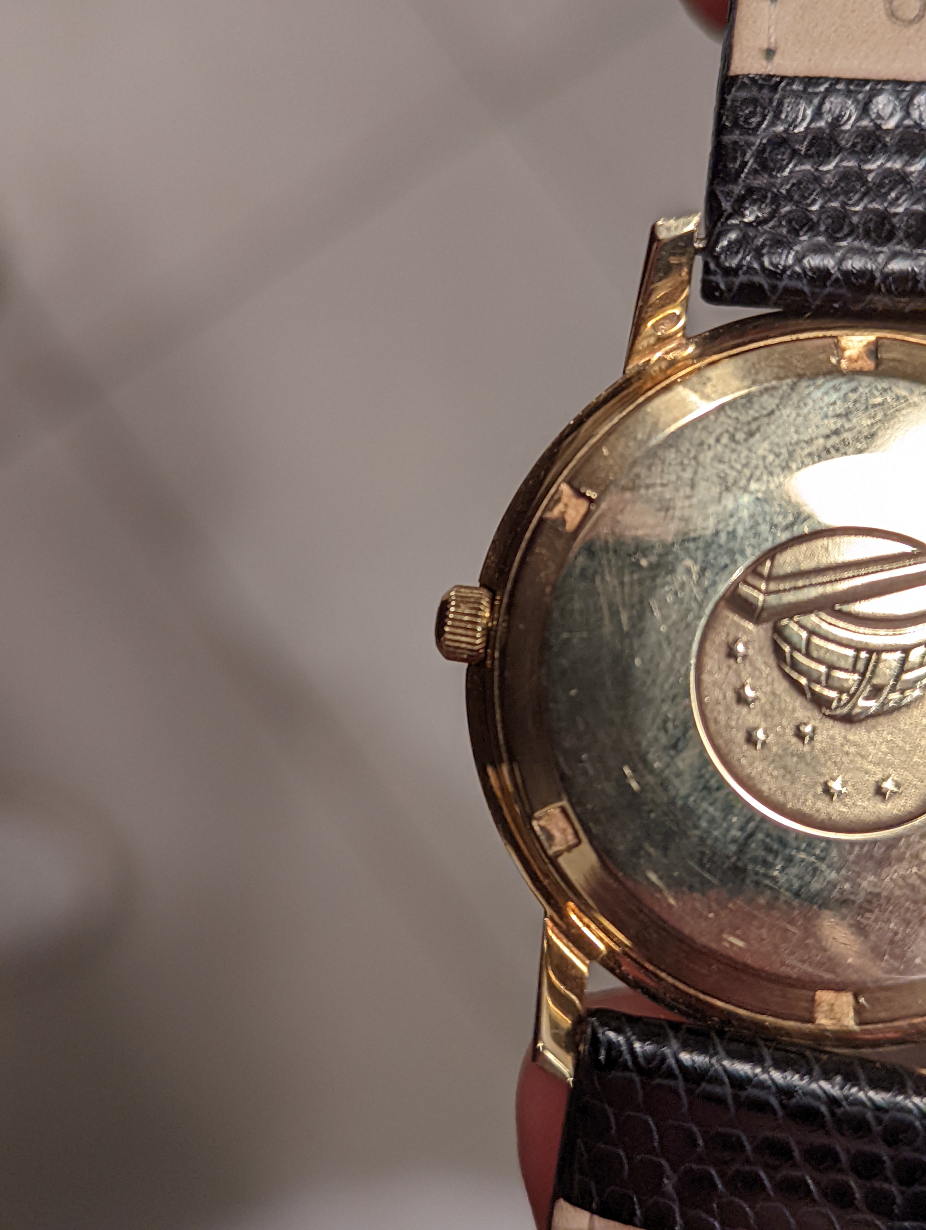

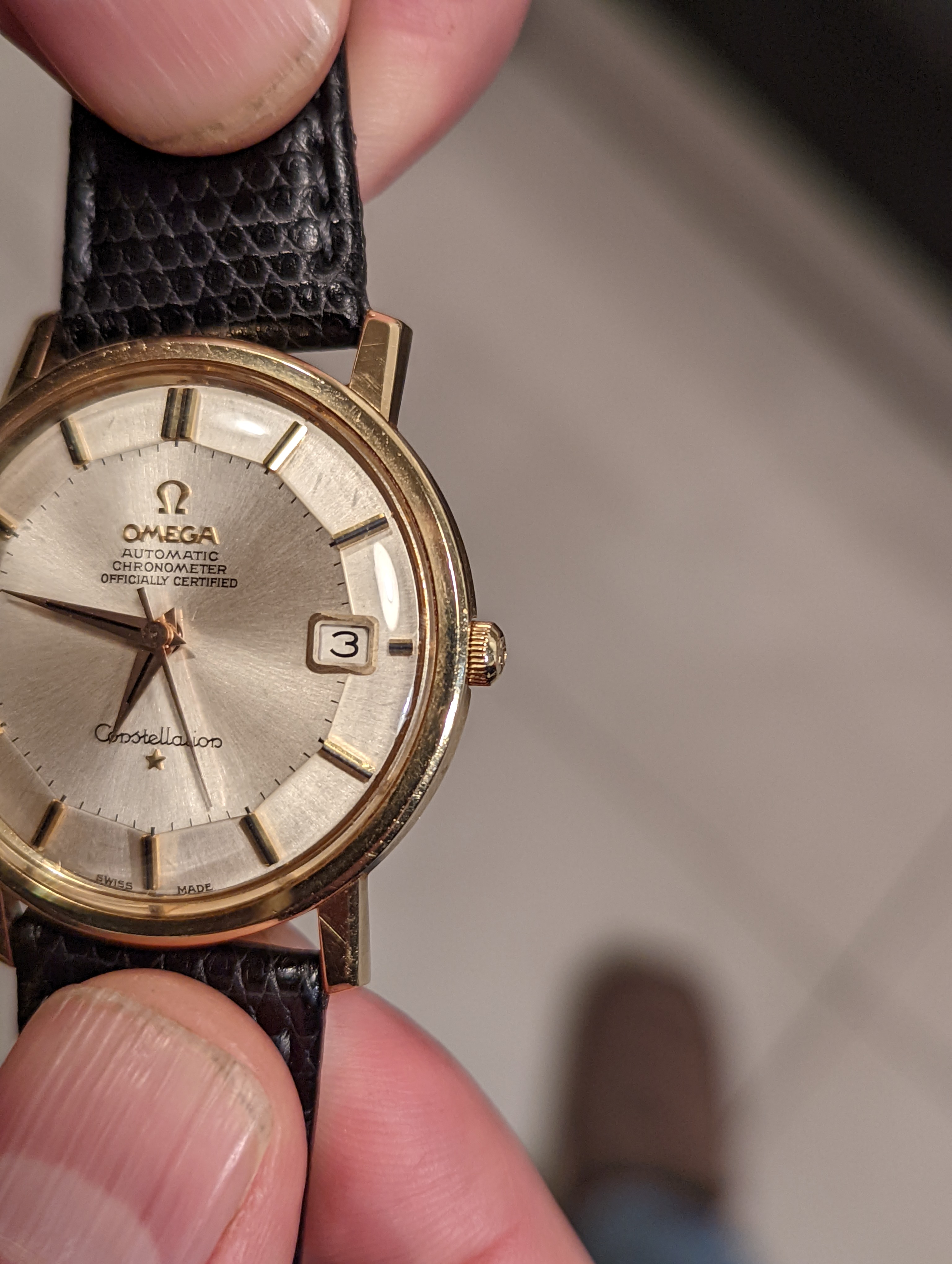

I am not sure if that crown is a service crown or original but I am sure that the length is correct.
My 18k says hello.
I’m sure this conversation has been had before at some point - but are you suggesting that gold cased 168.010s were supplied with different ( longer and round-ended) crowns to gold capped or SS 168.010s?
the expressed crown on your gold Connie is very different from the ‘hidden’ ( but always slightly protruding) flat-ended crown on your SS Connie.
- or that both are correct?

Nice watch

however, I do agree with him about the crowns ( but there are two replacement crown styles, one flat-ended and one round-ended)

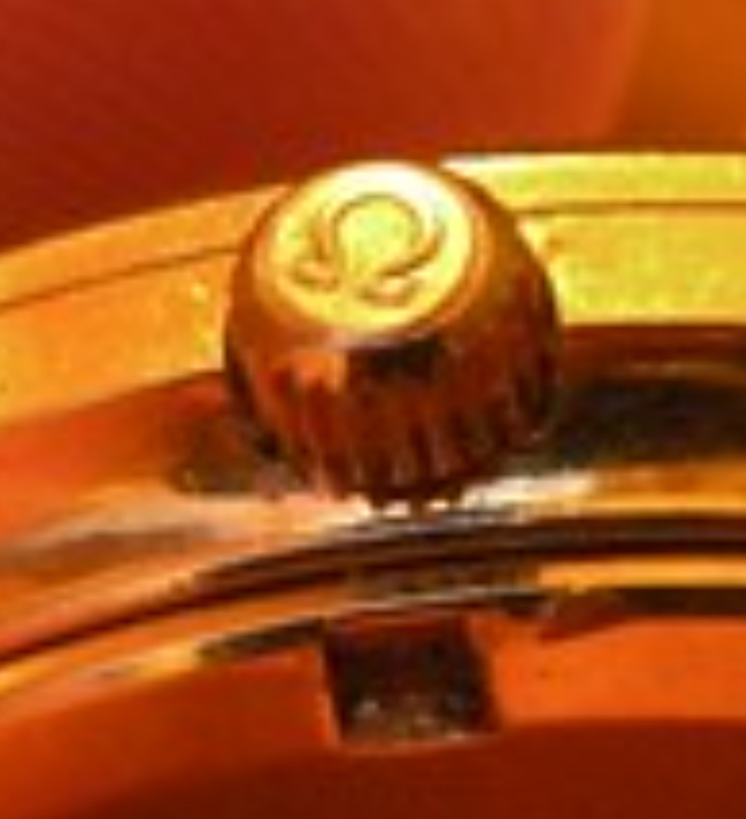

Here it is.
An old crown for sure but did the crown start life on the 168.010?
I seem to recall something somewhere (Desmond’s blog?) about a domed semi-recessed crown - on a 168.004?
I suppose we will never know for sure unless someone has an old advert or this crown on an unserviced watch bought from new.

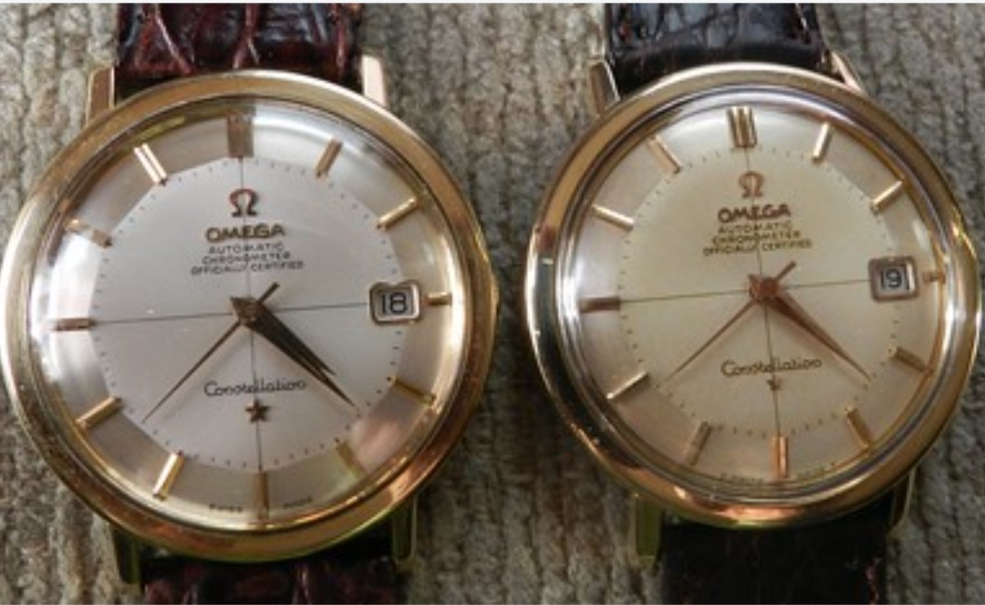

3,790
6,452
My 004's are original, I believe, and they have recessed crowns on both of them.
Certainly, 010 crown is a bit protruded compared to 004.
Above are my 004's with close up on crown.

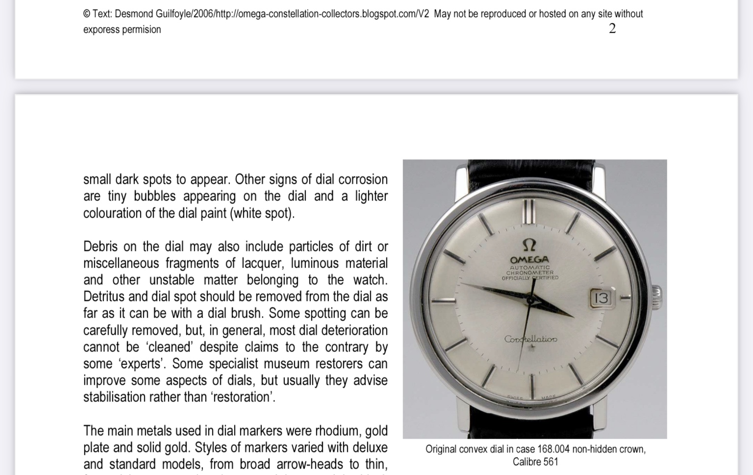

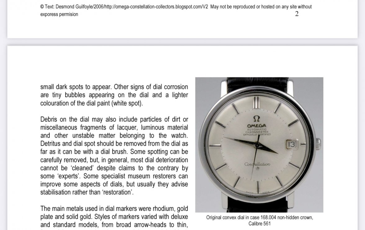

I knew I’d seen a similar crown somewhere.
Courtesy of Desmond’s blog
The case is heavily polished so I think it’s safe to presume the watch is not a virgin example - but this may have been an acceptable replacement crown at some point.

Why would you design a case for a hidden crown to install a semi recessed crown? It's just not logical
Because the clients complained that the completely hidden was so hard to use

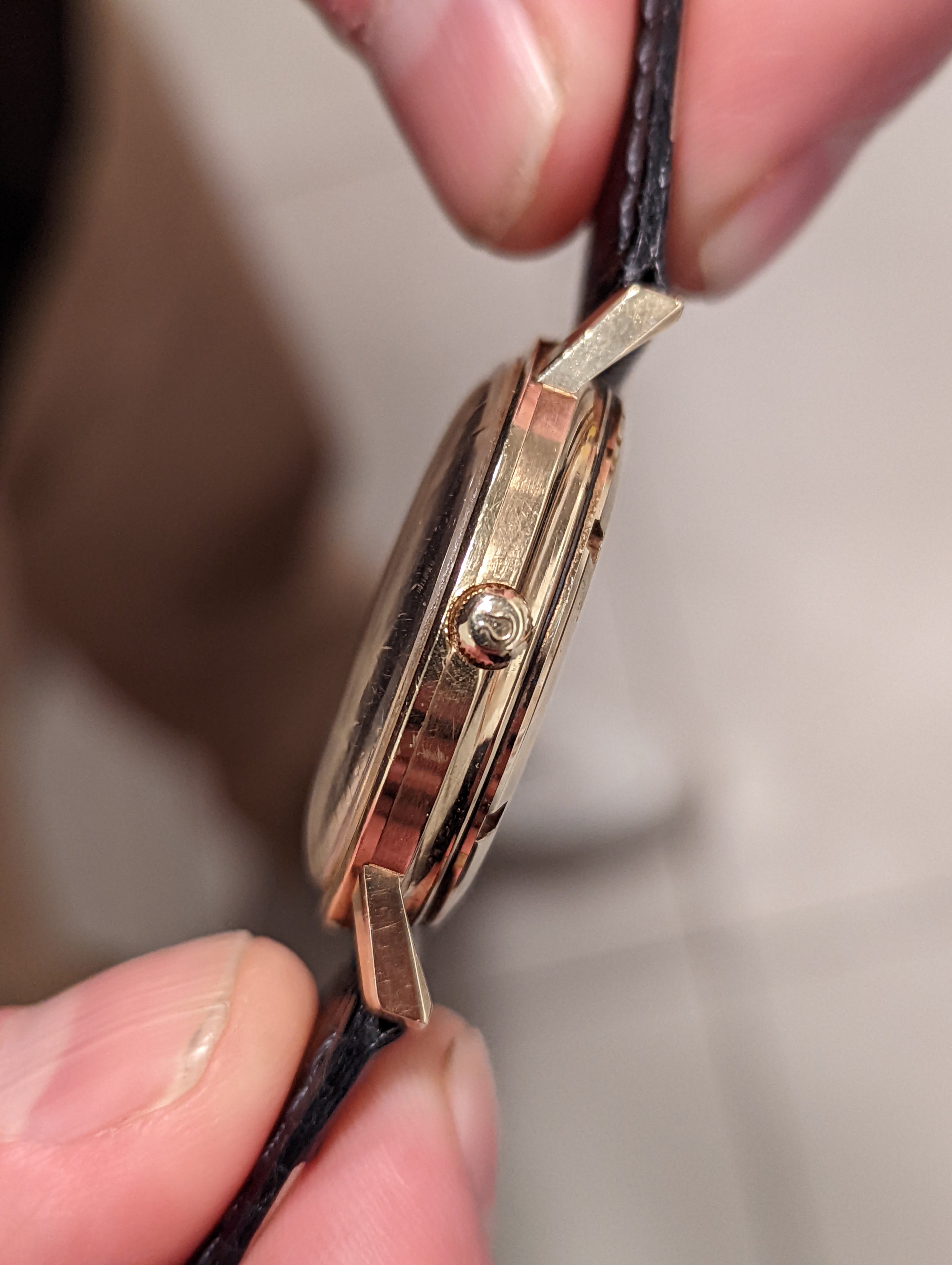

I did end up asking Desmond's view on this. His response (hope he doesn't mind quoting, but I think it's for the greater good of solving mysteries):
It could well be the correct crown if it is solid 14k. Even with 14 k one would expect quite a bit of wear on the crown leading to it being less sharp and more rounded. What I’m saying is that it’s difficult to be certain because of the wear to the crown.
I will share more pictures when I receive the watch at the end of this week. Thank you OF for being so responsive!
6,835
10,505
I too think it’s 100% period.
A replacement but period.

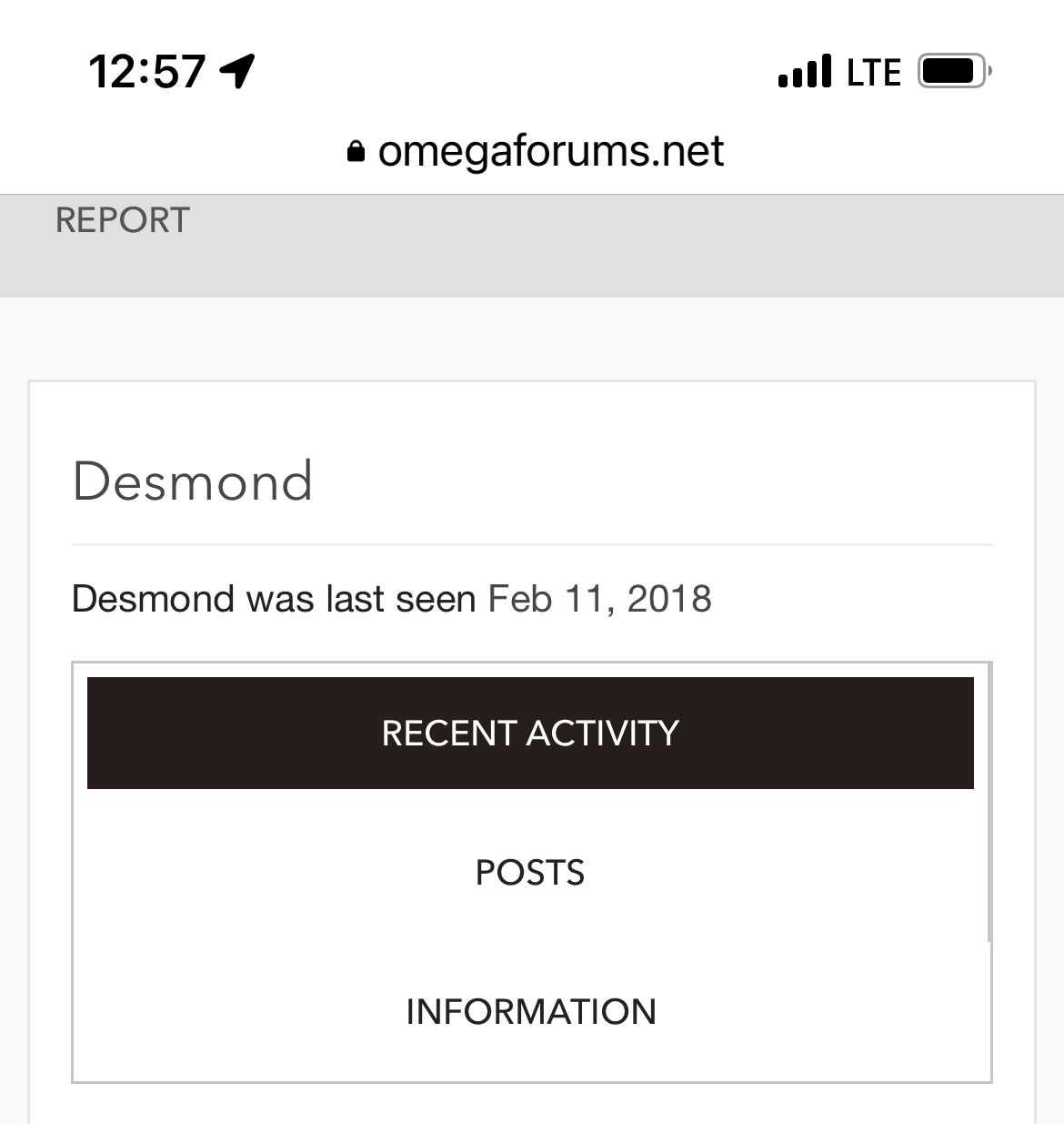

Speaking about Desmond, I tried reaching at him on PM here w/o success, he has not been around OF for sometime now. Has anyone heard from him? 🍿
I've not contacted him recently but he was definitely around on OF in the past few (10) days.
Must just be you.....😉😁
8,318
19,723
Maybe I looked at the wrong handle???
