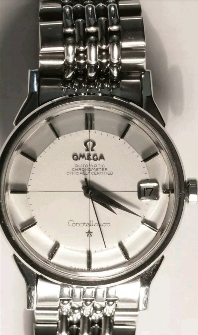

Posts 360 Likes 1,050 Majork ·Oct 22, 2019 Hi guys, I've never seen a 14900 T Swiss Made T dial. Overall the print looks weird to me. Would you say it's a redail?
Posts 9,588 Likes 27,706 ConElPueblo ·Oct 22, 2019 Majork Hi guys, I've never seen a 14900 T Swiss Made T dial. Especially since the dial is without lume. Constellation text is wrong too as is the heavy printed crosshairs.
Posts 360 Likes 1,050 Majork ·Oct 22, 2019 N Noddyman I suspect a fake dial. Do you have any other pics? Nay not really... the watch is on eBay though.
N Posts 1,120 Likes 1,792 Noddyman ·Oct 22, 2019 Majork Nay not really... the watch is on eBay though. Only going off what I have seen before and read on Desmond’s blog. http://users.tpg.com.au/mondodec//Counterfeit_Omega_Constellation_Cases.pdf
Posts 6,835 Likes 10,503 Peemacgee ·Oct 22, 2019·Purrrr-veyor of luxury cat box loungers Classic fake dial. Would need to see side and rear of case to tell if the whole thing is fake.
Posts 1,501 Likes 5,694 KingCrouchy ·Oct 22, 2019 Looks very fake, but to be sure more pictures are needed. Hard pass.
