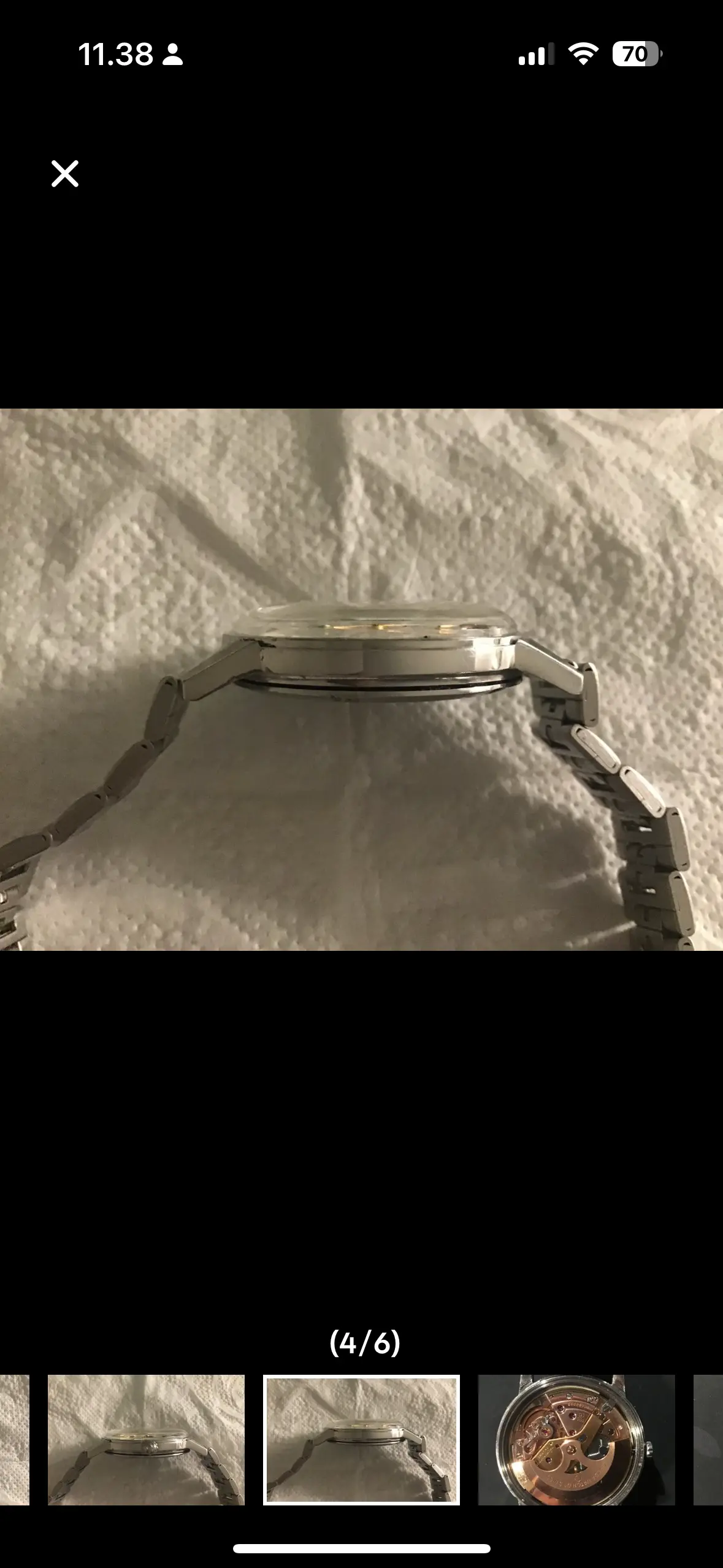

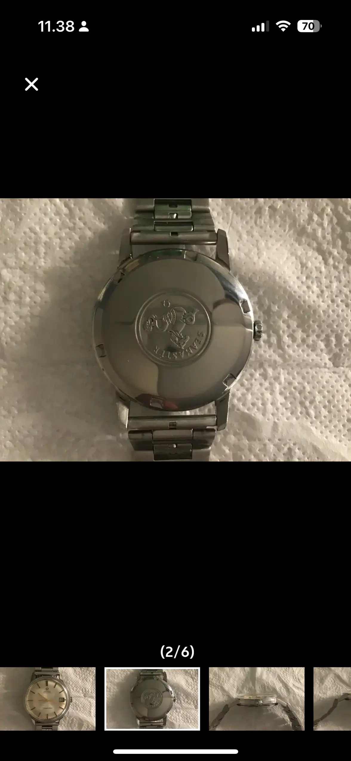

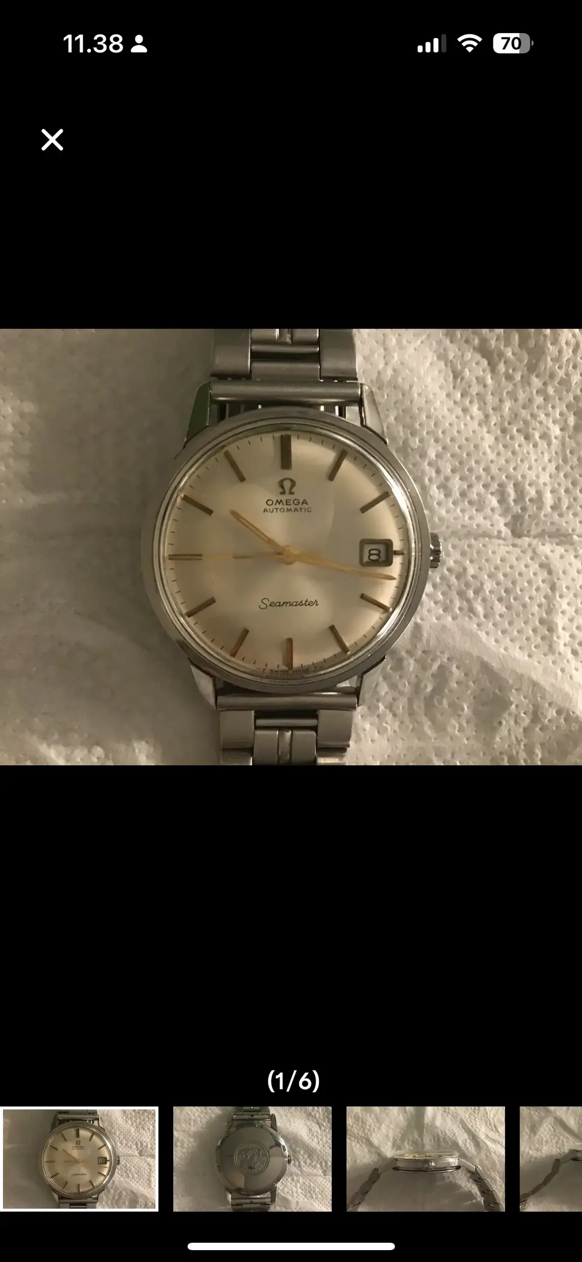

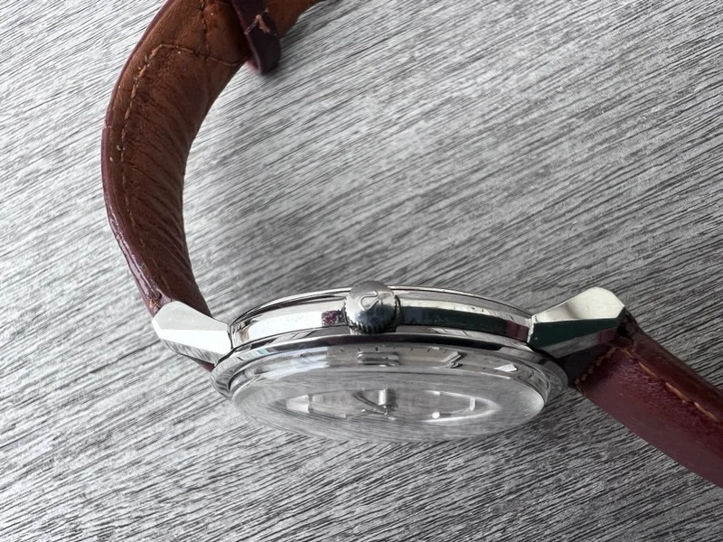

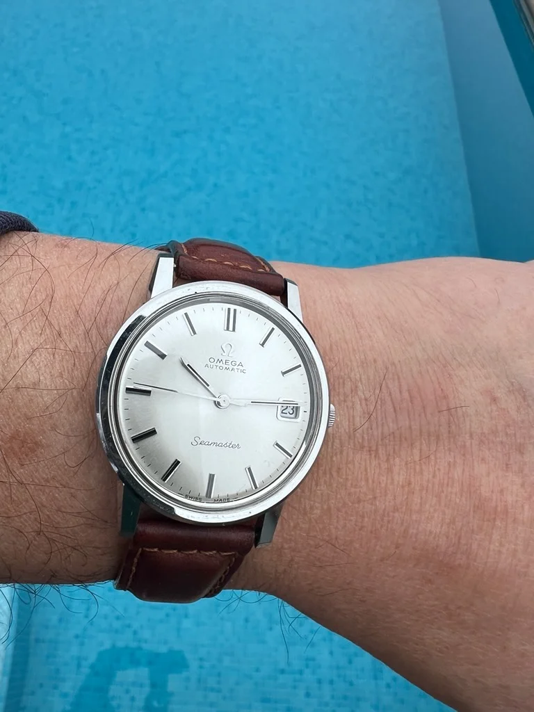

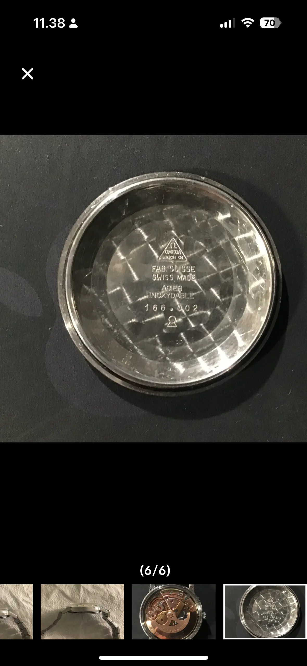

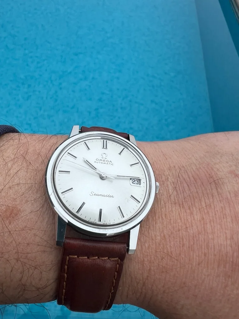

Hello, everyone!

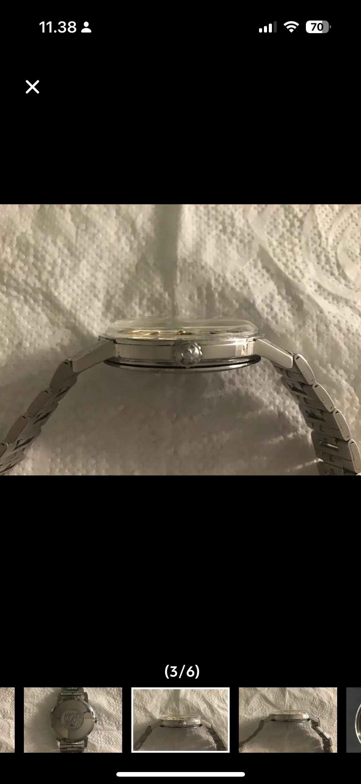

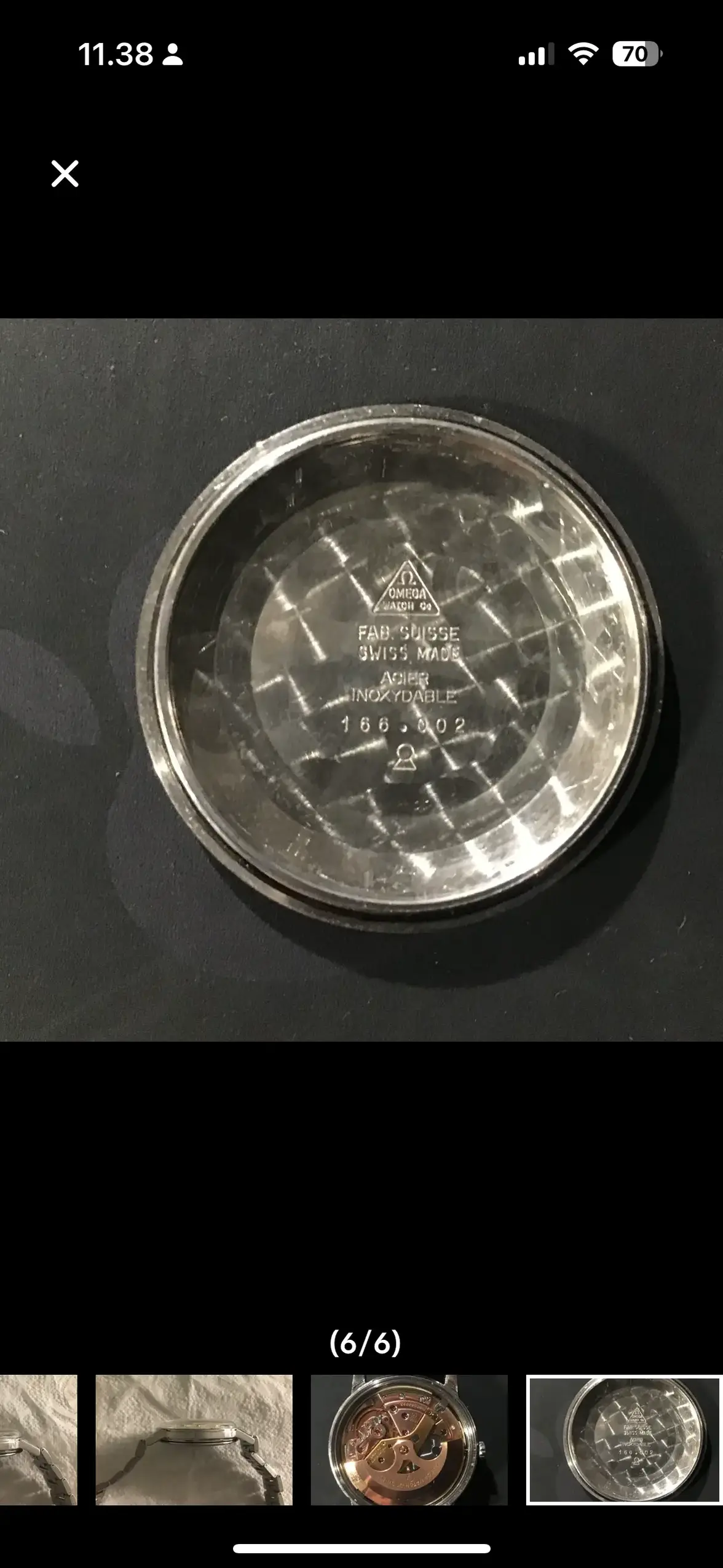

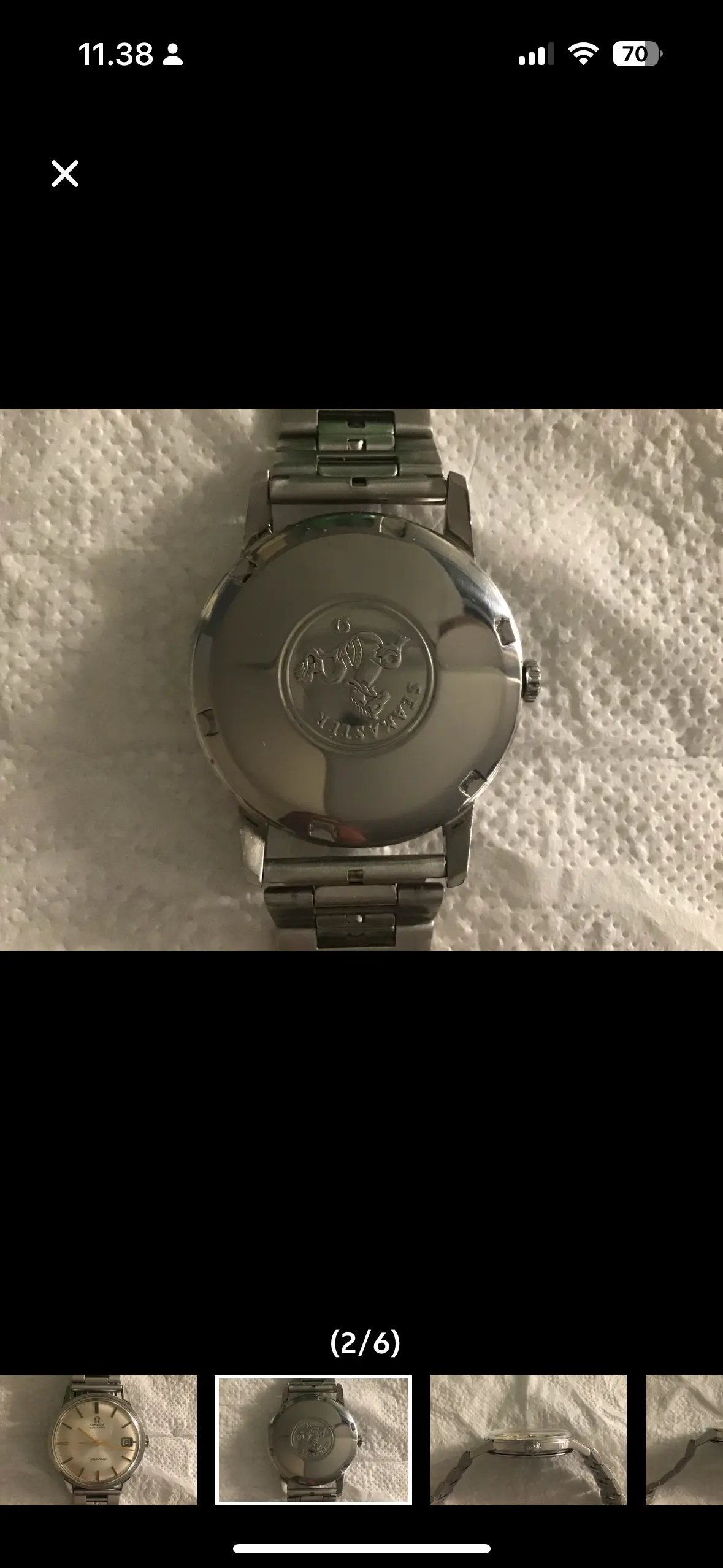

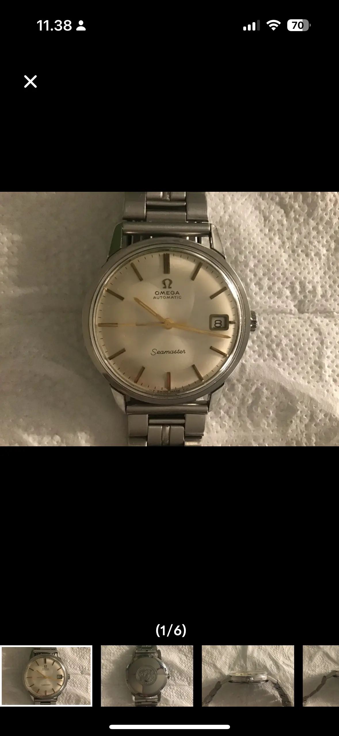

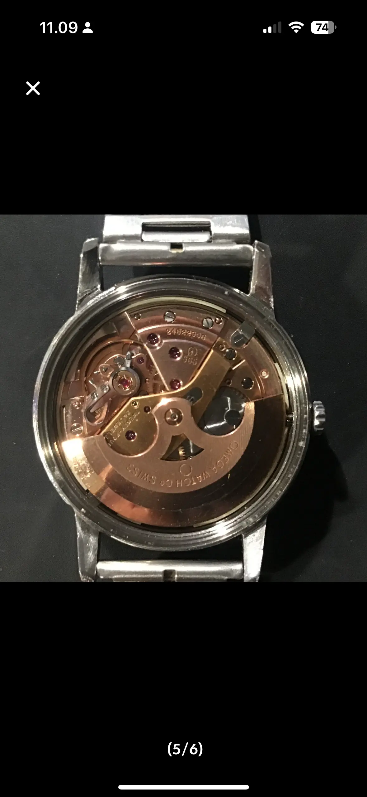

I am concidering buying this Omega Seamaster for €490 ($510). I have been comparing the images provided and everything seems good apart from the orientation of some of the screws in the movement. Could someone help me verify if this watch is original and if the price is fair? Thank you in advance!

It’s a 166.002 (not .022). Everything appears correct but I’d like to see more pictures of the dial. You’ve only shown one which is poor quality and I’d like to see more to be confident the dial is original.

Yes, sorry that was a typo on my behalf. I will contact the seller for higher quality pictures of the dial. What are some signs to look out for in the dial? Do you reckon it would be worthwhile to get the watch authenticated by a clocksmith (or whatever they are called)?

It’s no straightforward job to explain how to validate a dial. If you post better pictures here we can confirm it’s original.
Absolutely no point taking this for authentication. You can find everything you need to know here

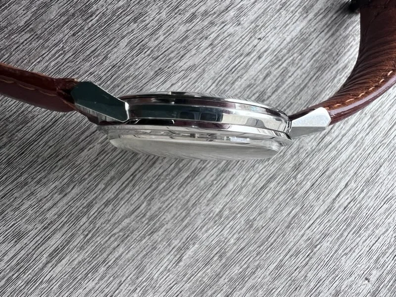

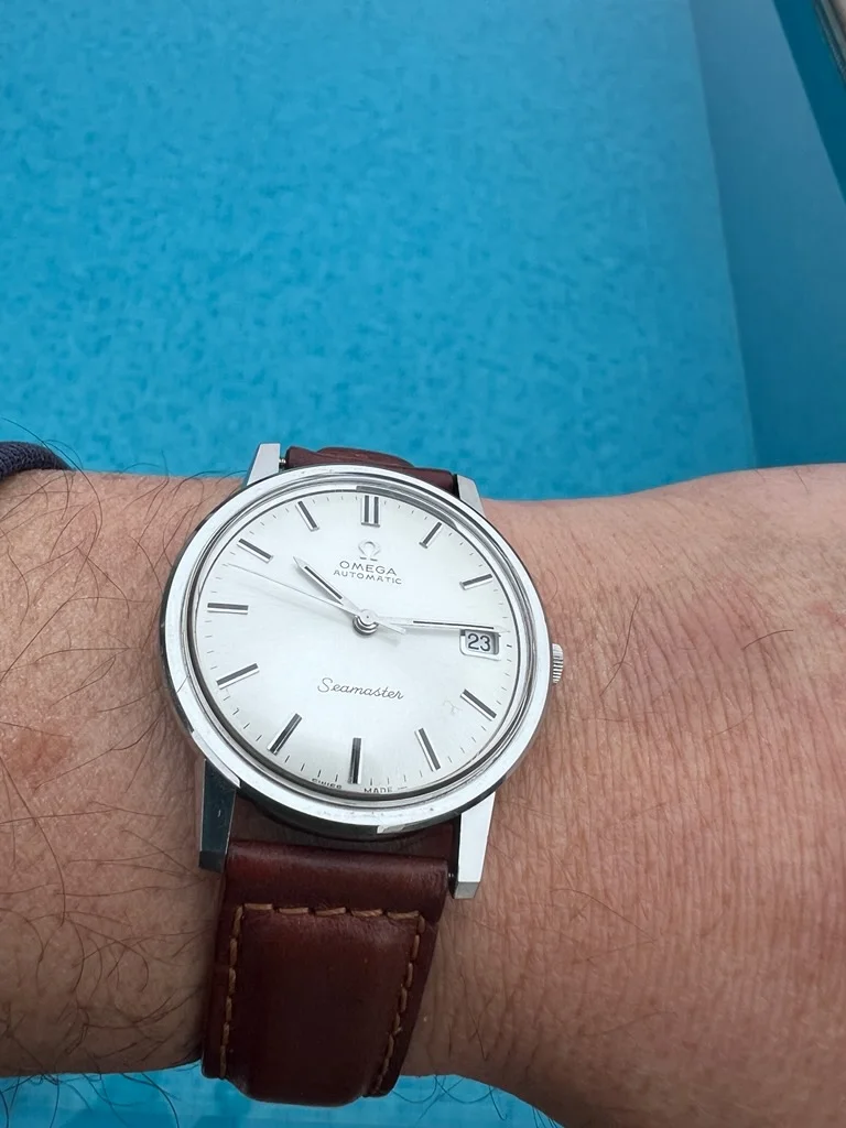

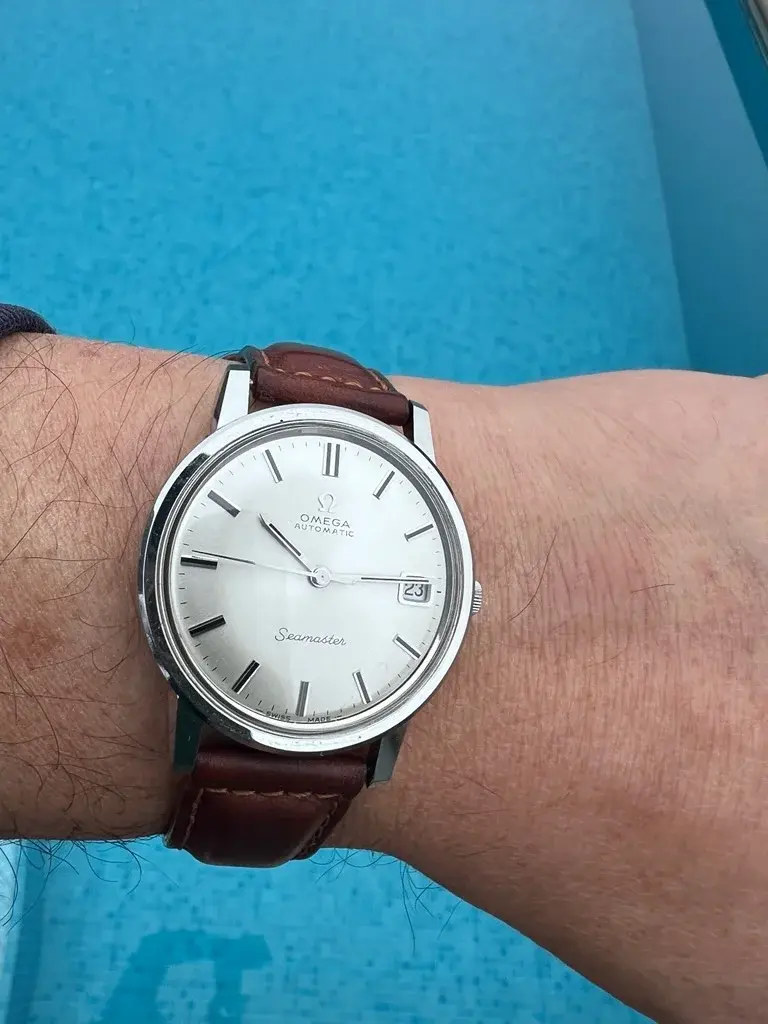

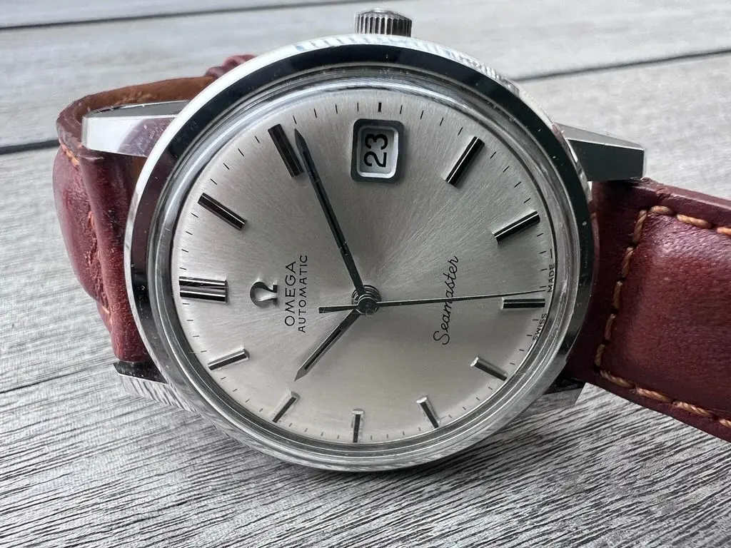

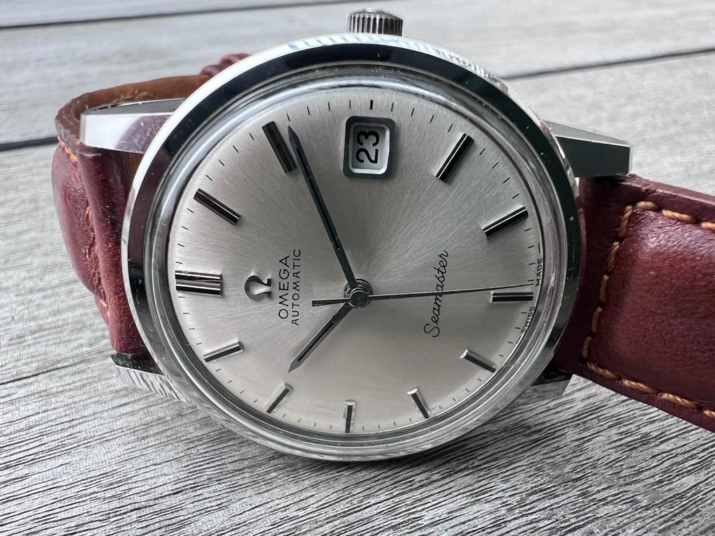

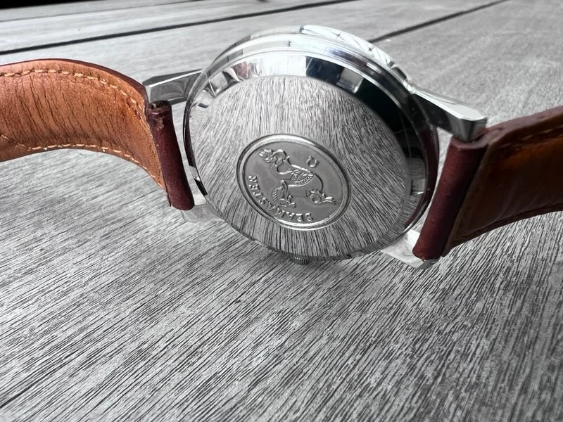

Here is a cousin to your watch, ref 166.003.
565 movement, and serial nr 24.75 mil, so in the same year as the one you are looking at.
The one I have has a different luggshape, and also different indices.
But you could see the condition, and compare with yours?
Take your time, your reference (and the cousins) are easy to find!
And you also might have to set a budget - condition costs....😉

“Orientation of the screws in the movement”? I am unable to believe what I am reading? Unless my interpretation of your meaning is wrong.

I believe he meant the orientation of the drive/slot on the screw heads. That is not significant as far as I know.

That was my interpretation as well. I am unable to believe that anyone would think that was related to the quality or condition of the watch! Learn something every day!

This is what comes from people trying to learn about things in isolation over the internet. They overlook significant things (like overpolished cases, poorly printed dials, and mismatched colors in the movement) and think that minutiae are important (like screw-head orientation). I always recommend that new enthusiasts join a local meet-up group of watch enthusiasts to get some first-hand experience handling watches and seeing how more experienced people look at them.

Thank you for the feedback. Definitely something I could look into, the meet-up group thing. And the orientation of the screw-heads was just my own observation. I assumed that such delicate movements would have extremely tight tolerances when it comes to the screws. One learns something new every day.
