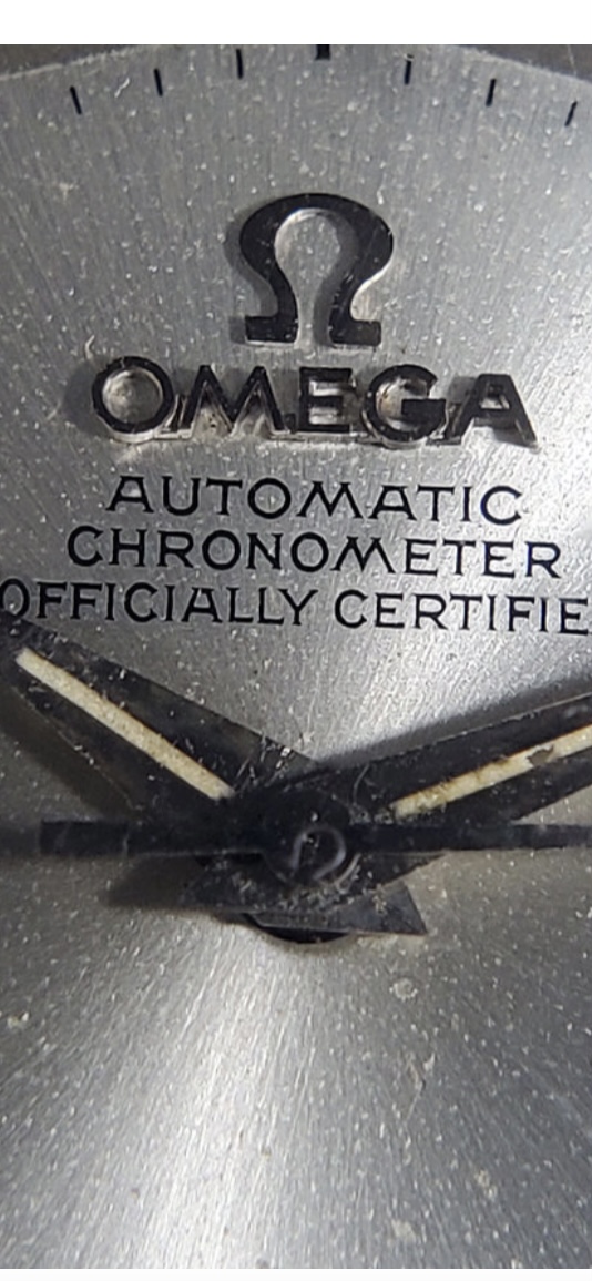

Hi kind folks,
Just looking for confirmation that this looks original and ok please and thank you.
As in not a re-dial, not overpolished etc...
thank you very much

Looks quite good: Neither redialed nor overpolished
Crown is not original

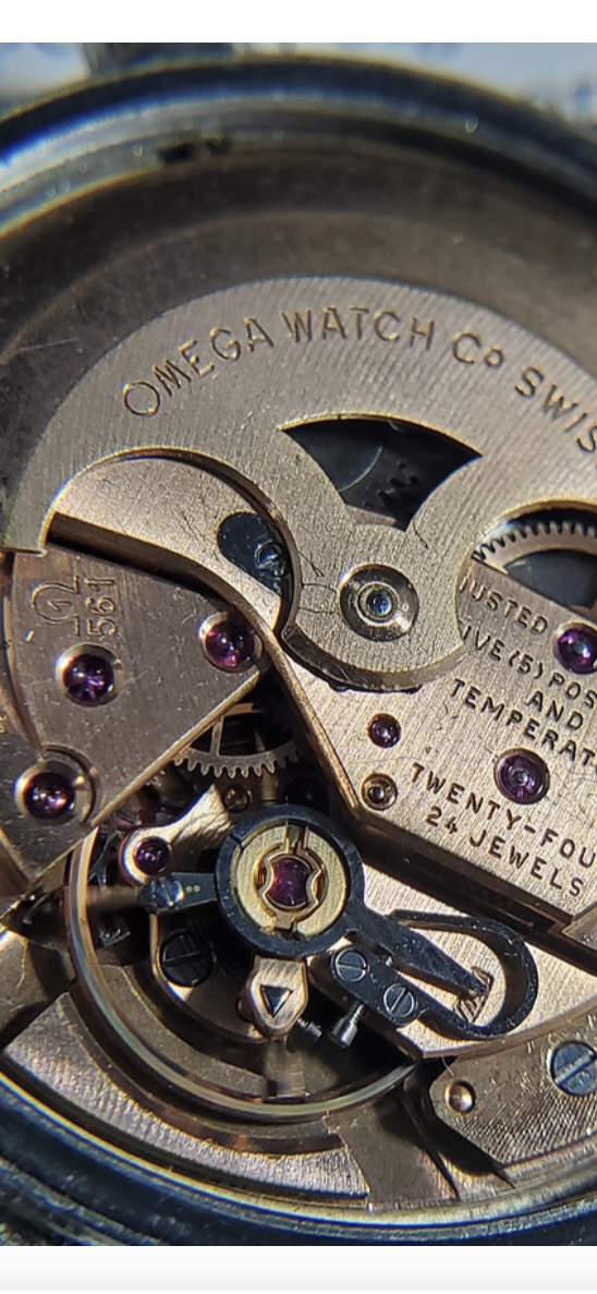

How about movement shots???
Asking price is?

Thanks, I’ll get a movement shot. I know @STANDY has a Connie with this style of crown

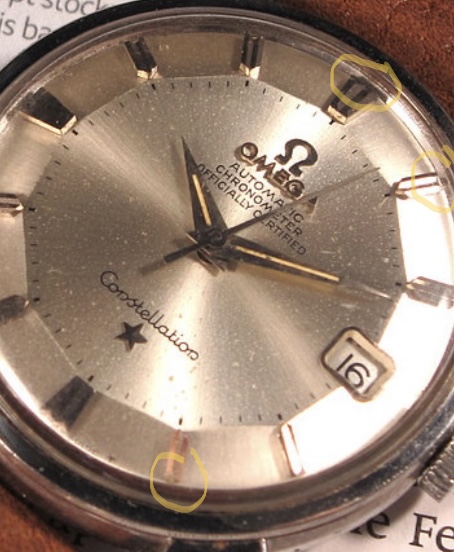

Do all hour markers have lume? It's not visible on the pictures

Very good point, I can’t see them either....

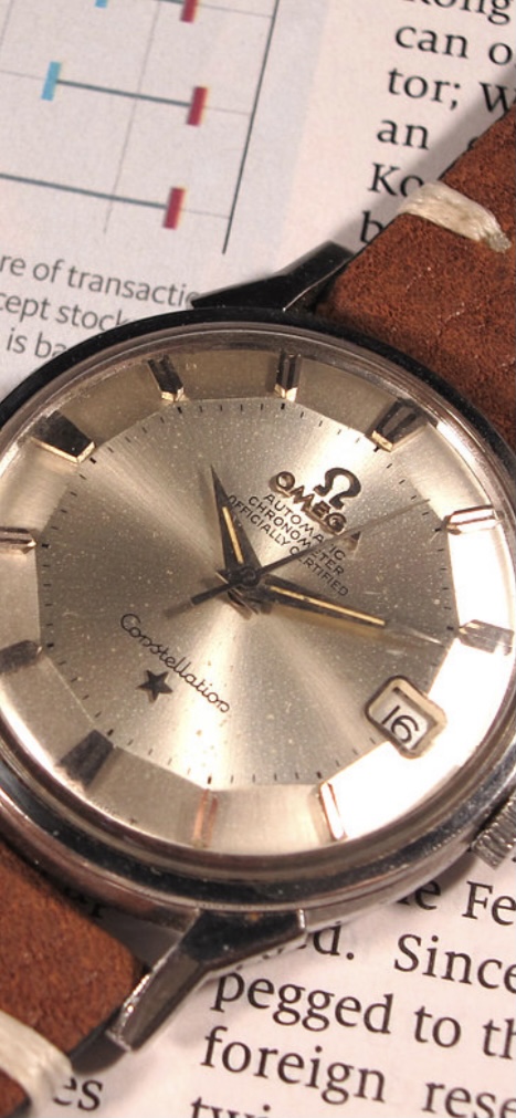

Any more pictures available?
How about a straight on of the dial?

No better pics I’m afraid.
Haha I’m being told now that it shouldn’t have lume plots. I don’t suppose there’s any way it came with lume hands and no hour marker lume from the factory? 🤨

The odds of every single lume plot to have fallen off would be pretty low wouldn’t it?

There might still be lume on the 10 and 11 index - terrible photos, so difficult to tell.
If not it certainly has the concave pocket for lume at the end of the indices.
The watch should have lume - it has lumed hands and at least one T at the bottom of the dial.
Watches frequently have all the lume removed if some of it is missing (looks neater than bits missing and cheaper than replacing it)

Thanks for your reply, yeah I can sort of see some now, just crummy pics. Thanks !

I’d ask for better photos, but it does look like the lume is still there on at least some of the markers.

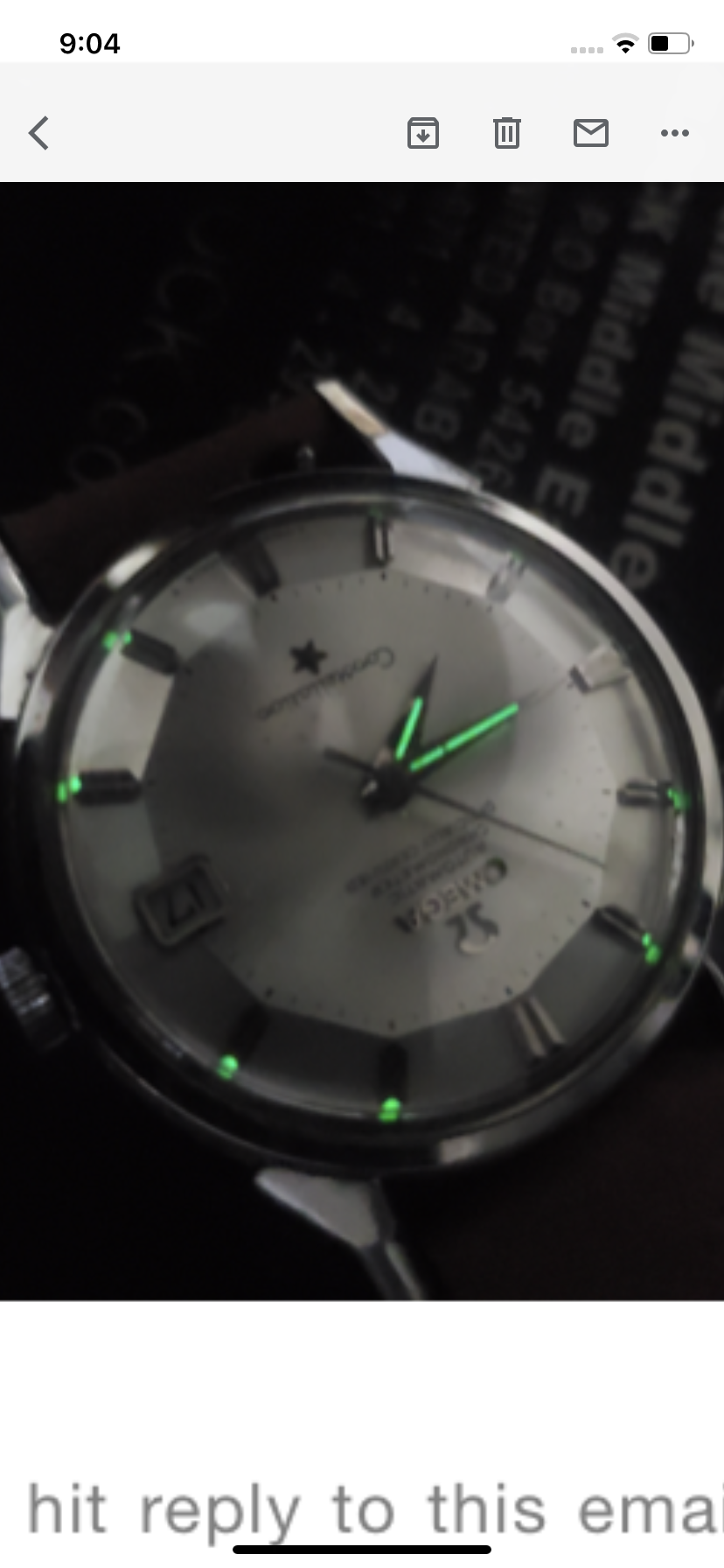

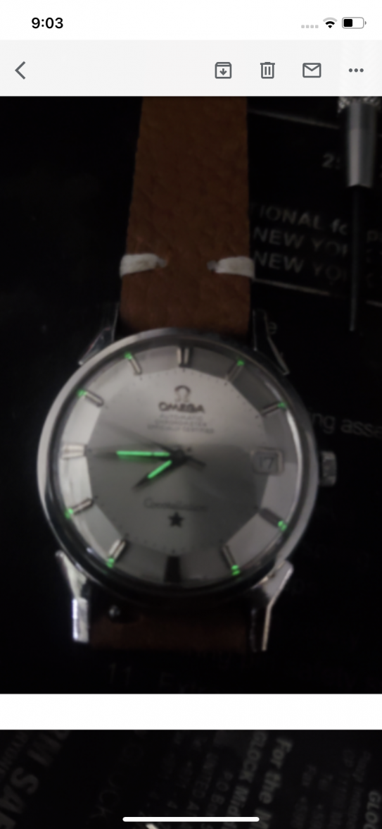

None on the 3,6, 9 or 12 because I don’t think there should be, but otherwise confirmed 🥰

Not a redial, but the dial has certainly yellowed/darkened with age and there is some spotting. I see some corrosion on the hands. Impossible to evaluate the case and lugs without better photos, but the case back certainly shows some wear. Medallion is decent though. Movement looks like it could benefit from cleaning and lubrication. I think that the crown is incorrect. What is the asking or current auction price?

There should be lume on the 3,6&9 too.
The original lume appears to have been removed and replaced with Kryptonite. 😉

Should there be lume on 3,6,9? Really?
