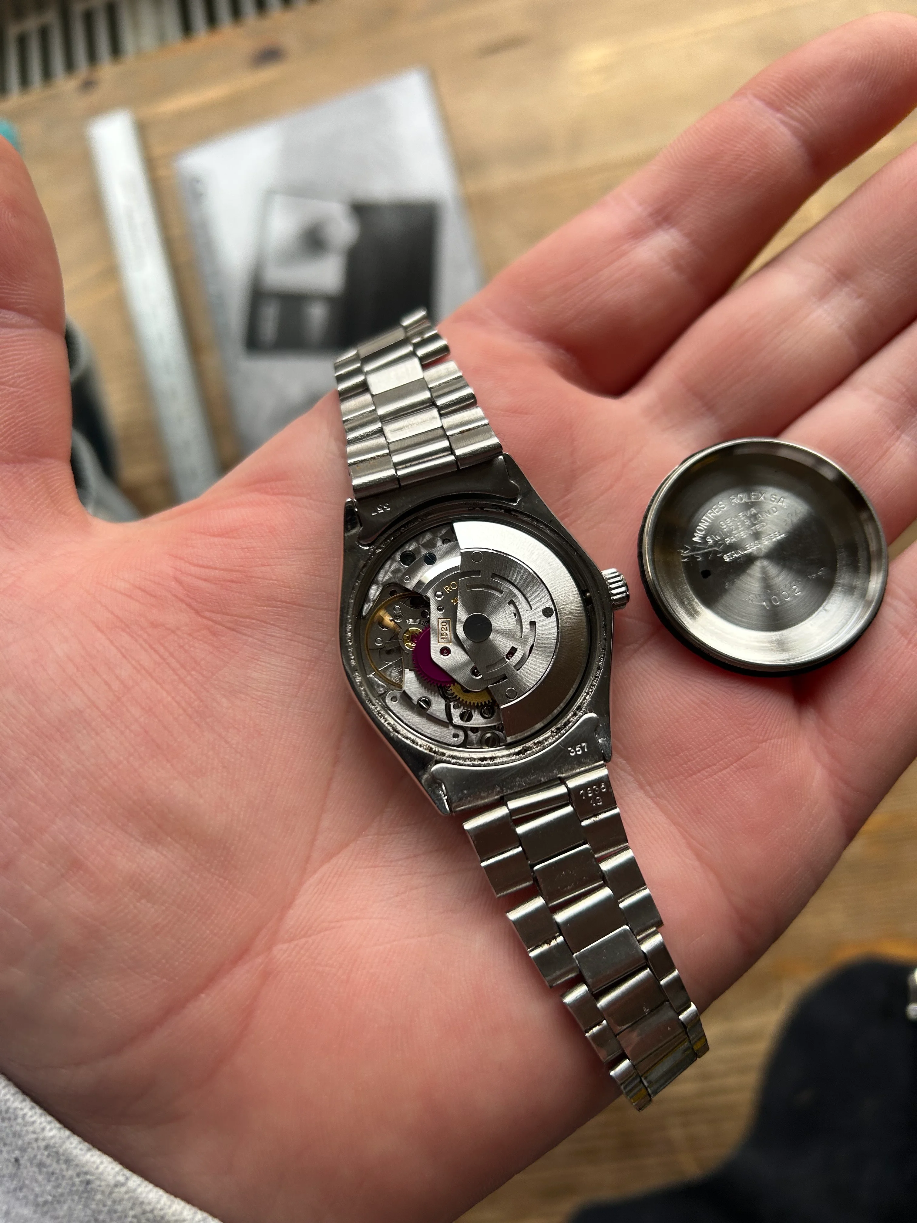

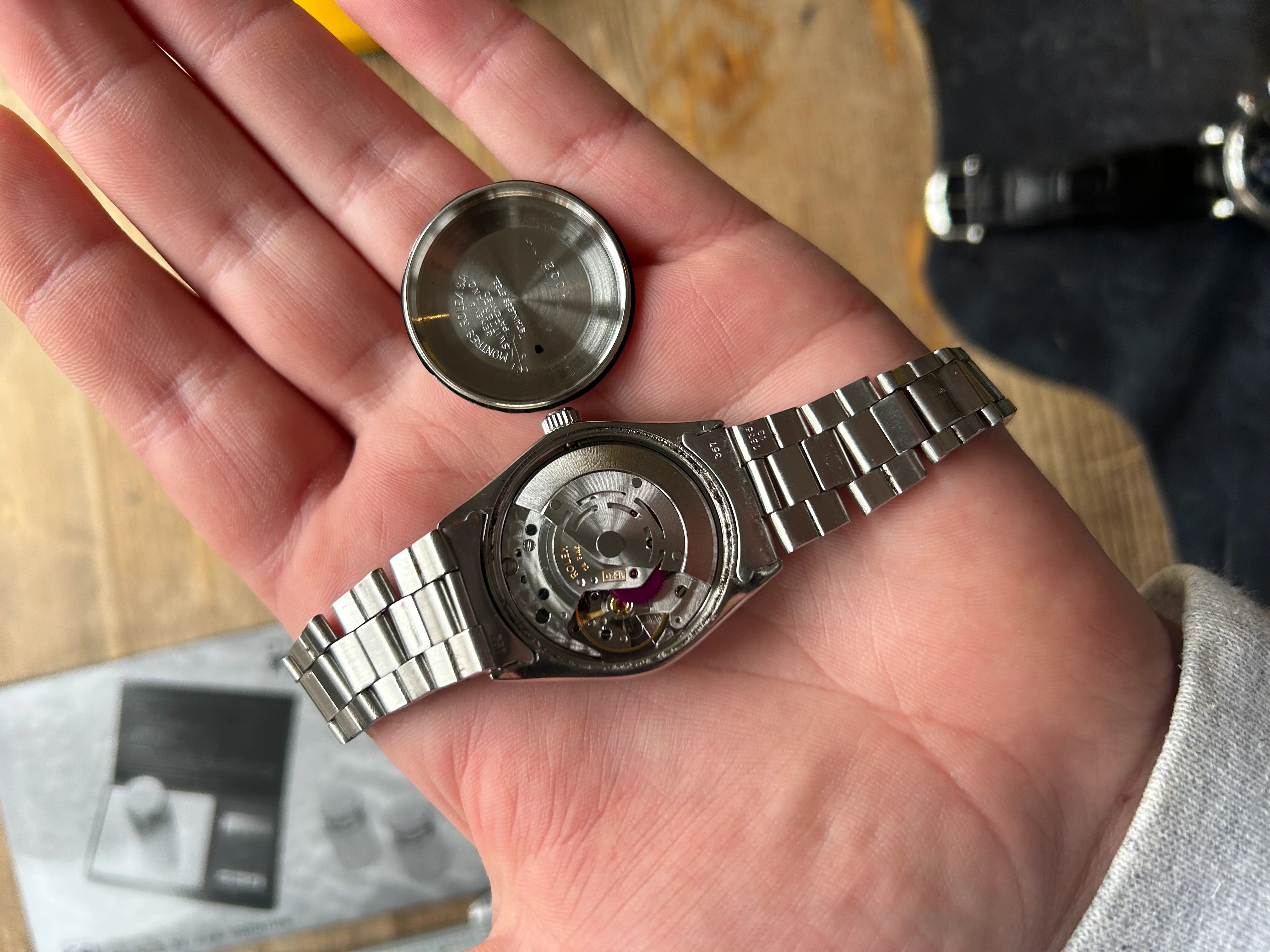

hello friends. I have to pay 2000 E for this , with papers, from 1977. On close inspection one of the links seems missing on the bracelet - do you agree , is it easier to find spare ones ? Are there any other details that appear strange to you. BTW : the lid is a service lid, I am aware of it, and does not bear the same ref nr.

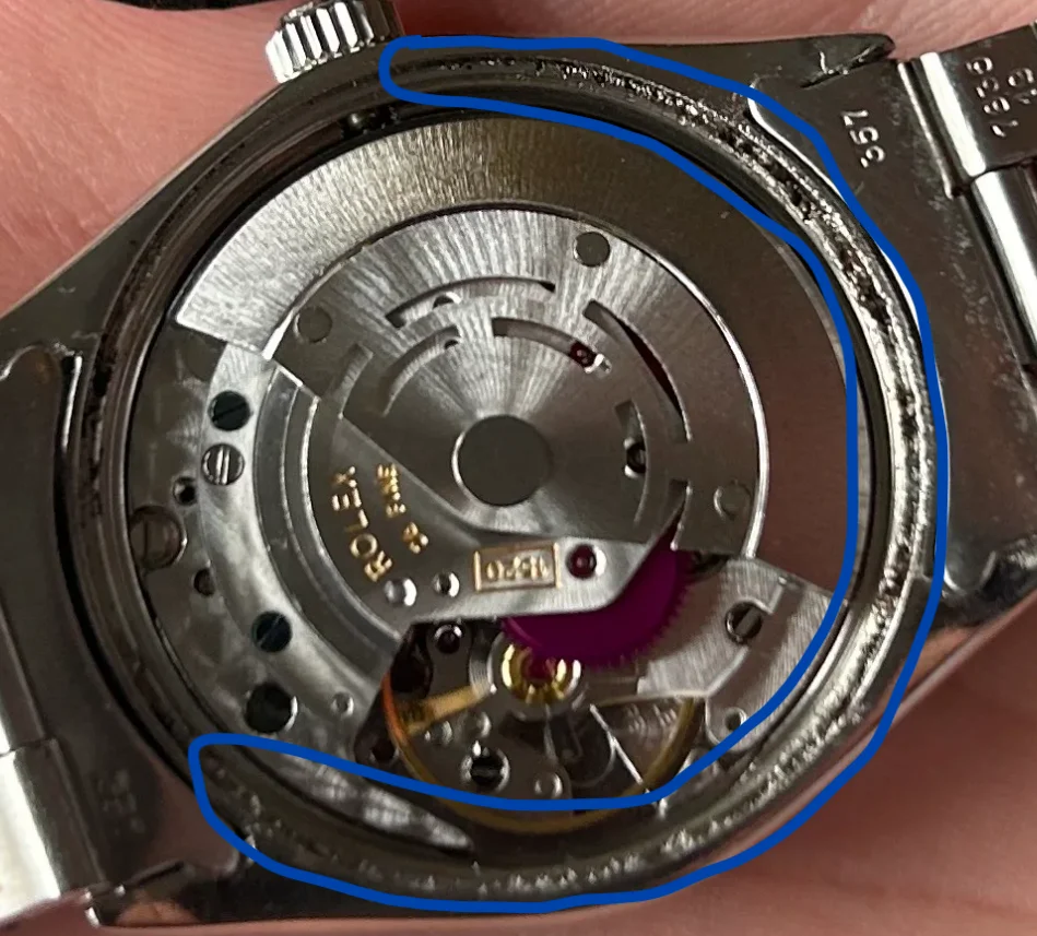

Not sure about missing links, but the bracelet is hella stretched out. 2000€ seems pretty cheap but look at all of the corrosion to the case where the caseback screws in. I know you are looking for deals, but these are the things you need to look out for because they are expensive mistakes.

i think i can ger rid of dust , by putting a special creme on it - grandmother's secret but it works. It is more the braceley on which I would need your advice.

The photos are pretty bad, so I don't think I'll attempt to count the links for you. But as long as it fits your wrist, who cares, that is the least of the issues with this watch.

I'm not seeing any obvious missing links in terms of width. If you are seeing a gap, perhaps you can make it clear in the photos so we're not trying to read your mind. But obviously the bracelet is unwearable as is and needs a $500+ restoration. And for a small ladies wrist, you will probably need several links removed anyway, so you will never have a gradual taper.

1st photo : 3d link down , much smaller than the rest.

That is a stretched out link yo, not a missing link. Think for a minute about how the bracelet is constructed. Also, tell is all about granny’s cream that can un-pit stainless.

A major problem is the groove for the gasket is heavily corroded? Likely worn by someone with very acid perspiration! You’ll never get this case to seal properly! The gasket which is still around the case back is not the correct gasket for this watch. Forget the missing link. Forget the mismatched case back. The case is trash.

probably used (or stored) without the gasket - > electrochemical corrosion by (slightly?) different materials of case and caseback??? This steel is usually INOX. Am I wrong?

Are you sure? I disagree, it sure looks to me like there’s a significant step down in the widths of the links as the links go 1, 2, 4, 5 etc with the missing 3rd link being the cause. I’d avoid this watch.

A Rolex bracelet will not hold together with a missing center link. If the link is stretched out you will see gaps like that.
