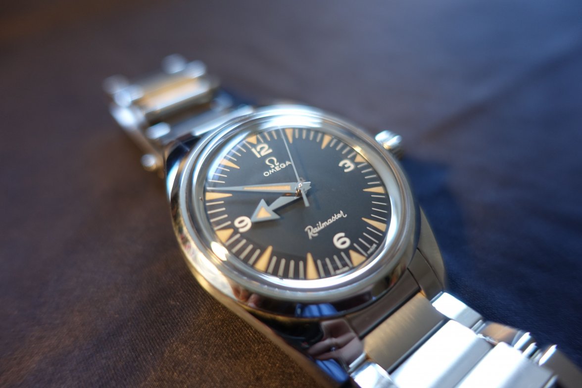

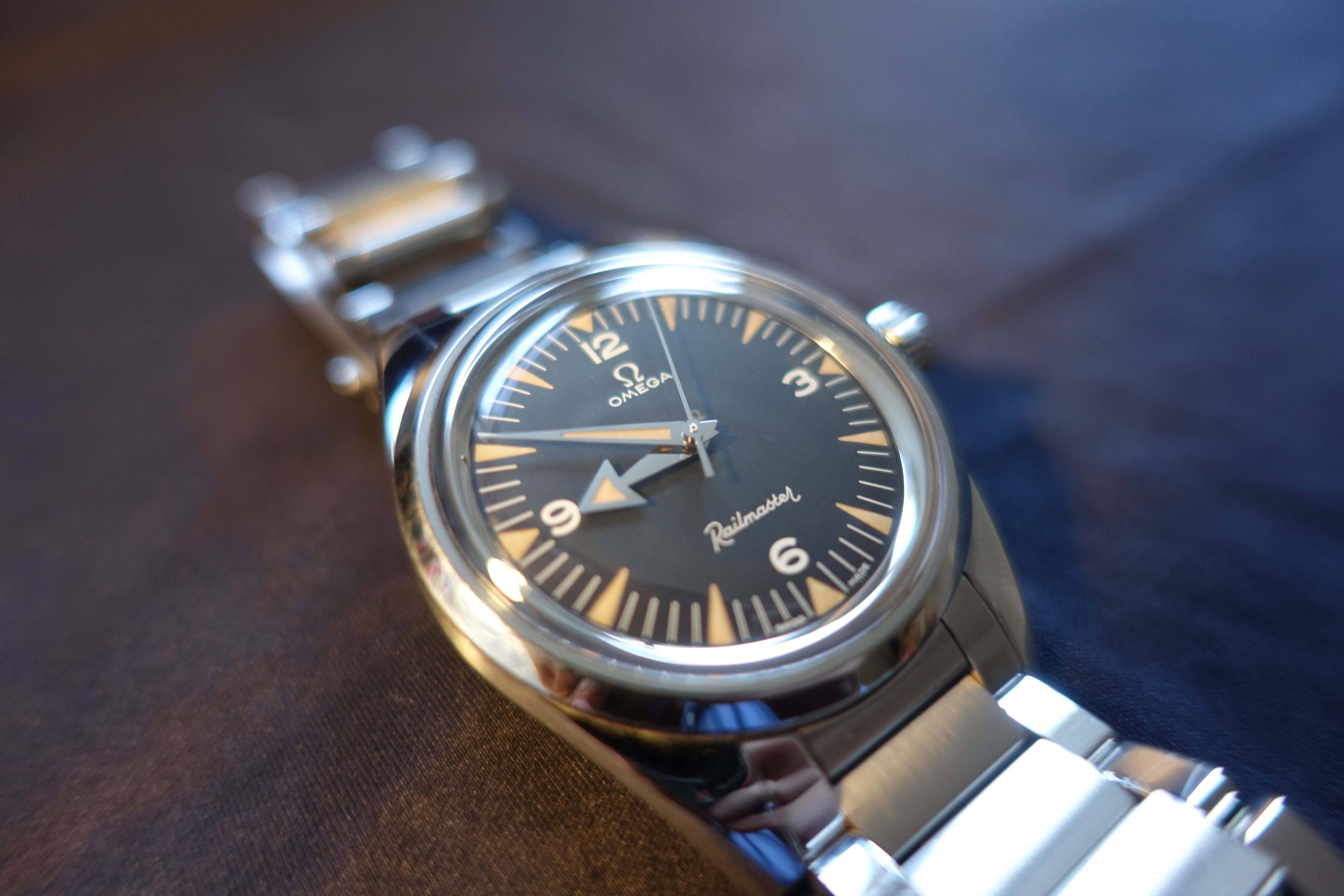

Popped into an OB today at a mall in L.A. when I was there, anyway. After what happened to my new Railmaster, and after swimming several times in my Speedy Pro during the past year (with no problems), I did get to thinking. My Pro is about two years old now, so I wondered, what exactly goes into this annual pressure check that is recommended?
So I inquired with the nice young guy on duty in the OB and told him where I was coming from and why. He was borderline amazed when I told him I swim in the Pro. I said, well, 50M is 50M. He then started giving me the old "Well, I don't recommend it with that watch, and yeah it's rated for 50M but that's static and when you swim the pressure increases ... "
I sort of cut him off and said, that's a myth. Immediately apologized for interrupting him but then explained briefly why it was mathematically silly. He's paid to be nice and continued to be nice but I could sort of vibe that he still thought I was nuts.
Anyway we talked for another few minutes and he told me he offers sending my watch (or anyone's Omega) free of charge to the San Diego OB and the tech they have there for a complimentary pressure check and cleaning, which I though was very nice. May do it. But I walked out thinking, yeah, most of the people who work here don't know much about reality in these matters. They recommend stuff on the super-safe side because they don't want to be blamed when it goes south, which I totally understand.
Regardless, point is I'm still a bit cloudy on what the actual course of action should be if you want to swim in your watch. "They" say you should do an annual pressure check. OK, makes sense. But if the watch passes the test on two-year-old seals, then what? You just go another year? I'm not dumb enough to think seals that pass the test on a Tuesday might not the next Friday. Things degrade gradually and fail over time, they don't go from 100 to 0 instantly.
Maybe @Archer can chime in here. If I want to keep swimming in my watches, maybe it's really advisable to replace the seals once per year regardless of the results of a pressure test? I'm leaning that way, more than just a little bit.

Thanks, Al, that was the sort of input I was looking for. I didn't know what, exactly, I was comfortable with because I had only ever gotten as far as the general advice to have the pressure test done annually. That's when it occurred to me, yeah so the watch passes the test, what do I actually do with that information, then?
My Speedy doesn't get worn every day, but it gets worn let's say at least half the time. I hadn't considered the crown seal wearing as a result of winding, so thank you for pointing that out.
I think next month once I get my RM back, I'll have the OB send it out to the other OB for the pressure test. Will probably just ask them to replace the seals, unless the cost is exorbitant. At this point, they are probably closer to three years old than two from the actual date of manufacture. Thanks again for the additional input, as always.

Just to report back that Omega accepted the watch back and likely be repaired under warranty, pending outcome of diagnostics from the service centre. Should have it back within 4 weeks.
Interesting remark from the OB rep was that the dial would potentially not be covered under the warranty, only the movement. Lets see what the diagnostic comes back with but that does not seem right to me, when they acknowledge faulty product performance, then why only partly rectify it. Have a feel it won't come to that though.
Interesting note on the dial btw, using the magnifying glass in the store, the luminova seemed mostly effected, some raindrop-like build up had formed on them, which appeared as crystals to the naked eye.
Will let you know how the story ends...thanks for the (emotional) support so far!

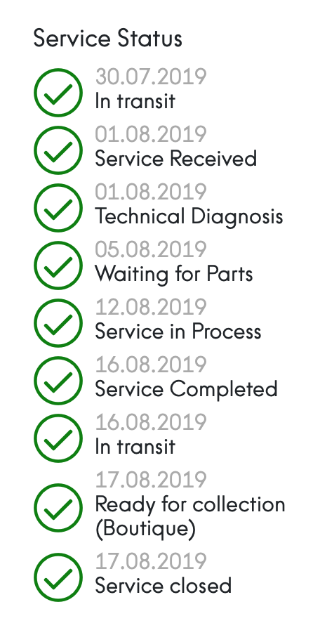

@rainking. Attached is the status trail my repair walked through. It took about a week for the parts to be received, followed by the service which took 4 days to complete. Maybe within Europe delivery is quicker than Switzerland to US? Maybe you can give the Service Centre a call to ask for an update? Really hope you'll get yours back shortly.

Interesting to notice they started the service on the 12th and finished it the 16th. I would have expected they would take some more time for testing. I know for a fact the Rolex guidelines are 2 weeks on test before releasing the serviced watch again to the customer on a wrist simulating mill.
As a second thought on your incident. You were on a hot day wearing the watch. The air in the wat h gets hot and expands. This overpressure will seap very slowly over the cause of one or more hours past the seals to the outside world and the pressure gets the same as the outside pressure. After some time you jump in the cold water, the air in the wat h rapidly cools down and creates and underpressure inside the watchcase, in other words it starts to suck on the seals. If ther is only a slight imperfection on the sals, the seats of the seals they will leak and you will suck in a tiny amount of water. You get out of the water, the watch warms up, it looks all fine no condensation, but later that day you the temperature drops, or you get inside and now the glass cools down and you notice the condensation of the suck in water.
So bottomline, if you have a waterresistant watch (anything below 100 mtrs or more) cool down the watch a bit by covering it with you hand till it gets to body temperatue and than enter the cold water. This helps to prevent the pressure shock of the air inside the watch.
Btw, nice to hear Omega gave you a hassle free guarantee treament
