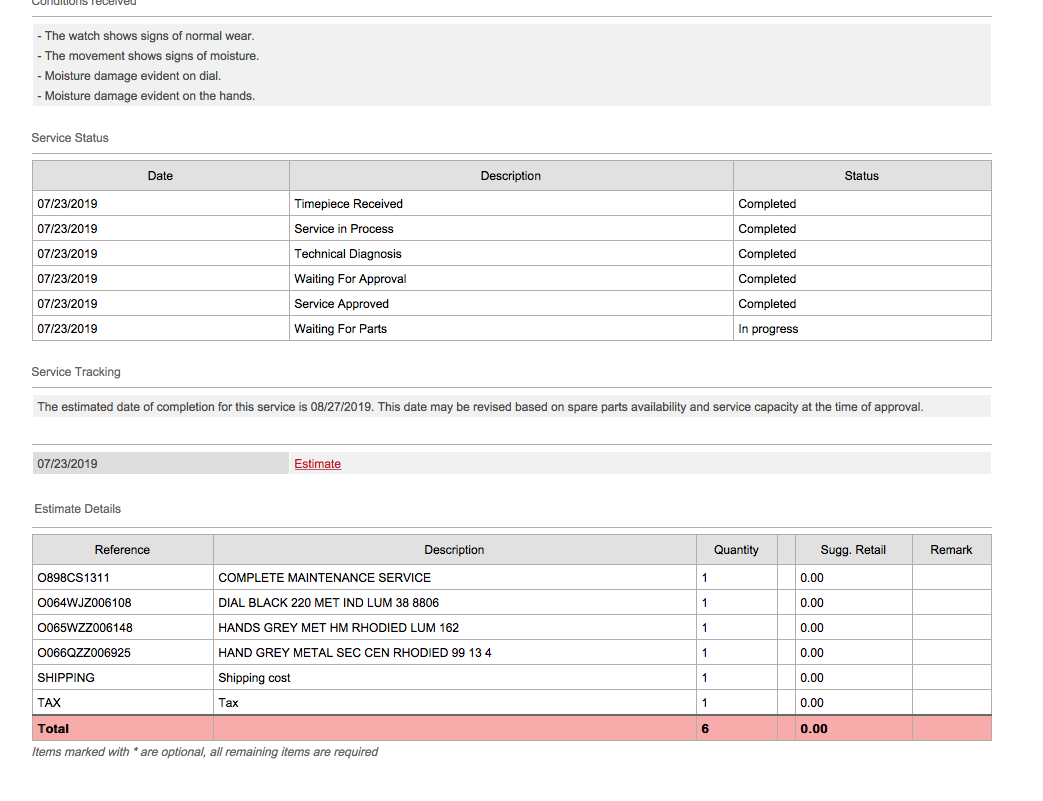

The latest. Getting full service of course, plus new dial and new hands. Not thrilled about their estimated completion date in late August, but what can you do.

Well, that's a pretty good result. Disappointing that it happened, but good on Omega for addressing the issue with no fuss or pushback. I've had a couple service experiences with Swatch where the actual completion date beat their estimate, so perhaps you'll get it back sooner.
For sure. I honestly never expected any trouble from them over it. I've had nothing but good experiences with the west coast service center. And yeah, hopefully they get it done quicker than the estimate. Hopefully it's a case of giving an estimate on the longish side just so they don't have people complaining if they give an earlier estimate and then don't get it done in time. If not, oh well, it's five weeks, not five months. I'm perfectly happy rocking my Speedy Pro LOL
