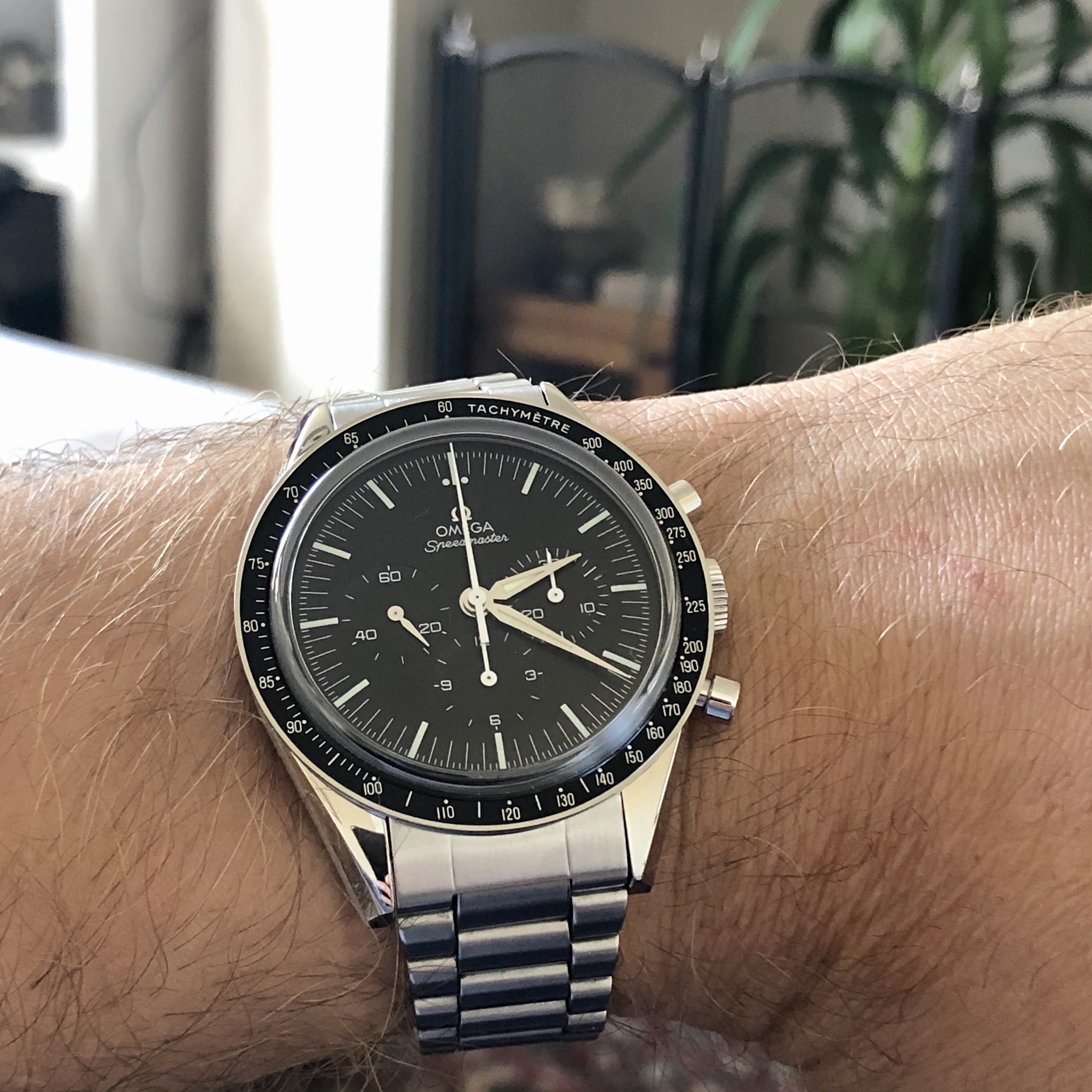

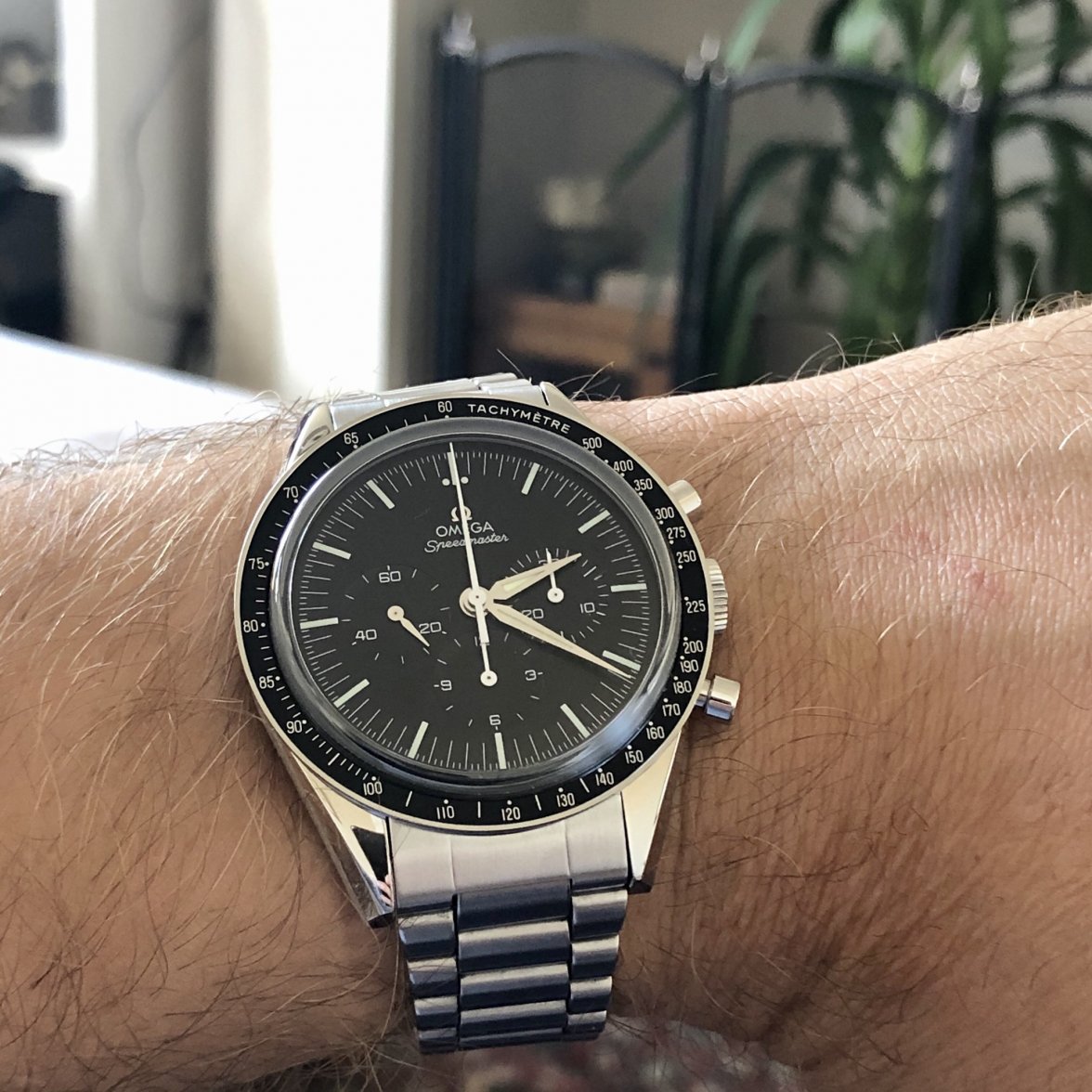

Sent it off on the 10th and just received it via DPD today. I have to say that was a very efficient 10 day turnaround. It had a ‘water resistance service’ under warranty whatever that includes - no spare parts returned so I assume they took it apart and put it back together again and everything looked okay? Pretty decent all the same.

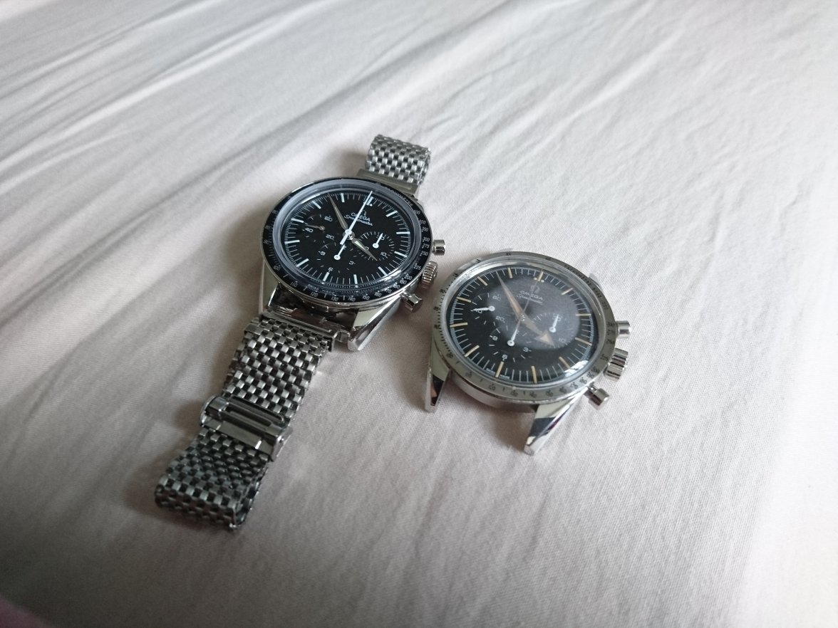

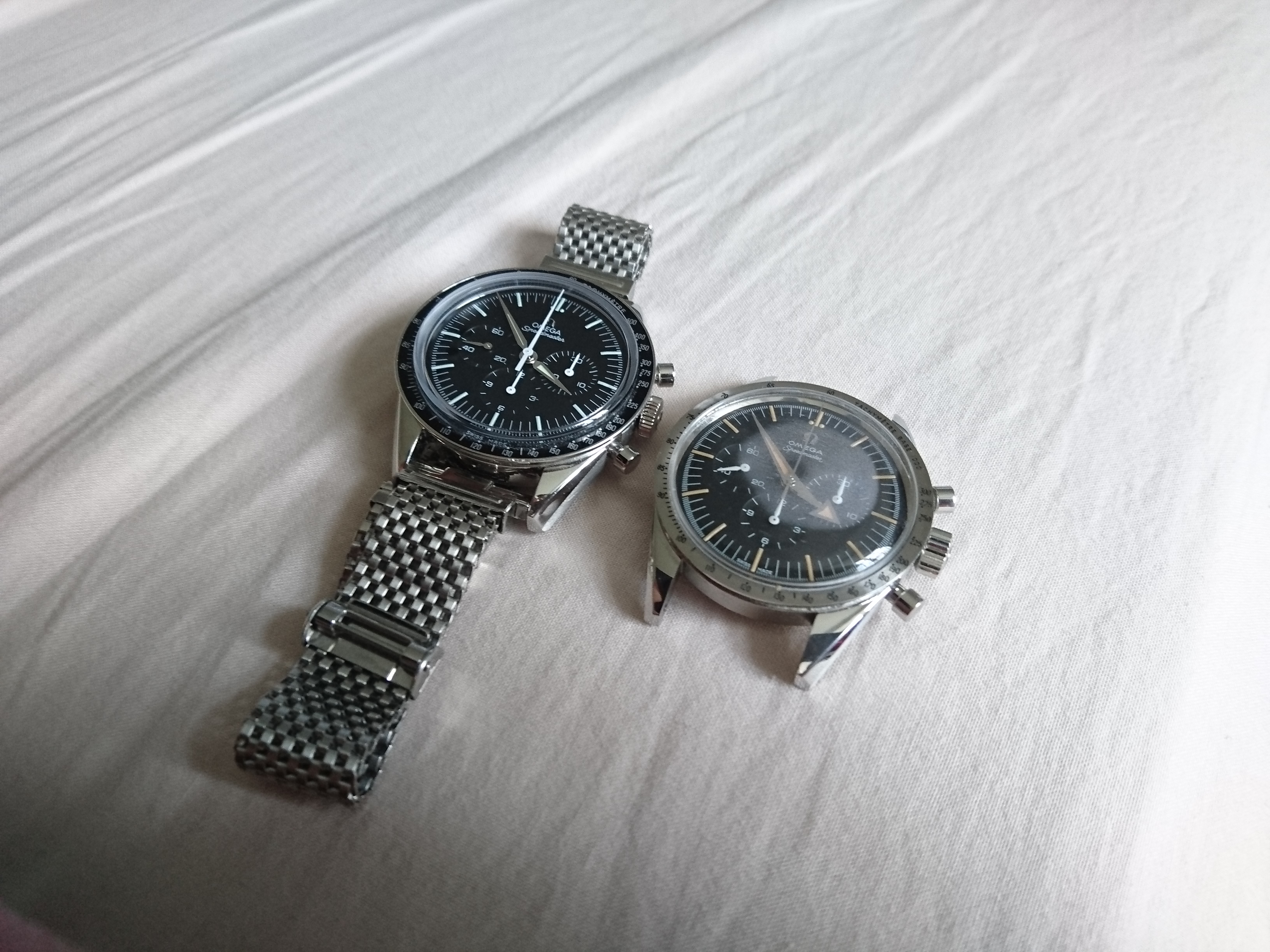

Ah that's great man, superb service, looks fantastic.
What bracelet is that btw? Looks really good on the FOIS.

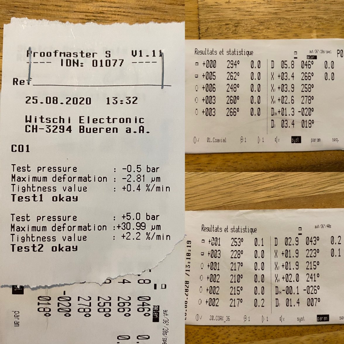

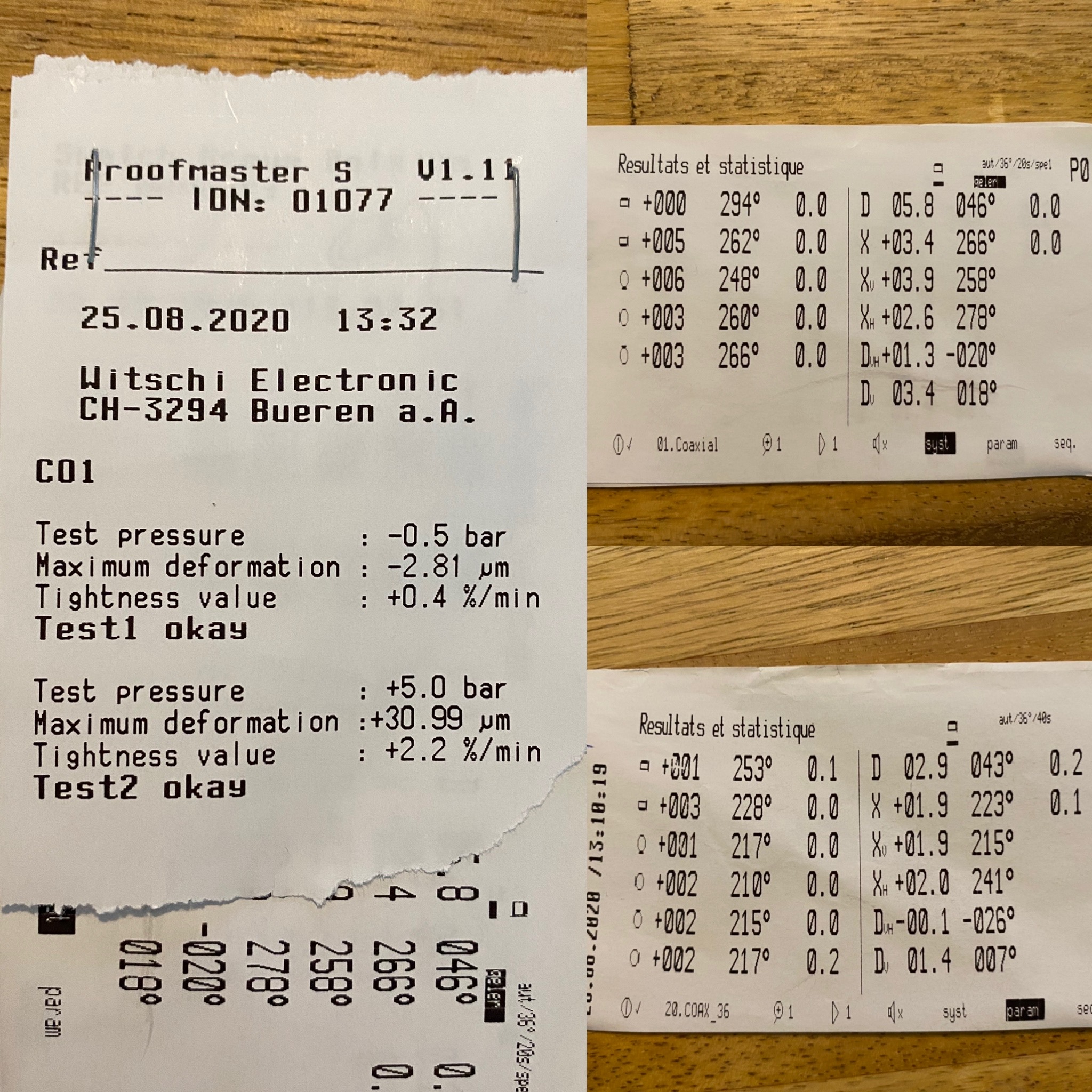

Mine back as well, all looking wonderful again. Collected it a while back but didn't get round to posting earlier.
What surprised me is that I got a new warranty card as well as evidence of the (pressure) tests done. Not sure how to read the stats (see attached) but gives confidence that it was done properly. Makes me suspicious though that maybe last time the service wasn't as thorough as it was this time as then didn't receive warranty card nor outcome tests.
They gave it a complete polish as well which was not what I wanted but didn't think of providing that requirement when handing in the watch. Was actually happy with some of the dings and scratches that were taking some of the shine away that this model has plenty of. No biggie and my fault I suppose and just very grateful for service of restoring the watch.
Hopefully this is the last time I'll have the post this issue in here. Will try real hard to keep the Railmaster away from any water.

I would think you would be more confident now seeing it passed a pressure test?👎
Is that absolutely guaranteed then? Remember this is the second time they fixed the same issue, so hence my hestitation to trust that this model can handle water well.
Seems like you got a bit more detail back from them regards a pressure test! I just got the watch back with a receipt of the water resistance service. Its not had a problem since so I'm going to assume it was all sorted. I hope yours runs into no more problems too.
Its a 1125/617 on my FOIS...
I would have faith in the pressure test results but it's your watch so I can understand you're not willing to take any risks anymore given previous experiences.

Interesting timing results. Dial down amplitude 30 degrees less than dial up at full wind. 😲
If you see any timing issues, get it back in before the warranty runs out.
Oh ok, very perceptive of you, that doesn’t sound like normal variation of the watch’s heartbeat.
I don’t have any tools to measure with any accuracy, maybe I’ll use online atomic time as a benchmark or so for 24 hours and see how it performs.
