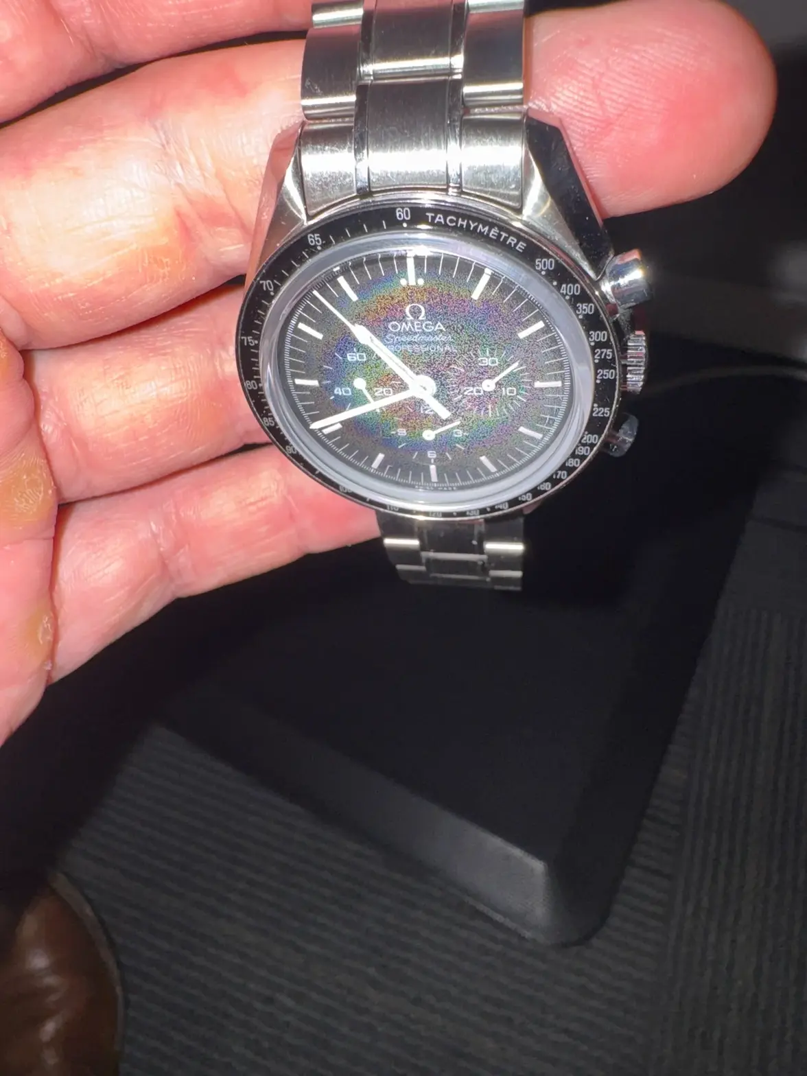

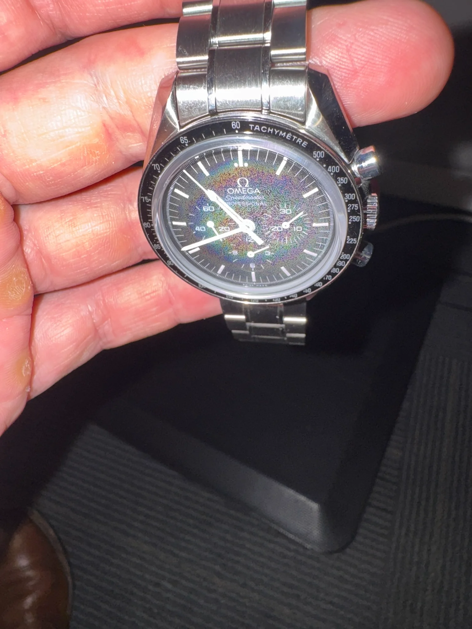

Hello, last week I noticed that there appeared to be condensation inside my Speedmaster Calibre 1863. I took it to the Omega boutique by me and thought what they told me seemed incorrect, but wanted to get your thoughts.
They said that washing my hands while the chronograph is running (not being pushed in, just already running) can lead to water getting inside. This does not seem correct, but is it? The way they were talking, they made it seem like the watch isn't water resistant at all.
Omega tested the gaskets and they said they were fine, so how could water have gotten into it? I have only had it for a few weeks. I am 99.999% postivie I have not washed my hands with the crown pulled as I never pull the crown. I've never swam with this on or taken a shower with it. Is what they told me at the Omega boutique correct? What if the watch got wet from washing my hands and then the chrono was pushed in? Could that lead to water entering the case?
I just want to avoid this problem in the future. I took my watch to a different boutique and they took it for a service, but I don't want to encounter this issue again, so any advice/thoughts would be much appreciated. Thanks!

What's with the milky whits ring on the crystal?
Just lighting?
6,276
30,626
Just lighting?
With cal 1863 that is the sapphire version, so not unusual to see that.
Just lighting?
Lighting. I took a flash picture so you could easily see the condensation.
