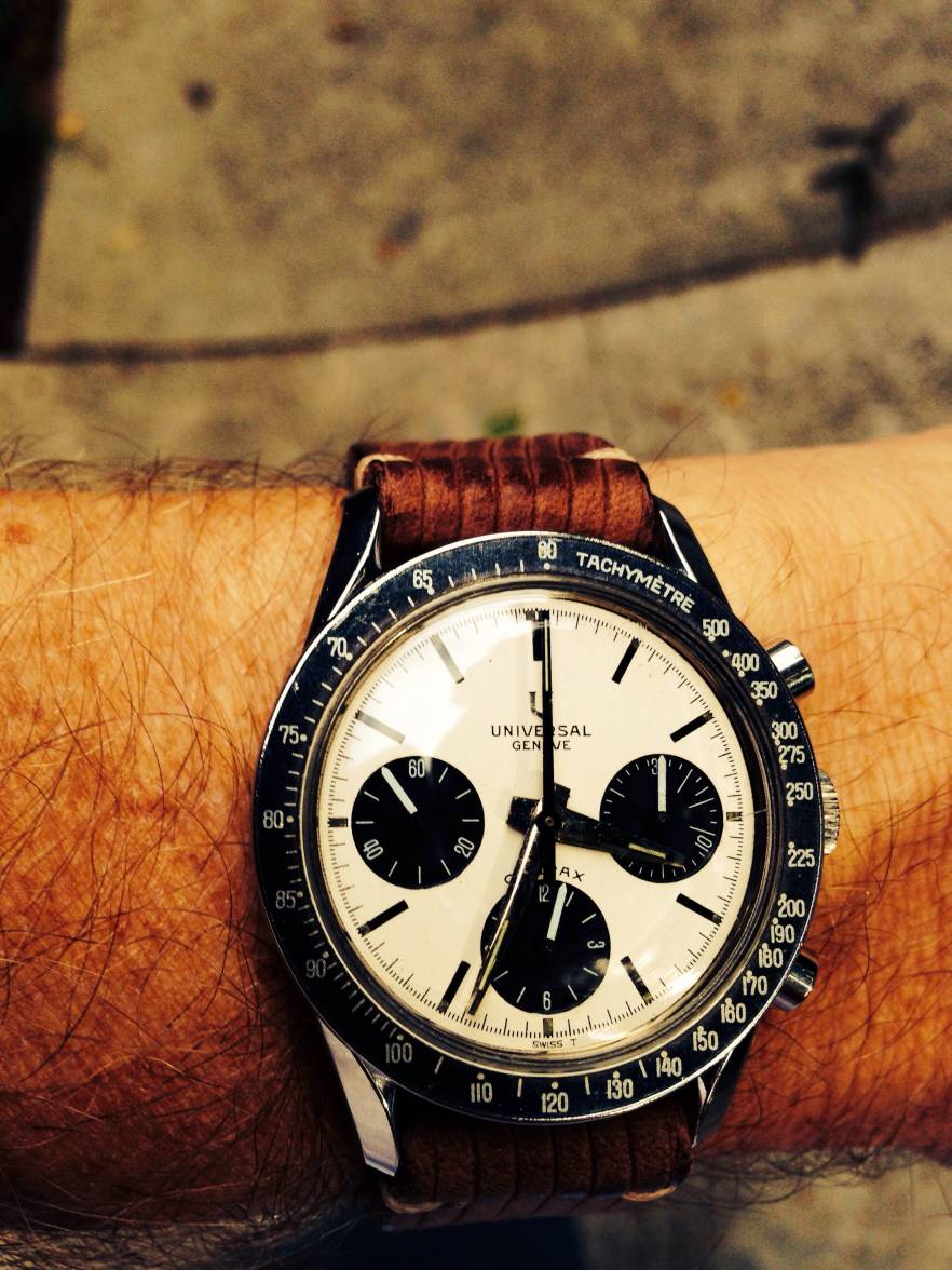

Wow, that is awesome!!! In that photo, those register hands look aesthetically like they could in fact be correct, although I have not seen others like them. Congratulations on a great purchase!!

Hi mrcorken, you are right that the Nina Rindt version with the applied logo (and thin white hour hands) is the earliest. They then switched to the luminous register hands. The watch you show above looks great except those register hands look different than the usual thin ones. I haven't seen thick non-luminous ones like that, although I haven't spent tons of hours looking at these. Otherwise, it has a faded but original bezel, which is great, and the central hands all look correct. The blued central seconds hand is very hard to find if it has broken off the post, so it is great it has that. Some seasoned collectors really prefer the earliest version with the applied marker, but it seems like the market now may be placing a premium on those with the luminous register hands. In either case, if the price is good, I would say snatch it up as you could always replace those register hands with thin ones (those aren't hard to find). Check out HODINKEE today, by the way:

Any suggestions on where I could find replacement register hands?

Where are you based? They should be pretty simple thin white register hands that any old watchmaker may have, like those of a Speedmaster. You can buy Speedmaster register hands through Otto Frei. They may not be exactly, exactly the same as what is on other early Nina Rindts, but most shouldn't be able to tell the difference.

Thanks for the info!!! I am located in northern CA

You have to check the pinion size. Just because the hands look the same does not at all guarantee that they will fit a different watch! That's likely a job for your watchmaker, unless you're comfortable doing your own case work and have the correct tools to remove and reset hands--particularly on chrono subdials which are the most difficult to get right.
UG hands occasionally pop up on parts watches on the bay, but I've never seen any of the correct ones for the Nina available.

Hi George,
I'm curious to learn more about this. Do you know somewhere that documents this observation, about the Nina with thinner hands being an earlier execution? I imagine you're right about the painted vs applied logo (the painted one in any case is UG's more recent logotype), but I haven't found out anything concrete about the hands. I'd just assumed that the occasional thin-handed Ninas were sporting replacement hands, probably from a Tri-Compax. Since this reference isn't in Sala's book, I'm not sure where to look for more, so if you've any ideas I'd love to know. Thanks so much!

Similar related question to above. Can a Nina, ( or reverse panda evil nina) have raised U logo but fatter lumed subdial hands and still be correct?

I believe yes they can. I've seen a fair number of iterations.
