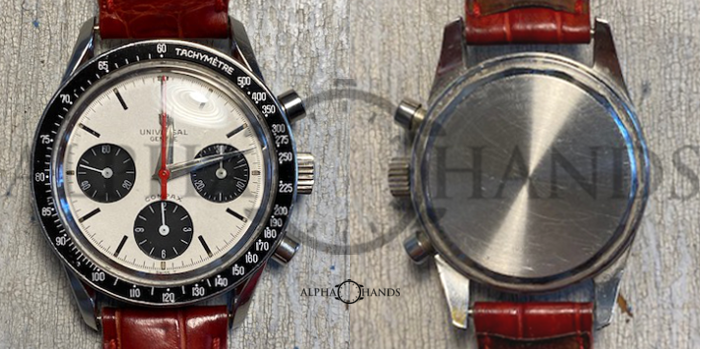

FOUND: Nina Rindt's Nina Rindt (UG 885103/02)
1,536
3,177
I believe that the early 22706 came with that hand combination and had applied steel hour markers ...
Nina's is a very rare watch indeed !
181
359
Nina's watch is an early serial, though not the lowest seen, though the only early one with these hands (at least that I have found).
As you mention, we do see these hands on other UG's.
1,536
3,177
We do see them on other UGs of the era that have the v72 or caliber 130 movement ...
189
178
This should be a huge story!! Well done for tracking it down 👍
994
3,206

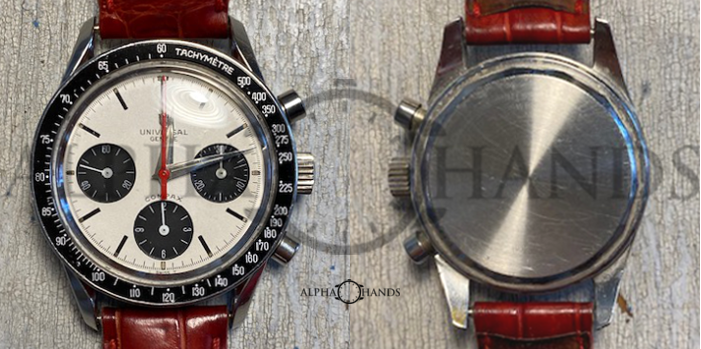

My UG Nina serial number project (https://alphahands.com/faq/universal-geneve-nina-rindt-serial-number-project/) wouldn't be complete without the 885103/02 owned by Nina Rindt, would it? So now it's added, along with a brief history and images (and also what happened to the Heuer 2446M owned by Jochen Rindt).
Enjoy and stay healthy, everyone.
https://alphahands.com/faq/nina-rindts-universal-geneve-885103-02/

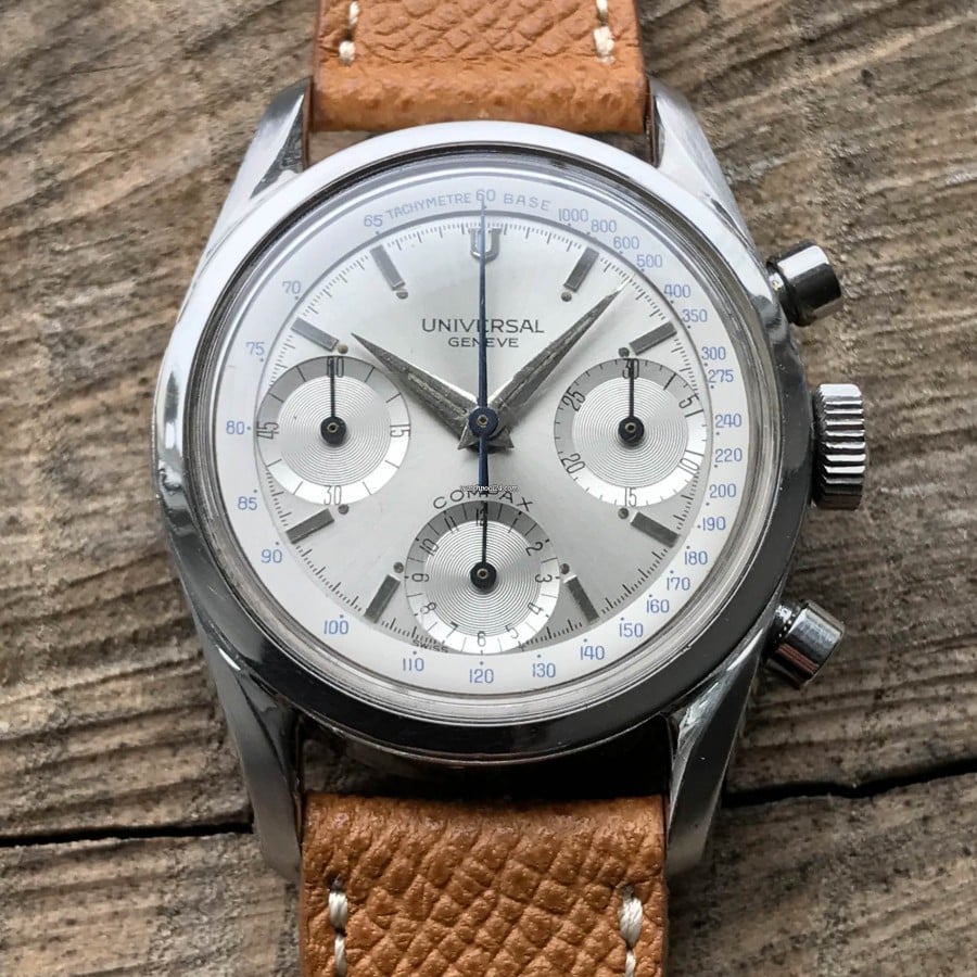

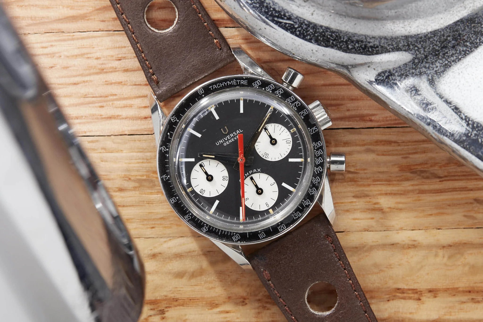

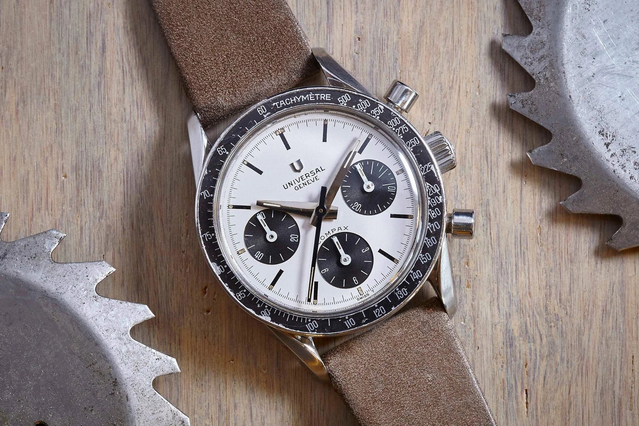

Hello everyone,
I am posting on this existing thread instead of creating a new one.

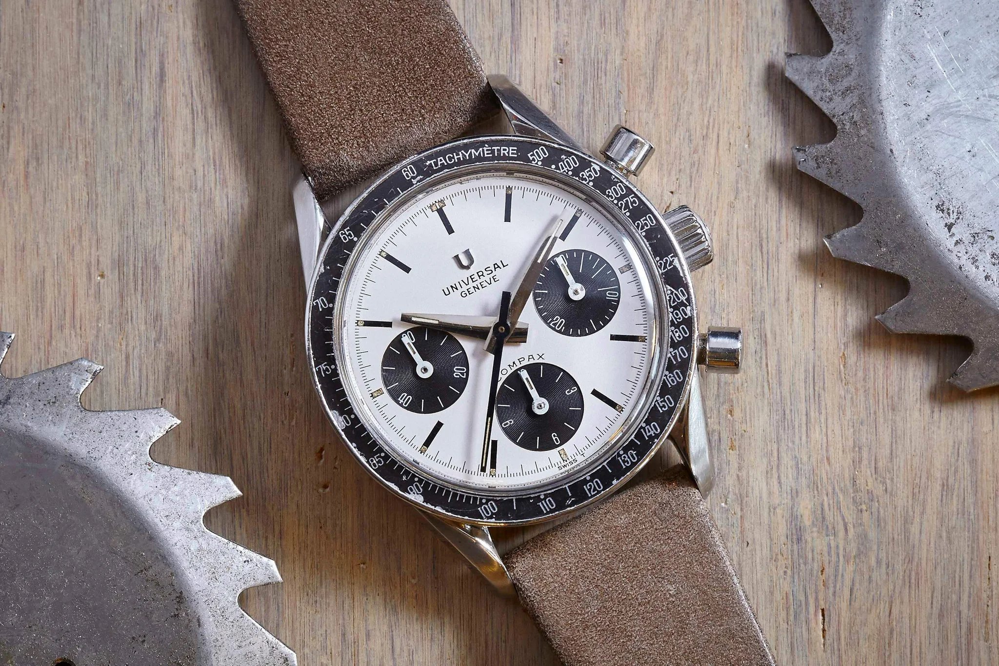

I've been looking at the Nina's recently and have found a few that seems to exhibit characteristics of both the MK1 and MK2 dials. This seems to be the case for both the traditional white panda Nina and also the reverse panda Evil Nina.
Take a look at these examples (both from analogshift curiously, though I've seen it at a couple of other dealer sites as well):
My question is, did UG actually create such transitional models - specifically those that had the applied UG logo, silver hour/minute hands and Swiss T from the MK1 but the thick baton style chronograph sub-hands more commonly found on the MK2 dials?
Perhaps the UG project maestro @subregister or anyone else with knowledge and insight can comment on the validity of these.
"Transitional" UG Nina:
Links to the original listing here.

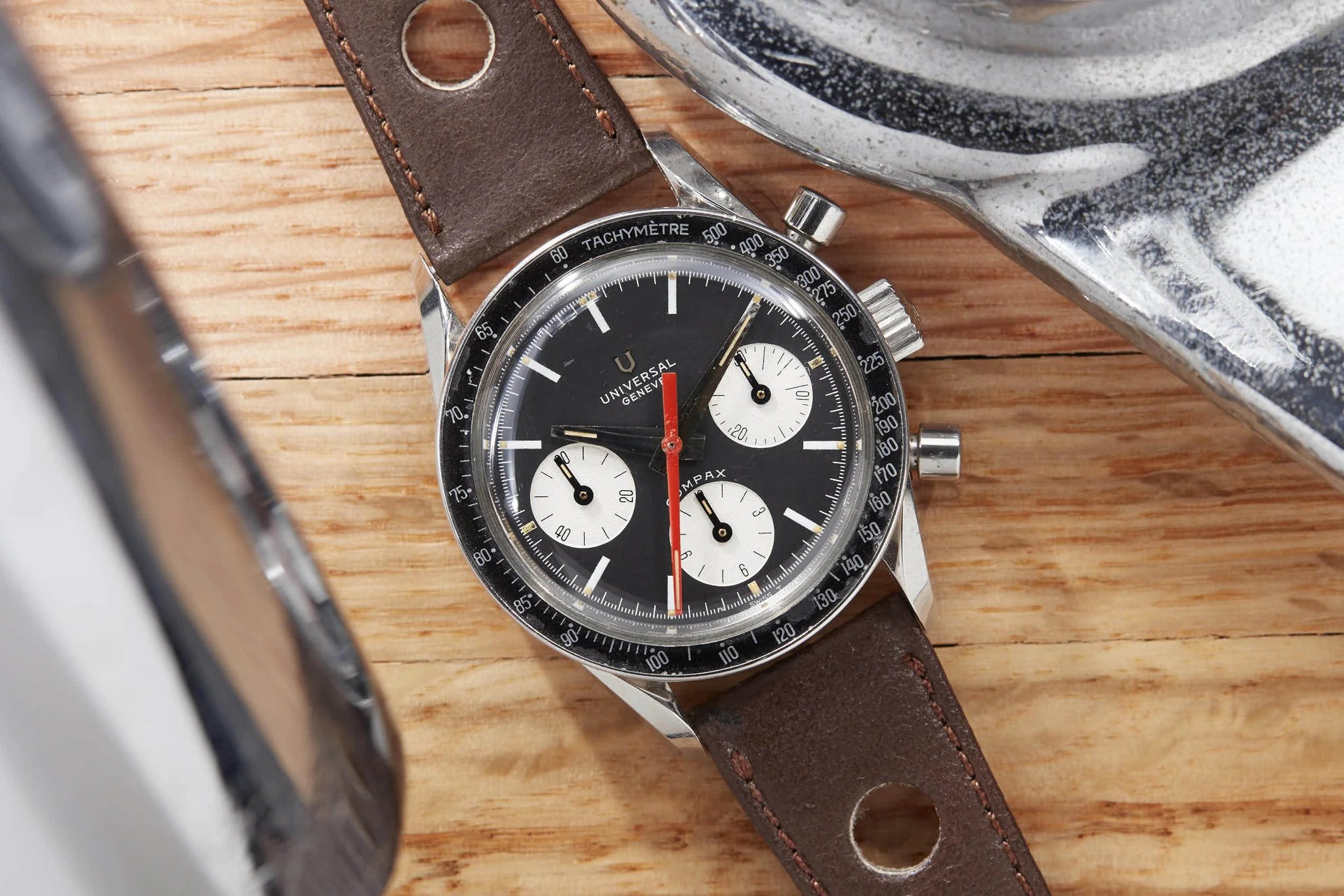

"Transitional" Evil UG Nina:
548
2,570
Categorically “yes’. The Nina and Evil Nina Compaxes appear to have been built in three distinct configurations, not two. The two watches you have highlighted aren’t “transitional” models in my opinion, they are their own recognised Nina Mk II class.
The UG ‘Ten’ book does a terrific job of illustrating the three Nina iterations. The Mk I, II and III all appear within tight serial band ranges and should be pretty easy to check if you have both the book and the watch reference to hand.

The book is incomplete. There are more than three evil nina references and i believe that also applies to the nina. There is a fourth. the 22607 with applied batons and dagger hands ...
345
634
Thanks for your replies. I don't have the UG ten book but there is an MK2 (or what I called "transitional") piece that is available (and potentially being offered) with serial no: 2412XXX. Not sure if that checks out right but seems to be within "acceptable" range.
600
1,539
This version of evil Nina is also accepted - dagger sub dial hands but without the applied logo.
https://omegaforums.net/threads/universal-geneve-compax-885103-01-evil-nina.119627/
[URL]https://www.analogshift.com/products/universal-geneve-compax-ref-885103-01-evil-nina
[/URL]
345
634
I think what you've linked to is generally considered the so called "MK1" dial of the Evil Nina's.
181
359
@fizz "Maestro"...I like that! 😁 (of course doesn't always tie to correct/complete knowledge by any stretch!)
The combination you are talking about is fairly distinct, and in the range 2453xxx (after the 241xxxx displaying thin hands, and prior to the SWISS T 25 and thickest hands at 2569xxx). I have not personally seen an applied logo 241xxxx with either midsize or thick hands, though not to say it isn't correct (well...I would be surprised if thick hands were correct)
I can't speak to the Evil Nina...perhaps one day, however (I'll keep learning here at OF 👍)
I should probably have called that out on alphahands.com - it's a good question, and I'll add it to the site. Thanks for the question.

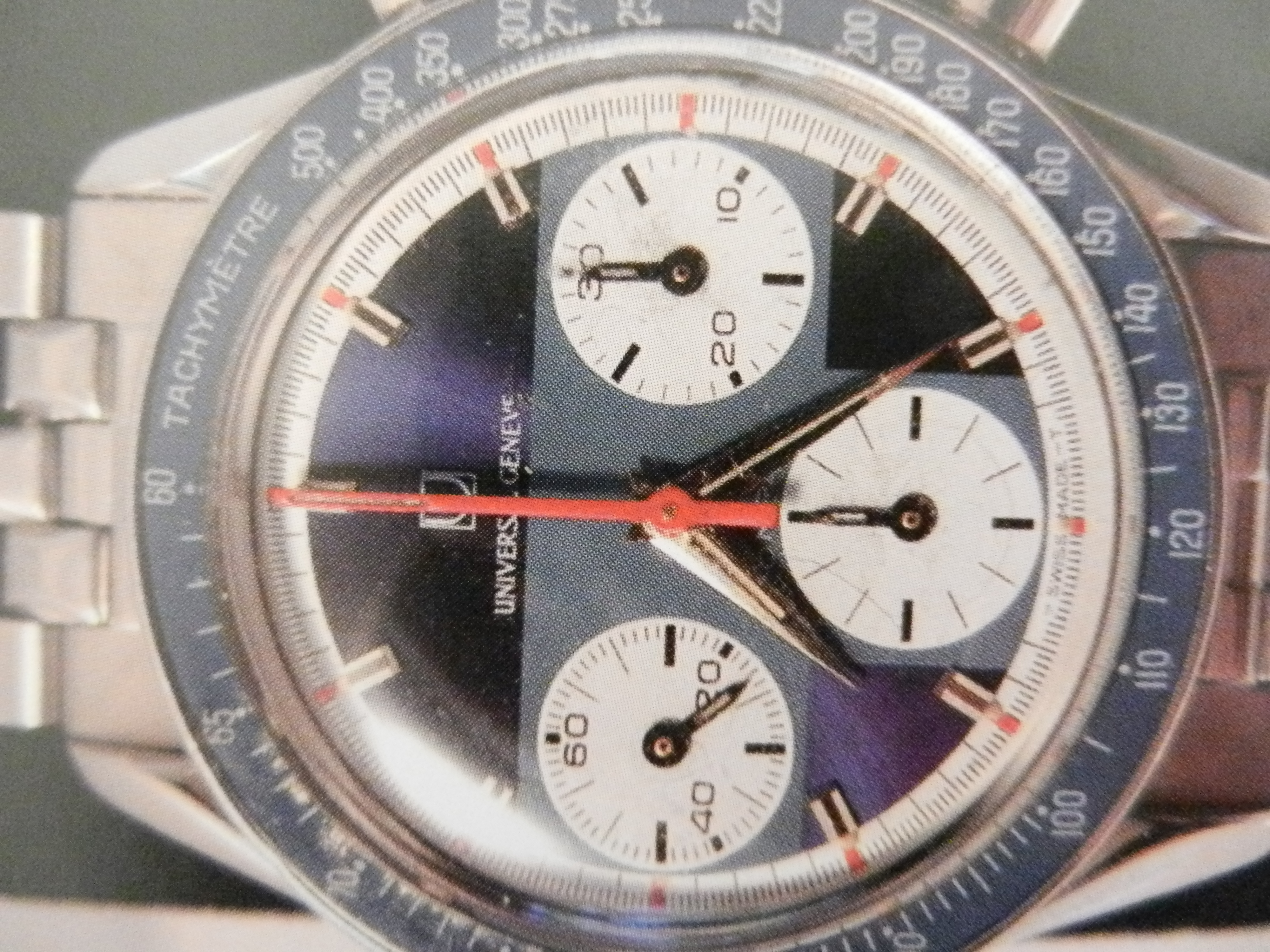

I'm afraid I only have the following two images.
The first is from the 1969 catalogue. The second is from the 1973/74 catalogue.
