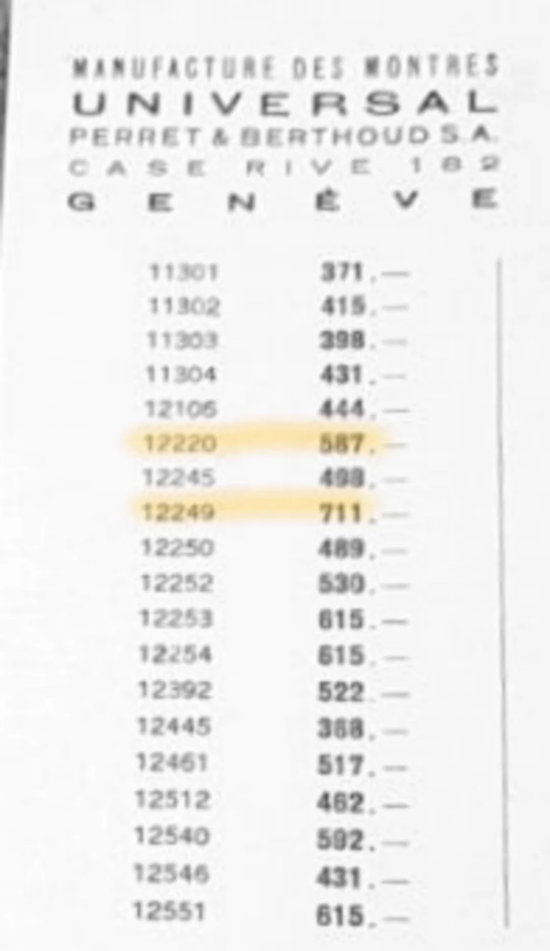

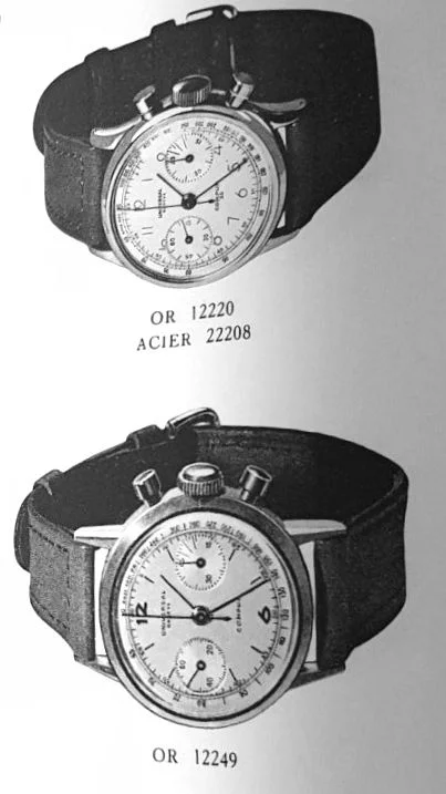

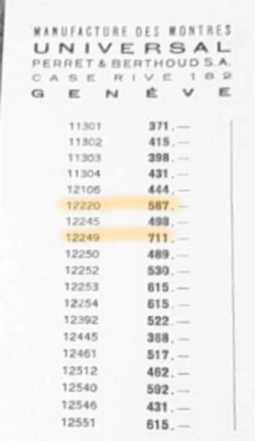

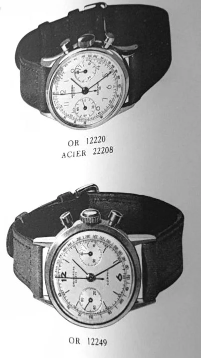

I'll be adding some sales material I have. These are of two similar gold waterproof watches, which are the first relevant documents I have on hand. I hope it will help the discussion.
Thank you for the further details. If you can find any documentation on fewer rubies in 386 please share.

I’ve reviewed everything I can find on Compax and Compur 30 and I feel like this documentation below is the best we’ve got so far, I just don’t know what it means or why.
The image only states that the same components of the Caliber 285 can also be used on the Caliber 386, which is 14 lignes (i.e., 33.8mm in diameter). Given their identical diameter, it confirms the Caliber 386 was a variant of the 285, exclusively used for the Universal 30 line. Regarding the question of rubies, I believe that came up during a conversation with my watchmaker; I will ask him if he has more specific information about it

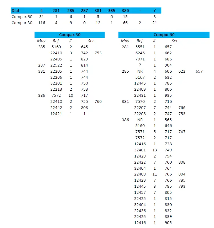

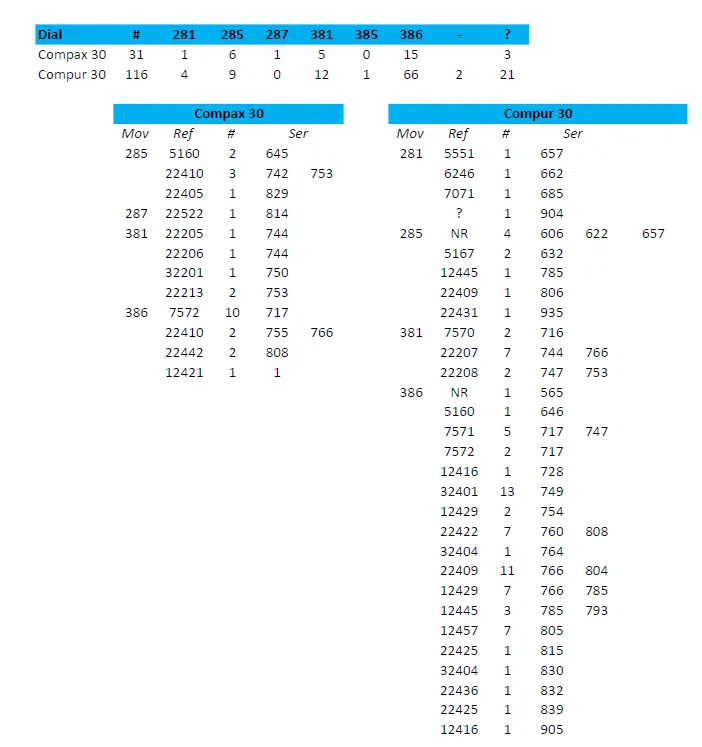

1) can you do a reverse check working off dials instead of calibers? Meaning can you poll all the compax 30 and Compur 30 dials and give us a breakdown of calibers used? @martinc already provided an example of a compax 30 with a cal 381 in the other thread, and stated that cal 385 was also used (but I’m not sure we saw that example posted).
2) can you deduce any information about case serials and dates working off the cal 386 movements (and/or 381, 385) or by working off the compax 30 and Compur 30 dials ?

I came to this:
My conclusion: 'accepted' range is 717-808k so around 1940.
