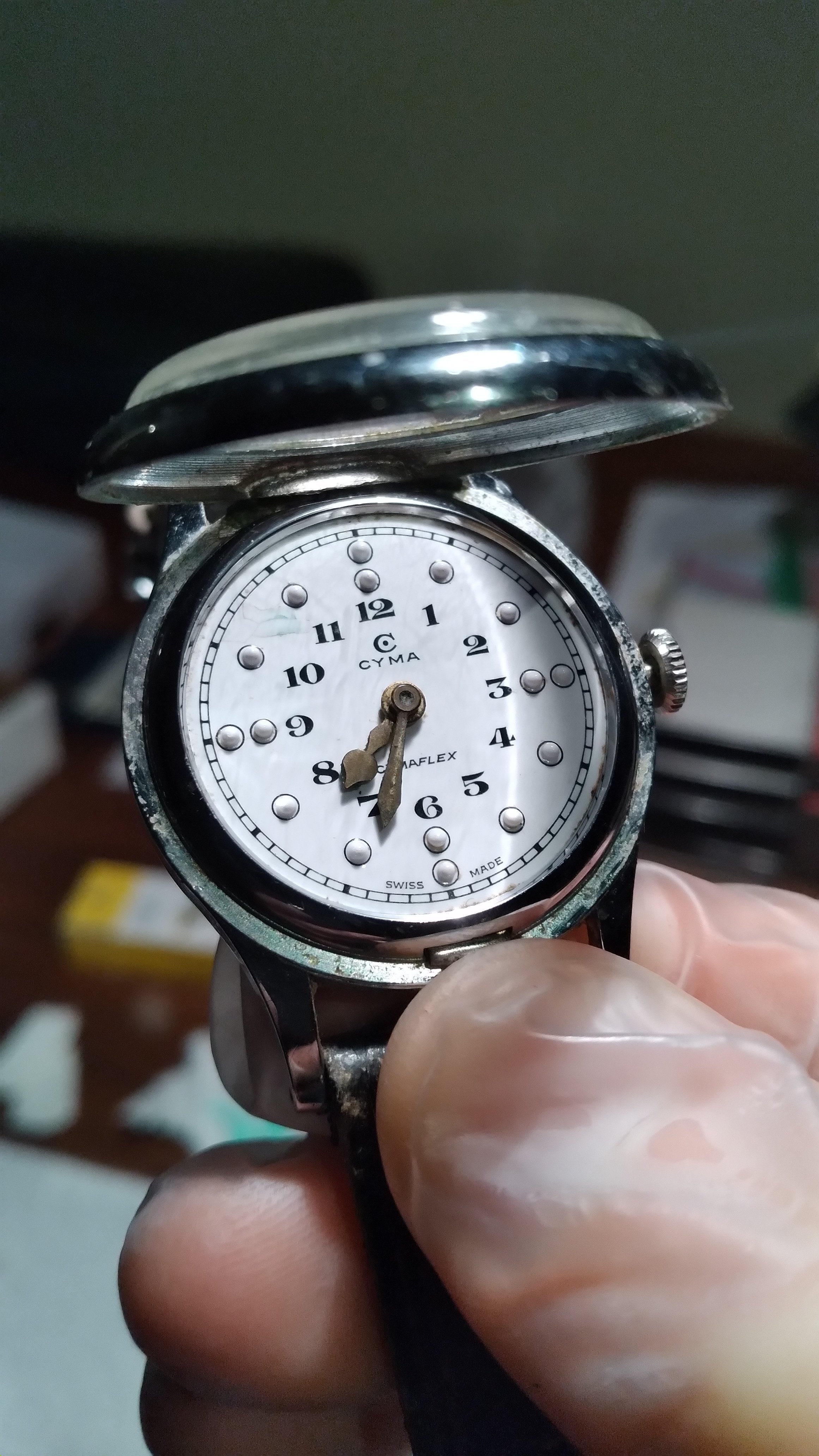

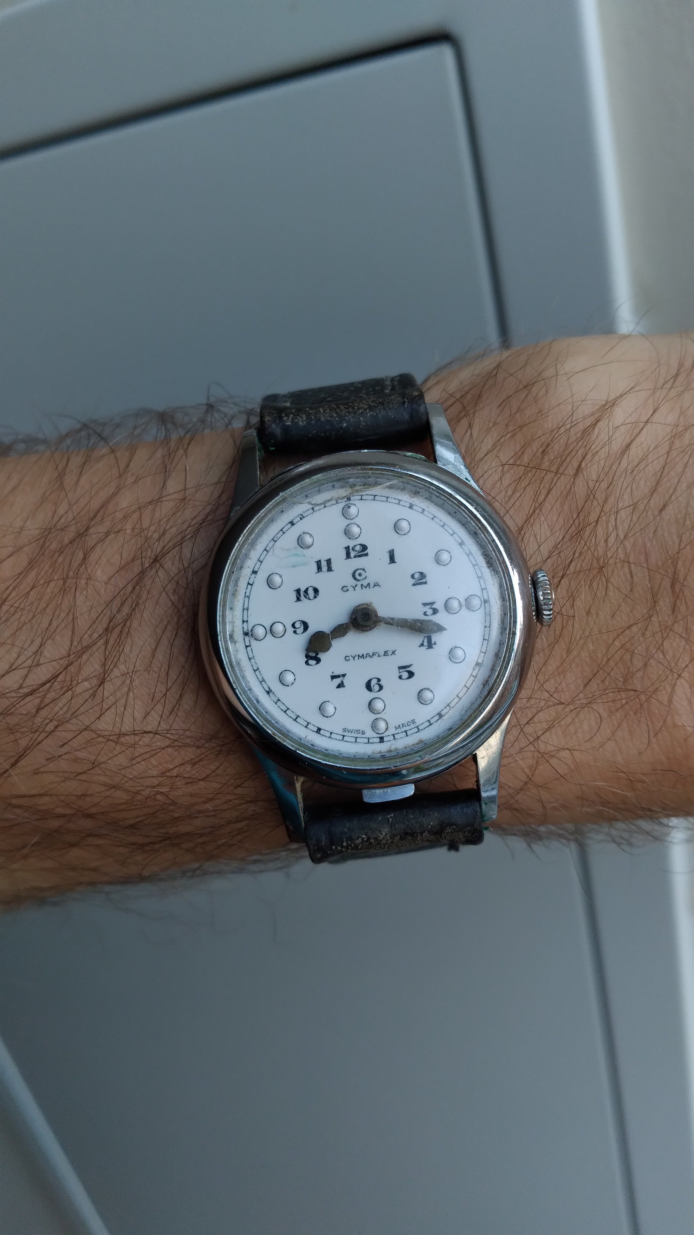

I recently acquired a vintage Cyma with an enamel dial. The watch is unusual in that the bezel and crystal swing open at the press of a button, to allow for a visually-impaired person to touch the dial and hands in order to tell the time. Other brands such as Smiths and H. Y. Moser made similar watches.

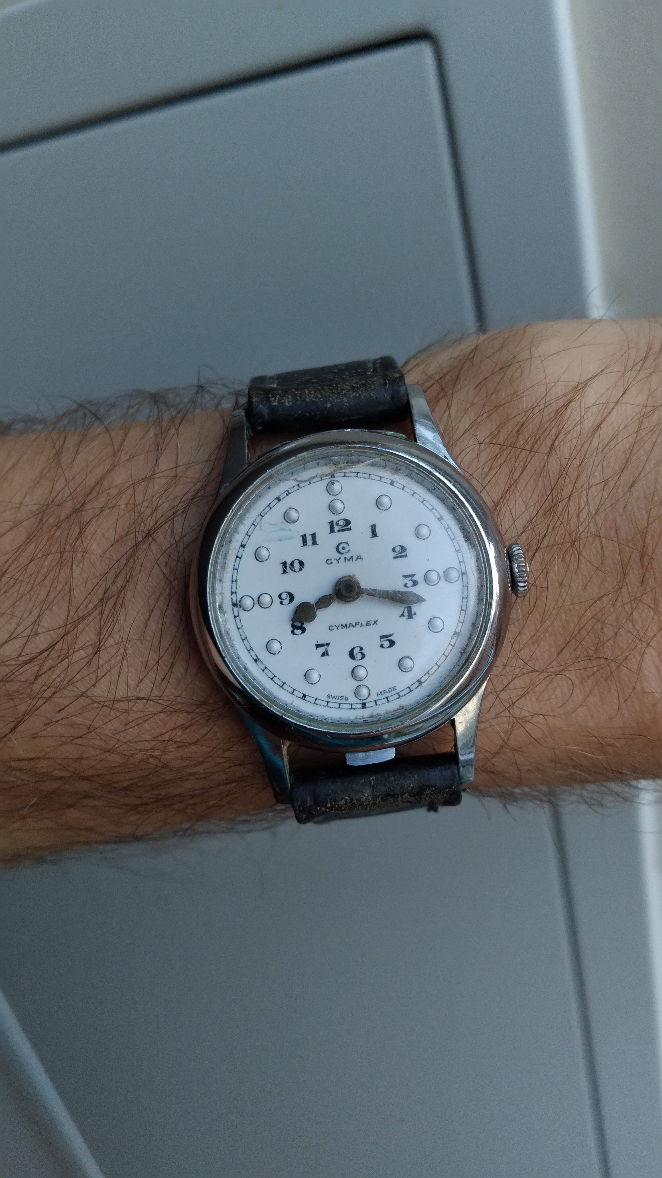

The dial on my watch was very grimy, so I decided to attempt to clean it. I first tried dabbing the detritus with Rodico, but very little came off. I then used a Q-tip that had been wetted with Windex, and this worked well. It took 3 Q-tips with Windex to get the dial to where it is now. My apologies for failing to take a 'before' photo!
I wonder what methods others have used to clean enamel dials?

I had not considered the binder in the cotton. A makeup brush is a great idea, thank you!

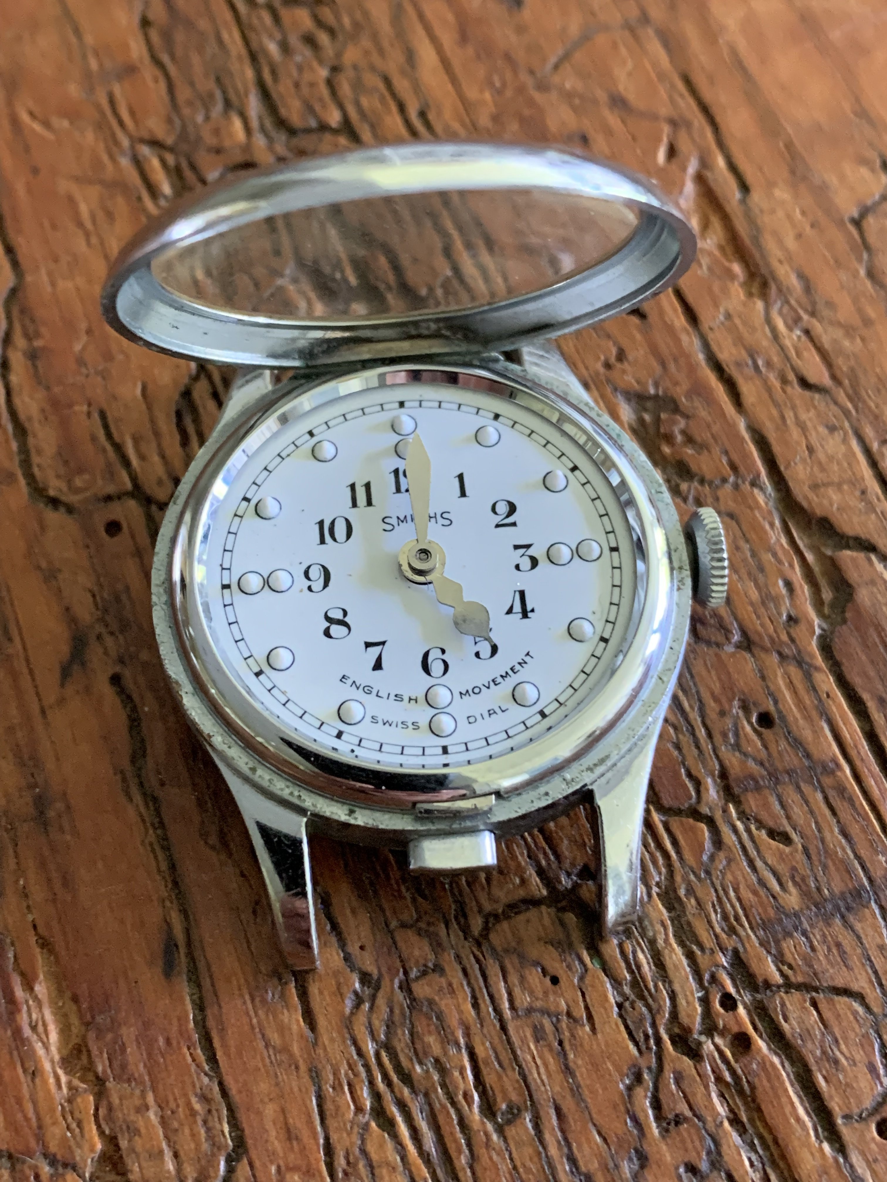

I’ve seen videos of folks using denture cleaning tablets with enamel dials, coming out looking great. I never thought about it, but likely my Smiths is enamel as well, I’ll need to check

Thanks for the tip, and nice example!

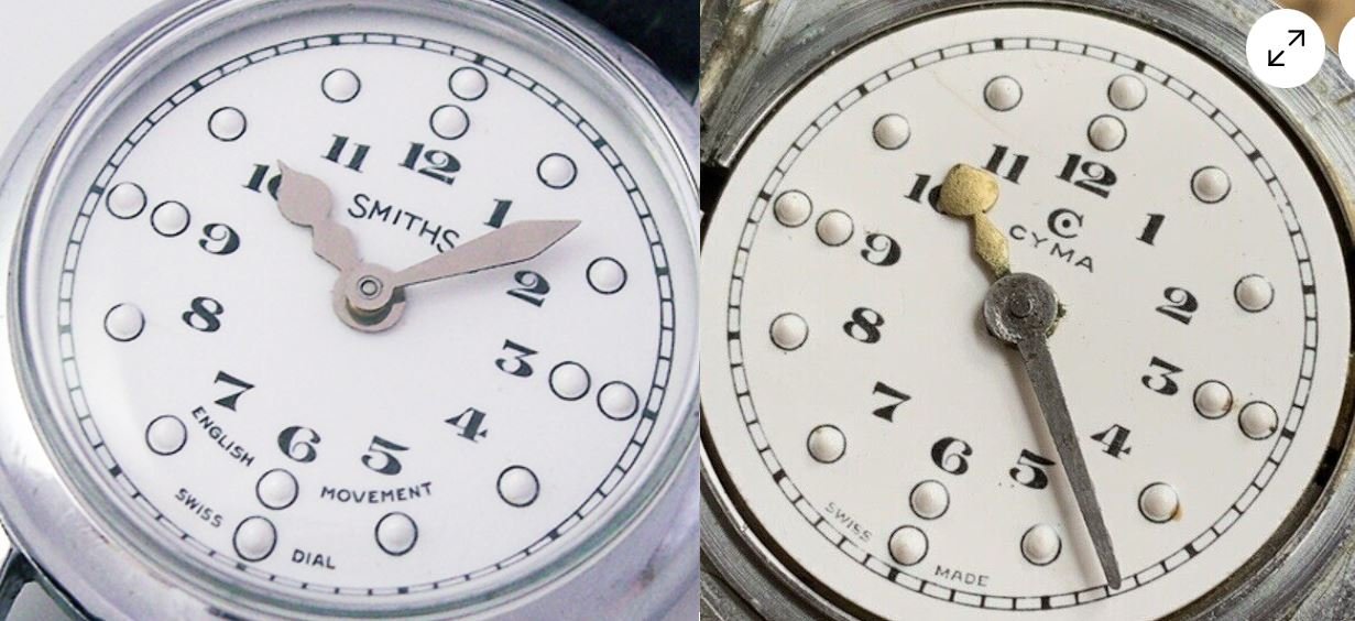

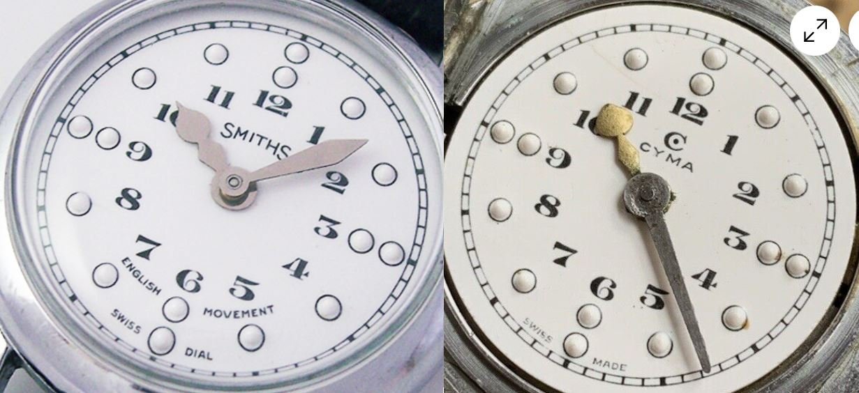

Part of me wonders if both the Cyma and Smiths dials were made by the same company. The dial in yours is a bit different than the one in mine (e.g., the single raised hour markers are closer to the minute track). The two examples below look very similar.
Smiths source: https://thewatchspotblog.com/smiths-braille-watch-smiths-cal-12-15/
Cyma source: https://www.ebay.com/itm/203281436790

Yah, it wouldn’t surprise me if one company made all those dials - how big was the market for them anyway? Maybe the cases, too. Thx for the articles.

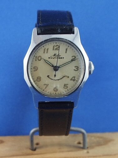

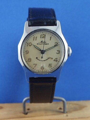

Cleaning dials, enamel or otherwise, look out for characters on the dial that are NOT vitreous enamel or paint! On occasion, some characters on a dial MAY BE India ink which is water soluble. Ask me how I know! Notice down by the 4 position on the dial of this Mido. Part of the inscription ran when I tried to clean the dial.
