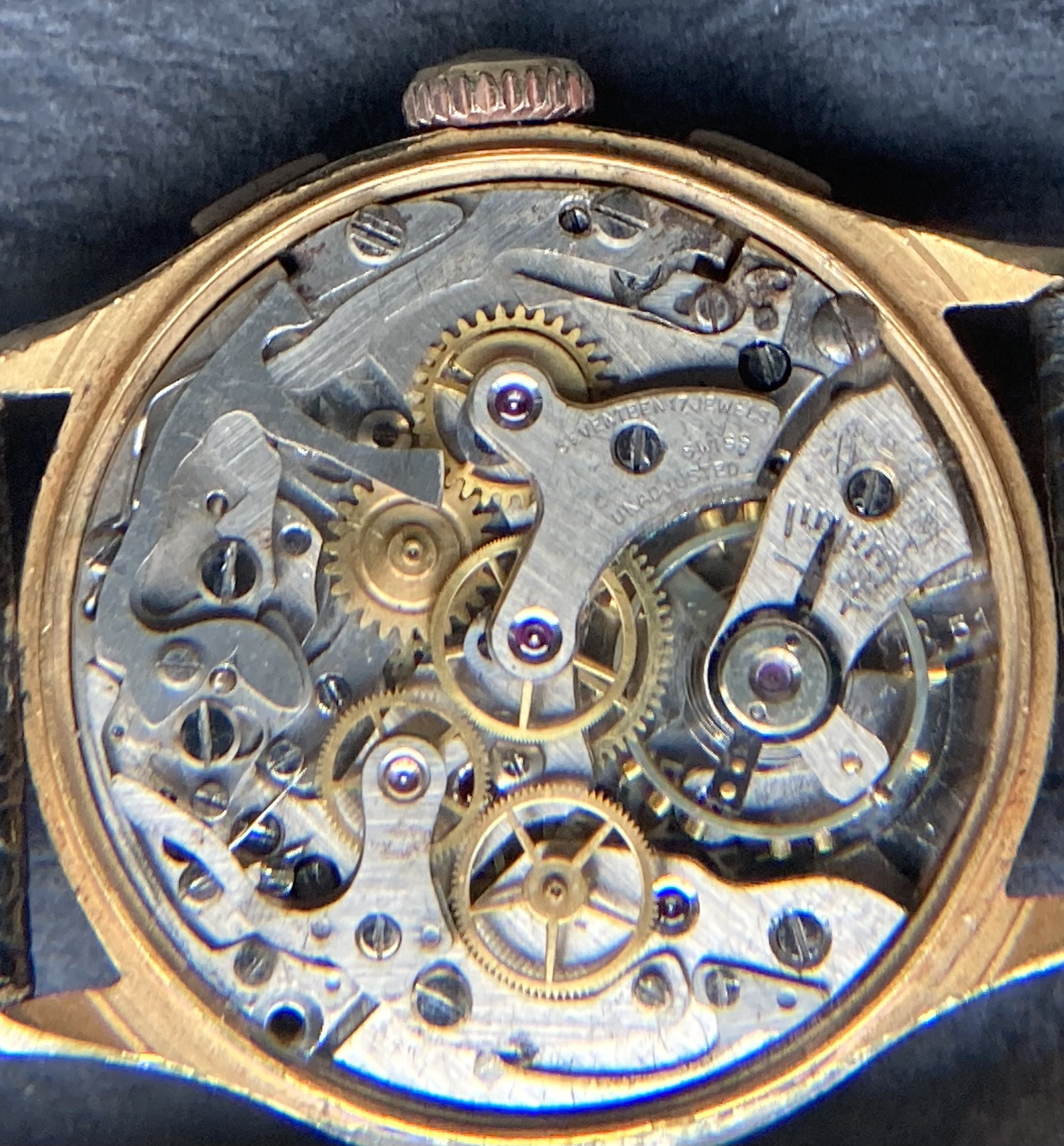

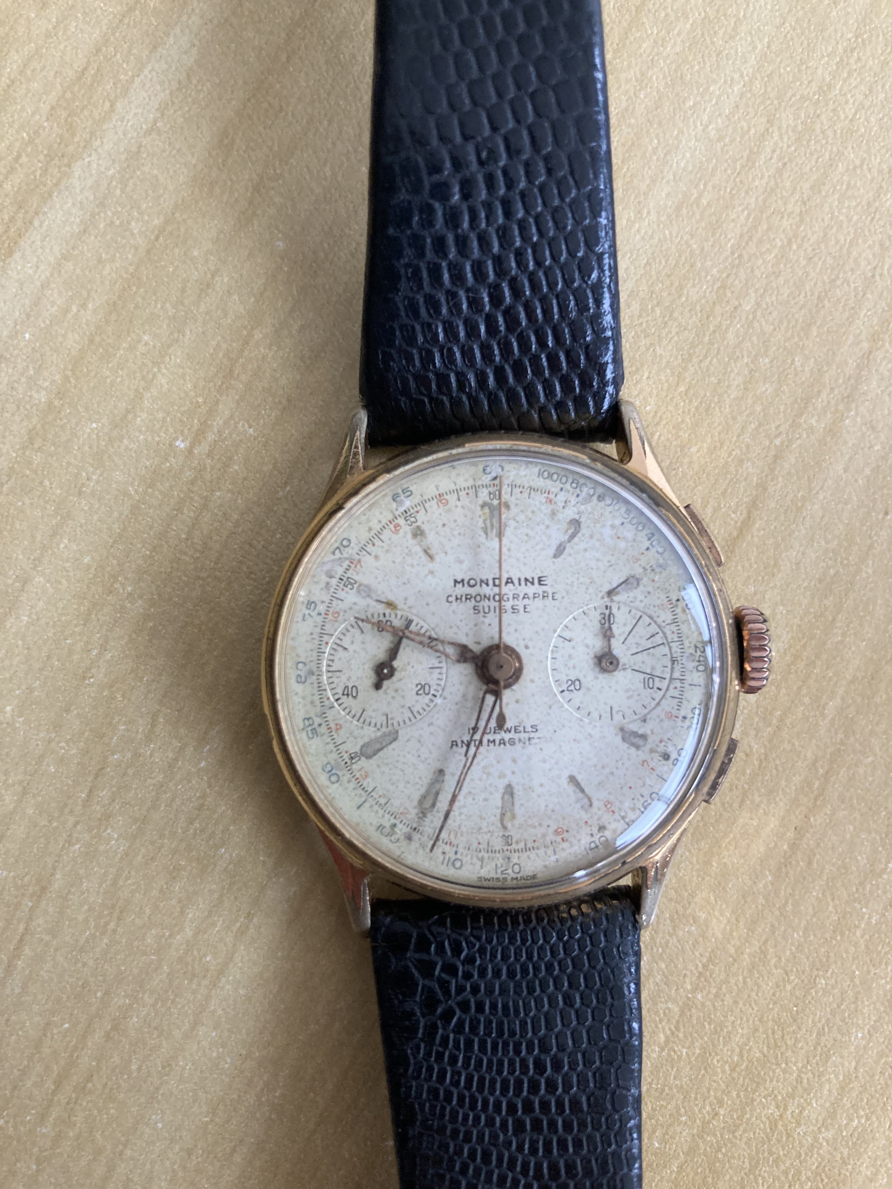

Hi, I do own an Omega watch but - apologies - I actually have some questions regarding this Mondaine Chronograph I bought recently.
this is what I know so far:
- Serviced in the last 3 months
- Circa 1940s (sellers opinion).
- winding lasts more than 36 hs
- advancing about 5min/day.
- Gold plated
- Chronograph Functions ( start, stop, reset).
This is what I would like to know:
- Proper ID of watch and movement.
- Any other comments
Many thanks in advance.

Welcome to OF. You don't need to own on Omega watch to participate on the forum or ask questions.
The movement seems to be a Landeron 51 as you can see under the balance wheel.
The case is in rough shape, so is the dial with missing hour markers. Hard to believe that the watch was properly serviced in the last 3 months if it is advancing 5 mins / day.

thank you. The information about the service came from the seller, perhaps he meant just cleaning, not sure.

Welcome, some watchmakers -servicing this watch- were not very talented.
btw: 3.5 million of this Landeron were produced. Avoid shocks...

Seller routinely lie. I doubt that has been serviced in decades. If it is running at 5mins/day it isn't healthy. 36 hours of reserve is a little low also (but not a disaster as full wind should be 41hrs) so it could maybe benefit from a new mainspring. I like these and I have had a few. The downside is that a proper service costs about the same as the watch is worth, which is why servicing is often skimped with these. These are a very cheap way to get into a Swiss chronograph, even solid gold ones are in the hundreds of $/£/€ rather than thousands.

The watch has definitely not seen a recent service, or even a cleaning. Since this was a purchase, I assume it does not have any particular sentimental value to the OP. That might make it hard to justify the $500 - $800 (estimated) for a regular service. But to the OP, if you like the watch (I do, fwiw) I'd just wear it and not worry about a service. It's definitely not going to last long enough to pass to your heirs, but you can still enjoy it, probably for years.
The +5 min/day would bug me a lot though. Assuming those are the OP's pictures (not the seller's), then the OP is at least comfortable enough opening the caseback. Even if you don't have any special tools, you could take a shot at adjusting the timing. Use a wooden toothpick to nudge the small needle-like arm above the balance cock towards the "−" (away from the "+"). Make very small adjustments, and be careful not to touch the hairspring. Without a timegrapher, you're not likely to get to COSC standards, but with a little patience I bet you could get it to a more tolerable ±30 sec/day.

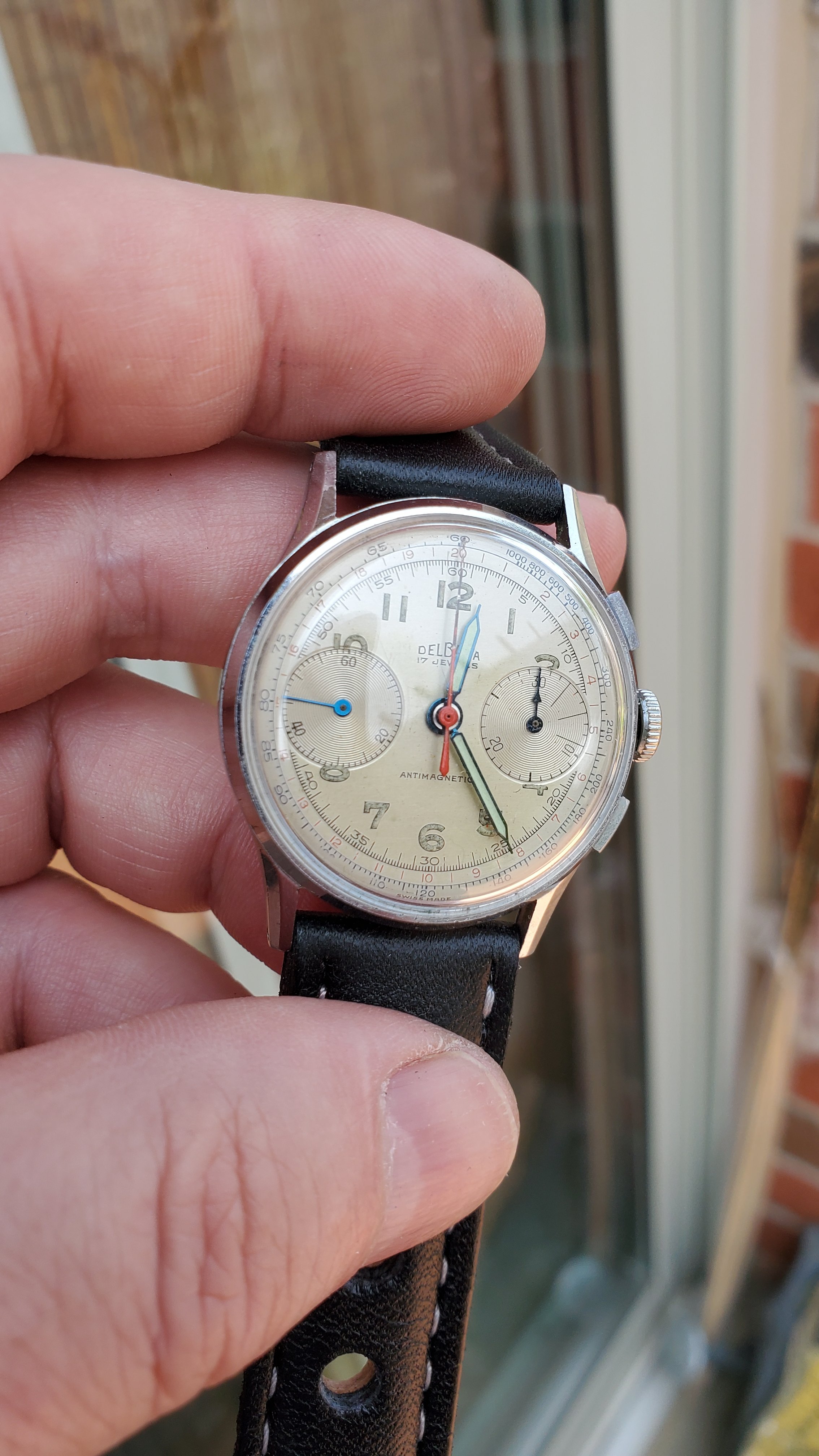

These Landerons where sold as many brands often as souvenirs at airports. Here is my Delbana, landeron 48. It needs servicing too, but gains less than 1 minute per day.

Indeed it was not very expensive. Thank you

Thank you, that’s extremely helpful. No sentimental value at all. I’ll try to adjust it thank you.

That is a beautiful watch!

Thank you, I like it a lot and will get it serviced and replace the crown.
