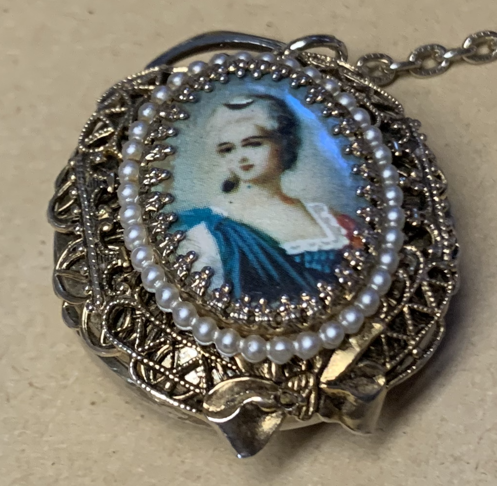

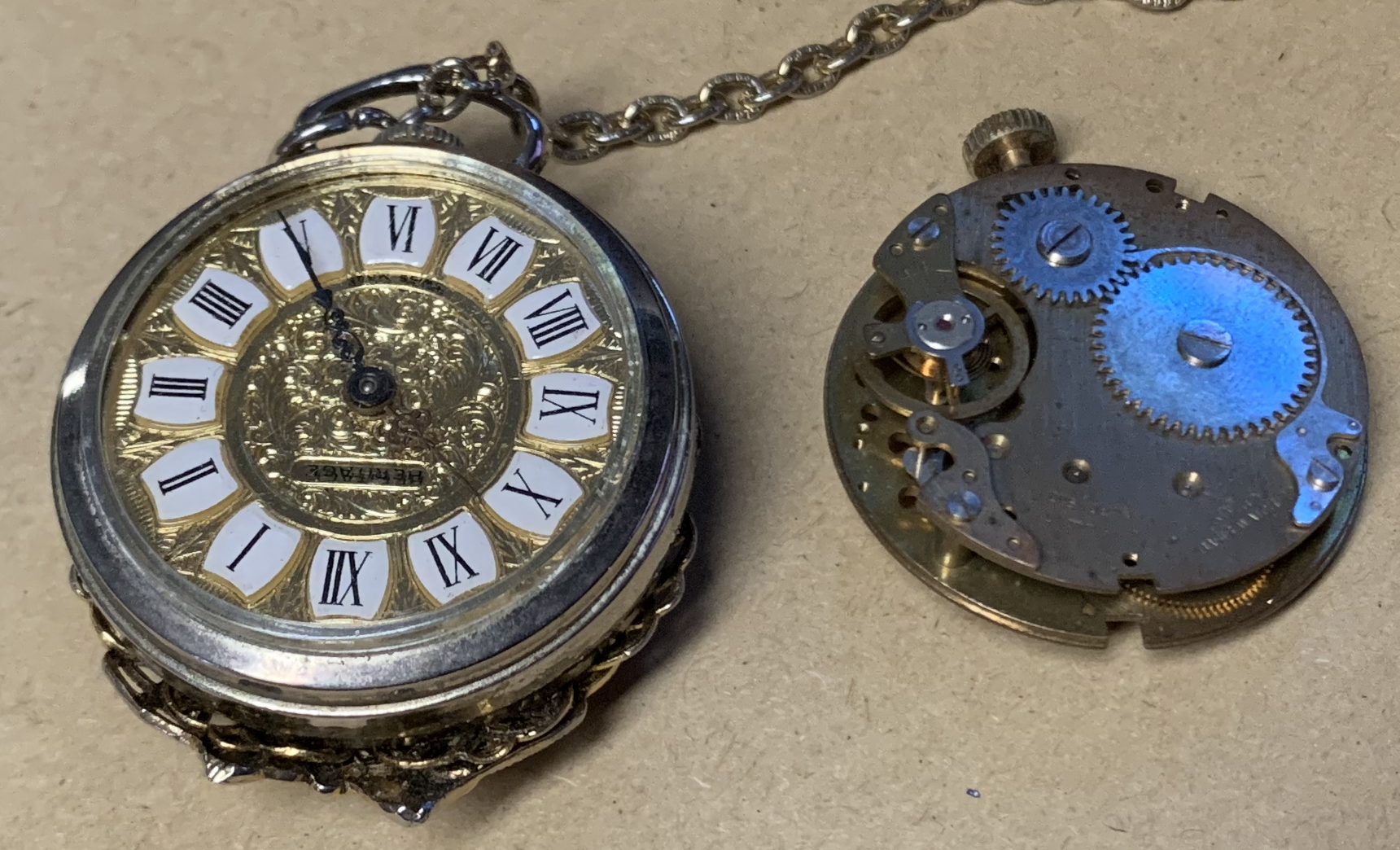

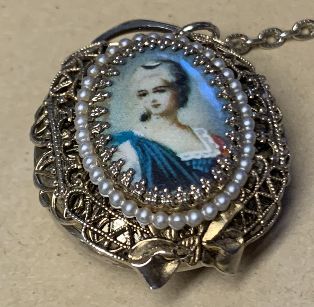

In the back of one of my drawers I keep a box of pin lever movements and part. Mostly because I found this costume watch which I wear at the Dickens Fair. This surprisingly gets noticed from time to time.
When I got this I cleaned it lubricated it and oiled it. For the past several decades this has been my weekend watch For November and December. My third favorite watch after my two omegas. It is probable though that what ever watch I am currently working on or wearing is a favorite.

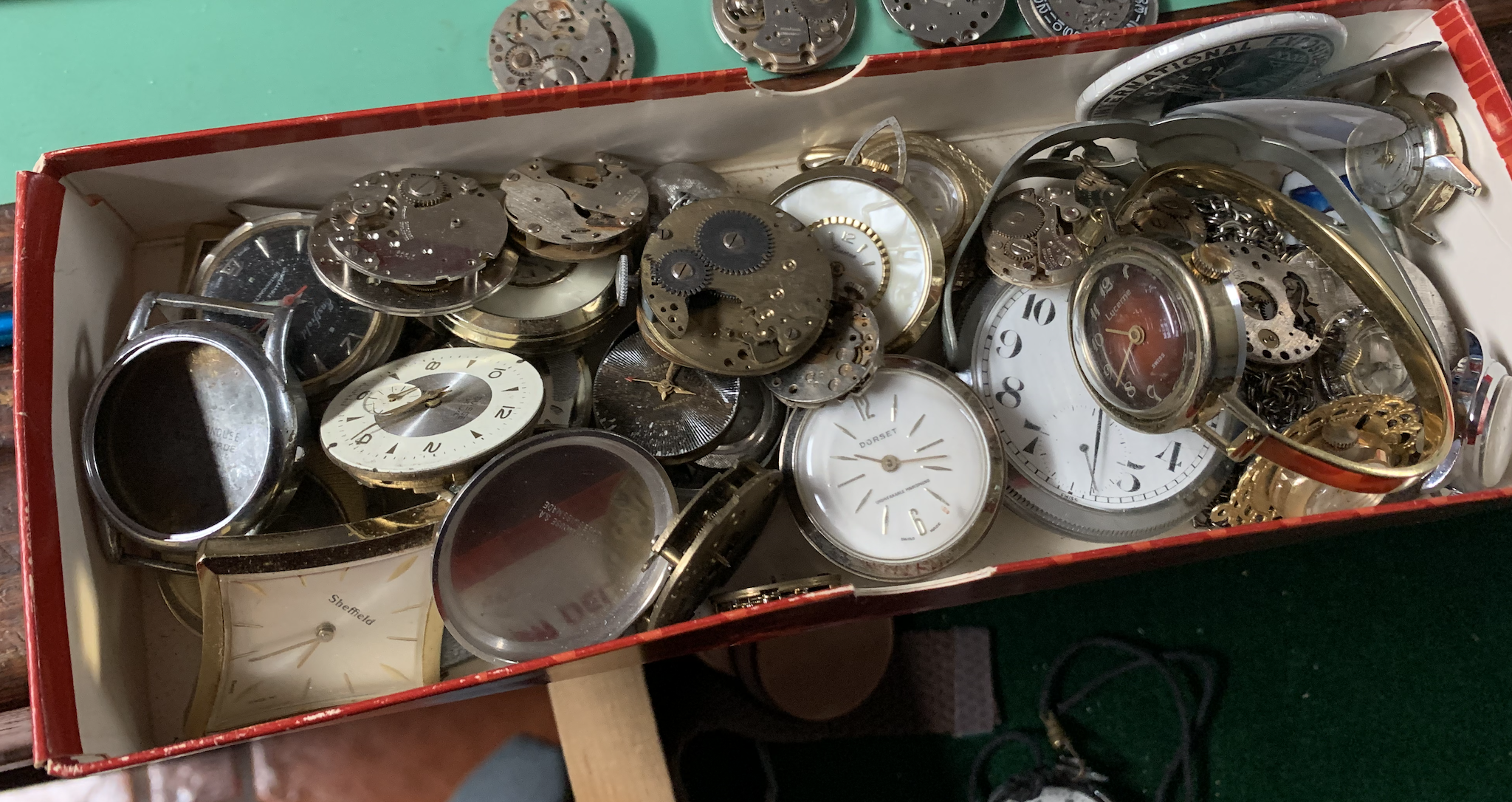

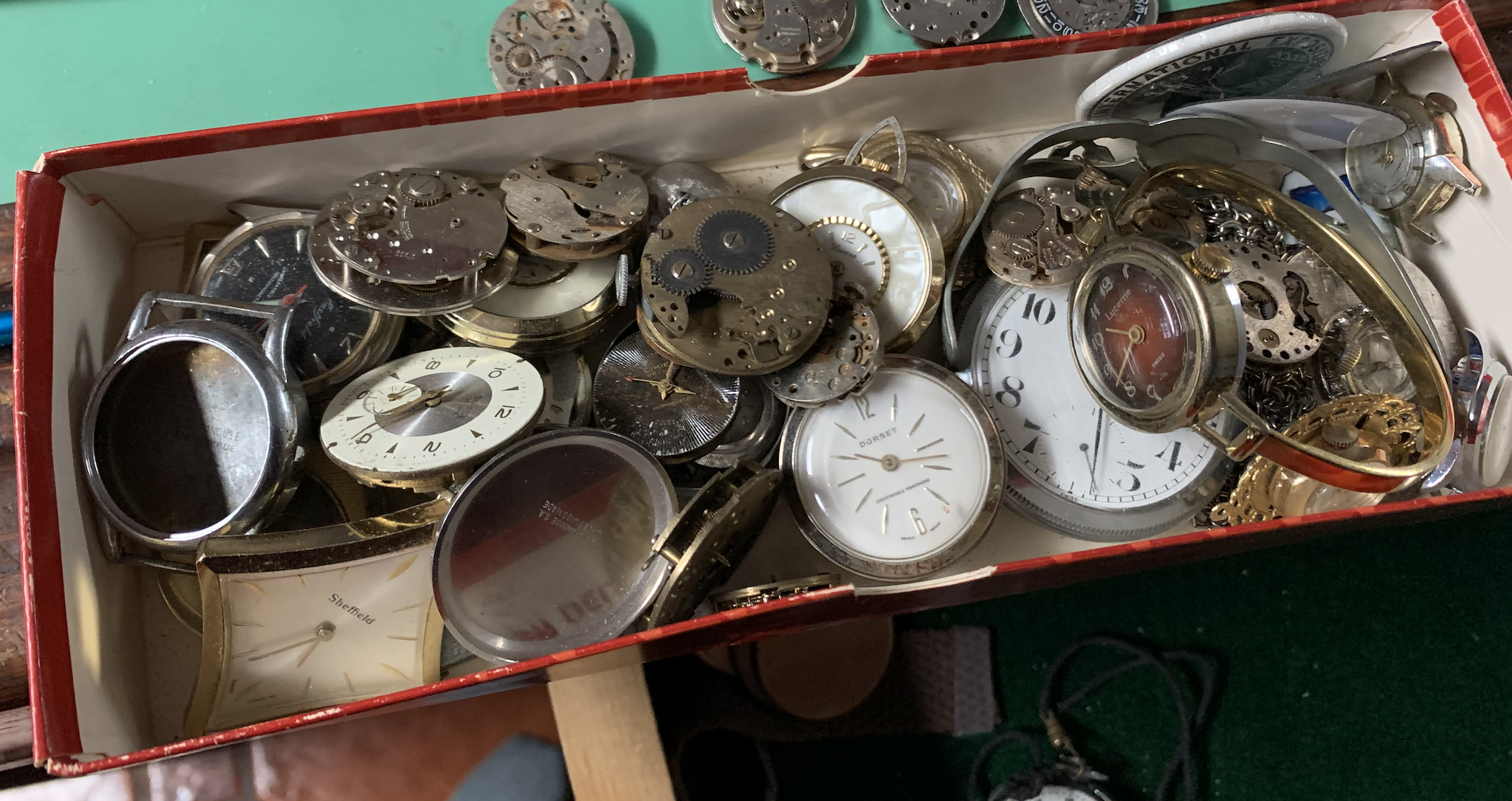

I carefully hoarded other pin lever watches In the off chance I might need parts to fix this one should it stop working. So far I have been lucky and it has performed admirably.
More recently I got the EB Bettlach 8000 based Snoopy watch. As noted in the recent post relating to the proper Snoopy watch, I had sorted my loose spares by parts. I also found one complete EB 8800 movement, which I am using as a practice watch.

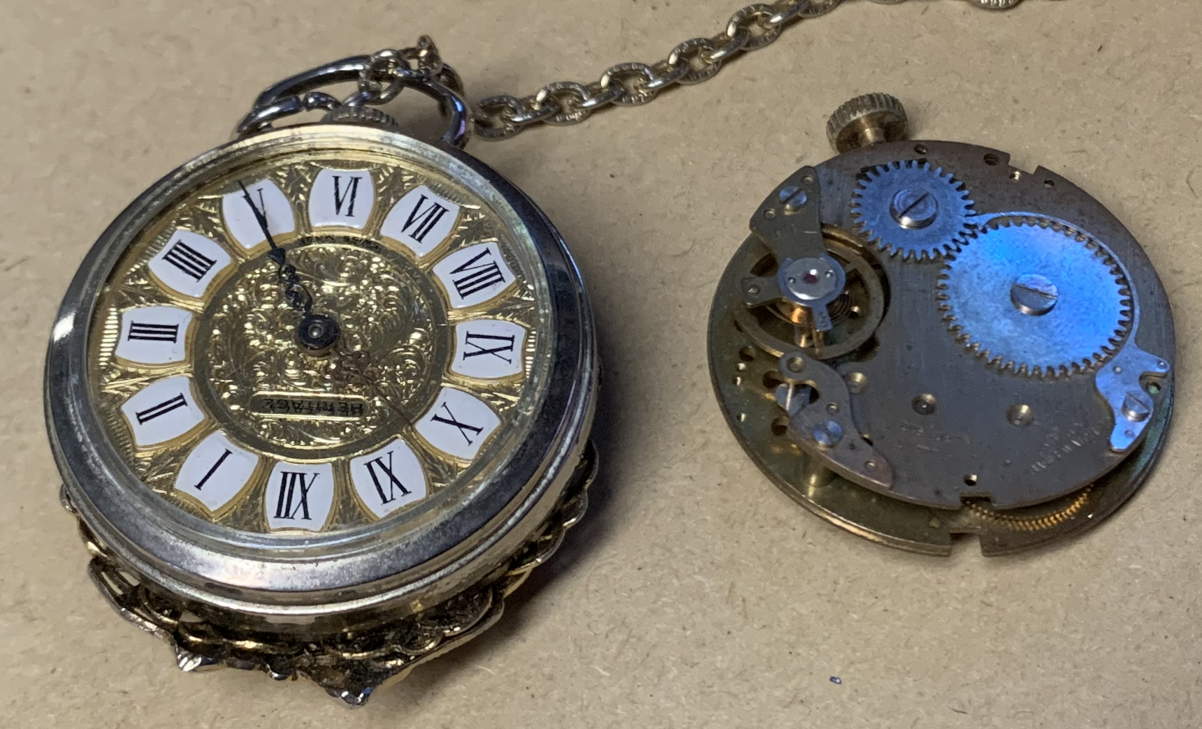

I was curios as to what movement was in the costume watch I use so much. Hoping that it was the same. This turned out to be a (BRAC) 52. I have quite a few of these as most of the pendant watches use this movement.

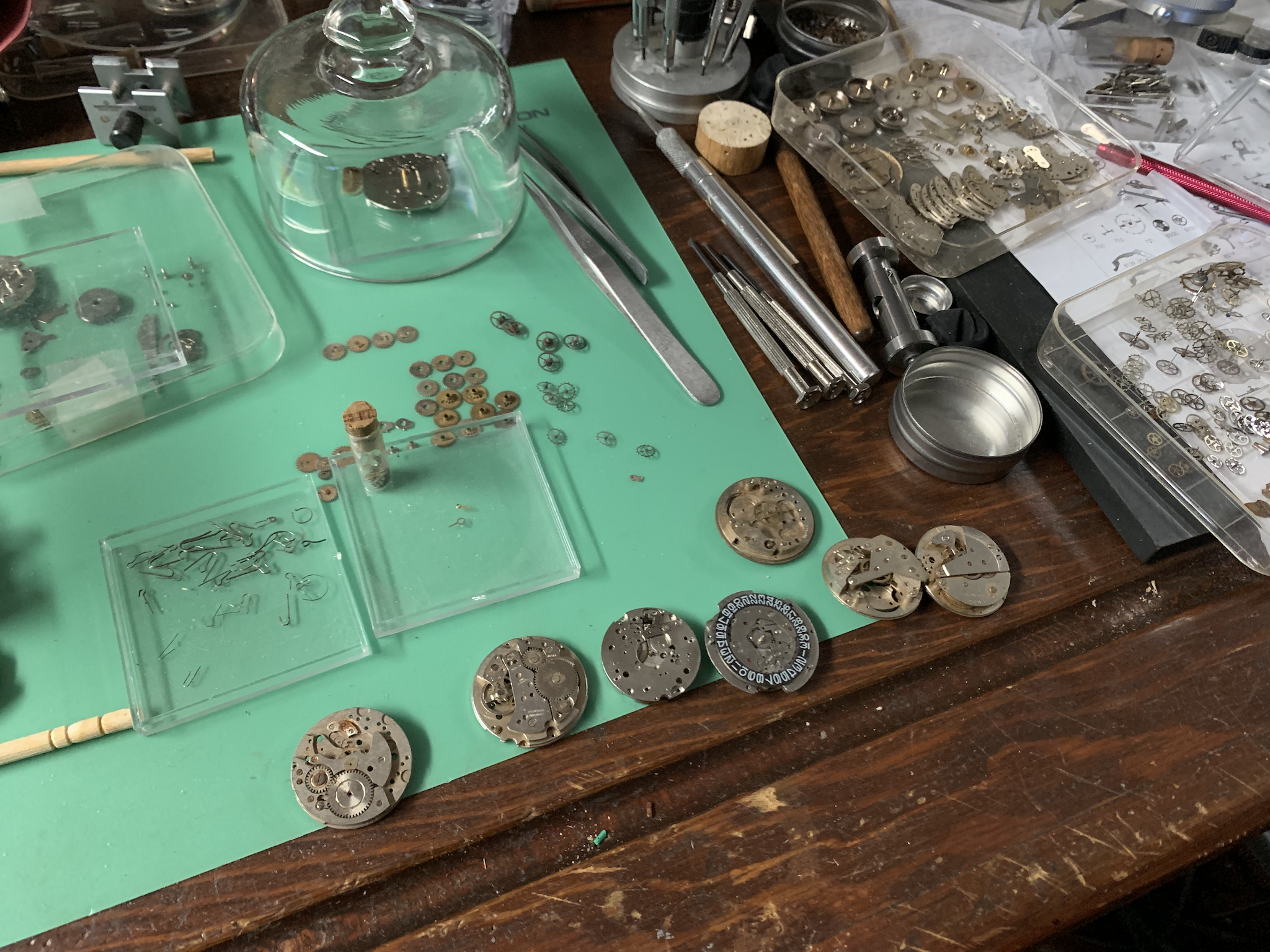

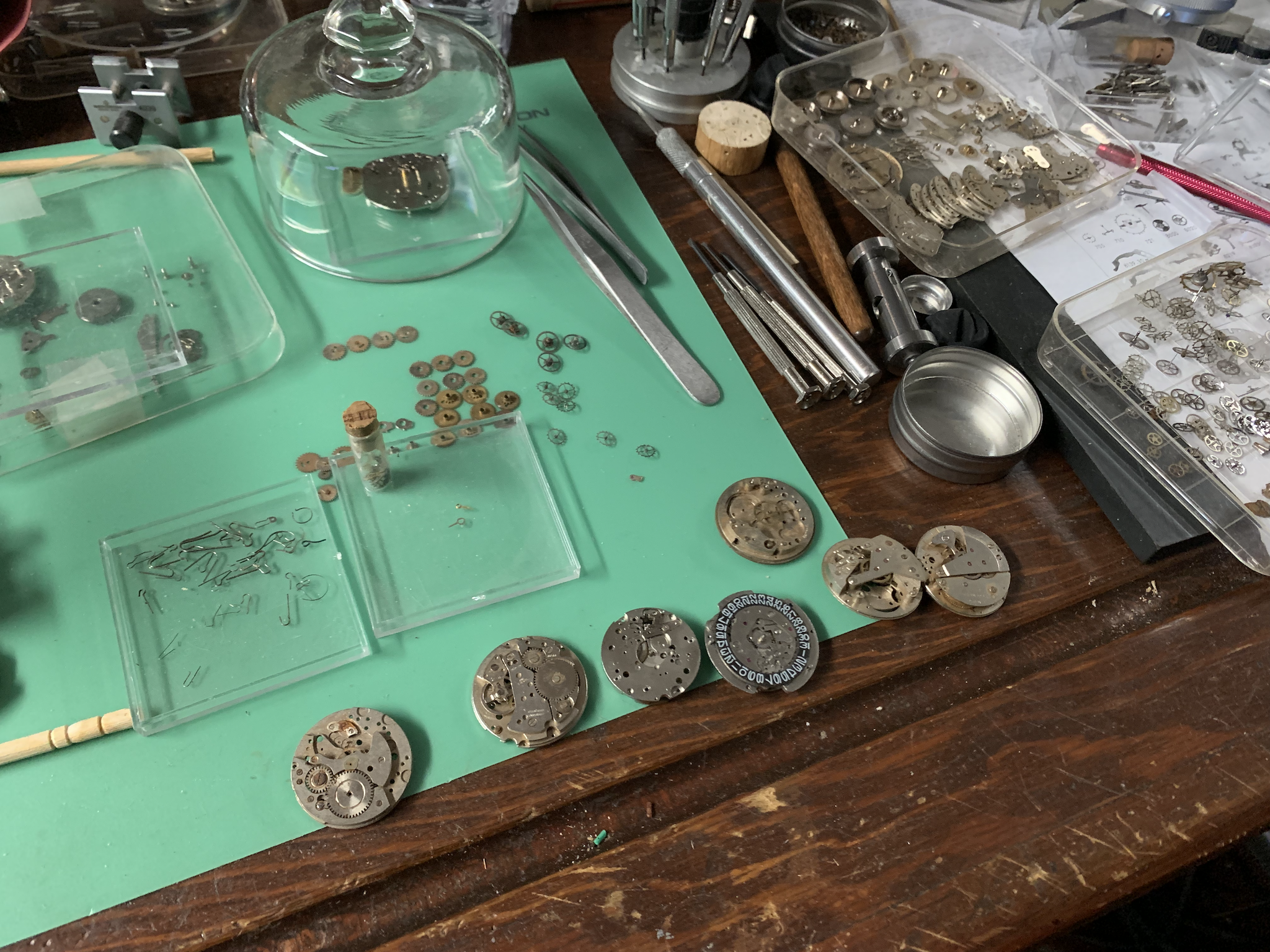

Having found quite a few Bettlach bridges and plates, but no 8800 base plates. I decided to sort wheels into big wheels, small wheels, then the small wheels into brass toned and silver toned. Silver toned often used in the pin lever. This turned up even more EB 8800 spares. Still no other base plates. Found some other EB calibers. Including two twins which with another are high on the want to clean list. This caliber also has a black dialed cousin.
Other pin levers are marked with a <RL> which seems to be a maker called Rhonda. Nothing seems to be complete.

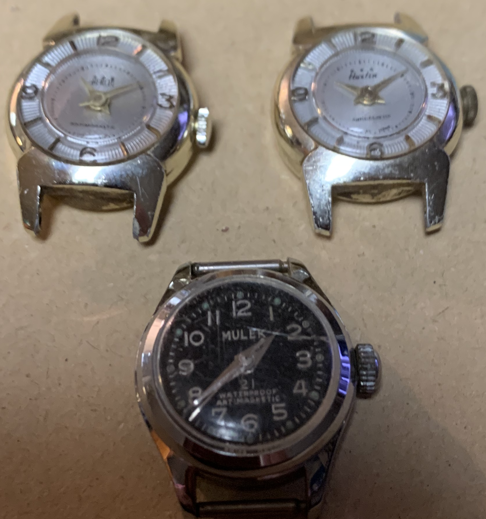

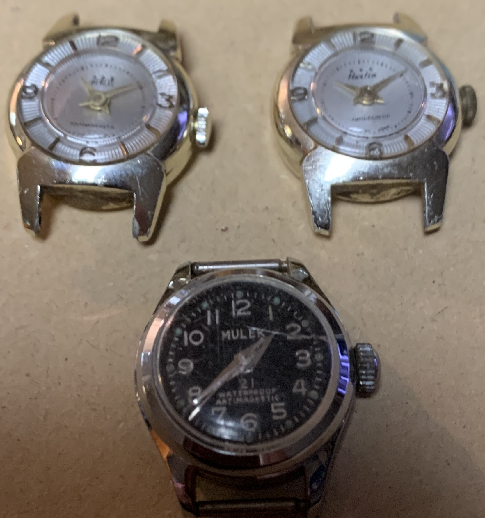

Interesting how many of these cheap watches come in a high grade of finish, even multiple jewel count. Yet they contain that maligned pin lever. Which is surprising robust. I suspect somewhere there may even be a pin lever tourbion out there somewhere.
Given that I have bothered to hoard these costume watches for a few decades, for a day like today. It seem strange that the base plates are missing for one of the calibers. Could be that some of the parts I sorted, then resorted by caliber over the week are used and replaced? That would then make this the proverbial junk drawer where vintage parts go. (Too bad these are mid grade from the 1960s. and not the stuff that is popular now.) I did have some rollex spares, but I sold them off years ago. I keep the Omega spares in a separate box. Chrono spares show up now and again.

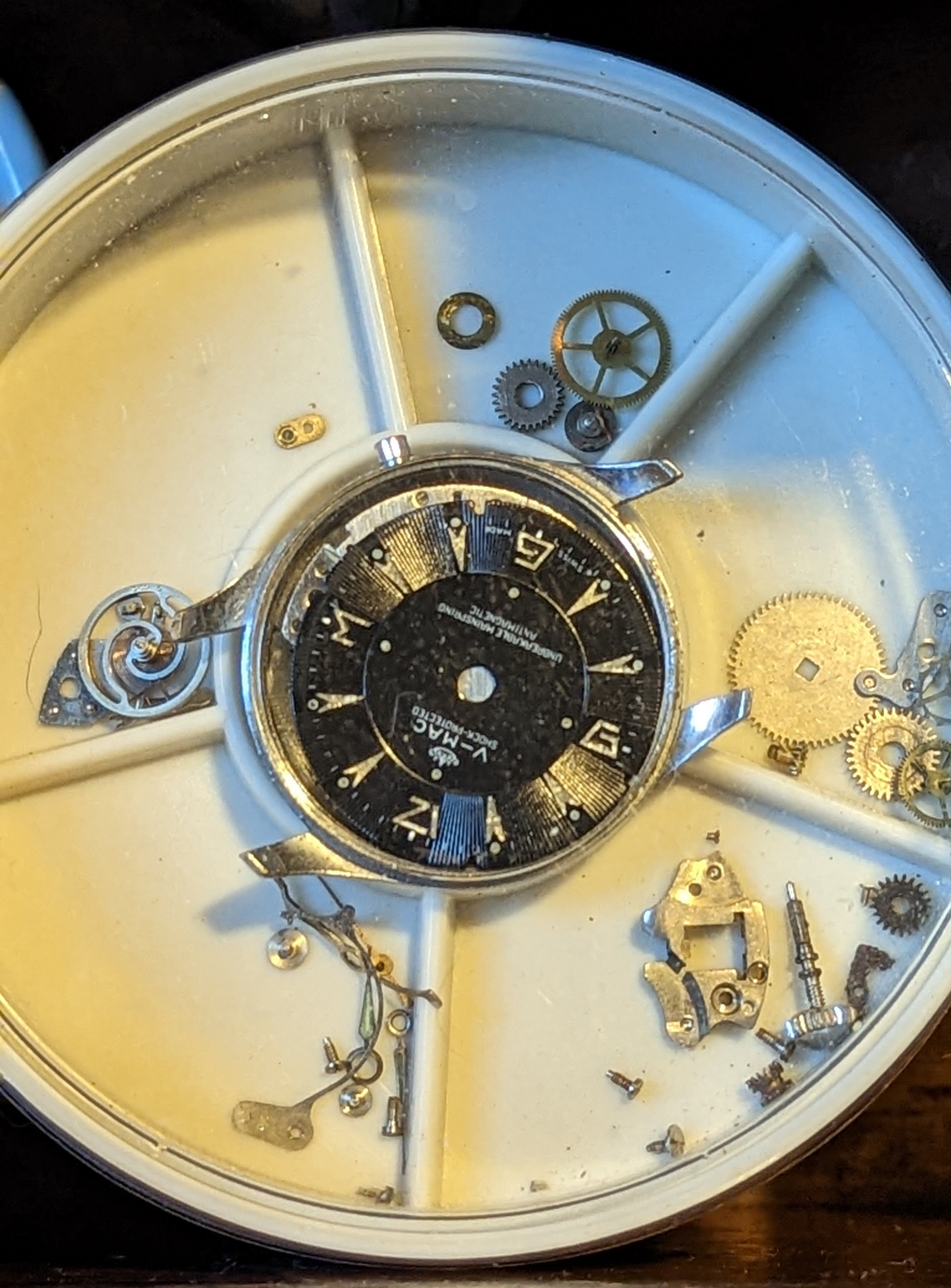

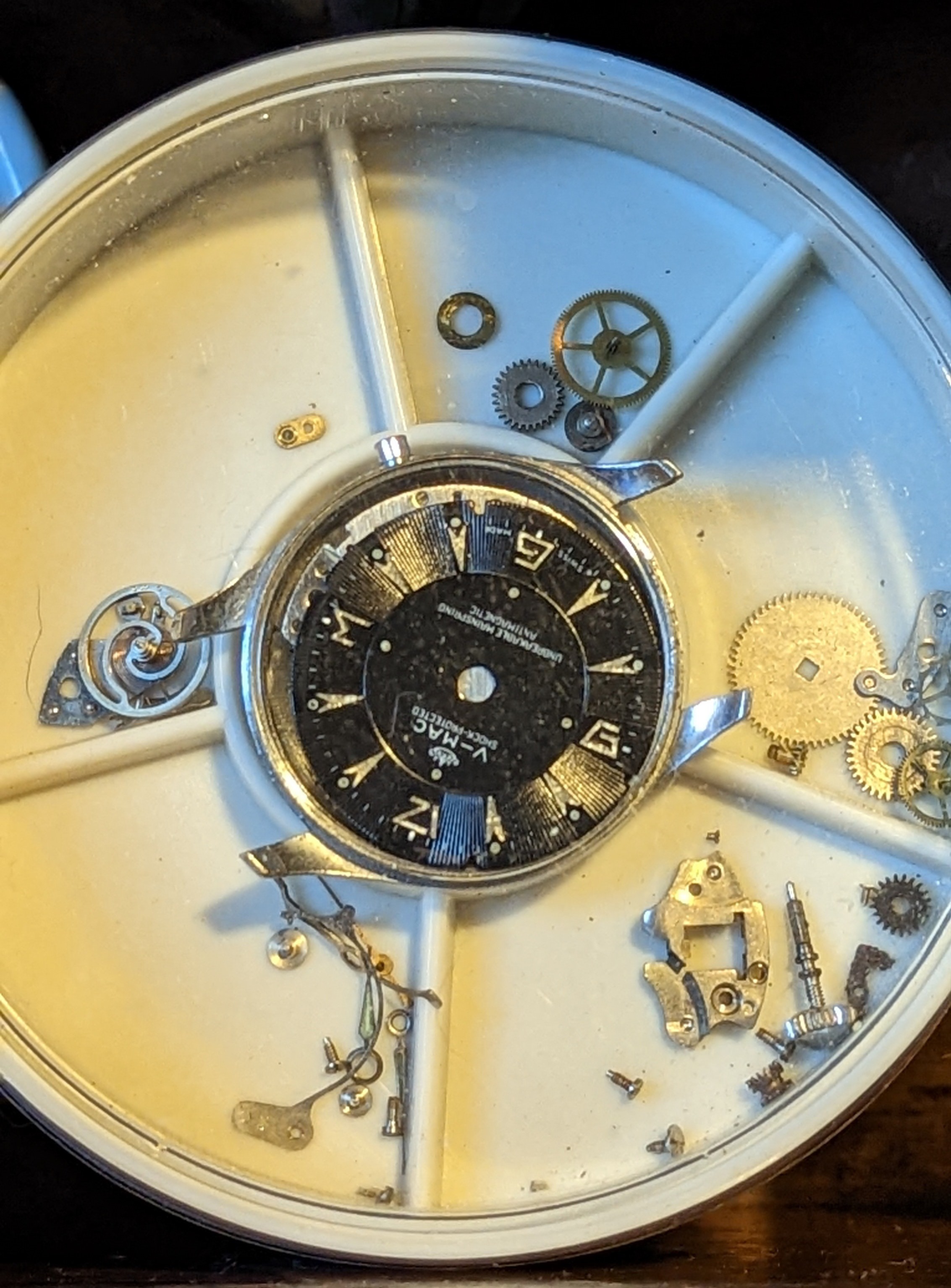

Why do such things become a rabbit warren? I set out to fix a Landeron, but need a dial. While waiting for a dial. I decide to de-rust a Val72. While waiting for rust removers to work, I decide to clean the 'Snoopy' pin lever. Only to find I may have a dozen pin levers all sorted by part with not enough parts to complete just one. Why is it that the correct clickspring can never be found, even though there are many in the box of spares. What happened to the clickspring for the watch I am currently cleaning and want to re-assemble?

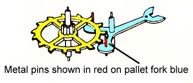

We use wiki so you do not have to https://en.wikipedia.org/wiki/Pin-pallet_escapement the fancy word for these is a Roskopf escapement. Actually I did not bother to read it till now myself.
Basically hard steel wire is used to replace the jewel stones. These are typically used in alarm clocks. Advantage is the production can be automated.
Such timekeepers also have loud tick sound. I think timex used a variation of such.
I guess the irony is that the rest of the watch is not than much less complex than the standard jeweled lever escapement. Especially from the repair point of veiw. For the most part these were not intended to be repaired. On the other hand the designs used are quite charming and appealing.
