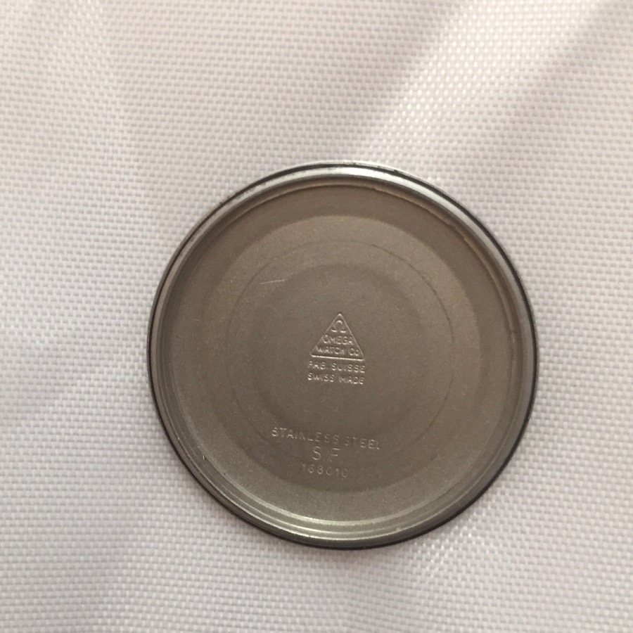

Posts 318 Likes 290 nicks ·Sep 6, 2019 Hi, folks. Posting here to see what I can find out about the caseback on my Constellation reference 168010 (1960s). The caseback has the correct reference number, but looks different from most. What do we have here? Thanks for the help.
Posts 2,326 Likes 1,887 VetPsychWars ·Sep 6, 2019 Cases are frequently made by contractors and there is acceptable variation between them. SF is likely the contractor ID. Tom
Posts 6,835 Likes 10,503 Peemacgee ·Sep 7, 2019·Purrrr-veyor of luxury cat box loungers Perfectly fine .010 case back. These later references didn’t have the perlage of the earlier ones. Your’s does show signs of rotor rub - so if you haven’t had your watch serviced it might be wise to do so. Old thread regarding SF https://omegaforums.net/threads/case-ref-s-f-168-017.11078/
Posts 318 Likes 290 nicks ·Sep 7, 2019 Thank you for your comment and the link. And yes, it was recently serviced. Cheers.
