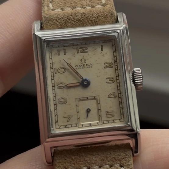

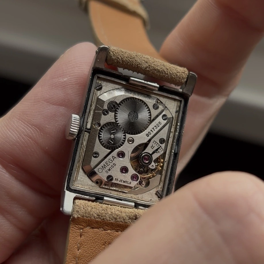

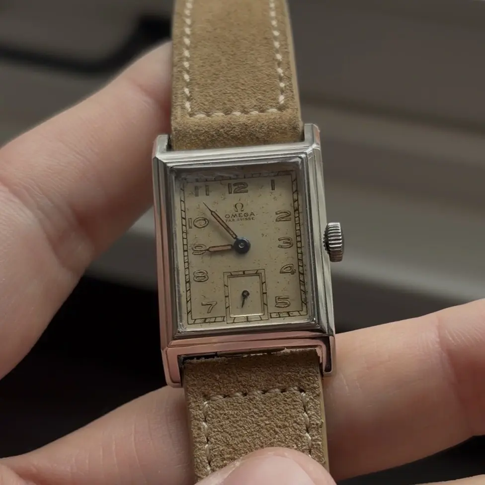

I have a beautiful vintage marine standard, I believe CK 3683 or CK 3635 (maybe you all can help me with identifying) that sadly had the caseback fall off. Been talking with my local watchmaker for a few months trying to source a replacement. It’s a hard task for sure, but am here to hopefully start a conversation with the smart people on this forum to help? How should I go about finding a part like this?
