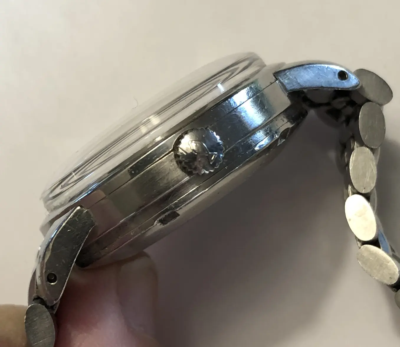

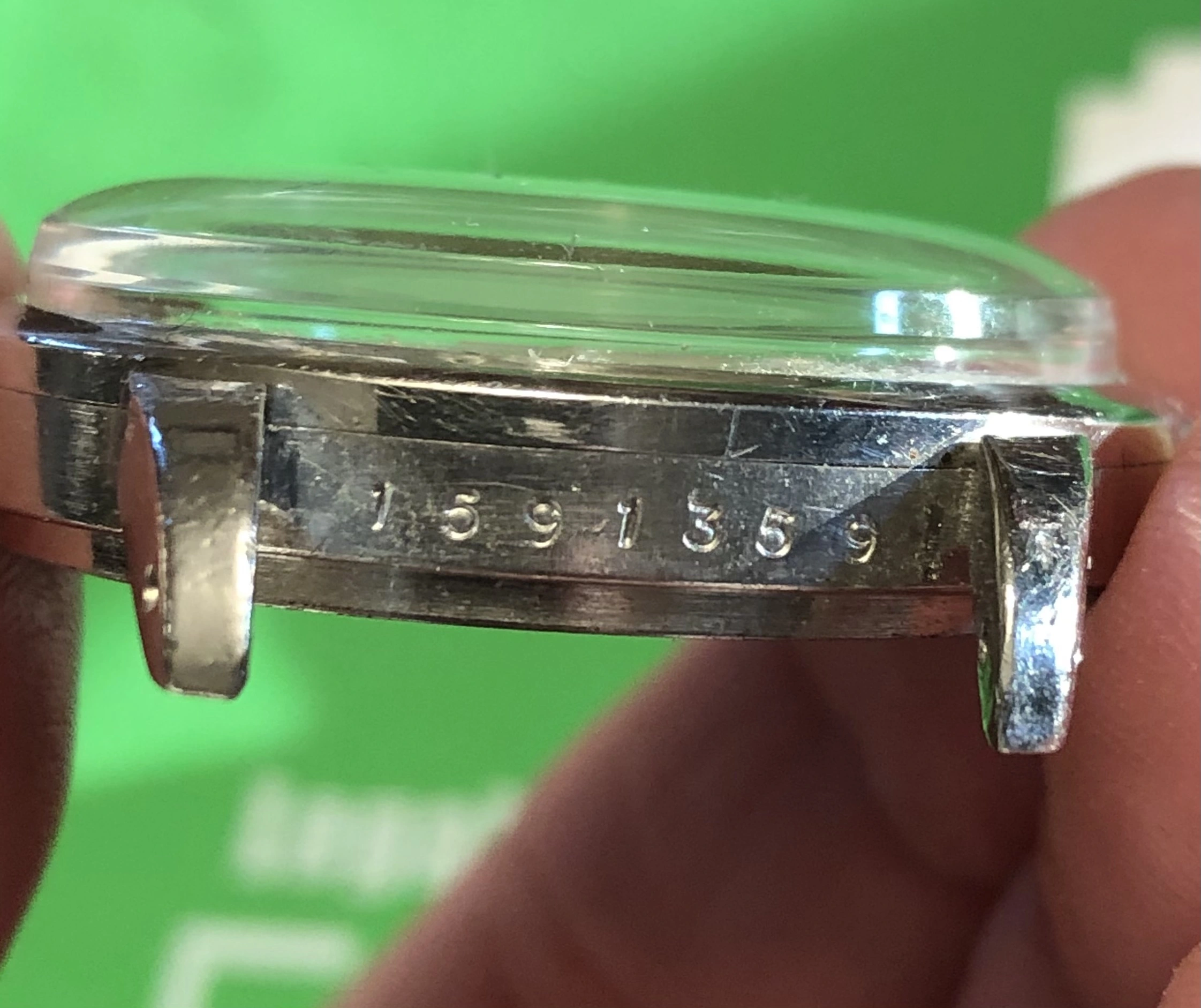

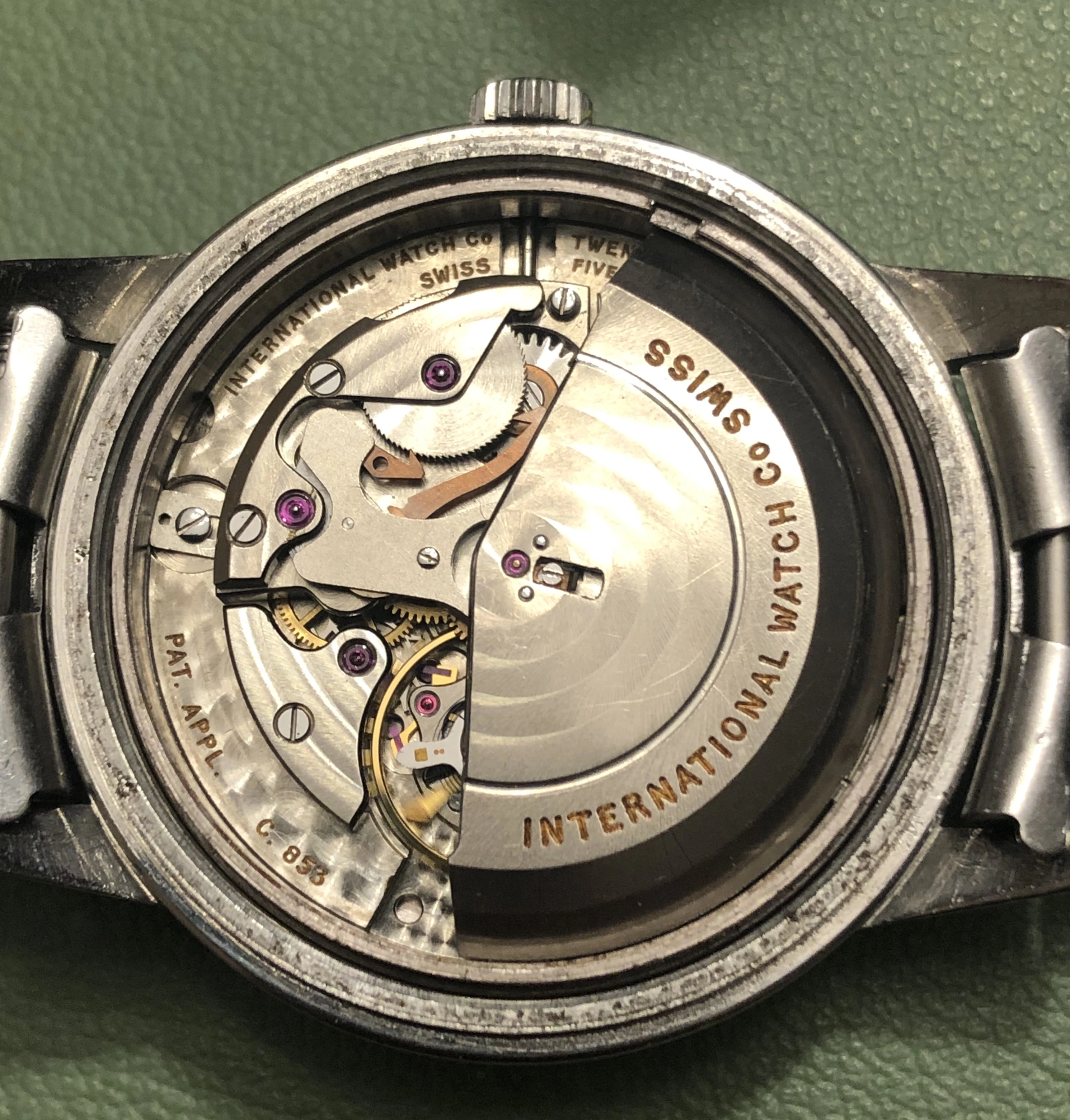

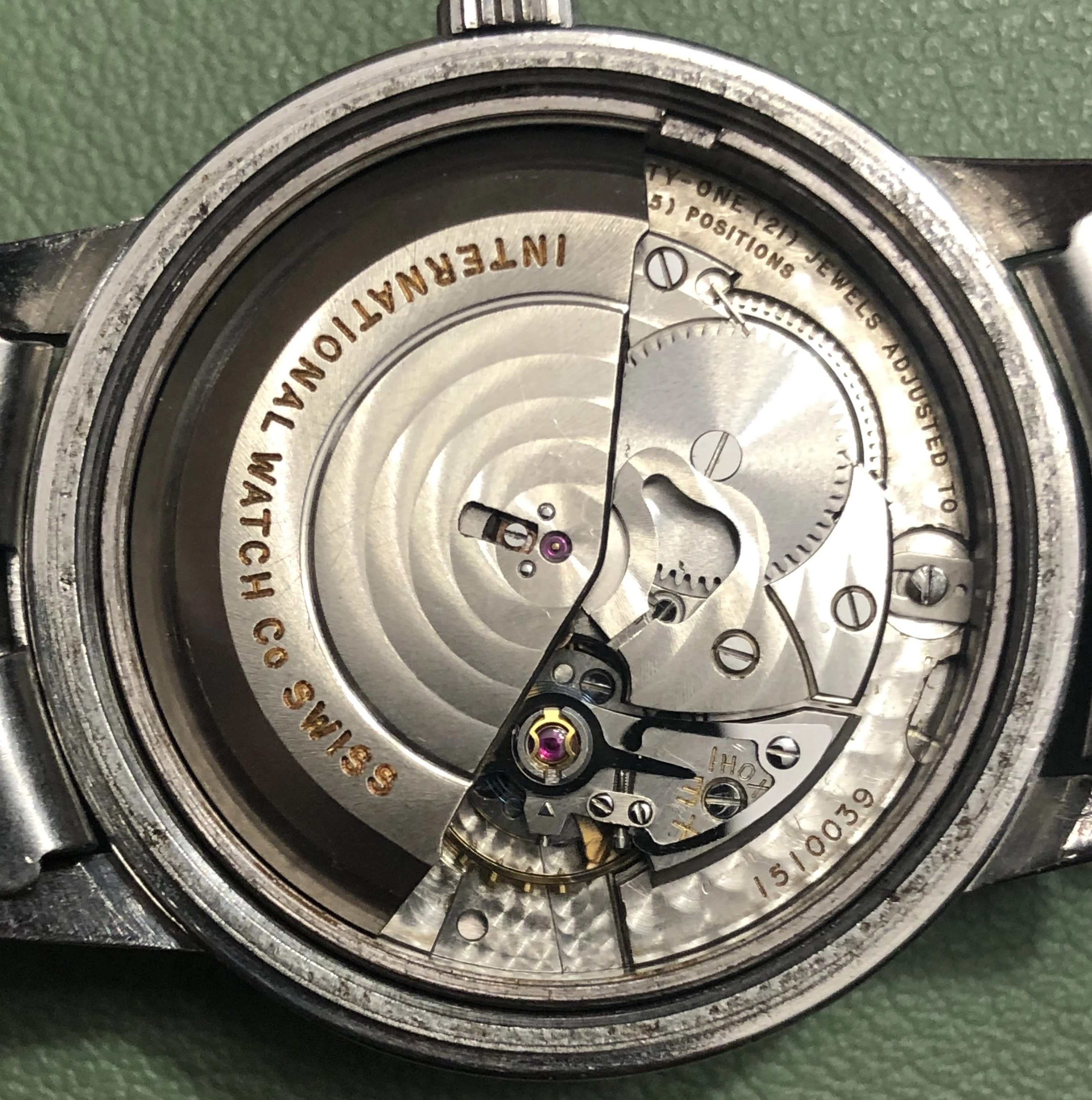

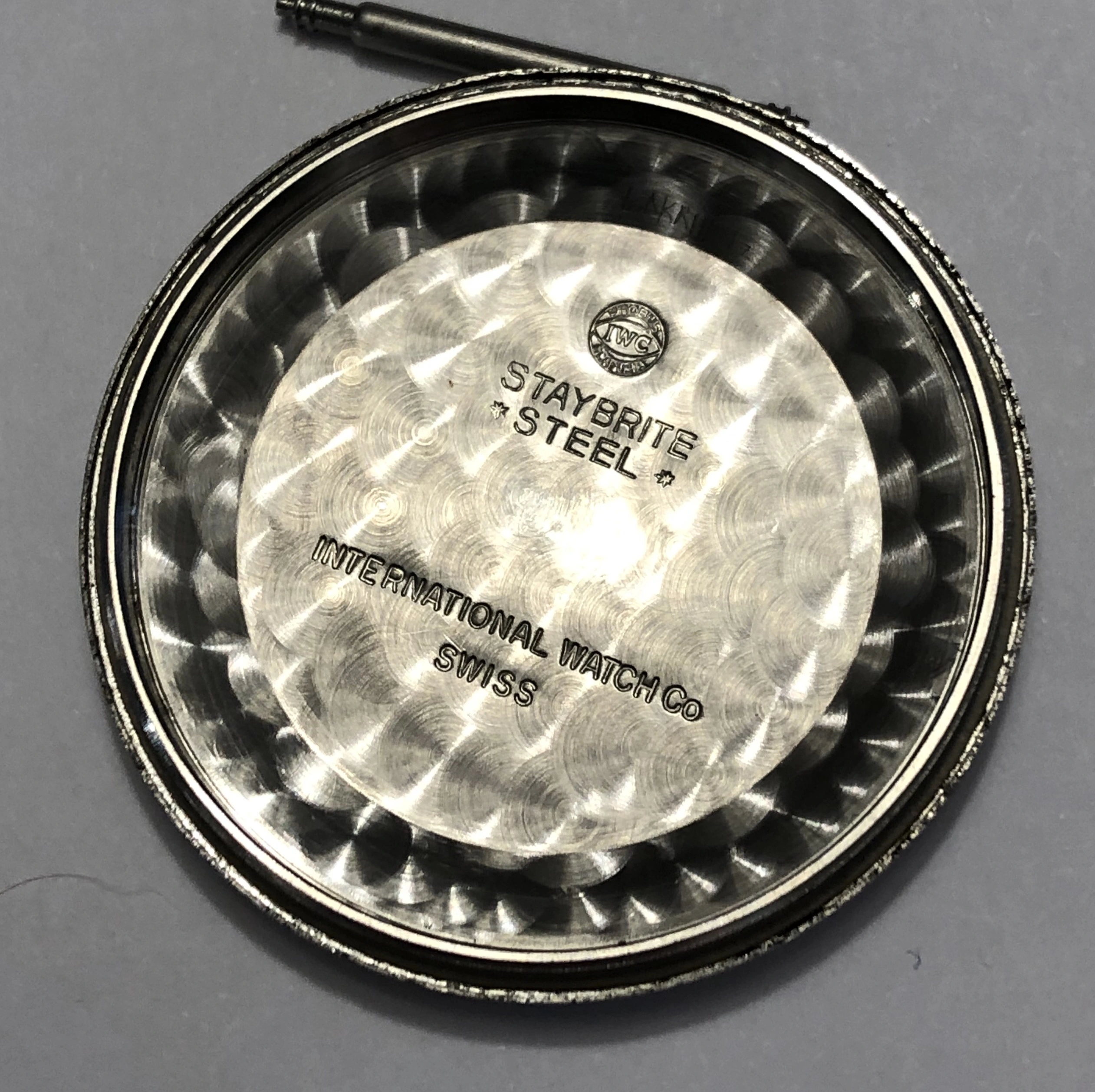

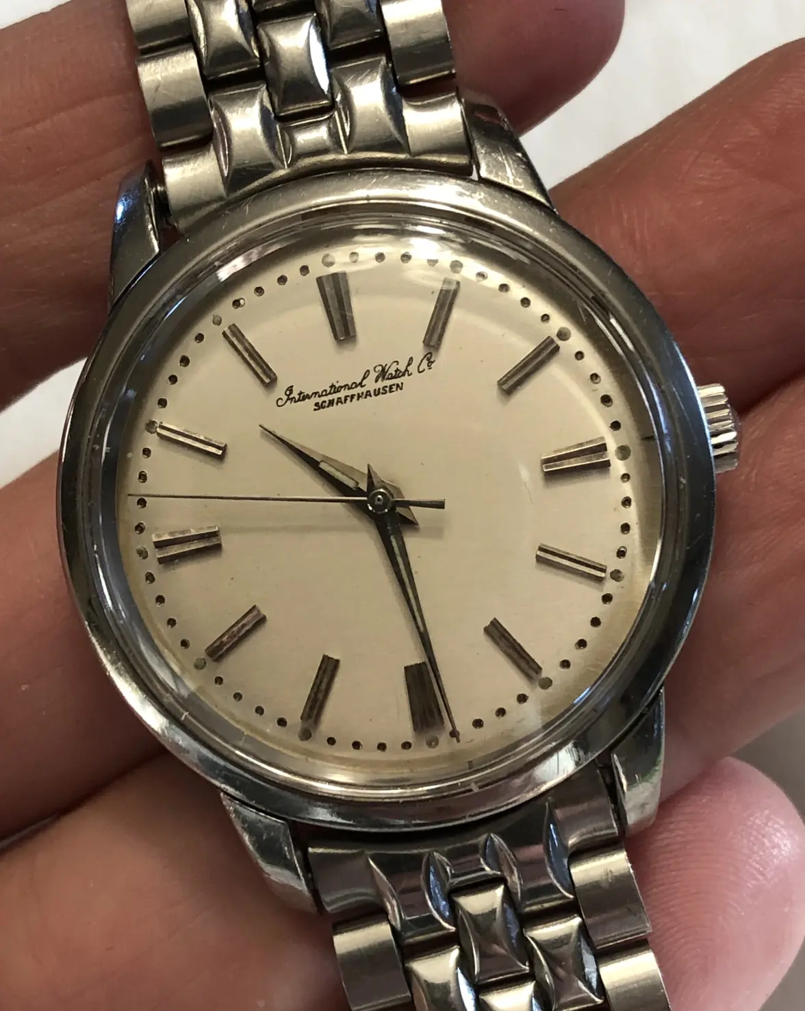

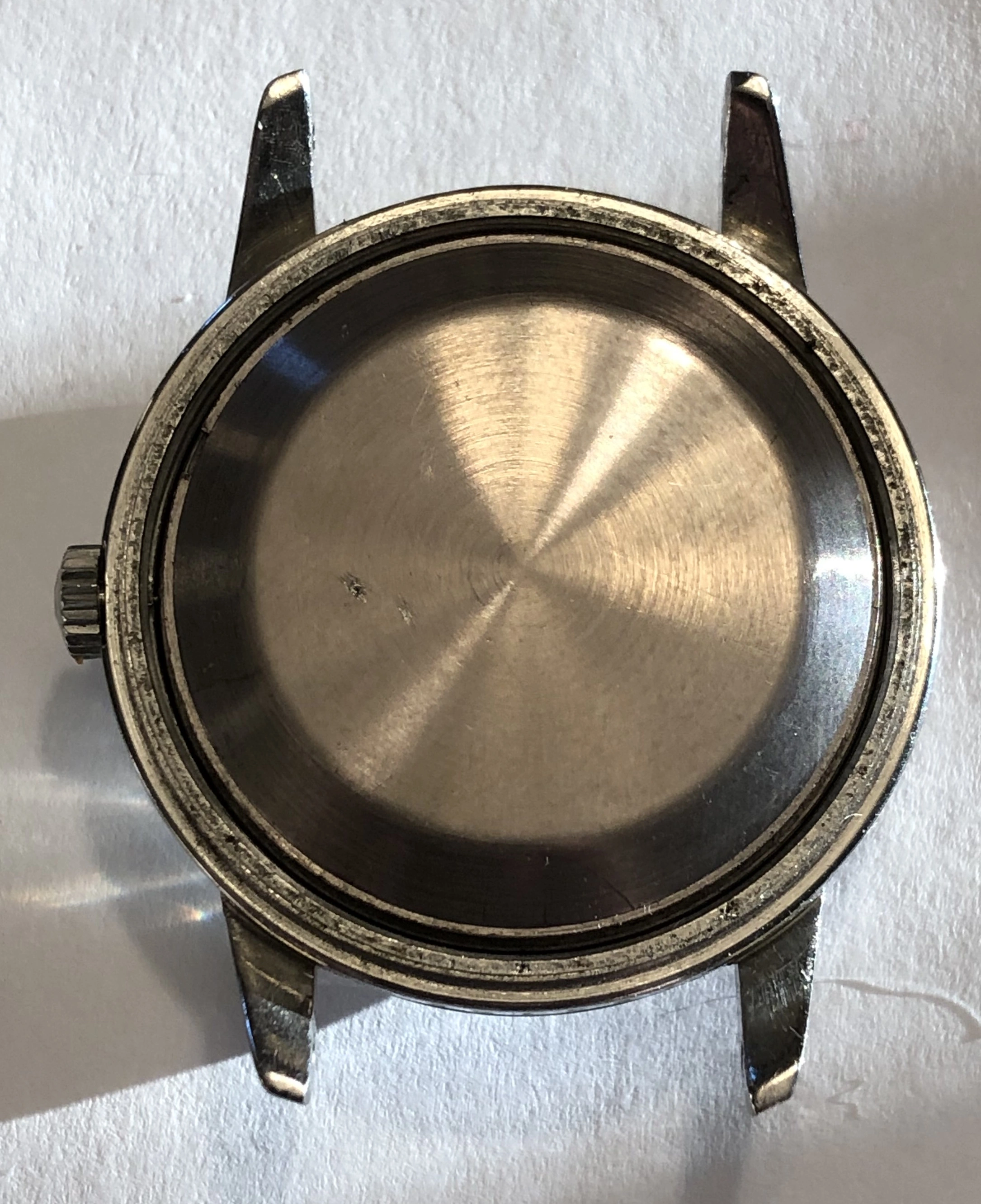

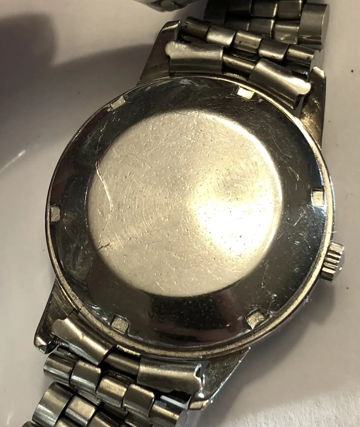

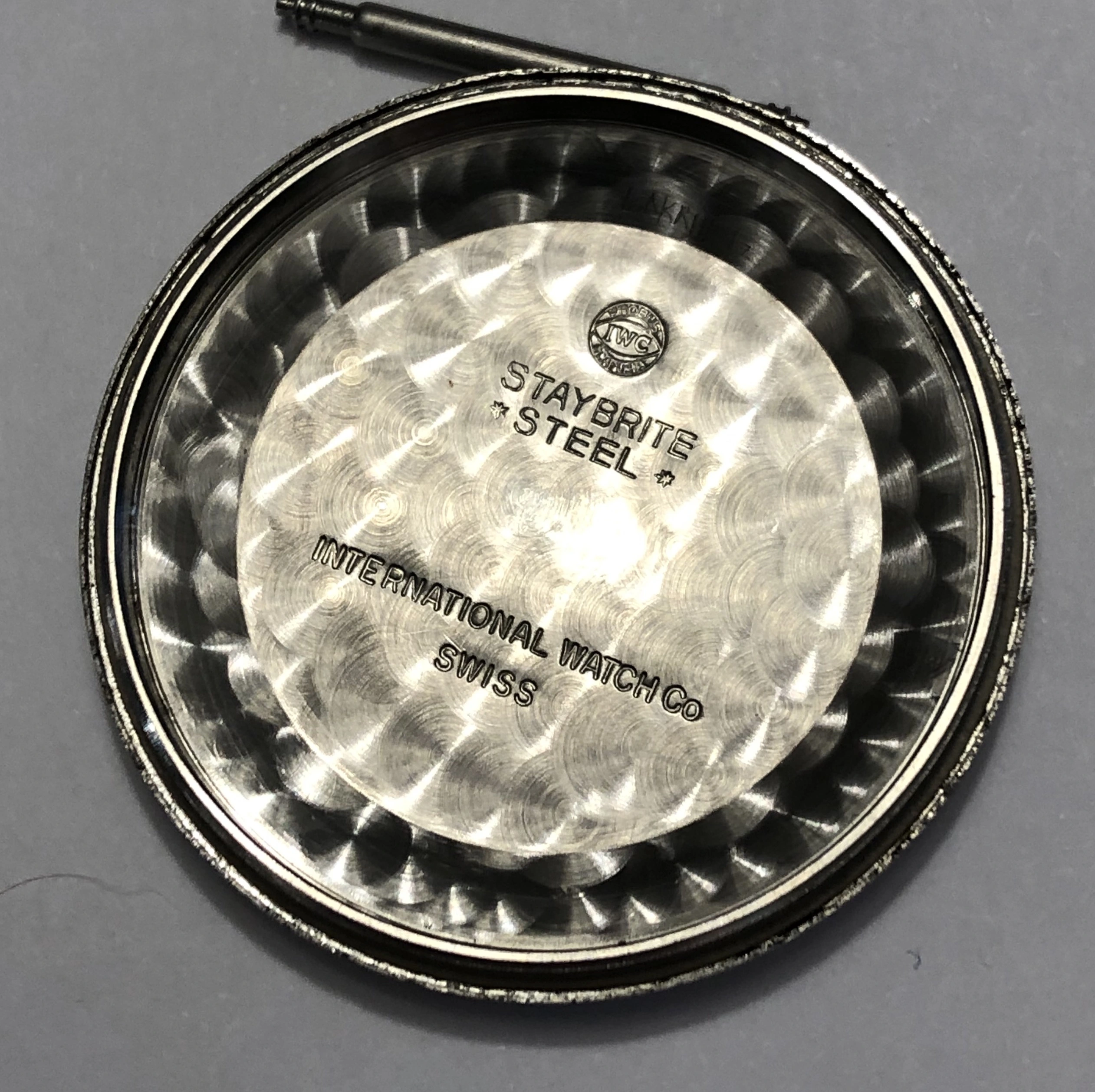

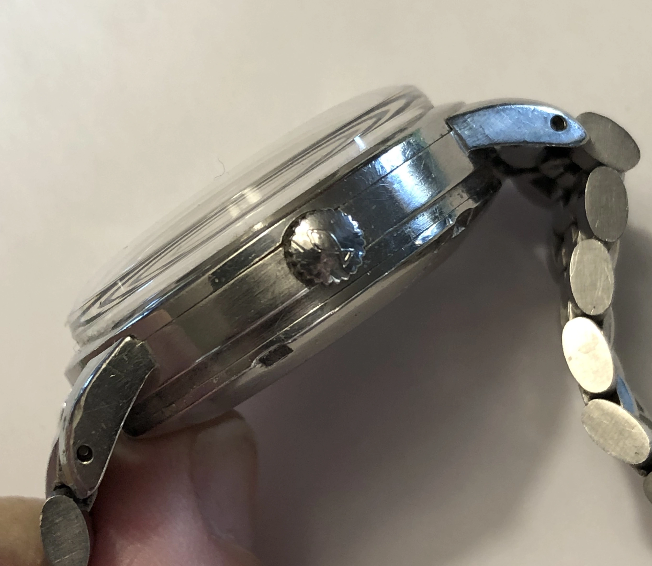

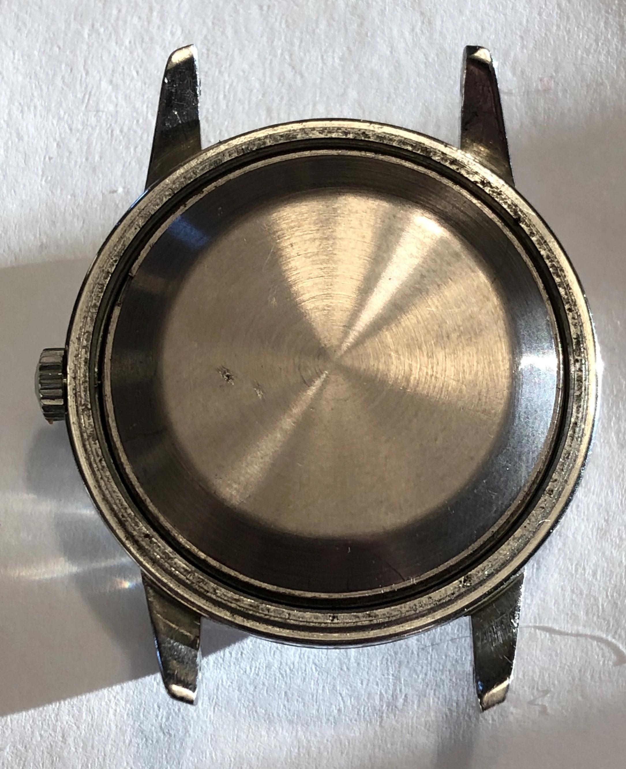

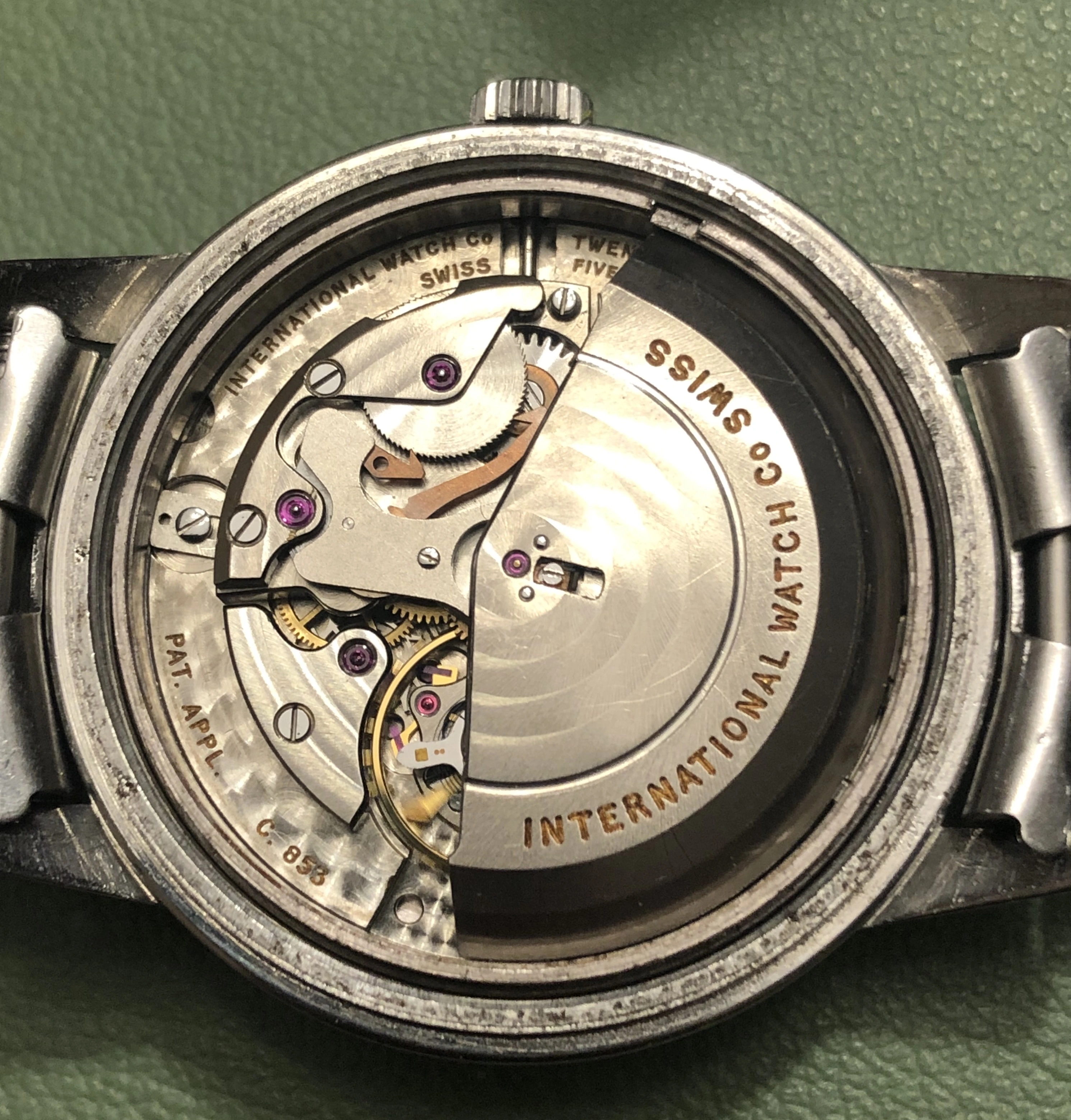

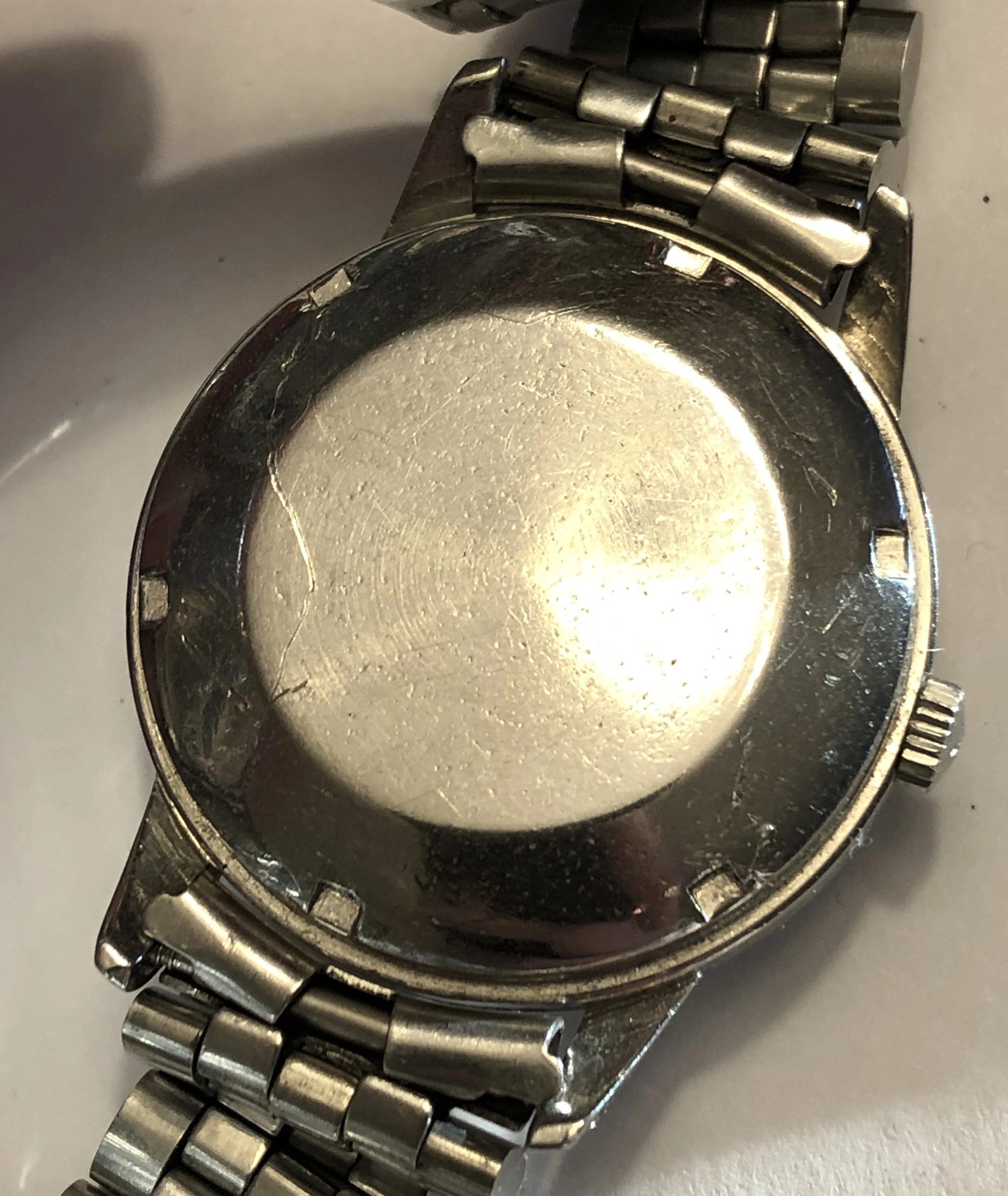

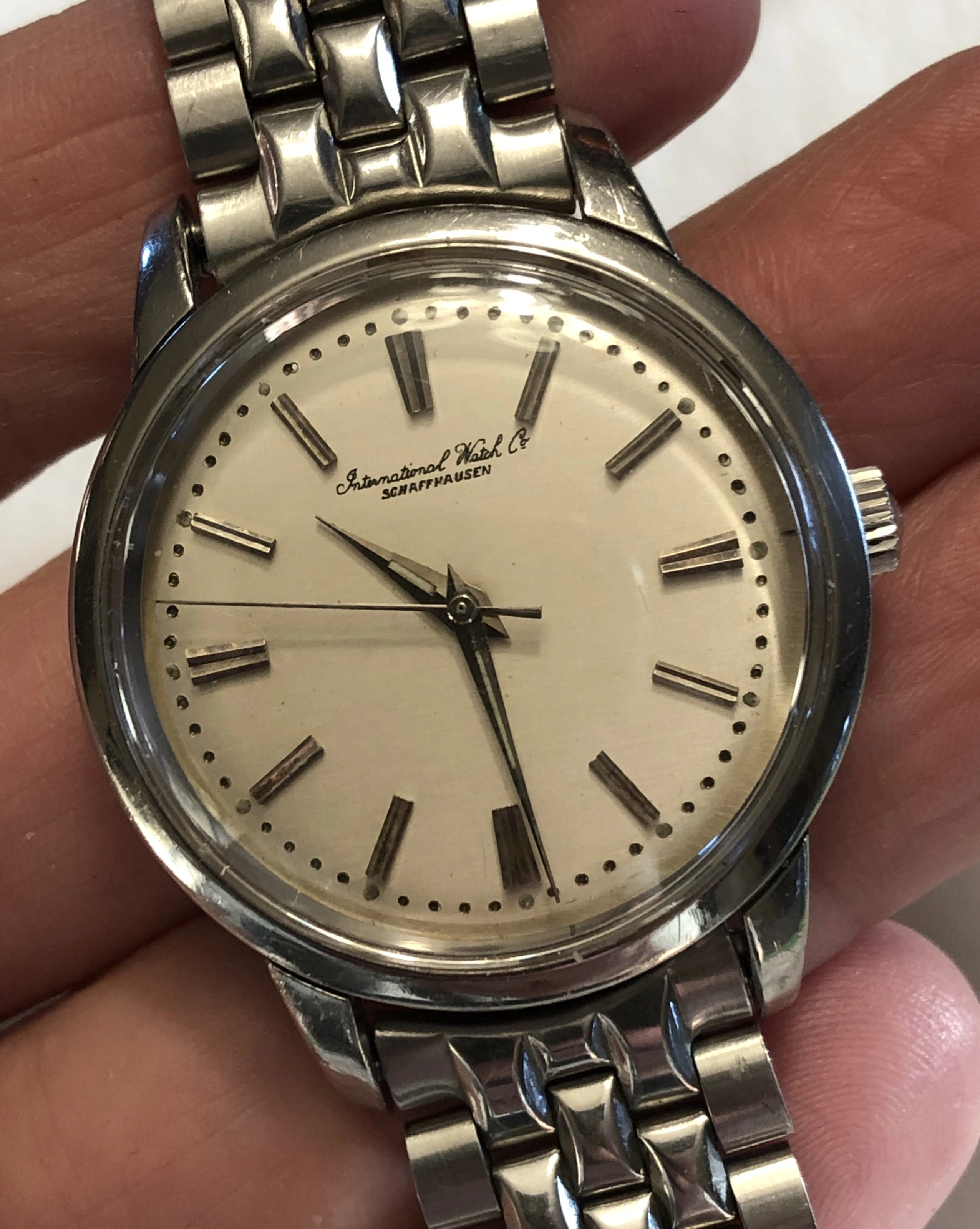

I inherited an IWC from my father, it was his daily wear watch and his pride and joy. It's actually a very nice watch, well worn but high quality, in a 36.5mm stainless case, with cal 853 movement from the early 1960s. It's basically a poor-man's Ingenieur.
However, the dial was poorly repainted, which decreases my enjoyment of the watch. I have kept my eyes open for a good replacement dial for about 10 years now, without success. I have found dozens of dials, but none in a condition that is worth the effort.
Recently, I've started to consider factory restoration. (https://www.iwc.com/us-en/services/restoration). I'm sure that the price will be exorbitant, but my bigger doubt is whether the result will be at all satisfying to me. I've seen a number of members post the results of Omega vintage watch restoration, and I haven't found them appealing.
I'm wondering if anyone on OF has first-hand experience with IWC factory restoration. Photos of the watch below.

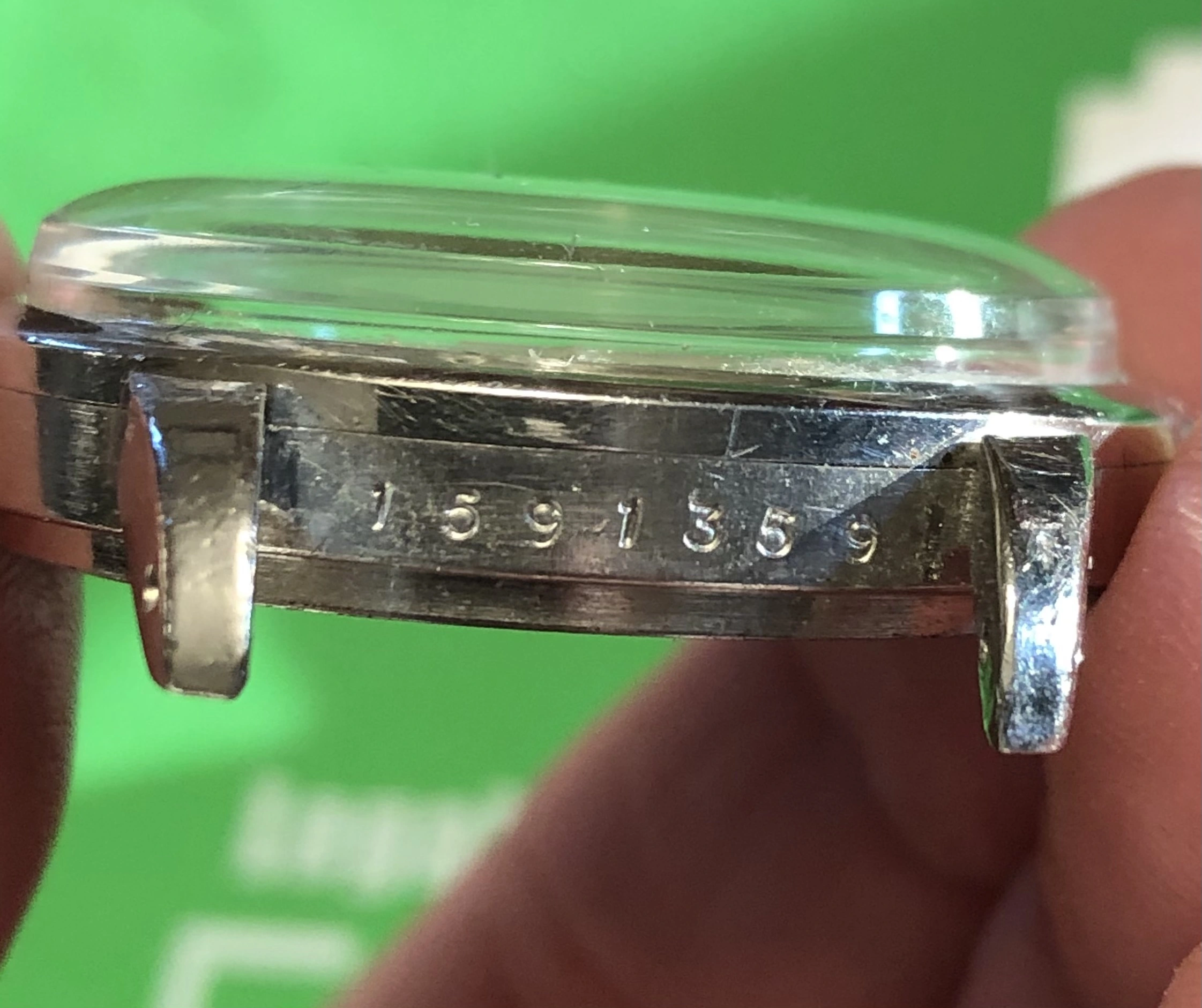

That case, crown, hands, movement cap, and serial number between the lugs are all consistent with a ref. 666 Ingenieur, and inconsistent with ordinary automatics that I am familiar with. The profile view is, I would say, further compelling evidence that it is a 666.
So...congratulations! Even if it won't make it easier to find a replacement dial. 馃榾

Good point, Tony, I really have just assumed it's not an Ingenieur, but it has all of the outward signs as you mention. I suppose I had better figure that out for certain before doing anything about the dial. I think that IWC may have an archive service.

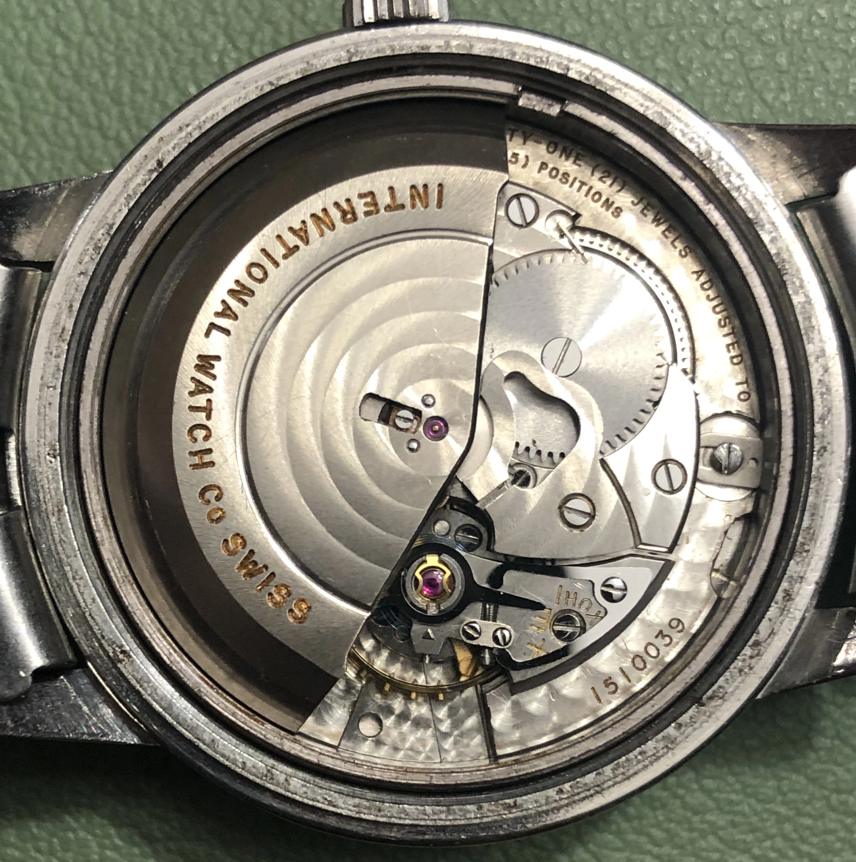

I'll add that your watch also has the soft iron shield that is put between the caseback and the movement (because of the anti-magnetic properties of this material). This is a further indication that you may actually have an Ingenieur on your hands here. (EDIT: just noticed that @Tony C. already mentioned the movement cap - me and my reading comprehension!)
Not that I'm an expert at this, but I also found it a "compelling piece of evidence".
Another, very much weaker piece is that the movement has the words "adjusted to five positions" engraved, which would fit with a top-of-the-line watch of that time. That said, IWC has been adding this info sporadically, as in: I can't make heads or tails of when they would use this, and when they would not. Still, it might be an indicator.
So if you really have an Ingenieur here, that would very much change the perspective on getting a replacement dial. There are soooo many fake Ingenieur watches out there (I swear there's a guy running around with a rubber stamp to "upgrade" any IWC to an Ingenieur!). Any loose dial floating about would be super suspect, I think.
Then again, if this is an Ingenieur, the cost of a professional restoration at the mothership suddenly seem to make more sense, man-maths-wise.

If, by chance, any readers would care to wager that it is not a ref. 666 Ingenieur, I'm prepared to take the other side of the bet. 馃榿

BTW, assuming that while the dial face was refinished, the indices are original, it is a rather uncommon variation. But I was able to find what I believe to be the same style (no larger image, unfortunately), albeit in gold furniture, on the classic Dial Variations site:

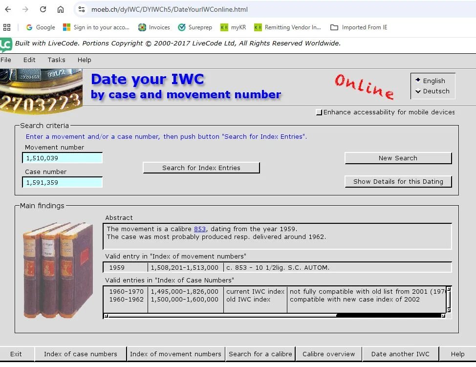

Much appreciated. I had researched the numbers in the past, but didn't have that information handy.
If you go to the website, there are tabs with more detailed information. Looks to me like it was cased at the factory in 1962.

That is a great find.

I can certainly understand the desire to restore or replace the dial and in general am all for restoring watches to their original glory. Since there are sure to be sentimental aspects in play in this case, I would give in consideration that there may be some value in keeping the watch the way your father wore it, with the dial that he used to check the time on.
