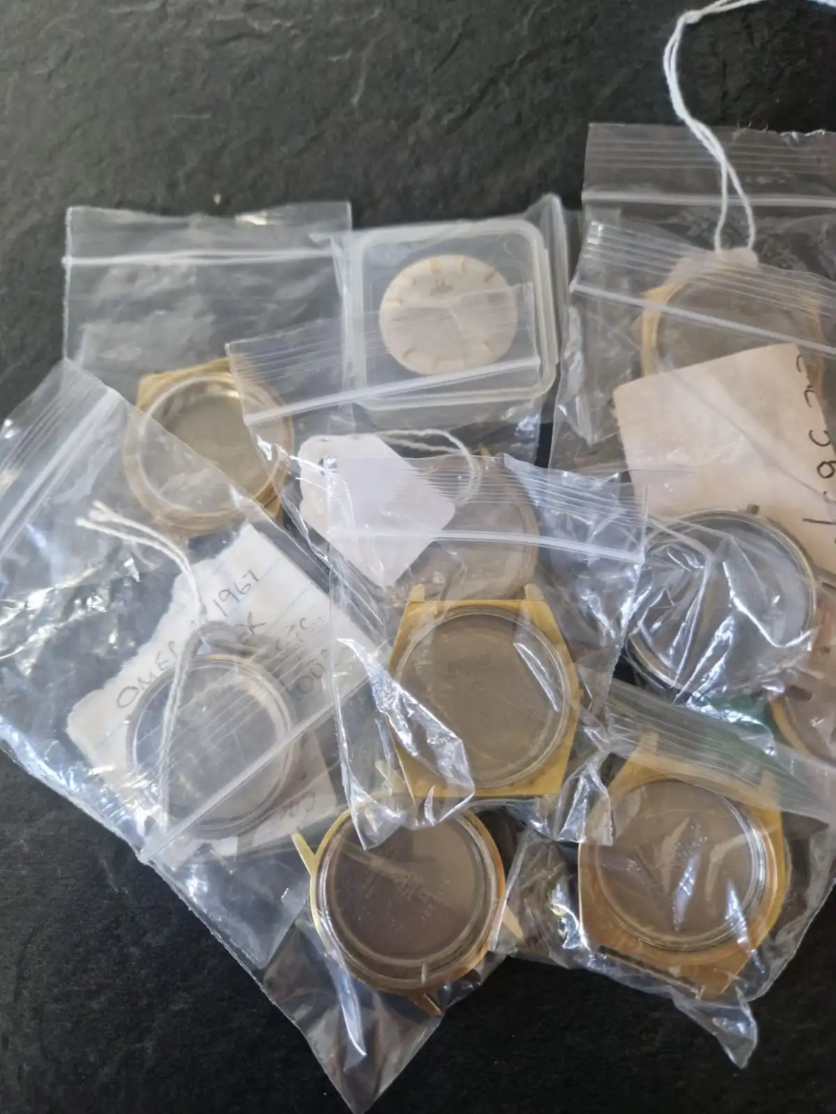

Have obtained this array of original Omega cases. Can anyone tell me what case number would house the 565 movement with a 29.2 mm Seamaster dial as it would make sense to match it to its case before offering for sale.
Thanks

166.002 165.002 165.003 166.070 165.041 Here are a few. The first 3 are seamaster cases that uses 565/552 movements so they’ll fit the other two are Geneve cases depending what you’ve got often they are just blank on the back cover ie has no hippocampus ext the movement should also fit. people with better knowledge may help also soon

A range of cases wil fit cal 565 movements, but often they have slightly different dial diameters. I’m not aware of any lists that confirm dial diameter for each reference. If you have a range of dials you may need to Emily trial and error to see which fit. Clearance for the hands under the crystal is also important.
